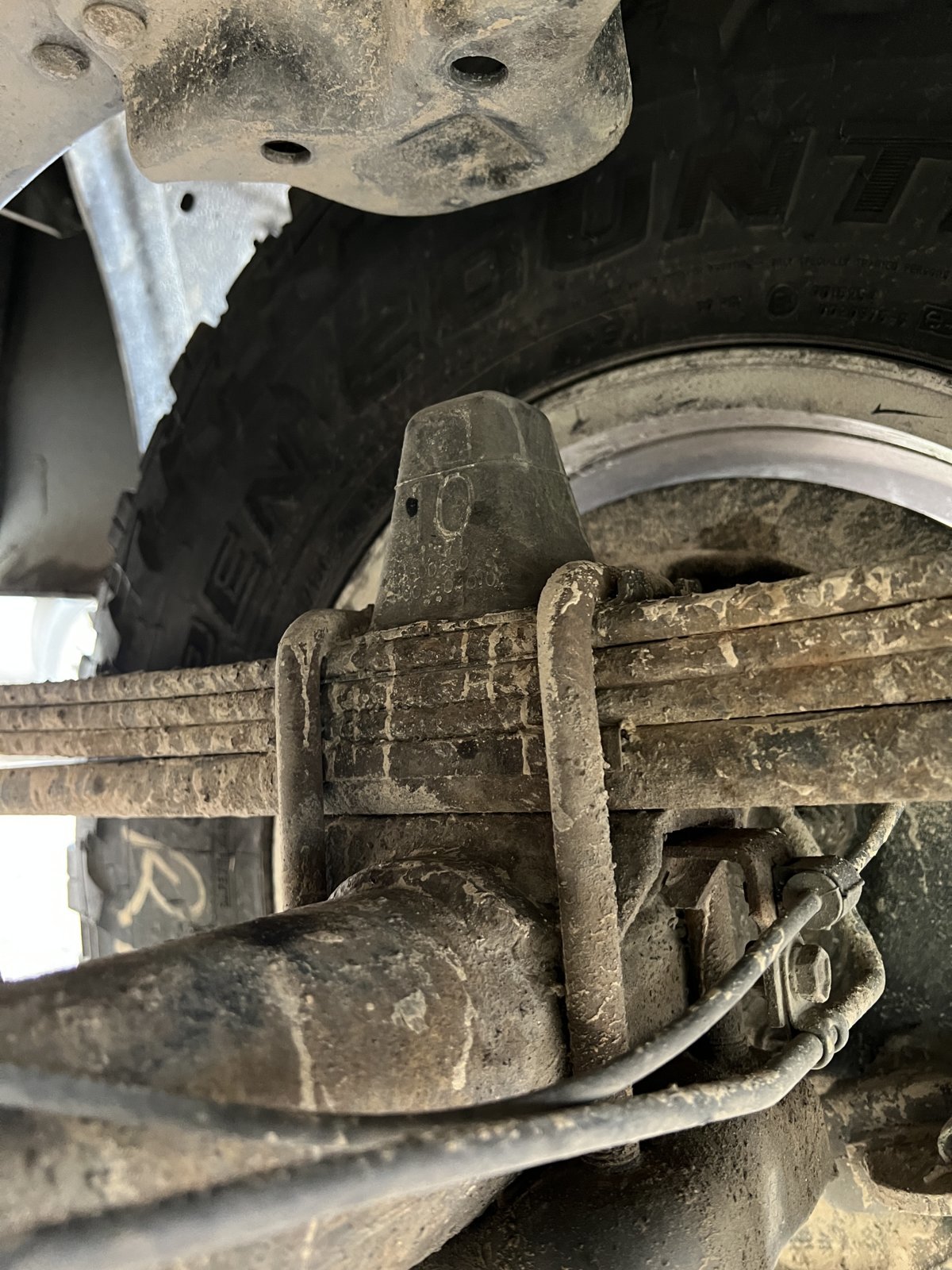

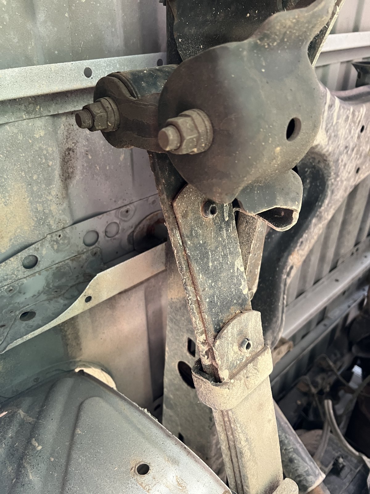

    No add a leaf or blocks. The rear leaf springs are in pretty good shape. Maybe the PO did a rear lift also? Theres stock ride height numbers out there for the AC on the back somewhere isn’t there? I can measure the back and maybe I am already lifted?

    I saw someone on here recently mention you can get them with 700# springs but I couldn't find that online.
    What year GTI?! Can't remember if you posted pics or not. Don't make me post my MKIV again!
    https://www.tundras.com/threads/how-big-is-yours-measure-up.46186/
    Get us a couple of pics of the leaf packs and leaf saddle and whatnot.

    Bilstein 6112 - Set @ 5/4; General Spring: 2000 - 2006 Toyota Tundra heavy duty rear leaf spring, 5(4/1) leaves
    Add a Leaf will give you more weight capacity and kinda "performance" . . block . . more height only. You can also count your leaves? Spelling?

    Rear looks stock to me. Your numbers look stock also [in the rear]*. And yep, that's basically level. So 6/4 on 6112 will get AC/V8/4WD a smidge higher in the front, but basically level. That's awesome to hear, and I think if I swap out my stiff ass Toytecs for 6112s, I'll probably go 6/4.
