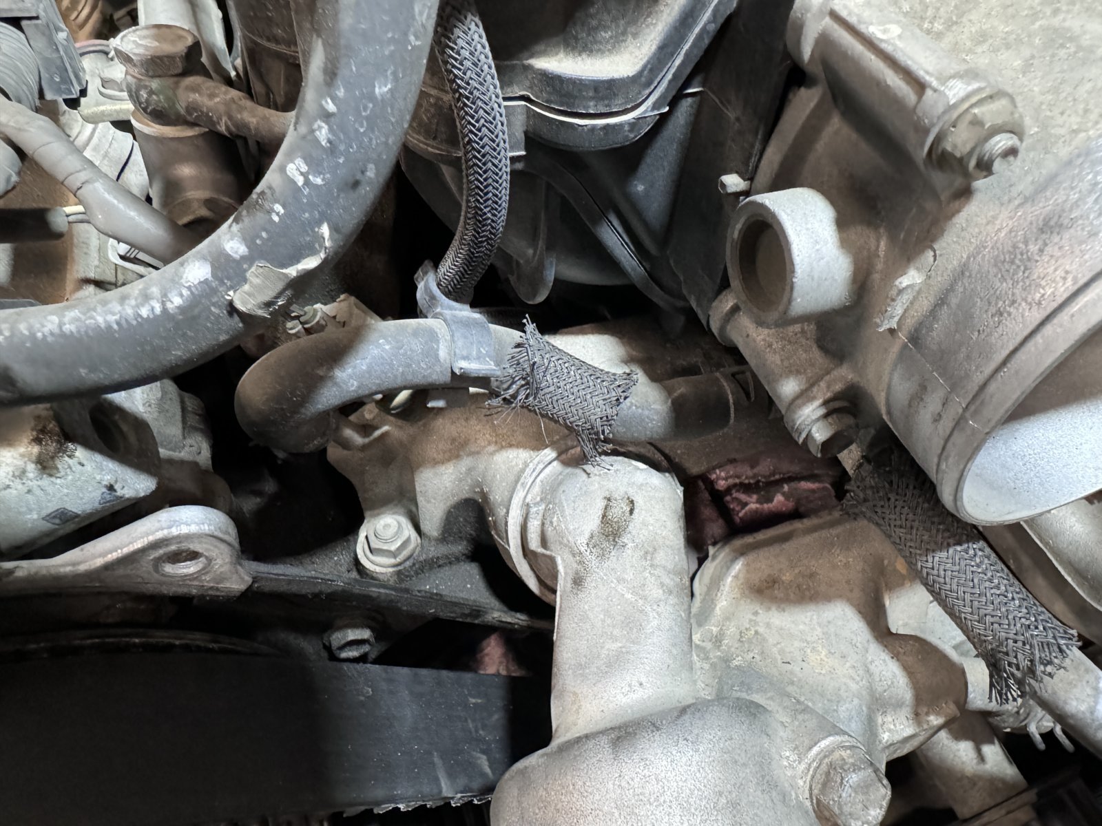

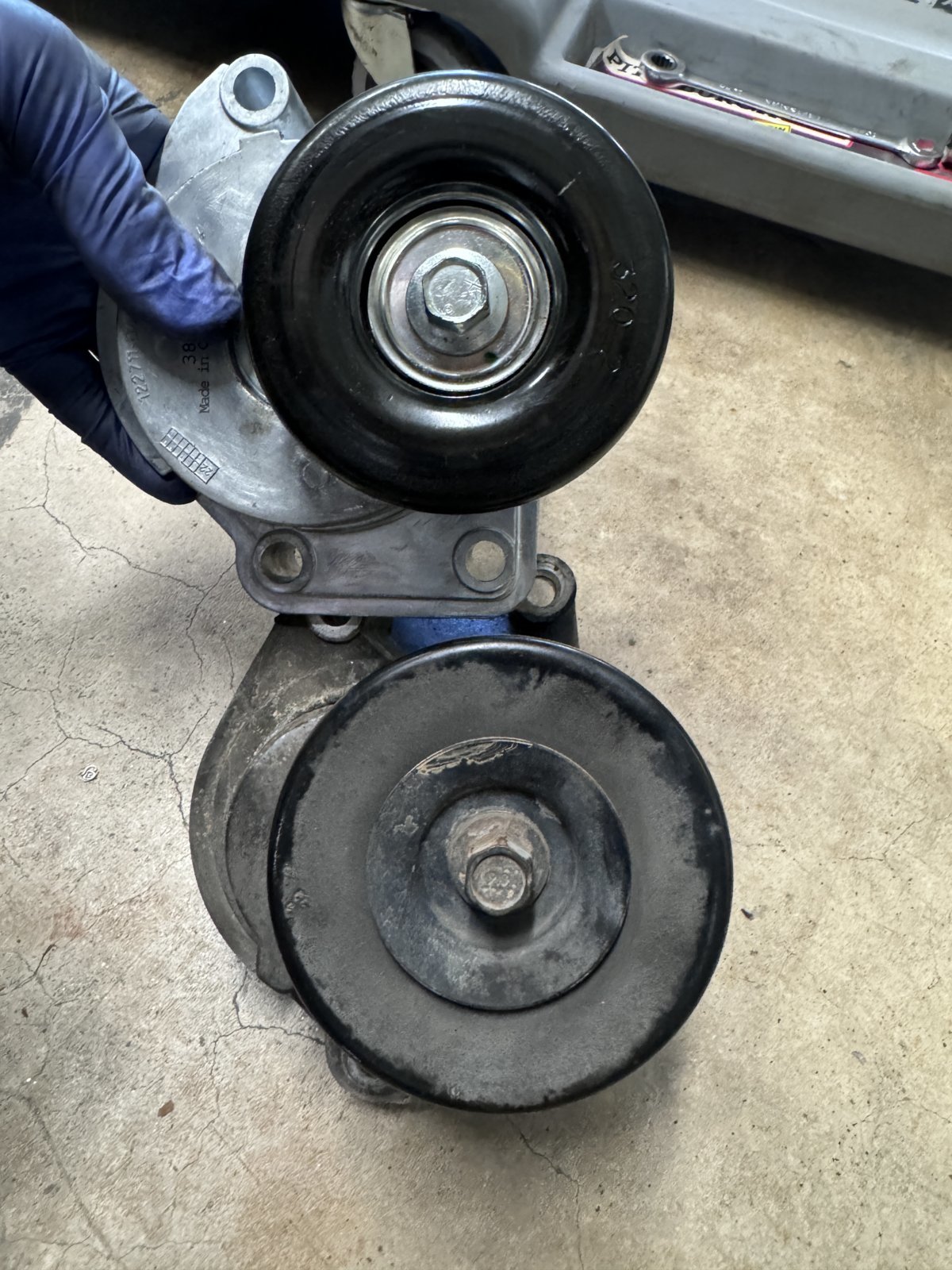

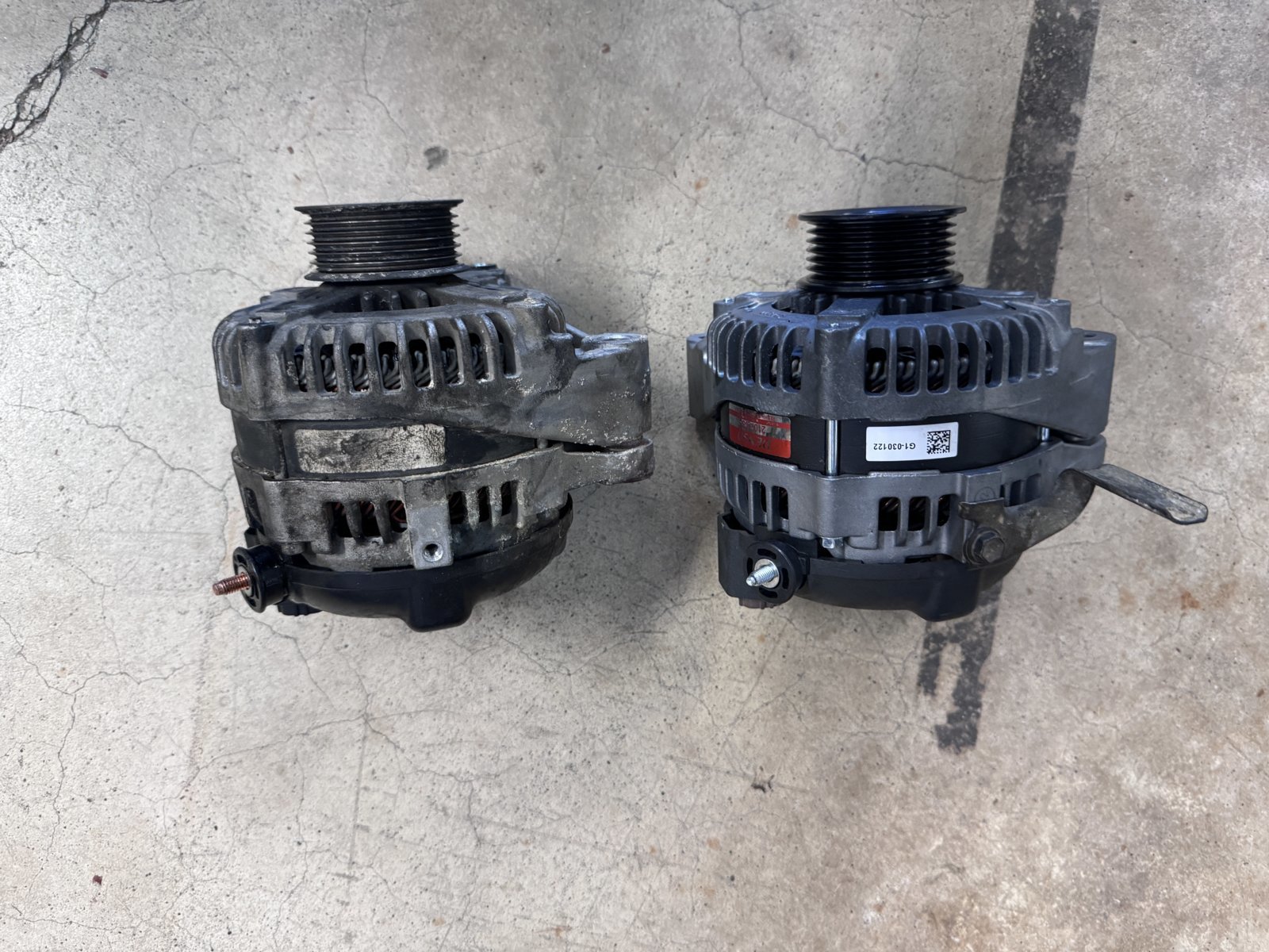

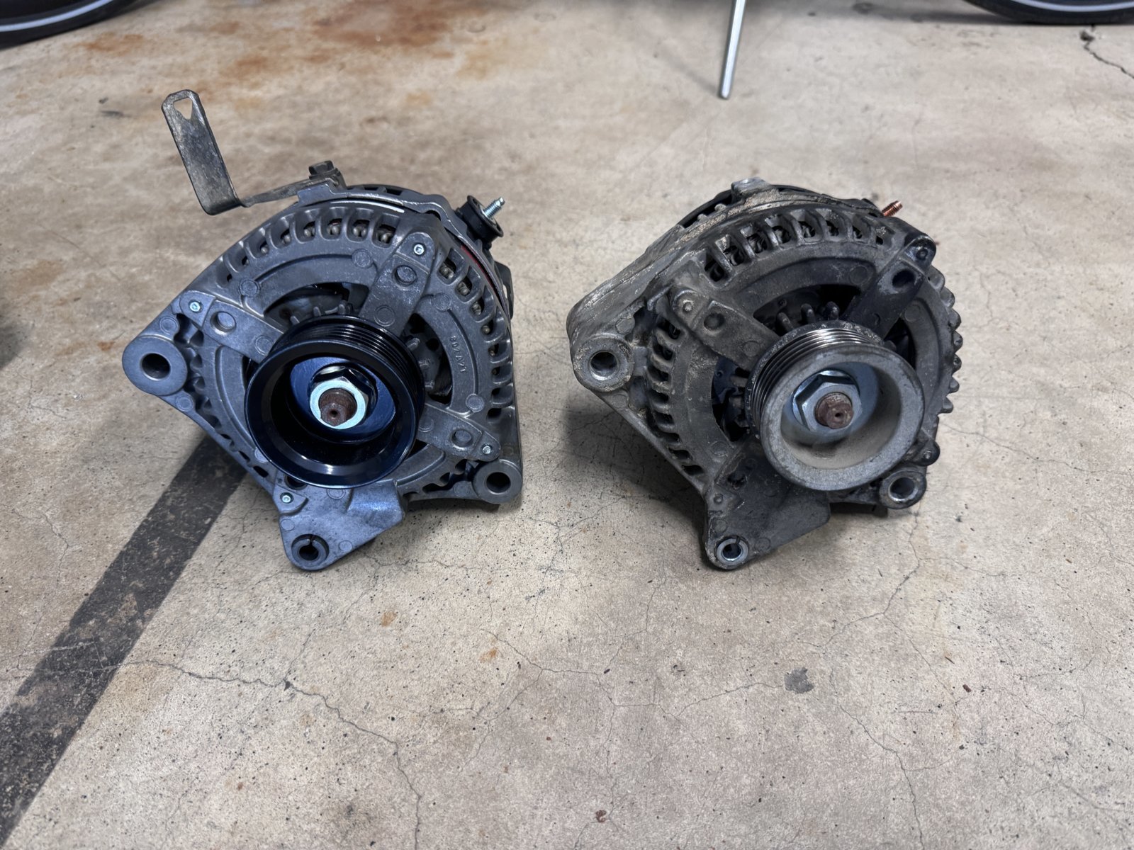

    Finally got around to replacing a few things. Started with the alternator but wanted to replace the serp belt tensioner and idler pulley as they were making noise. Bought the alternator a while ago and went with the Denso 1065 which I think is the bigger one? I forget as it’s been many months and just sitting on my tool bench.
    Had to remove the left and center timing belt covers to get the tensioner off though. New tensioner pulley was quite a bit smaller for some reason but the part number checked out.

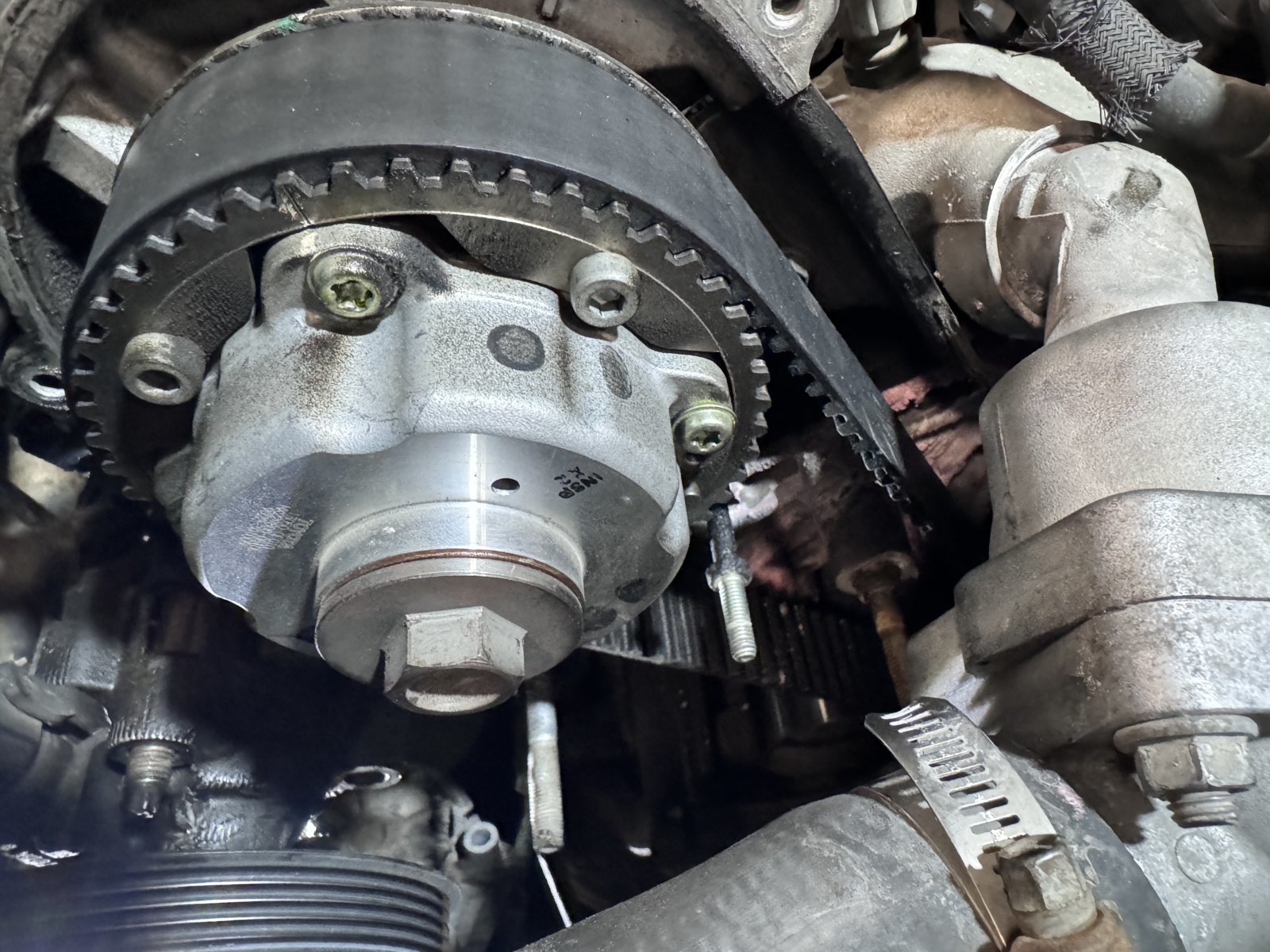

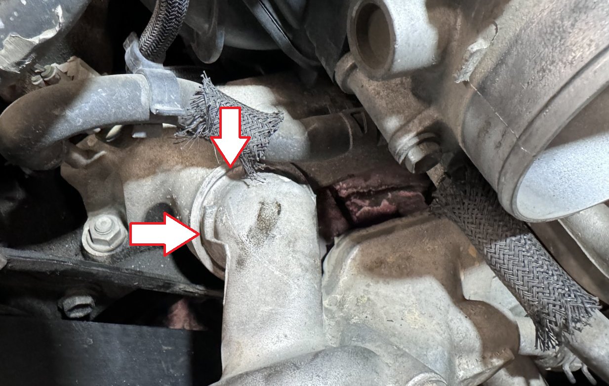

    Good news was the belt looked great but there was a coolant leak and I’m stupid and don’t know where it’s from.

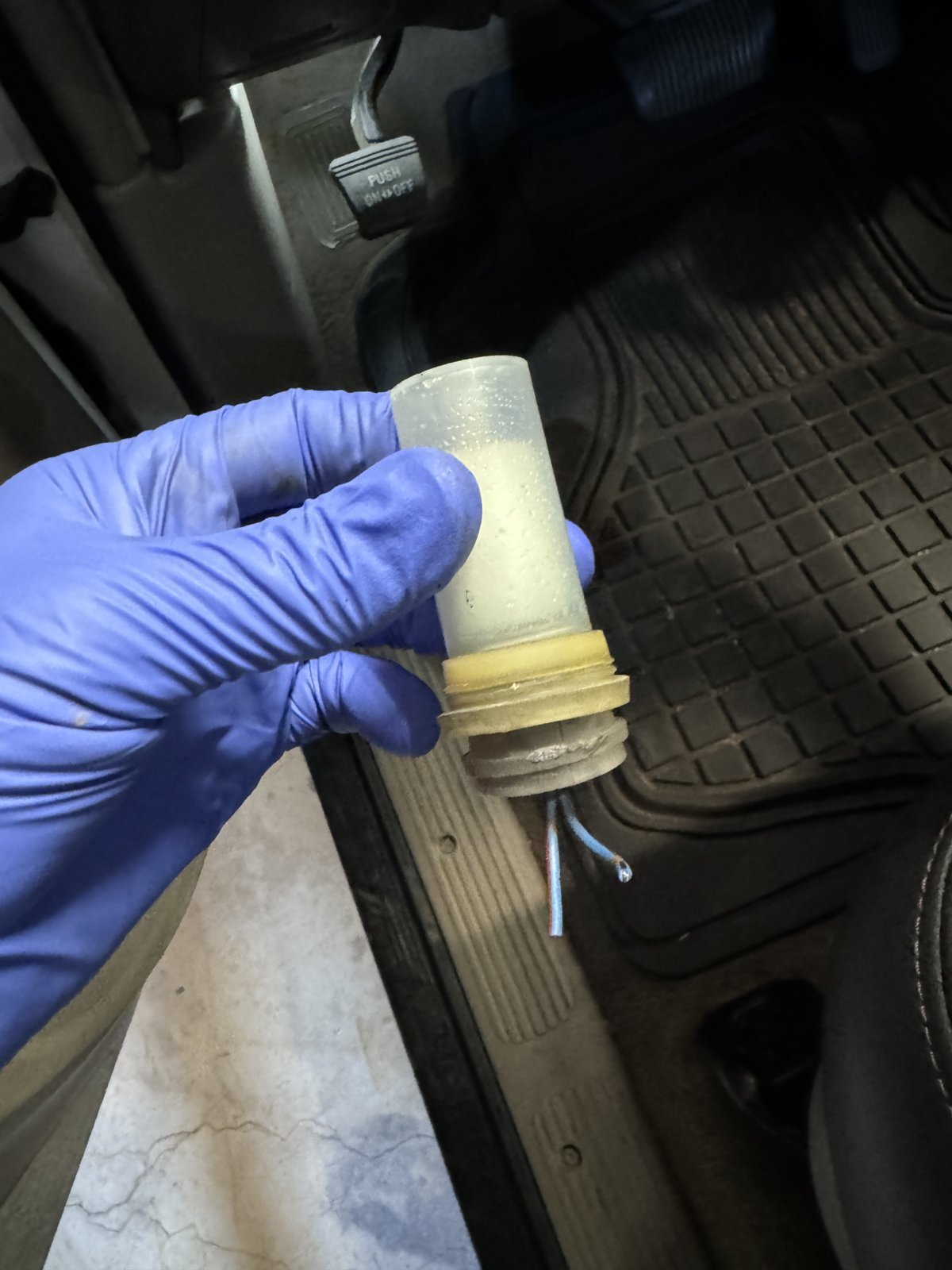

    I also got rid of my stupid washer fluid sensor dash light. A replacement sensor was $90-$120 so I just clipped the wires to the sensor and left them dangling. Light will never come on again.

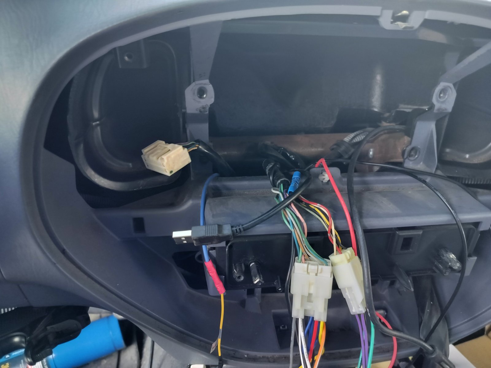

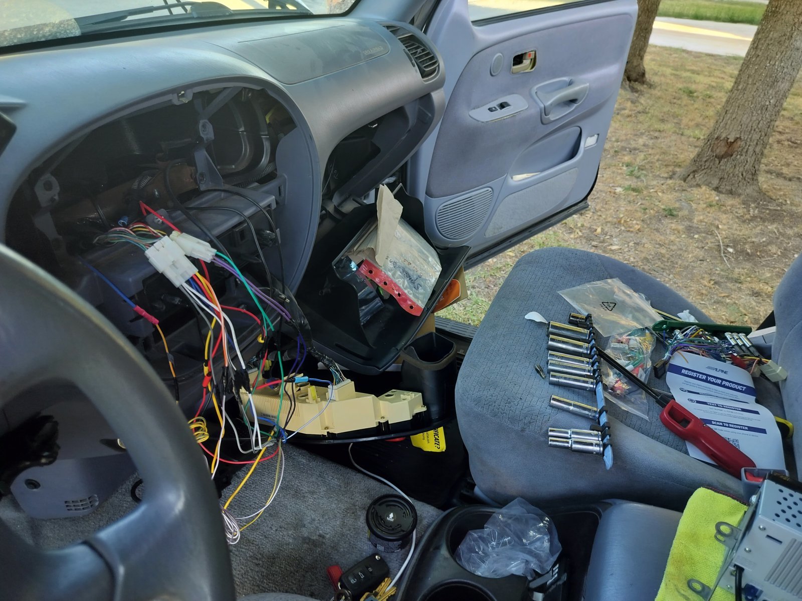

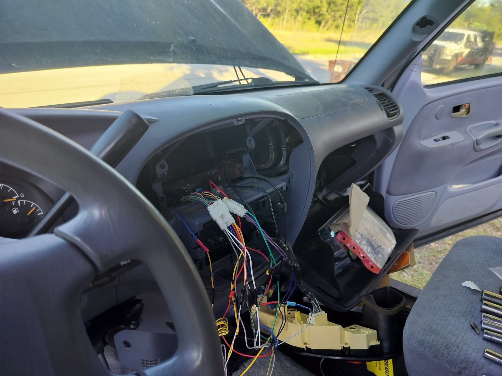

    Well it's been 2 hours but we're getting there. Pretty sure it's all wired correctly. Good thing I have fire extinguishers lol. But I know have non phone dependant GPS, which is nice. I got the antenna on the windshield in the 3rd pic
    Now I just have to figure out the back up camera wiring.
    Also I suck at/ hate electrical/ wiring work

    Electrical taped connections?! Tell me it ain't so!
    On the pulley: They updated the part to use a smaller pulley which is off-center just enough so the right-hand edge of the pulley wheel is still catching the belt at the same way. If you're interested in the exhaustive explanation I can find it for you on here.
    On the leak, I was going to tell you it was the ring gasket or whatever that goes here, but then I noticed all of the pink cake over to the right, under the TB, and I'm wondering if it's not leaking at the throttle body passthru? See the mesh/hose the top arrow here is sitting in front of? IIRC, that comes up from the coolant neck to the left, then pushes hot coolant into the TB to the right of the arrow, then comes out the front of the TB and off to wherever. Can you shoot another pic up under the TB to see where the pink settles? I have no doubt someone else on here will know where the leak is.

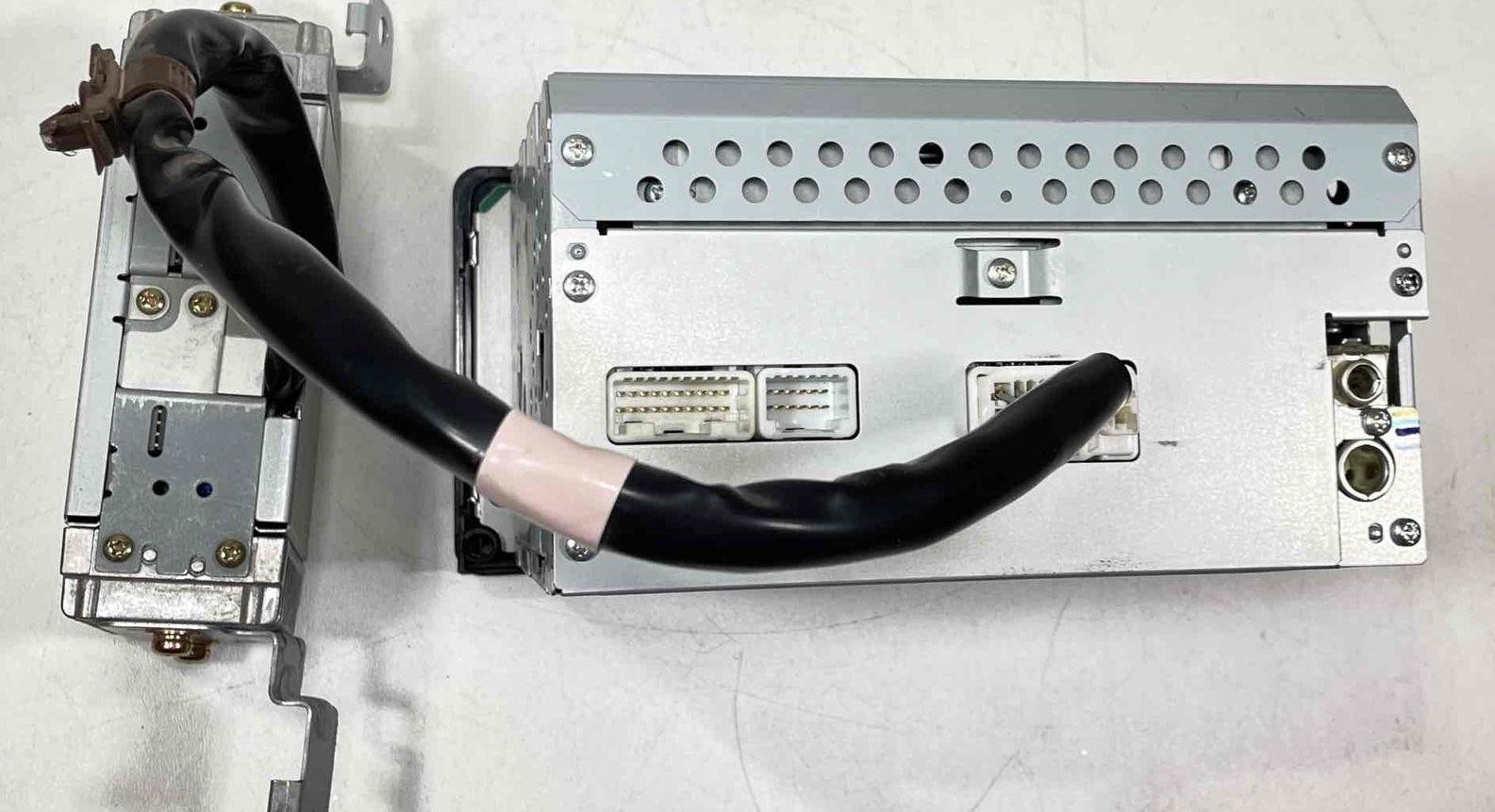

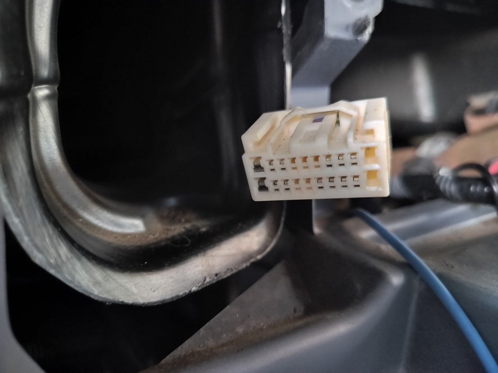

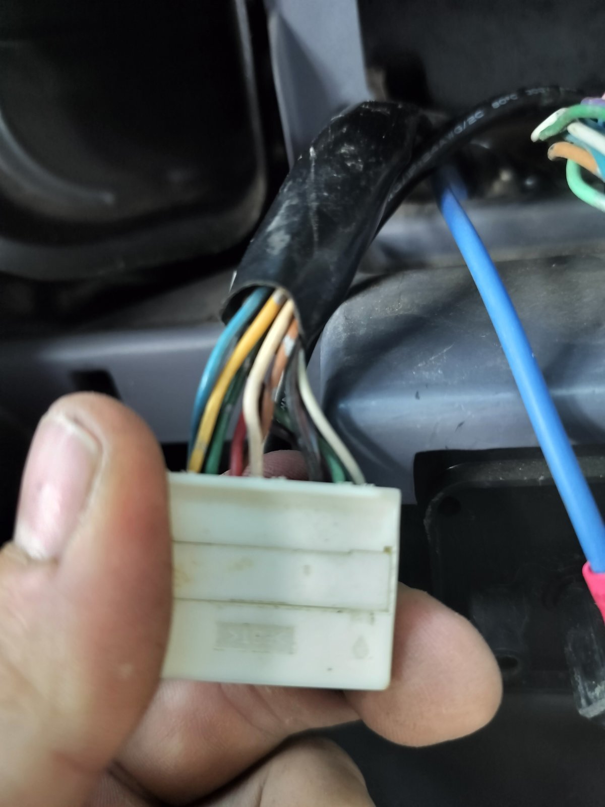

    Anyone know what this plug is for? I found it tucked down in the way back of my console area

    External amp connector? Dunno, can’t tell you offhand.

    Need to see the wire colors.

    It temporary I gotta make sure it's all hooked up right. I'll dual crush end them once I know what needs fixed. Lol.
    As bad as I am at this shit now, in high school I was thee guy to see about these things. Built volume to speaker matched boxes, amp and head installs. I could take a 12in and make it hit like a 15.
    I used to be a no think wiz bang at that shit. Noooooow I'm like a Marine trying to explain the difference between the purple Crayola and the violet crayola

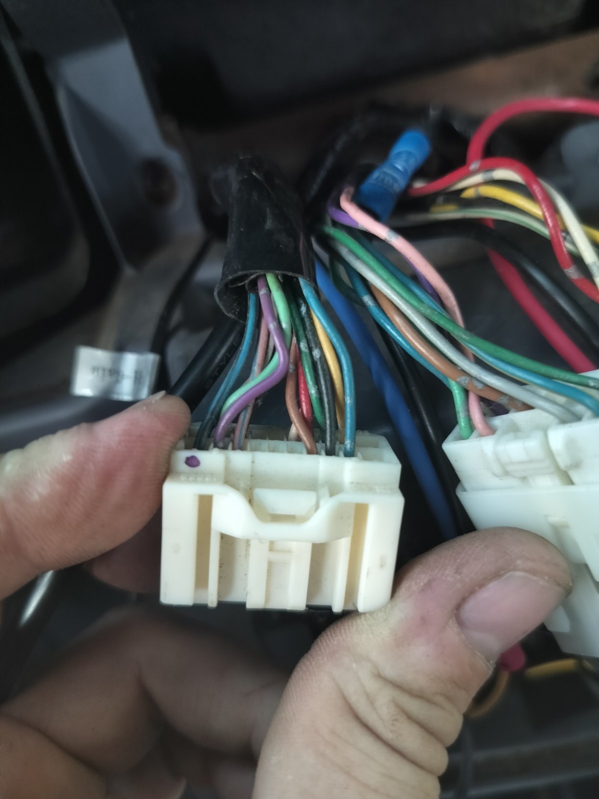

    I honestly have no clue. I honed in on the wire that appears to be pink with light blue stripe ("P-L" in the 2000 model EWD) and the only place I see that wire is used is with ignition coils and with the combo meter (gauge cluster) for speed. I don't see any 16-pin or 20-pin matching that connector at a once-over. I'm 10mins deep in it at this point, and I'm calling it quits. Gotta crash out soon.

    Also here's why I taped everything. I tested the dimmer switch, nothing happens. Tried the reverse camera, nothing happened. Turned the lights on, and the reverse camera came on.

    I figured they changed the pulley size with other modifications so thanks. That makes sense. Just scared me when I compared the two and had to double check part numbers.
    I guess I can pull the TB and see if it’s leaking from one of those spots. But it’s all put back together and I can’t get a decent picture now. I’ll tackle it another day. Still have u joints and a center bearing to mess with next weekend.

    Is your stock amp still behind the climate controls? It's like someone unplugged the amp to run the basic toyota harness but left the amp in there.

    You're correct. I was wondering about that myself because the light green and turqouise wiring were in that connector. I swear I warned @VR6T about pulling the amp ahead of time, but maybe I got everyone but him.
    @VR6T first off, illumination lead doesn't work, IIRC. And you have an unused piece of dead hardware (OEM amp) still in your dash. It's the thing on the left in this pic. The two harnesses you used for your radio are normally plugged into the amp, shown on the left here. The extra harness is what goes from your amp to the factory head unit. Yoink the factory amp from your dash. Pic of where the amp is located in the 2nd pic. 1st pic here shows the spare 3rd harness in your pic, plugged into an OEM radio.

    I've had this experience with most radios but my touch screen Sony unit in the truck works just fine with illumination wire and I have the same configuration.

    Ooh I bet that brown wire is the dimmer

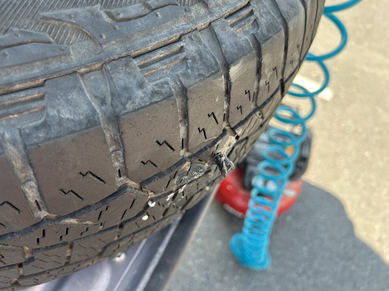

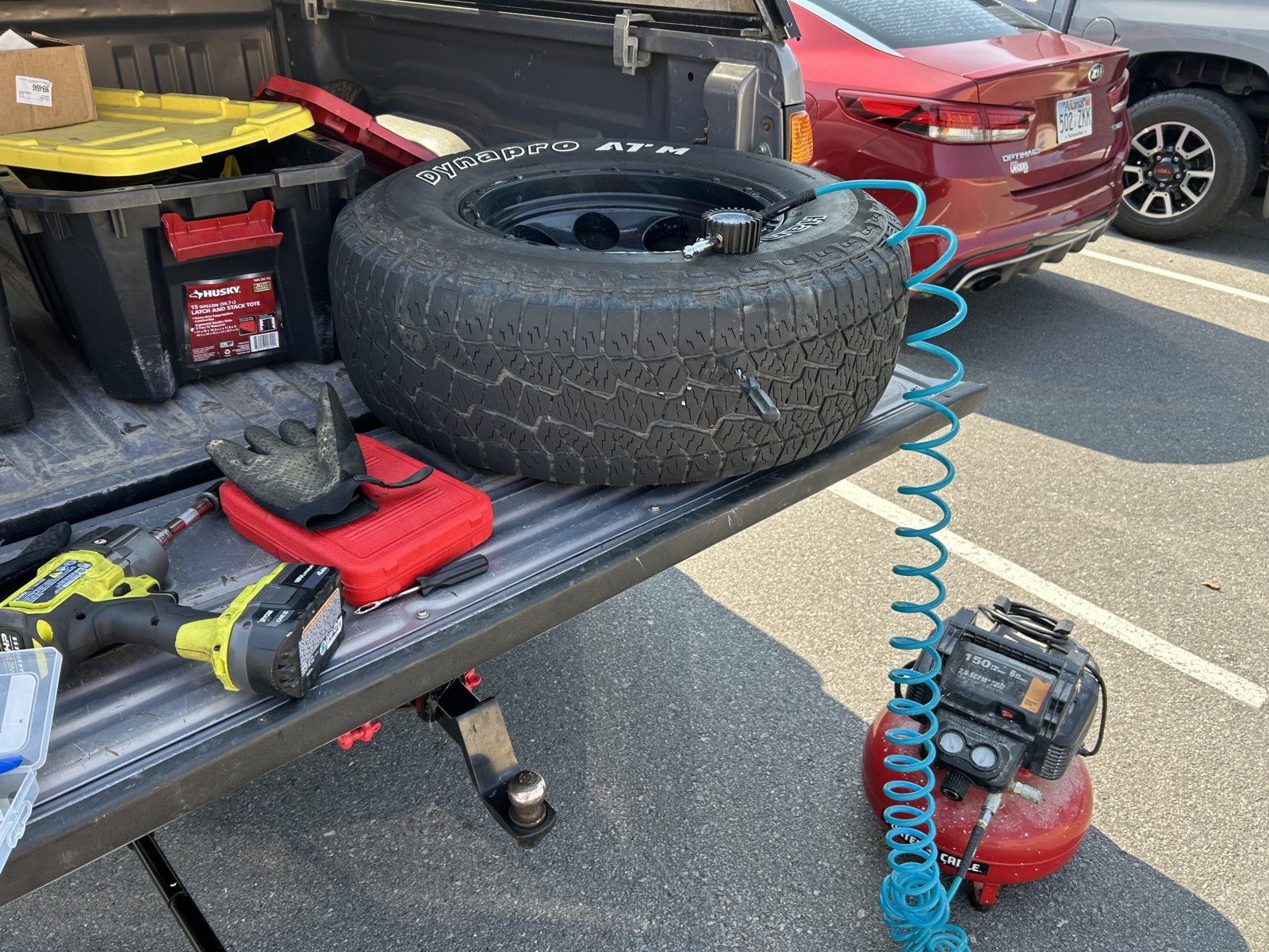

    Plugged. A little pissant piece of a nail
