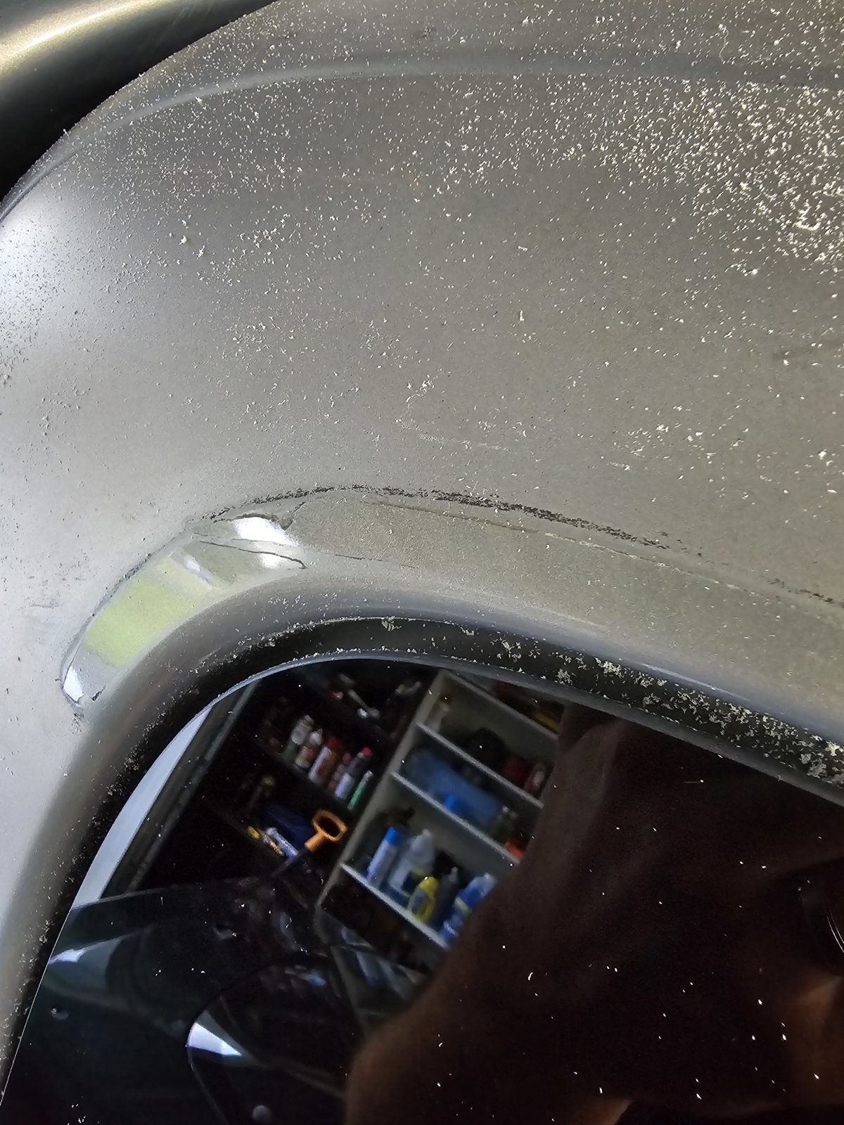

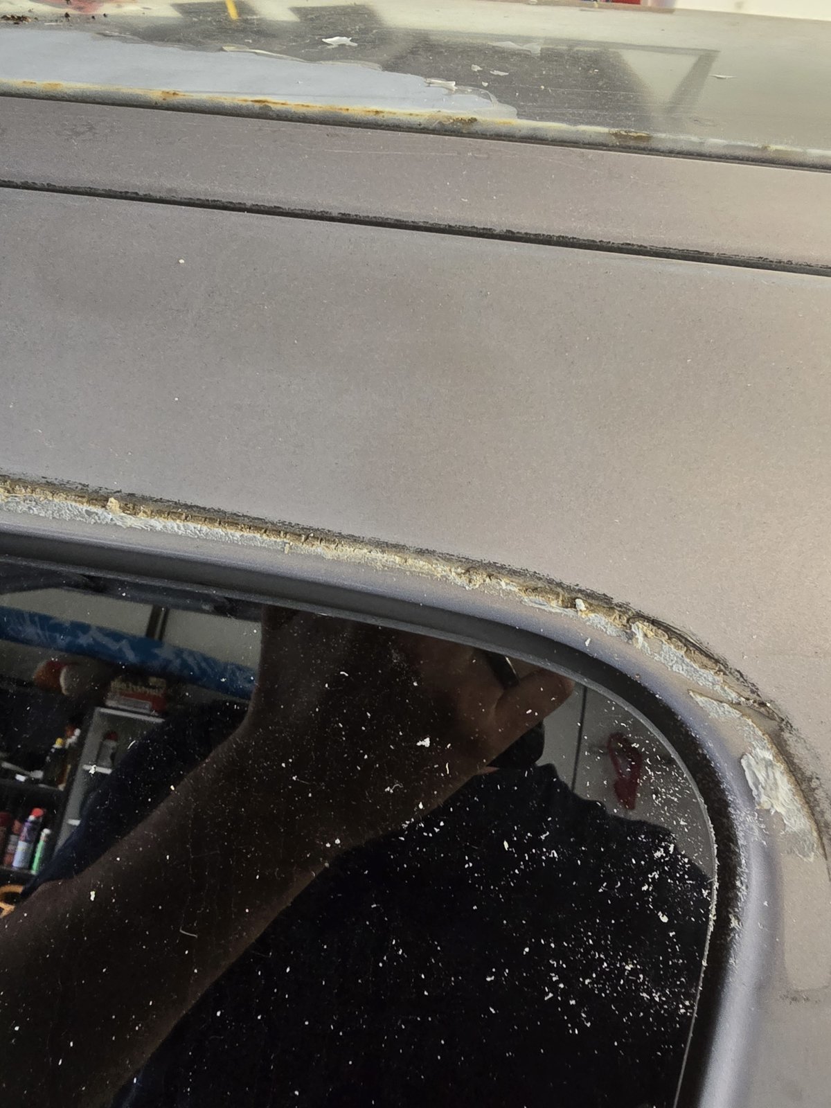

    Took a shot with the eraser wheel at removing the adhesive from my window guards. It did pretty good removing it but my passenger side doors don't have any clearcoat at the tops of them so it looks a bit off as the clear coat was still under the window guards but it is what it is.
    I only did the back passenger door so far. I know you all are gonna tell me to buff it/wax it and all that and it probably would look better but in all honesty I've never buffed or waxed anything and don't currently have the equipment to do so. I'll probably just roll with it for the time being and see how the rest of them look after I remove them and go from there.

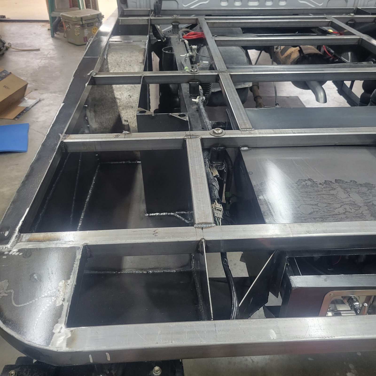

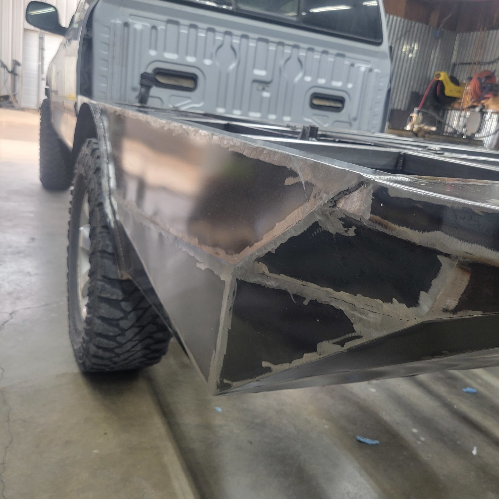

    I have the flatbed about 98% welded.
    I gave all the bare steel wipe down with Flood Penetrol FLD4 which gives everything a low luster and will keep things from rusting at least temporarily. The Penetrol is mostly linseed oil, but it has some added drying agents. Burns off well for any welding in the future, and in my experience does not cause any significant weld contamination.
    This photo you can just see the "skinny puppy" look where the welding has distorted the panels. Comes with the territory. A guy could do some hammer and dolly planishing work to mostly eliminate this.

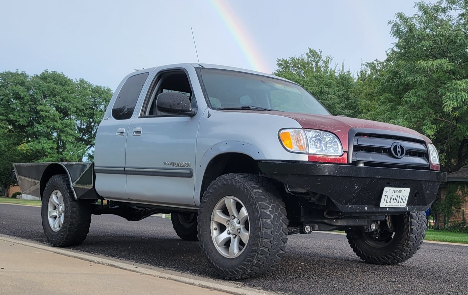

    Killer stance IMO. I should throw the front skid plate back on today. I left it off for my alignment guy a few weeks ago.
    Looking forward to getting the camper back on it and seeing the overall look for the first time.

    Great work man, really inspiring me to build a flatbed for my truck someday. Couple questions:
    What made you decide on the height above the frame that you went with. Clearance of tires?
    And the bed bolts. Did you need to buy longer ones or you had enough extra length to still have them get enough thread into the frame with the stock ones? Thanks!

    Thanks oscardog!
    The height is indeed set by how much tire clearance I wanted. I think this is as low as a guy could go due to where and how the oem mounts are placed on the frame.
    The factory bolts have enough thread engagement, but just barely. It is on my list to swap those at some point before the rig starts seeing a lot of miles. Alternatively I may recess the heads into the tubes for the extra 6mm that id like. As a bonus the deck would be completely flat without the bolt heads sticking up.

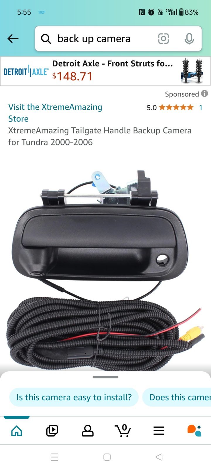

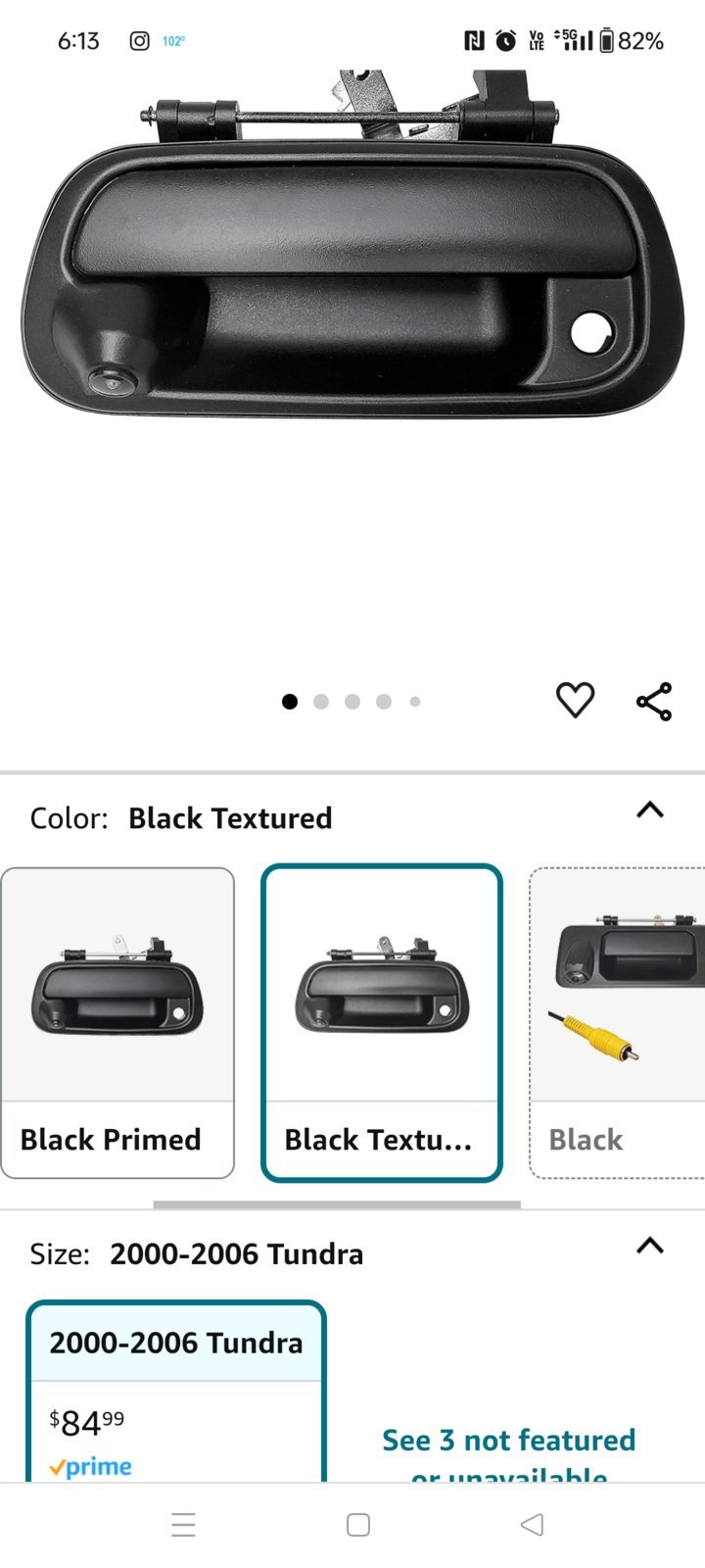

    Has anyone used one of these. I need to replace my license plate mounted one.
    How do you like it?
    How does it fit up?
    Does your tailgate latch still work?
    Which one did you use?

    It’s a ripoff (probably directly, malicious) of the Master Tailgaters camera latch which many have used on here. I’d prefer theirs but …

    Bro it's right there in the name, it's both extreme AND amazing! I have the MasterTailgaters one and it's been flawless.

    So look up the Master Tailgaters version got it

    This one of the black metal for 109?

    I've got one on the black truck. Not sure if it's the same brand. But I love it. Everything works great. Install wasn't too bad.
