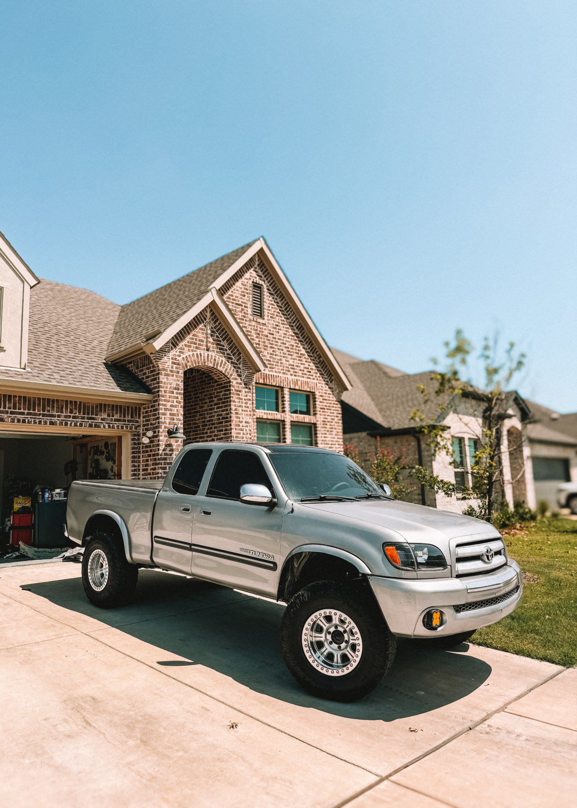

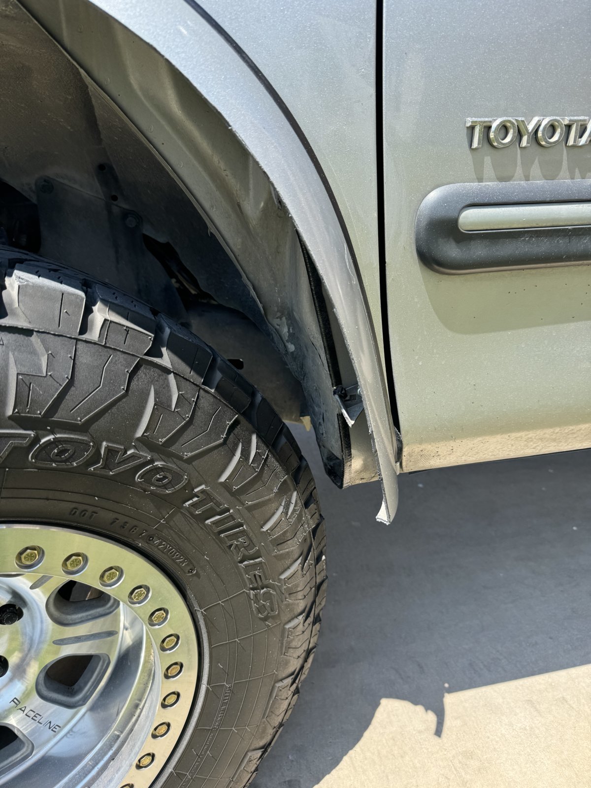

    305/70, but the killer is the -32 offset. I haven’t made it that far but most likely will cut it and cover up washer fluid reservoir.

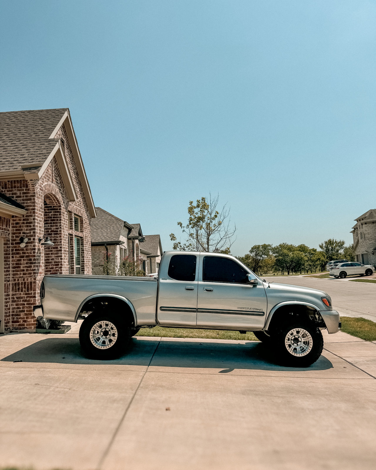

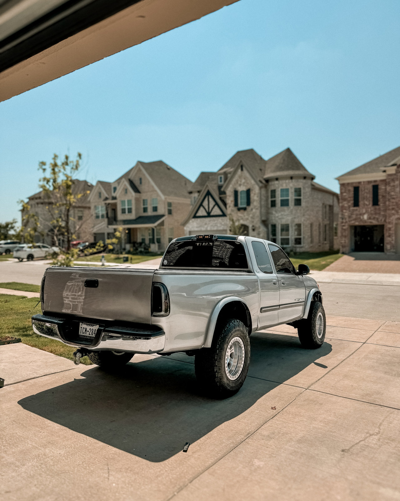

    Alright here's the completed pictures. I had to edit them so y'all could clearly see the wheel wells. Makes the truck look like it's sitting really tall, but now the tires look small haha. Without question I can clear all corners at the body. The rears could easily clear 35's, but even with pinch weld and a sledgehammer theres no way to clear it up front. I still have plenty of life left in the tires so we'll see how big I can get away with once I decide to pull the trigger on the long travel kit.
    EDIT: Don't kill me for using zip ties on the fender flares. The orange and blue clips looked terrible and although I don't like it the zip ties are sturdy and significantly more discreet.

    Damn, make me wanna take a cut off wheel to my truck this weekend lol

    That looks so sick dude, nice work!:thumbsup:

    Thanks! I'm really someone who shouldn't cut or paint anything, but for doing it myself I'm even impressed haha

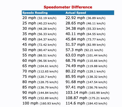

    Took my unc to his doctor's appointment today and got pulled over for speeding. Had the cruise set on 70, sheriffs deputy turned around on me and pulled me over. Clocked me at 75. He saw the larger tires and said that's what it was. Sure enough after he let me off with a warning, I ran a GPS speed app on my phone and sure enough, truck speedometer showing 70, phone registers 75-76. Damn.

    Sounds about right. I think with 33s it’s 1mph for every 30mph. Or at least that’s what I’ve found.

    That's not bad. Use this link so you can reference your actual speed vs speedo reading. I've got a 14% difference so I have to watch myself all the time when cruising on the highway.
    https://www.tacomaworld.com/tirecalc?tires=305-70r17-35-12.5r17

    Looks sweet! I’m a sucker for polish wheels
