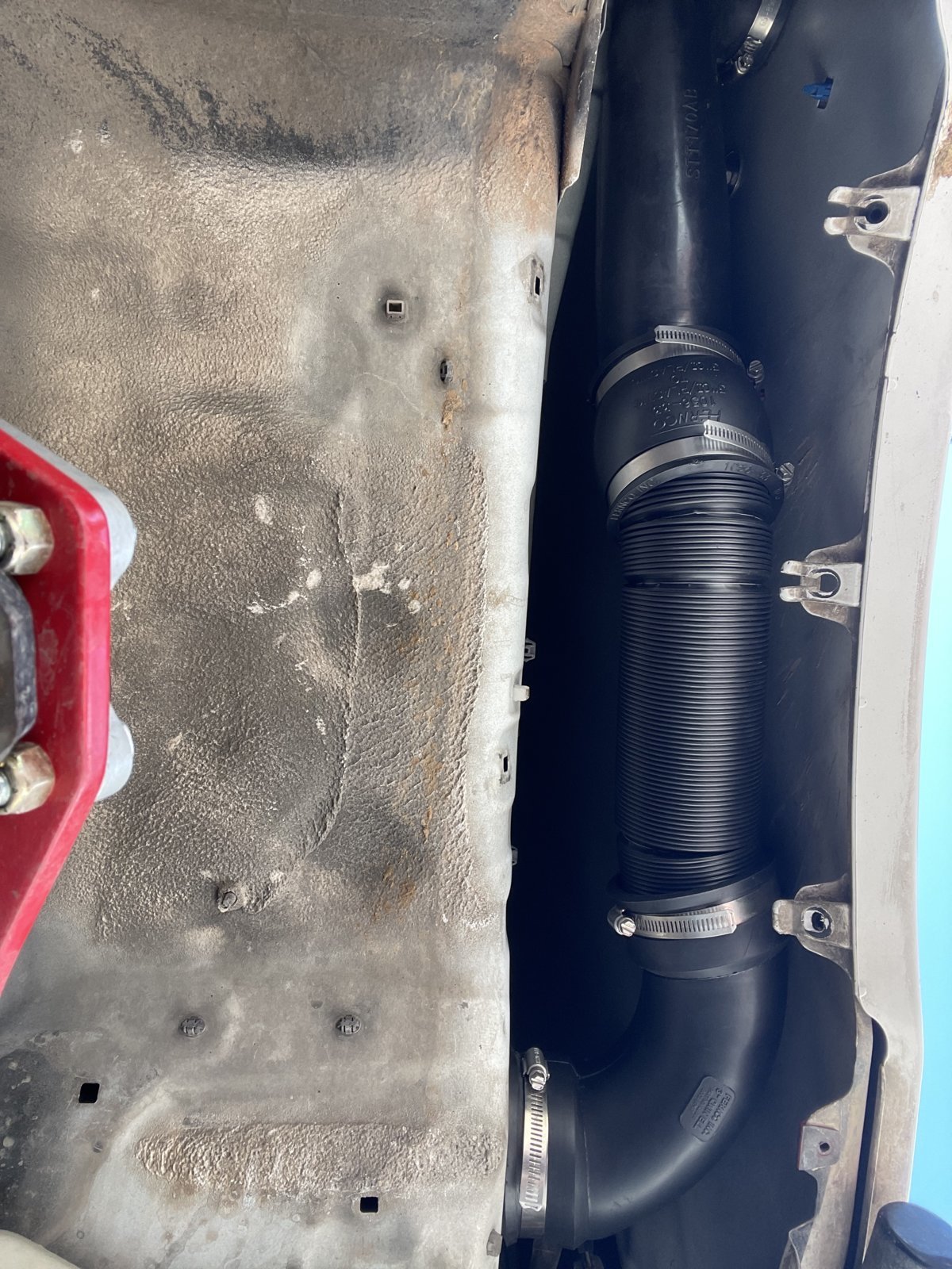

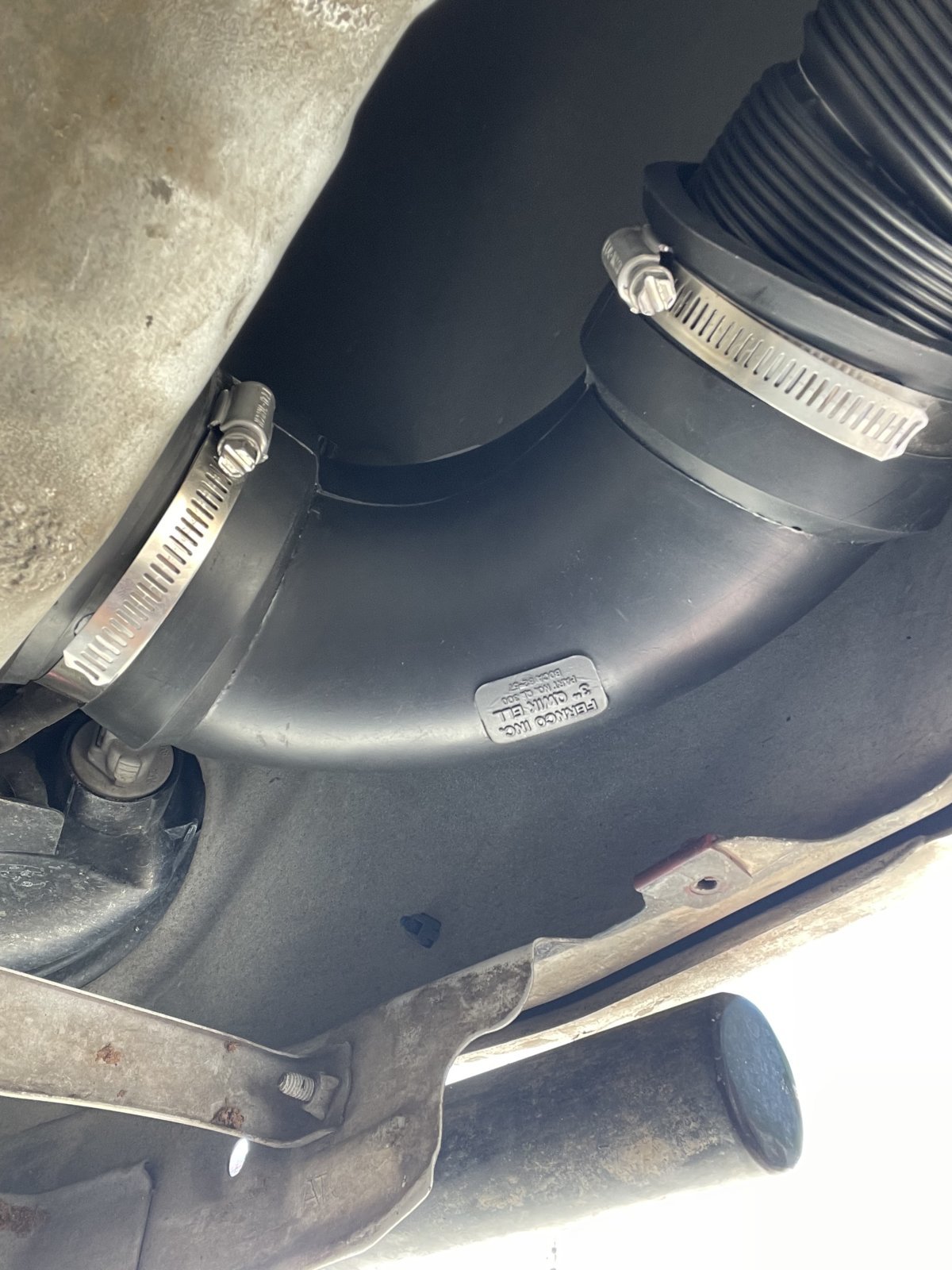

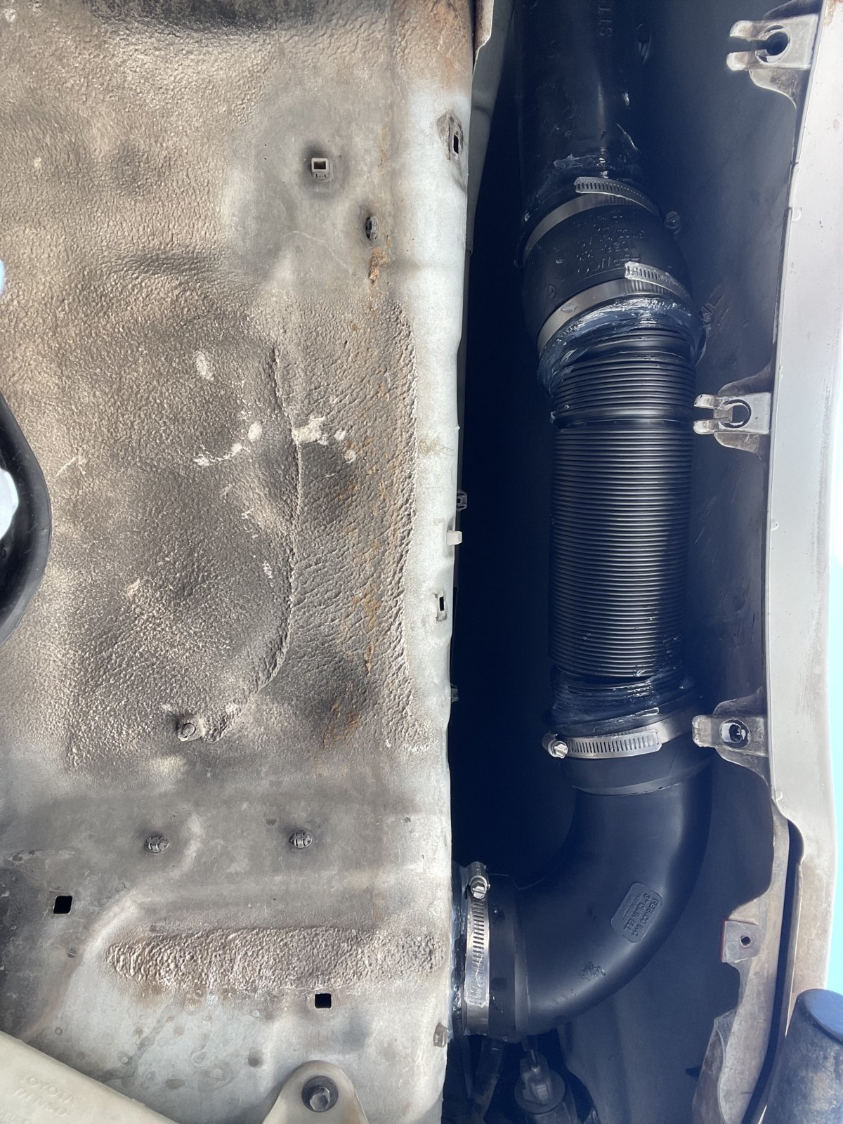

    Installed the 3rd 4r/ 1st gen taco snorkel. Took a lot longer than I anticipated. I had to heat it up to clear the passenger door. I’m sure my measurements were a little off.
    I used 3”x3”elbow for stock intake to 3” flex tubing to 3” flex coupling to snorkel adapter tube. Sealed everything with clear outdoor sealant.
    I only went with the snorkel due to having tube bumper leaving the stock intake exposed to the elements.

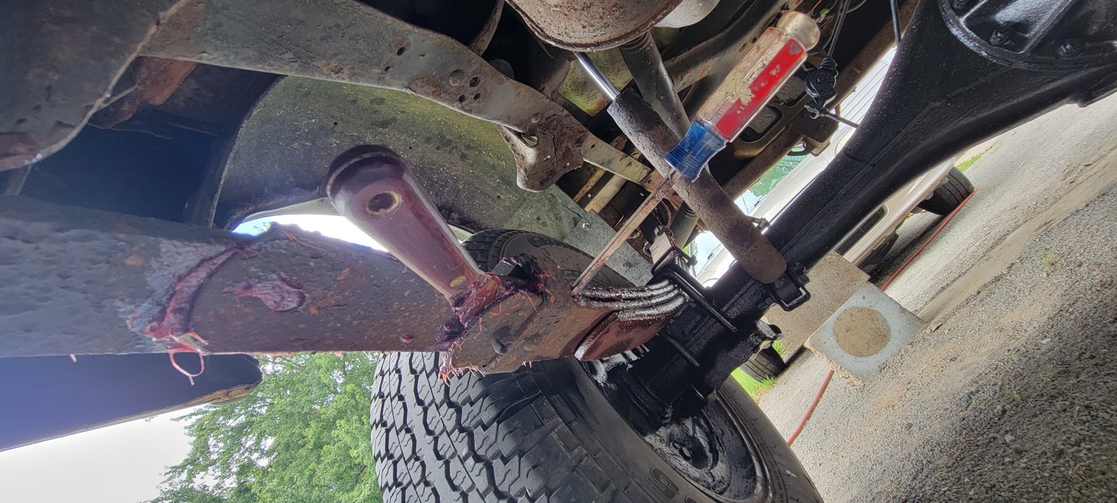

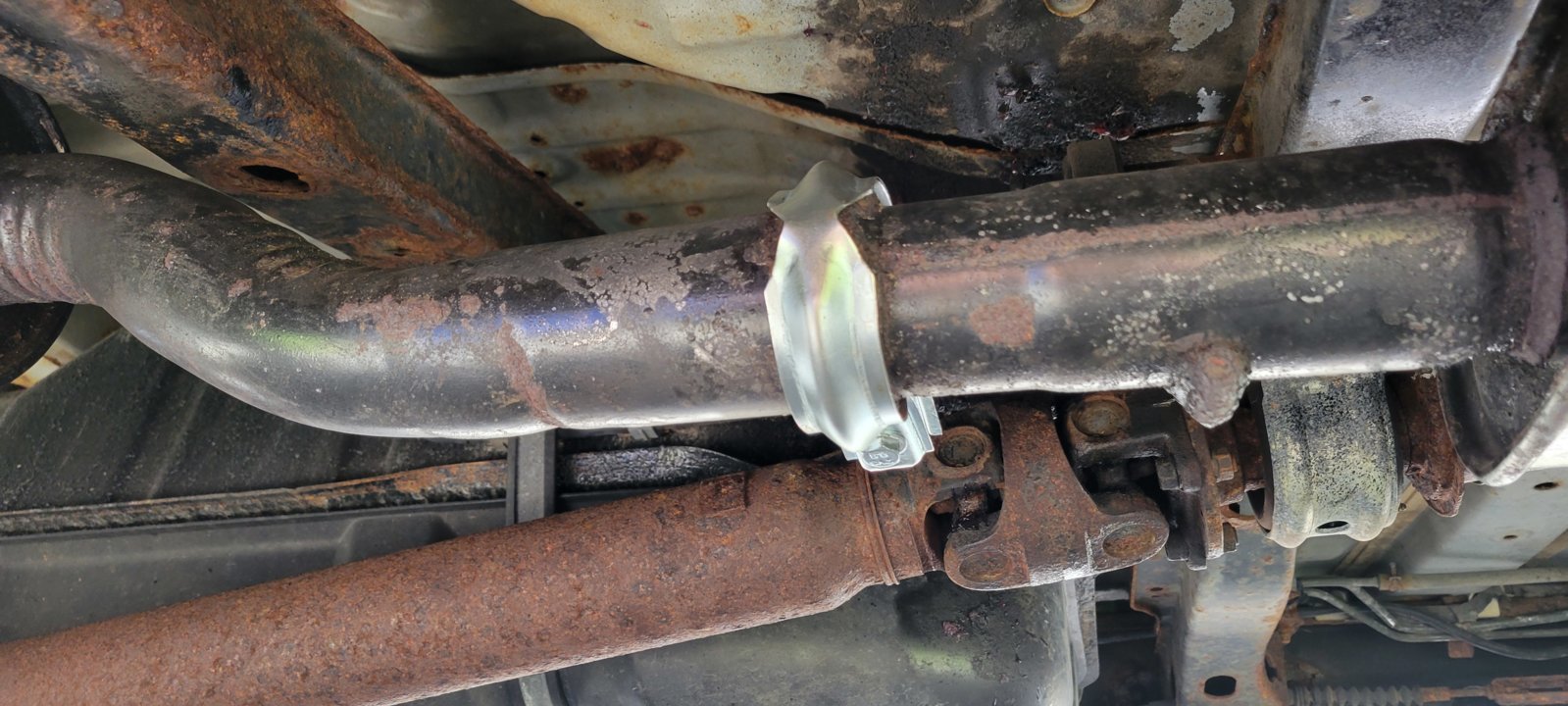

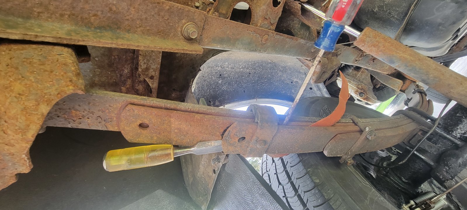

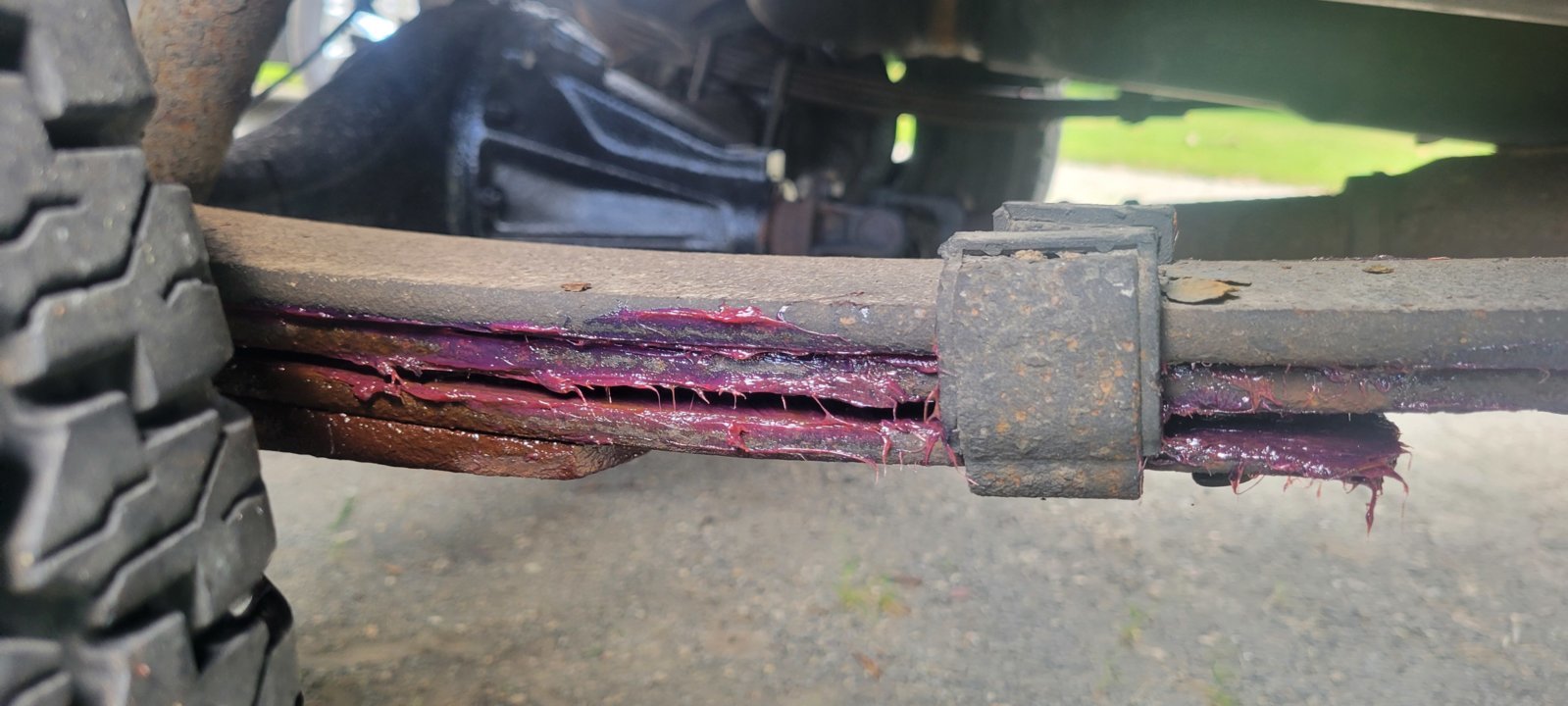

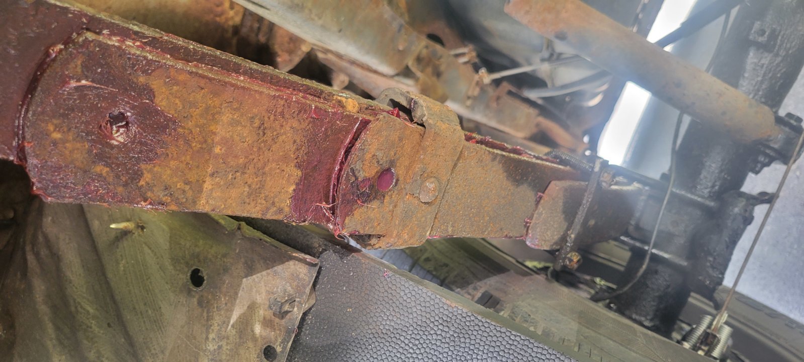

    Just a follow up. With a couple commutes and several instances where I would always hear the clunk... it's quiet. I'm calling it a win.
    Weirdest thing because your ass in the seat/ears/hands on the wheel detectors tell you it's up front, or at least under you.
    Like front susp, or trans mount or cross member, or even engine mounts. And with a truck that's been in an accident like mine, it could be body mounts or panels... who knows.
    If this stops working I will attempt the skid button tip wear pad anti squeak install.

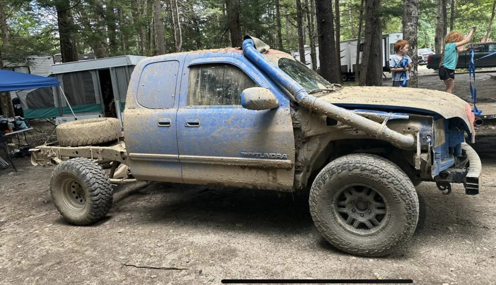

    The final boss of snorcklery.

    What color..... Periwinkle, with red accents!, said no one.
    Also, still a little cooler than my jalopy:rofl:

    was this during the flood of '23?

    Yeah I like to poke fun. I'm not immune to doing things to my truck just cause they look cool.
    I just did a river crossing this last weekend that without a doubt submerged my axles. Not uncommon, and not for long enough that I'm concerned about differentials.

    I love that truck lol anything with that much character and 100% see's max usage is dope

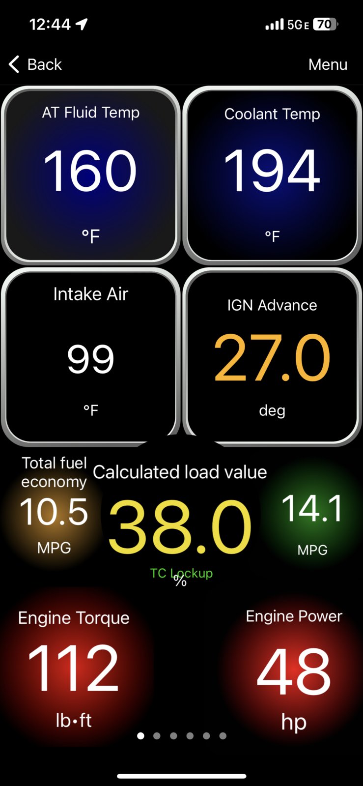

    Got my OBD2 reader hooked up and downloaded the PID pack for $14.99. Works great. Just gotta make a new dashboard as this is the old one from my other truck

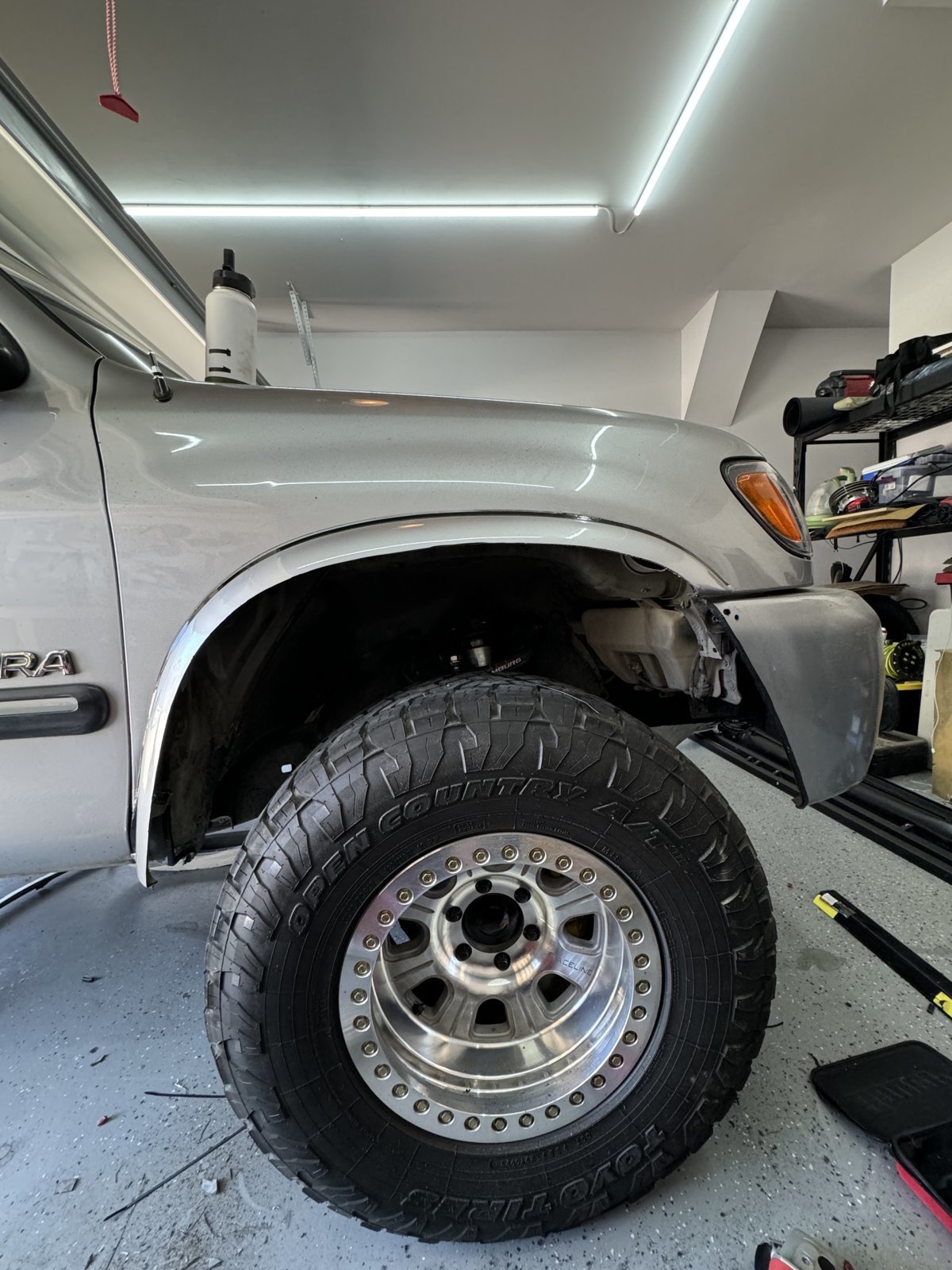

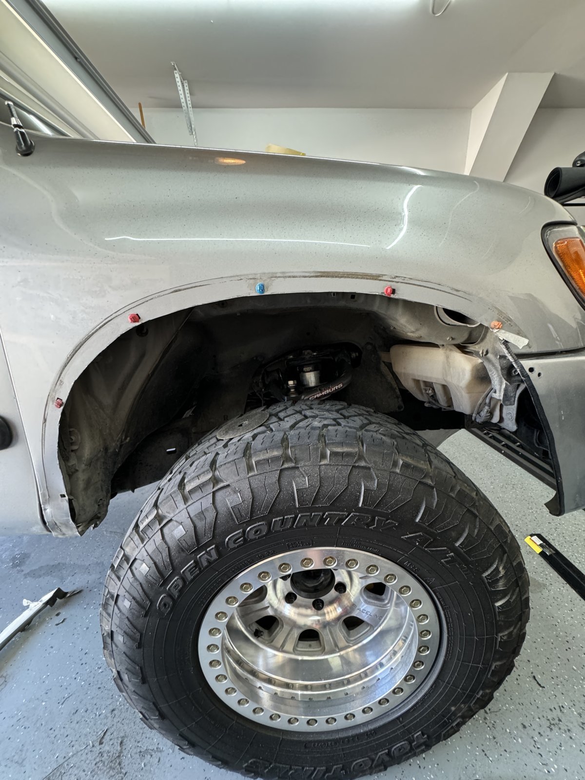

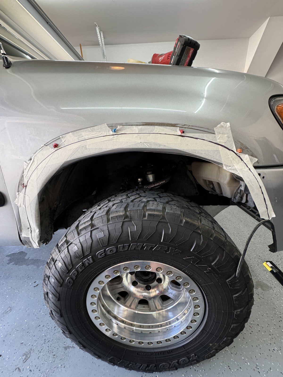

    One side down. Need to trim the drive side flare and should be good.

    That looks good man! What size are your tires again?
    Did you just remove the inner fender liner completely or cut it short and reattach?
