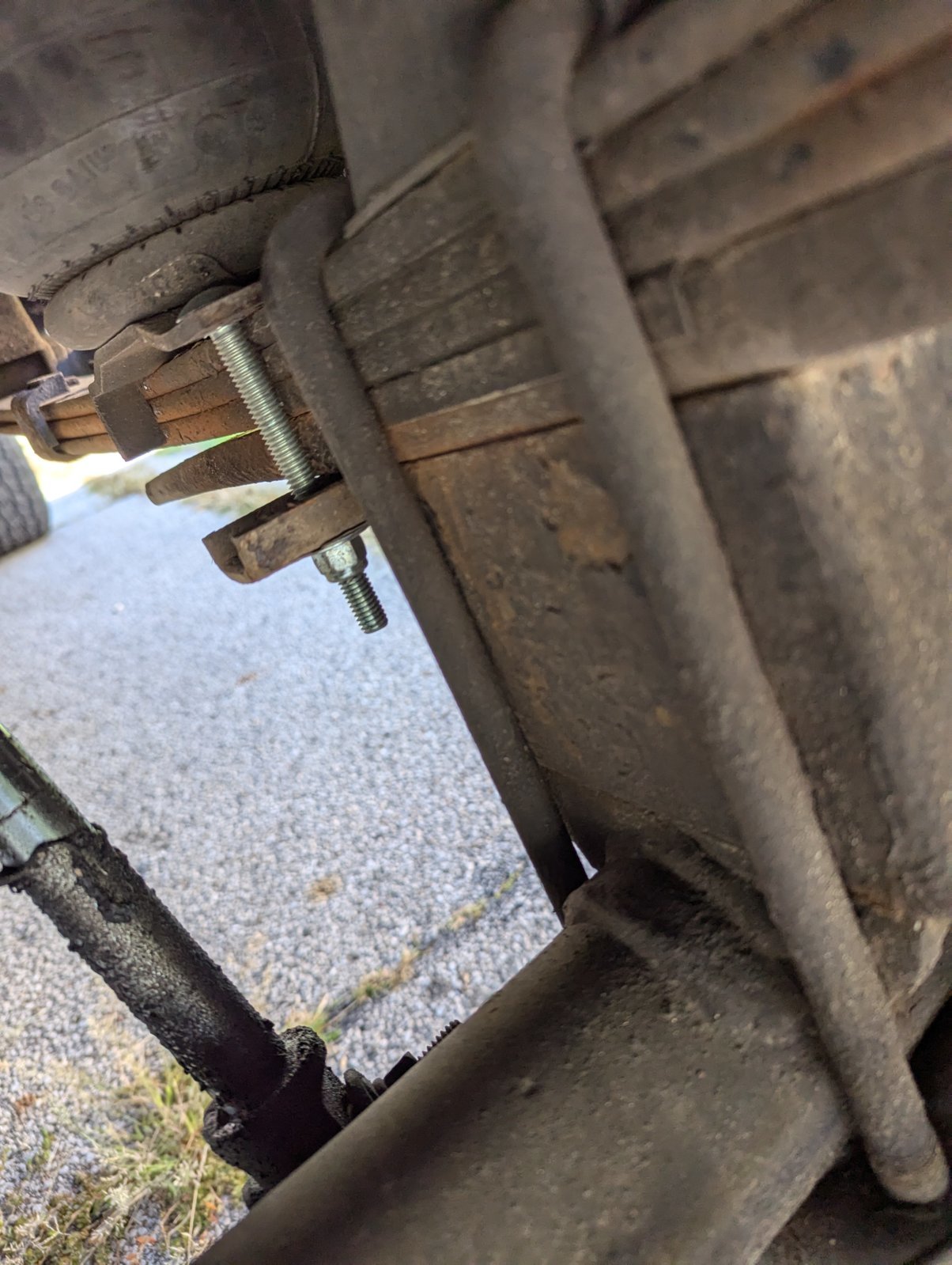

    Iron oxide weight reduction
    Hahaha, I know they are all missing, that one you see doesn't even qualify as present either.
    I don't think I can get enough room to slip them in there w/o braking the packs apart can I? Looks like the new ones are nealry 3/4 high.
    Take a look at the room I have, the OEM keeper wont even let me get that kind of room... maybe I can yank that rubber cushion out... gain 1/4-3/8"?
    That redneck clamp I made and put on there a while back because of the shifting I saw in that FAT bottom HD helper.:cool: I loosened it, but didn't want to loose what I gained putting it on.
    Which leads to cutting the U-bolts because they aren't coming loose, I tried with a LONG cheater until I figured I was going to snap one. So I'd be replacing them.
    I agree what you say is the correct way. What I factor in is the fused U-bolts, cost of new U-bolts, and ffs look at this thing :rofl:
    OH, and my shoulder is FKD up, I'm hurting from just doing what little I did today.:annoyed:
    Damn Dr.s went from "A small non-surgical rotator cuff tare" to "interstitial" tares and "Osteoarthritis" 5 months later when I recently started having issues again.

    You absolutely can, I’ve watched videos on YT showing people with an angled bar wedging under the tip enough to slide from the side. Dorman makes them. I’m fairly certain any LAPS should carry them, though they may not be marked as supporting our year. As long as the diameter of the nipple fits you’re good.

    I took that picture just for you. It looks even but similar to a motor when replacing brushes. All dirty n shit. It works perfectly. Easiest thing I've done on this truck minus removing bed

    Those are great, thanks :hattip:
    But I still don't think I have enough room.
    Notice in these vids they only have two leafs in between the OEM keeper, then look at mine... 3, and it's already almost touching as far as spreading them apart.
    I will def get under there and see how much room I can create though :thumbsup:

    wait, why is your overload curved? What sort of wizadry is that?

    Exactly... :rofl:
    I'm not mad at it (what the PO left me) I mean she can handle a crazy load.
    But It's a bastard step child pack no doubt.

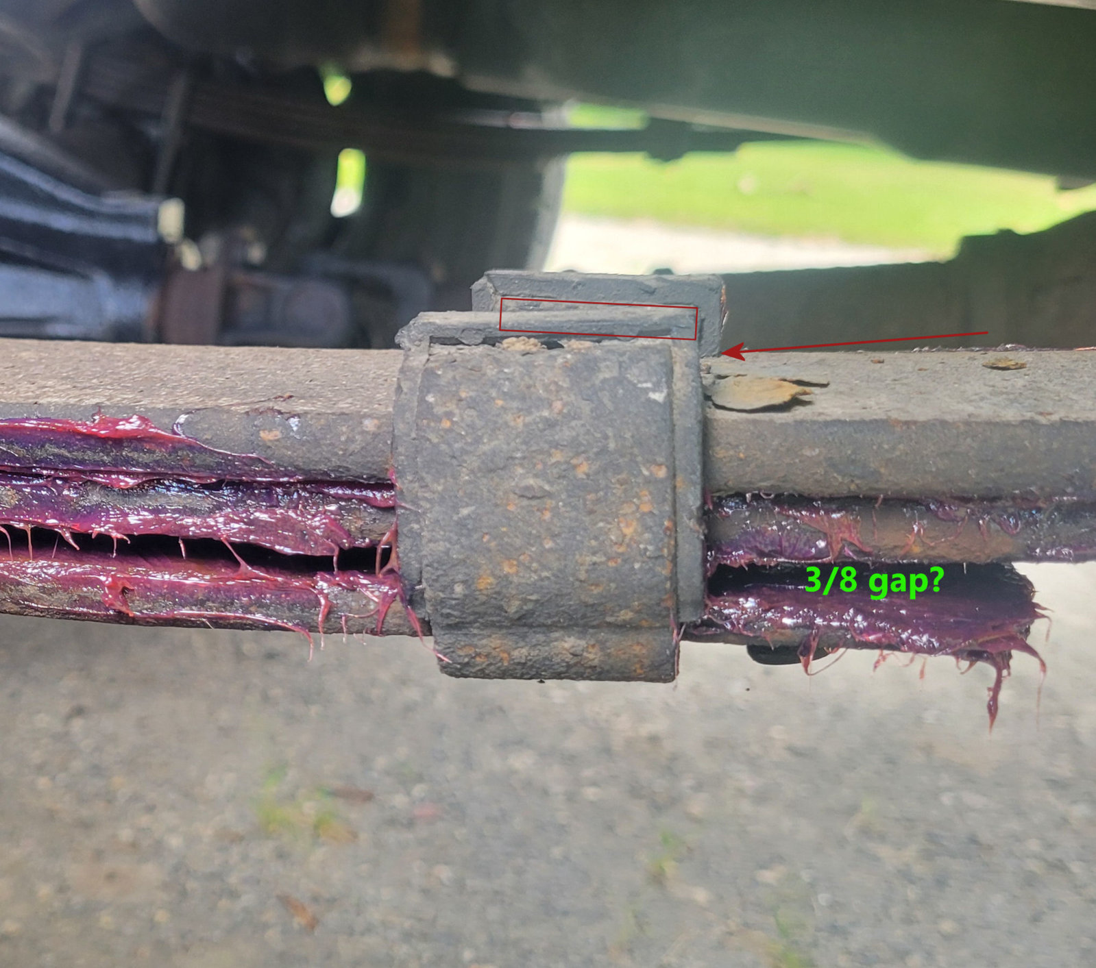

    There are a couple different types. Ones that have the tall flared base like yours, then ones that have a rubbed shank like this. The ones with the ribbed shank you can shave down on a bench grinder to get the clearance you need. I believe the ribs are supposed to be what holds them in.
    Shave it down to the height you need, and shove it in there. Note sometimes you can also open up that rebound clip (the steel C-clip) to get more space, then close it up using a large c-clamp. Your steel may be crusty because rust belt, but ... you can also grind the rivet, remove the rebound clip, and replace with an aftermarket rebound clip. If you have a full 12-pack already though, try shaving off some of the base using the flat side of a bench grinder wheel if you've got one (I think most of us do). Else maybe you have a belt sander or sanding wheel?
