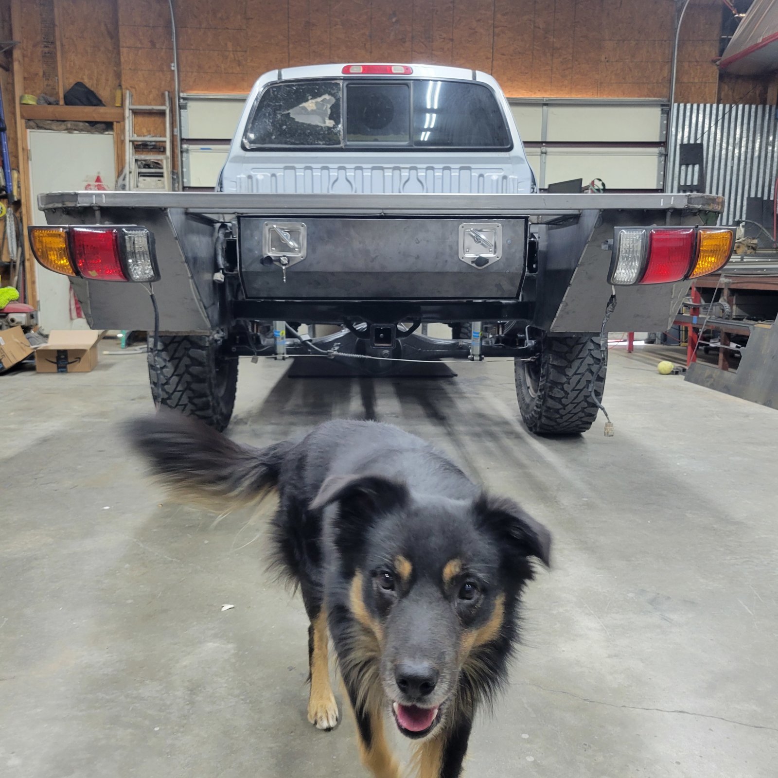

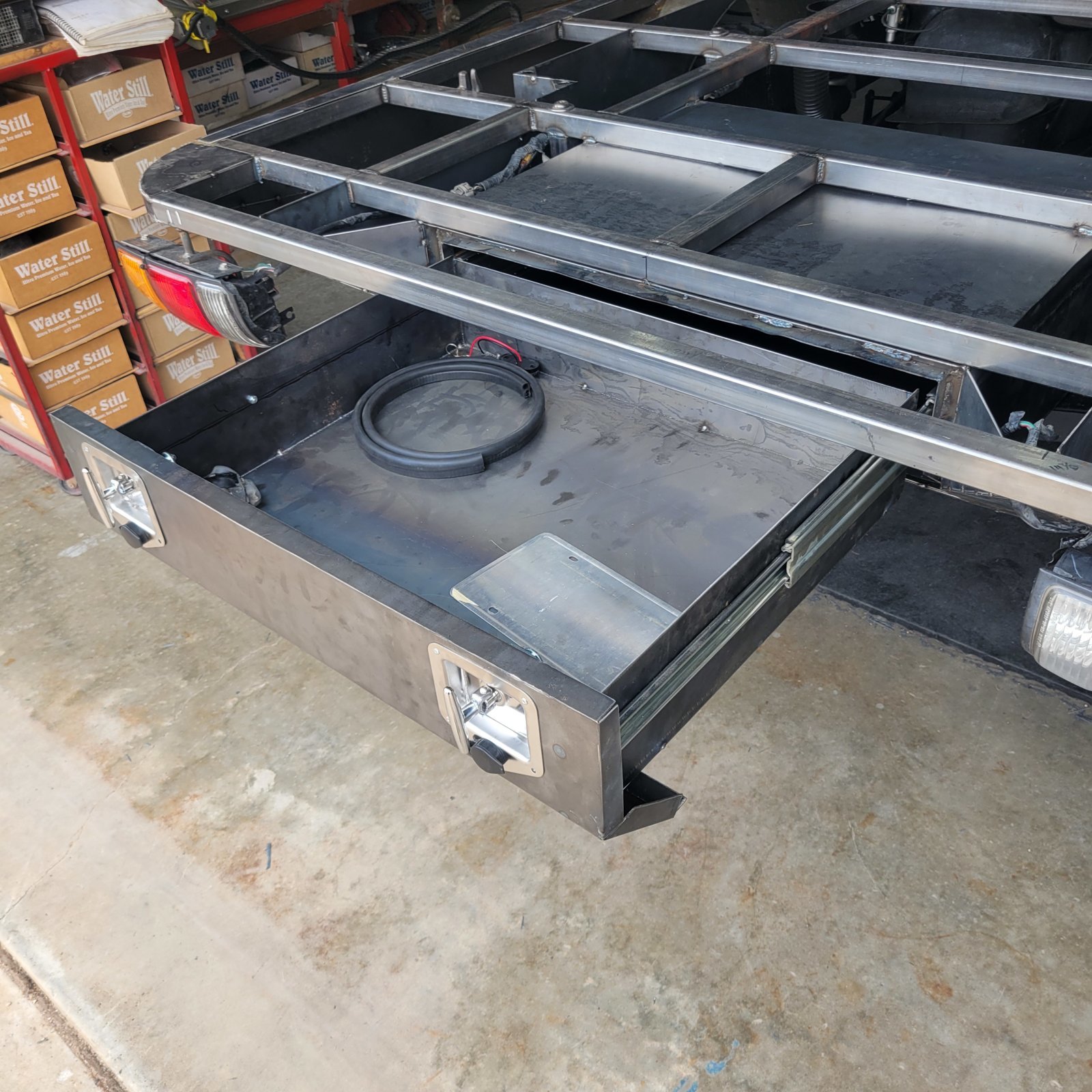

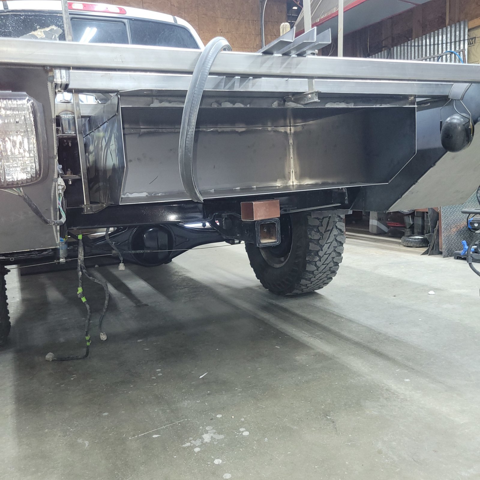

    This drawer has been kicking my ass all week.
    I think the worst of it is done and I can get some details dialed in tomorrow.

    Looks like you won the fight though! Looks great. Do you put a degree or 2 of angle on that for drainage?
    Looks like it's Dale approved ;) How can that face not make a dude smile hahaha :thumbsup:

    I didn't even think about drainage, park uphill:rofl:
    The drawer box has a channel all the way around it that gets a bulb seal, and there's some intentional geometry with the recessed door so any water has to make two 90 degree turns before the seal. Ill snag some pictures of all that for the build thread that I have been forgetting to update :thumbsup:

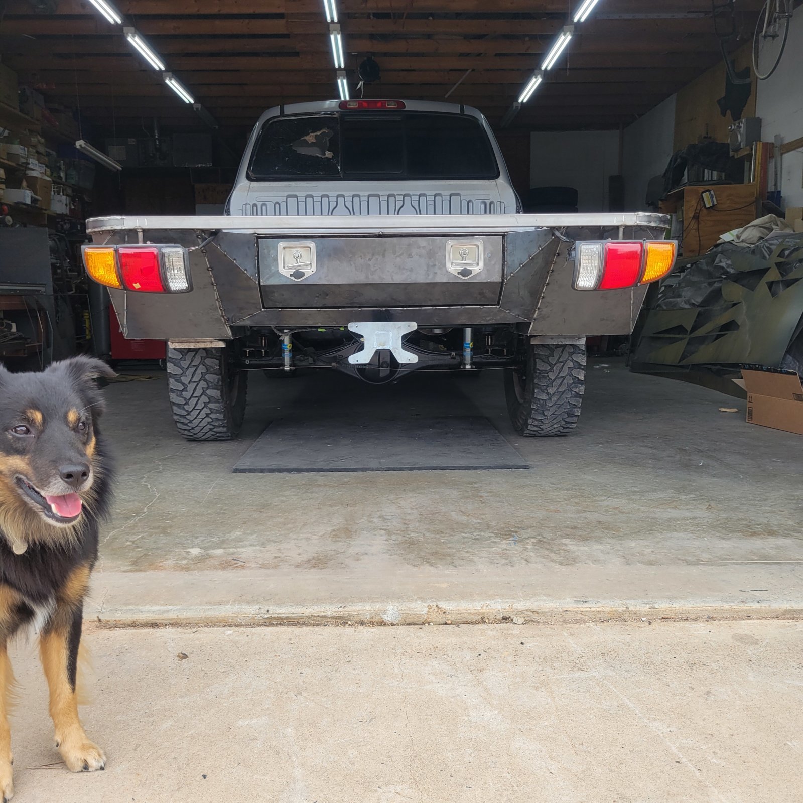

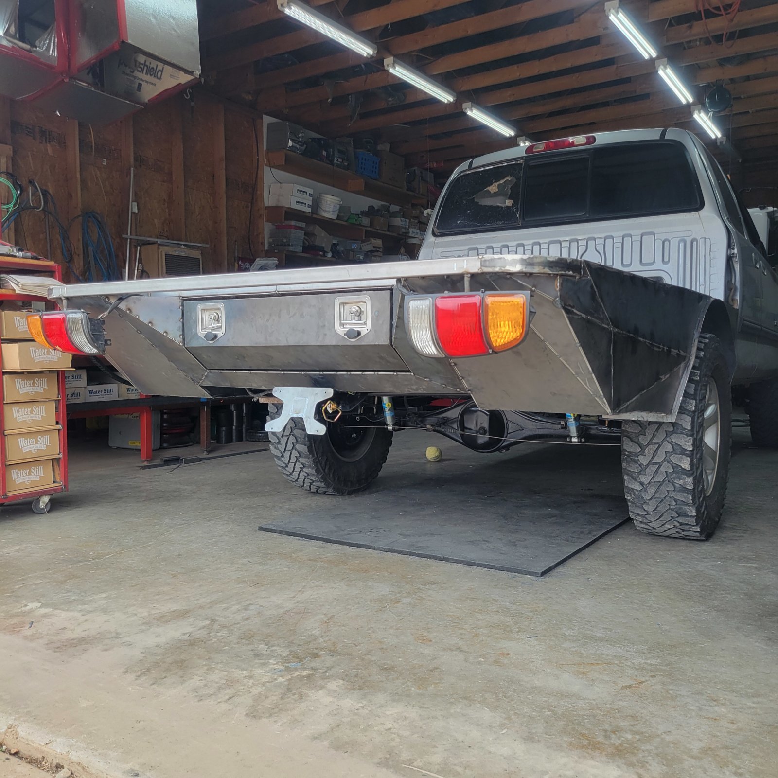

    Not quite how it it looked in my head, but I'm really digging it. It'll still see some changes as I continue to flesh things out and dial in the details.

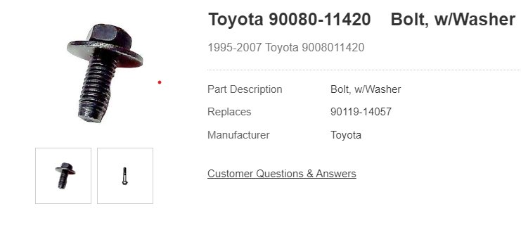

    Yes, that's the right part number. Just went through my receipts because I've ordered some.
    2x 90080-11420 Bolt with Washer
    2x 90179-14063 Nut

    This is so so hot
    Best becareful Jake those sleepy time pee pee touchers will come get ya and then ask for 10 bucks...... @bmf4069 :rofl::rofl:
