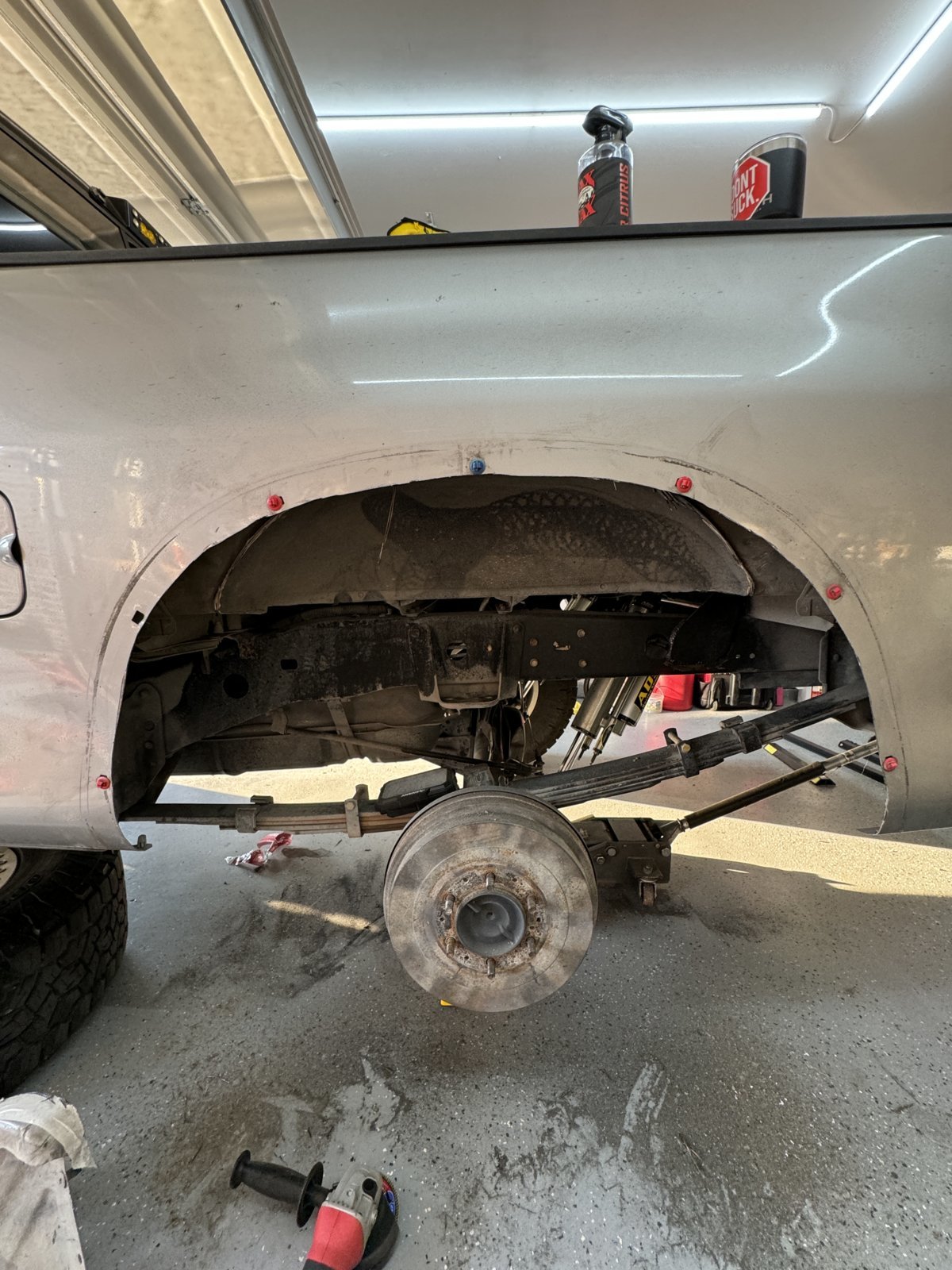

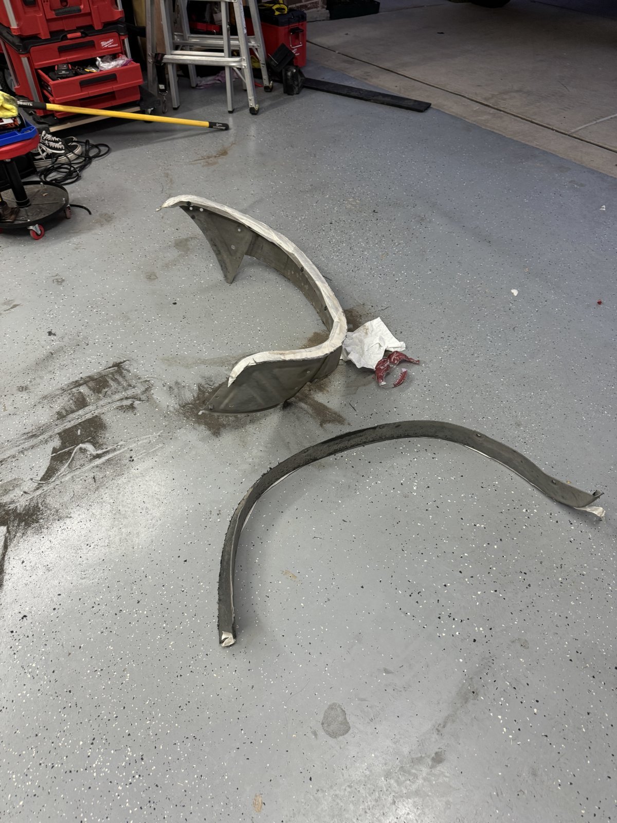

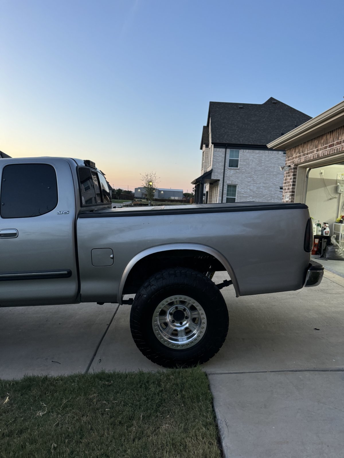

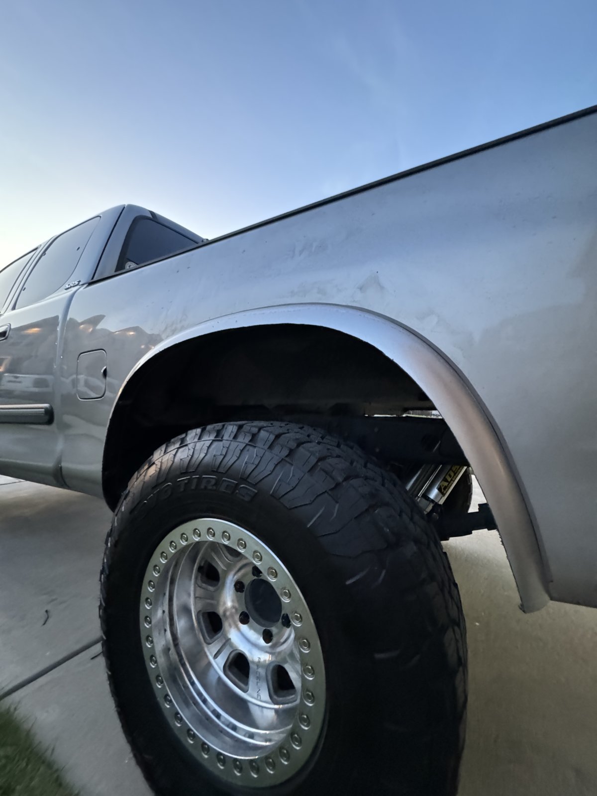

    02 SR5 RC Desert Sand- ARB'd 4x4

  3. Aug 3, 2024 at 8:47 AM

    BluegrapeVr6 New Member

    #82757

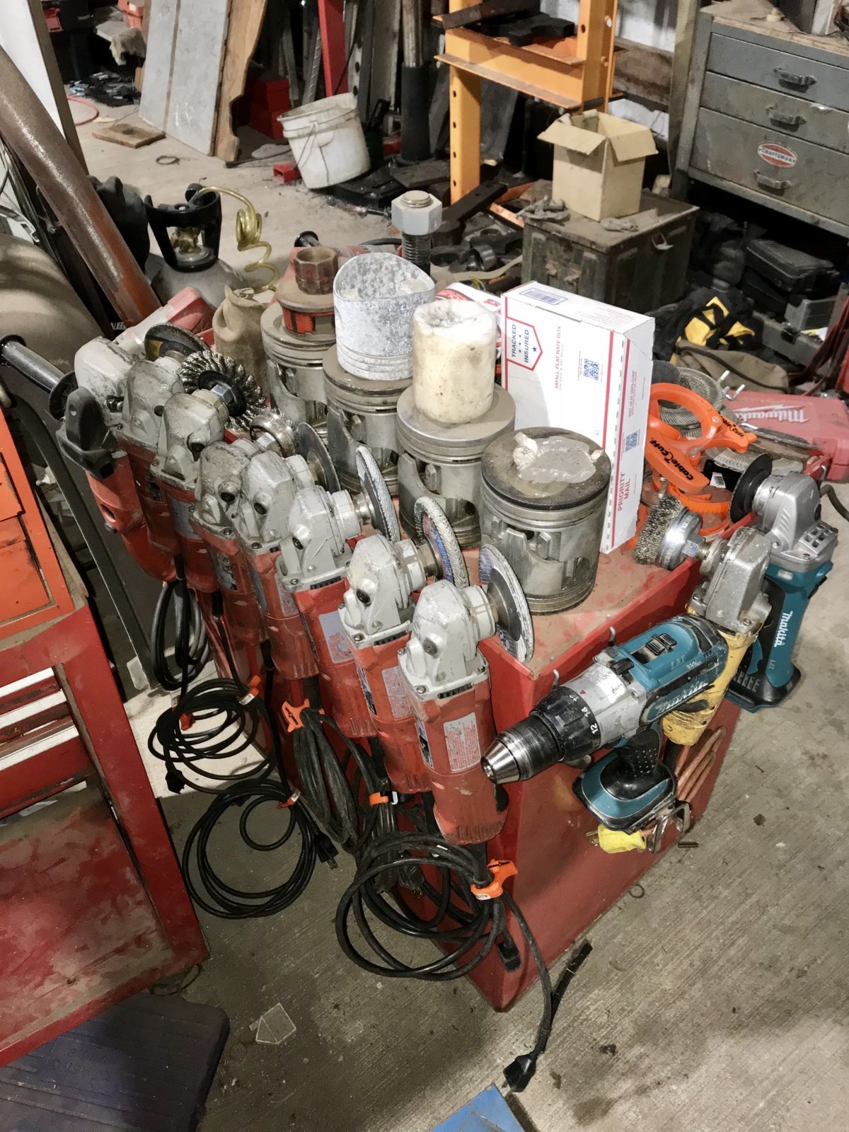

    478
    J
    BOSS head Unit, Track Rack, Tint. MT Baja Legend EXP 16x9, Pro-Comp 69, Icon Titanium Rebound 17x8. Cant decide on Lift. ARB Rear. Bash Fab Sliders.
