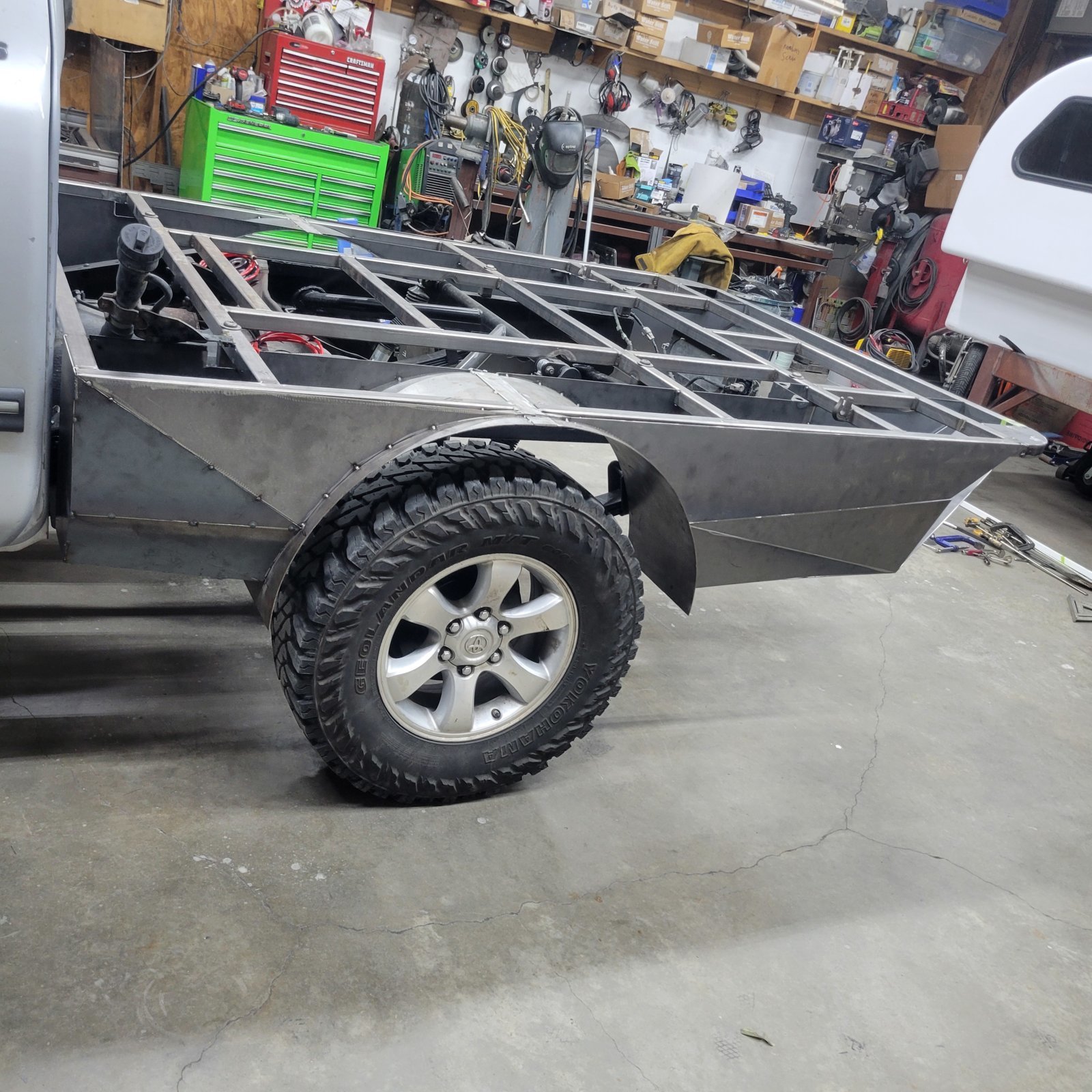

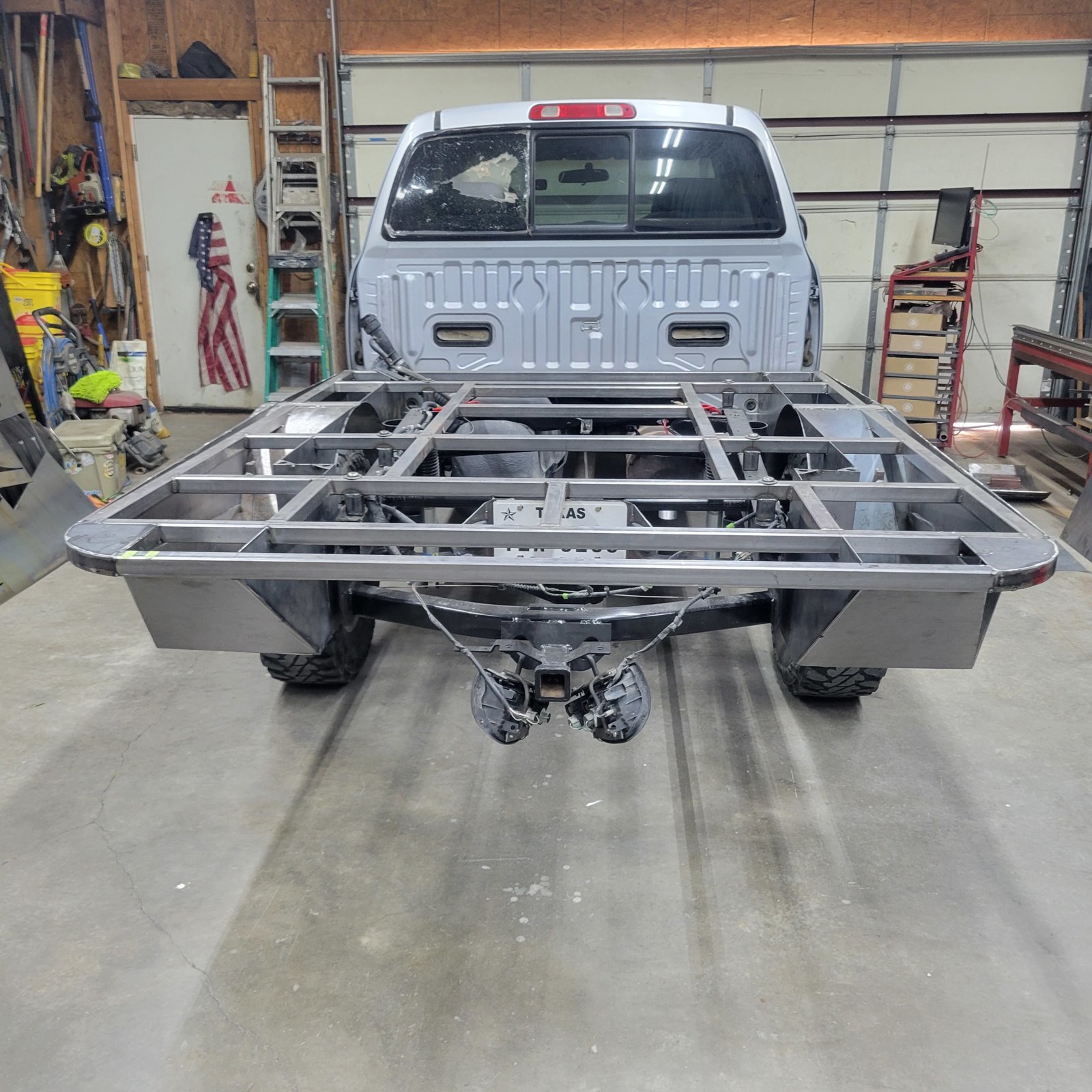

    OEM+, 6+1 bastard pack, 4.08 swapped rear end, custom spring shackles, 3 inch flat lift. This list will grow

  3. Aug 1, 2024 at 12:29 PM

    shifty` Waving My Dick In The Wind

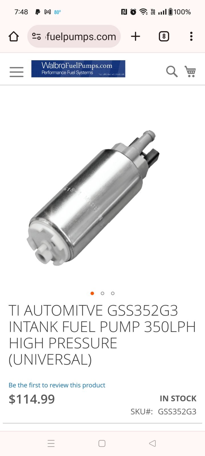

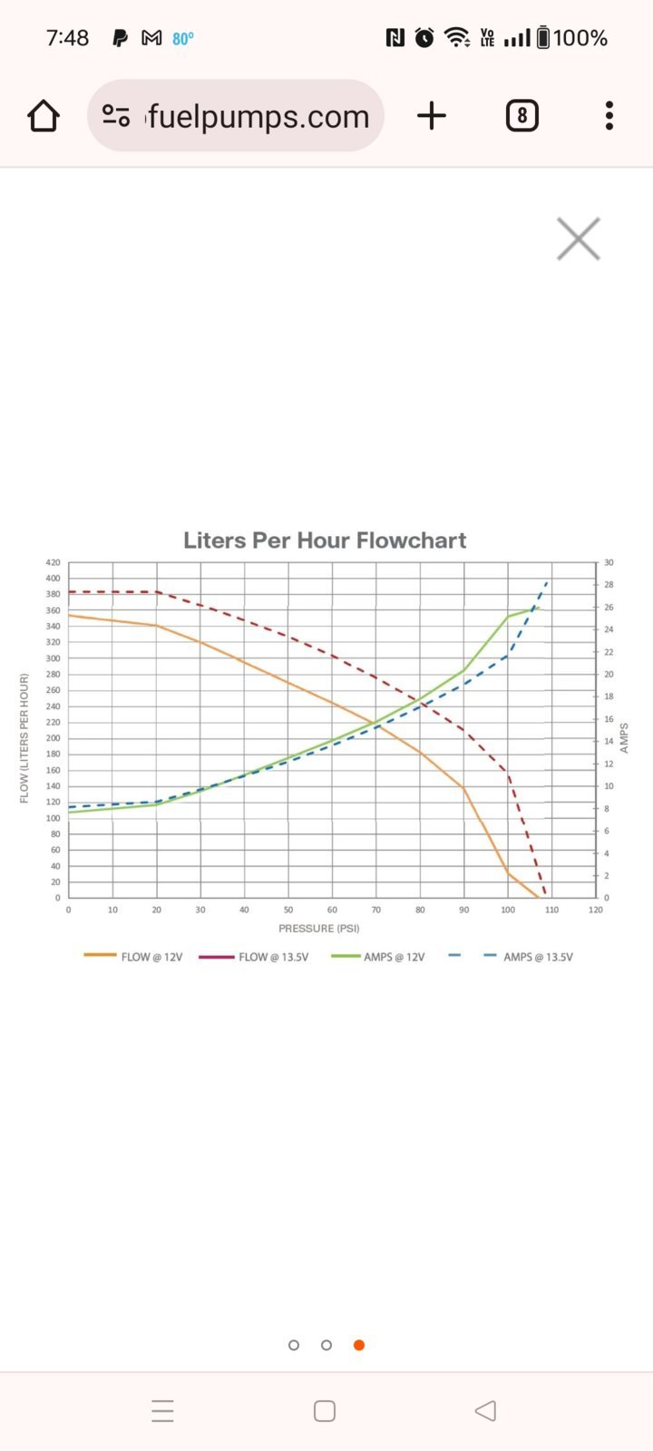

    Jun 20, 2020
    #48239
    30,101
    ATL

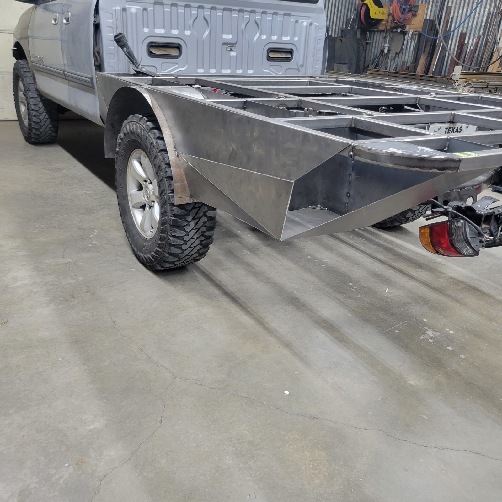

    That's the same exact spot i would store a wood 2"x12" plank (ramp) in my old 71 ford highboy's flatbed...until it caught on fire. Back story was that it was fun to coast down hill though a tunnel with the engine still in gear, but with the ignition key turned off. Then i would wait about 5 seconds and when i would turn the key back on, ka-BOOOOM!!! It was as loud as as shotgun blast! I guess you do that enough times over the years, and eventually the muffler will explode...which unknowingly to me it did. And since that's where i stored my wooded ramp right above the muffler, it was shooting hot exhaust onto dry wood. It all came to a head one night when i was on a 200 mile trip out to eastern oregon where ws pretty much nothing. I happened to be on a loooong desolate highway and i thought, "i wonder what the top speed on the truck is?" I promptly accelerated up to 100, then dropped it back down to 55mph again. A few minutes later i began to smell a forest fire. After another hour of so of driving i still smelled the same forest fire. About 15 minutes later i looked in my rearview mirror and started seeing the sun rise...at 11pm...in the East. Then i saw some flames from my side mirrors. I slammed on the brakes and jumped out of the truck and pulled out my flaming 2x12! The truck was fine except for some melted wires...that powered the trail lights, turn signals, parking lights, and headlights. Luckily one (out of two) of my KC Daylighters works. I drove with one spotlight for the next hour to my destination. And no more combustible materials next to a hot exhaust anymore.

    I absolutely love what you're doing! The angular shapes of the cubbies look spot on aesthetically pleasing. Keep up the excellent work!
    I know you flexed out your truck with the camper on the back, but it kinda looks like you don't have very much uptravel? I used to own a RTI ramp (i loaded it to a friend, and he loaned it to his brother, so i doubt i'll ever see it again), and i would use it all the time to test for suspension clearances.

    In all seriousness though, are you going to burn the entire seams, or just burn every inch or two and seam sealer the rest?
    You know, it's amazing Elon had all those designers and engineers on the Cybertoaster and it looks like something a 5yo drew. Then we've got you here making a friggin masterpiece. What the hell. Props.
