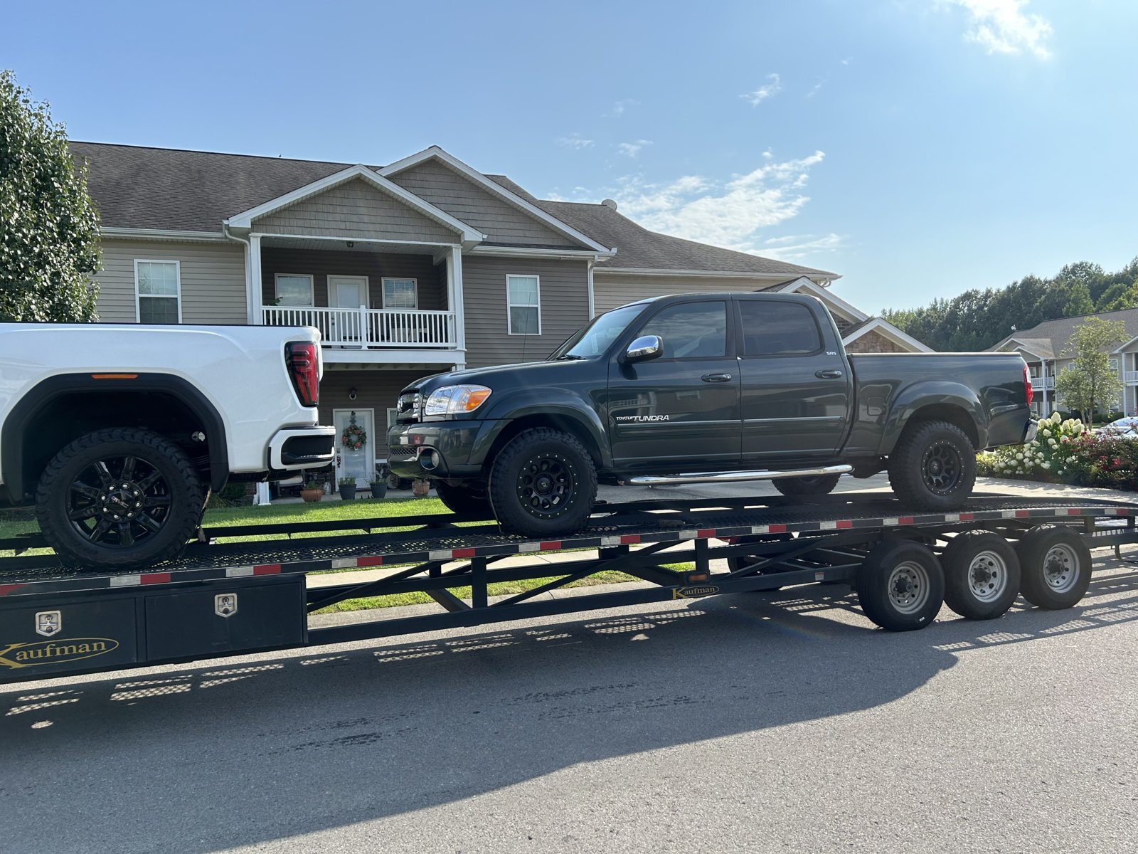

    Packed her up and sent her to meet me 800 miles away in Texas.

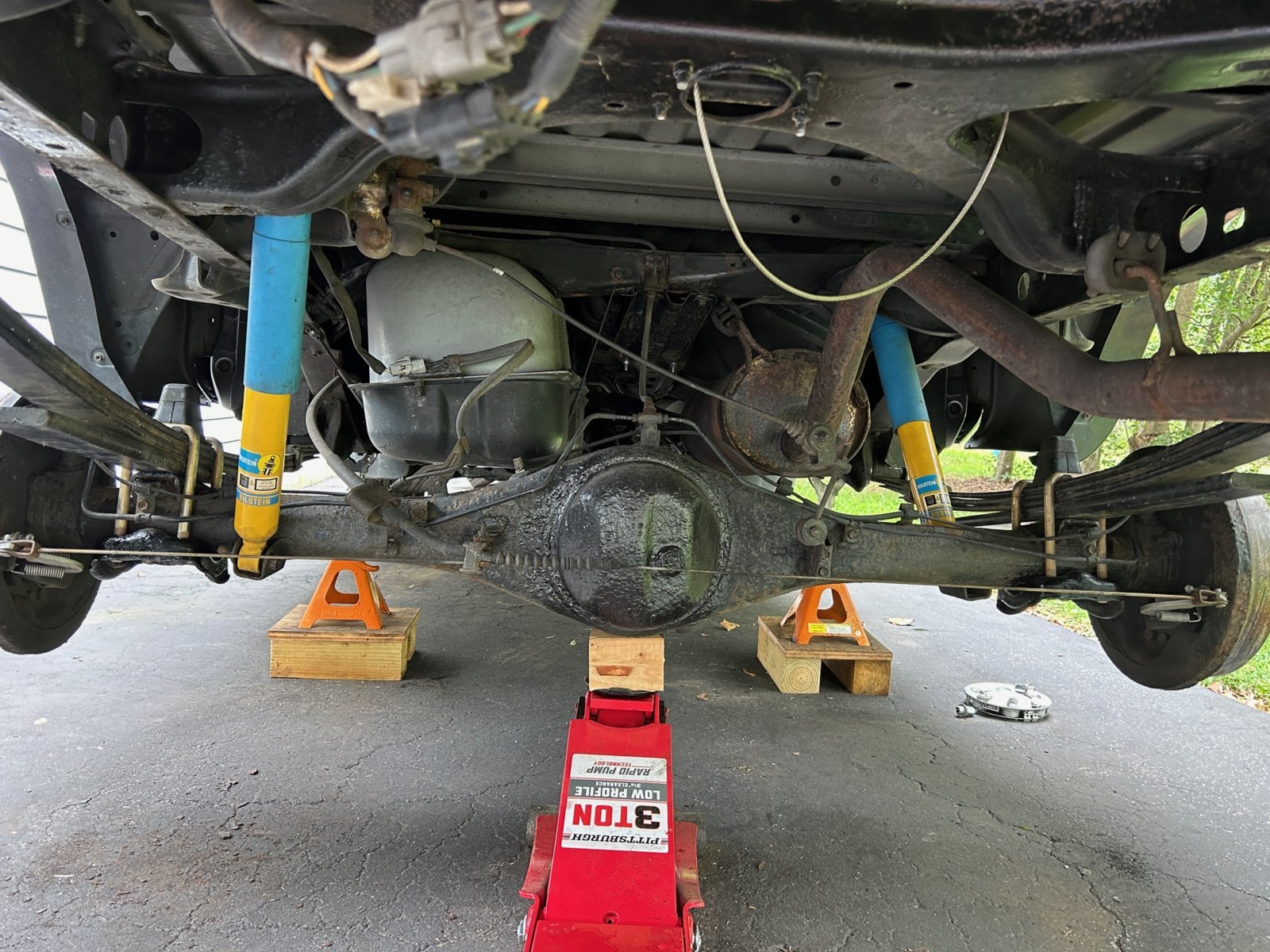

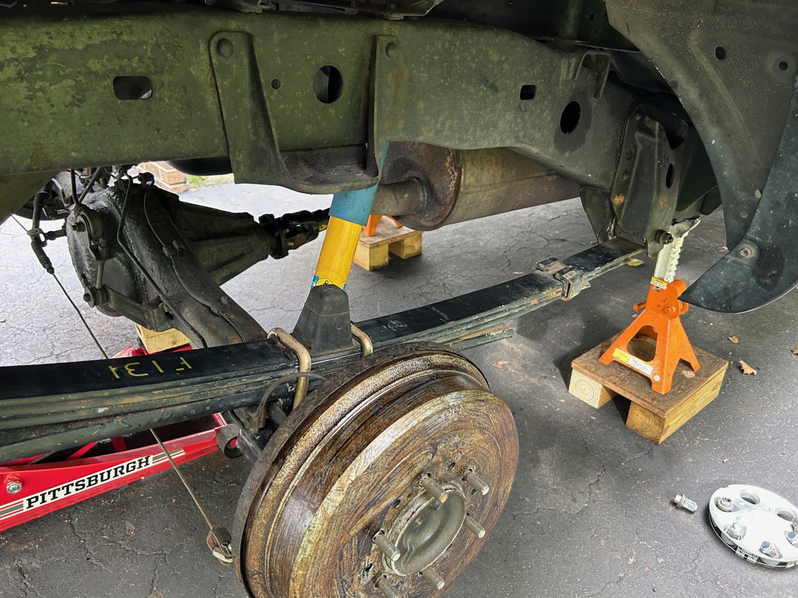

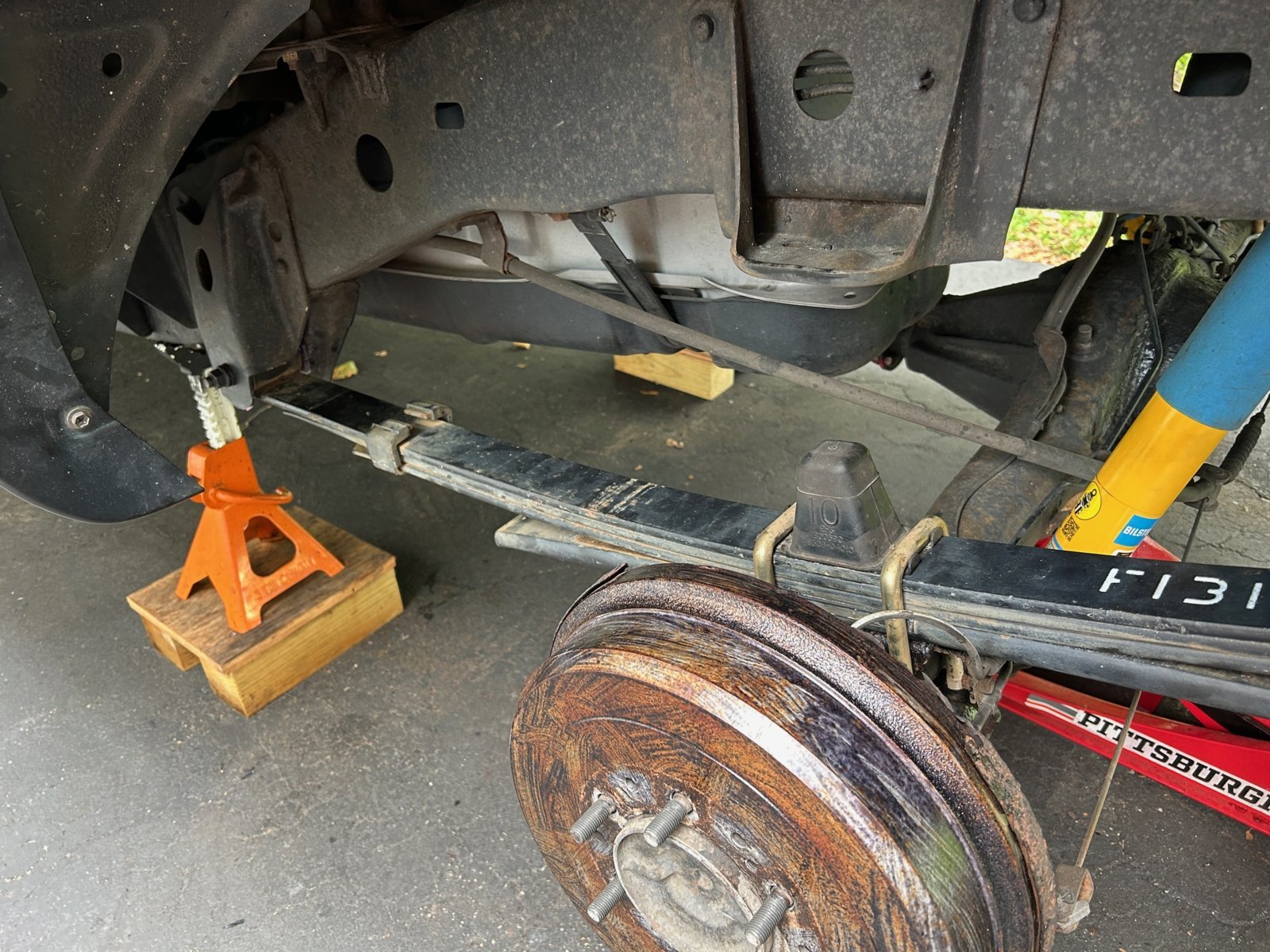

    Day 3 - Done!!
    - Mounted the new spring
    - Ran the bolts through the hangers
    - Put the bolts back through the shocks
    - But the tires back on, and dropped that fucker back on the ground!
    I bounced up and down on the bumper a bunch of times, then crawled underneath to tighten everything back down. I tightened everything "gutentight" with an impact, except for the u-bolts where I used a torque wrench.
    Total time so far today = ~90 minutes. I still need to re-install the trailer hitch and hang the spare (it's amazing how much room there is to work without the spare in the way), but I'm sick of this job!! I'll have another cup of coffee then finish up at a leisurely pace. I figure I need one more hour to finish up before the road test.
    It went much faster today because I've already done one side, and I knew what to expect. I also knew to measure and adjust the bushings while on the ground (much easier). And most importantly...plenty of lubricant (To quote the great prophet Zappa "keep it greasy")

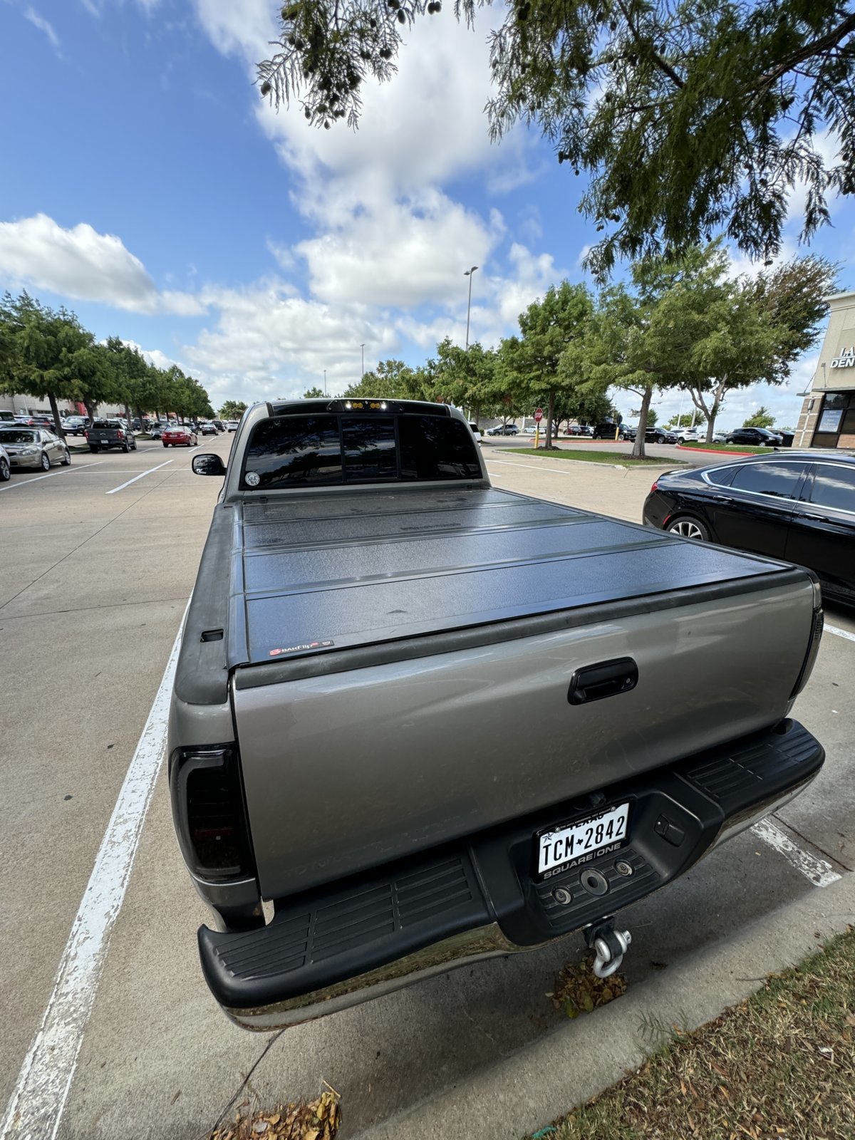

    Found a bakflip bed cover. Decent shape and I just needed a quick run to ace hardware and we were in business.
  21. Jul 30, 2024 at 9:15 AM
    shifty`
    shifty` NOT A NU JACK! NU JACK, NU JACK!
    Jun 20, 2020
    #48239
    31,406
    ATL
    '06 AC Limited V8/4WD
    That looks like the FiberMax Bakflip I have (but swapped for a camper shell, still have the FiberMax though)
    It's a pretty awesome unit. I could stand on it to wash the top of the cab. Sturdy SOB.
    khooiii[QUOTED] likes this.
  22. Jul 30, 2024 at 9:23 AM
    khooiii
    khooiii 80HD
    Oct 9, 2021
    #69126
    1,268
    DK
    DFW, TX
    03 Tundra AC 4WD
    This one’s the G2. I really like the bakflip covers. I’d love that hard shell roll up, but I’m not paying retail for one.

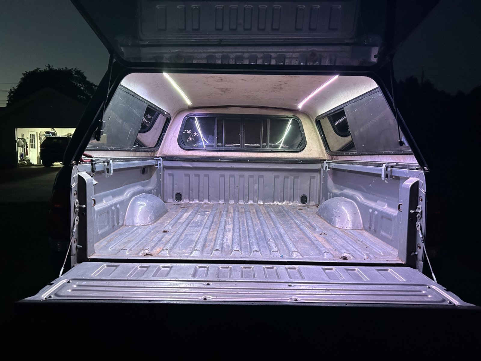

    Added some pockets to the camper and then added 5 HP on the back window. IMG_0077.jpg IMG_0076.jpg IMG_0078.jpg
