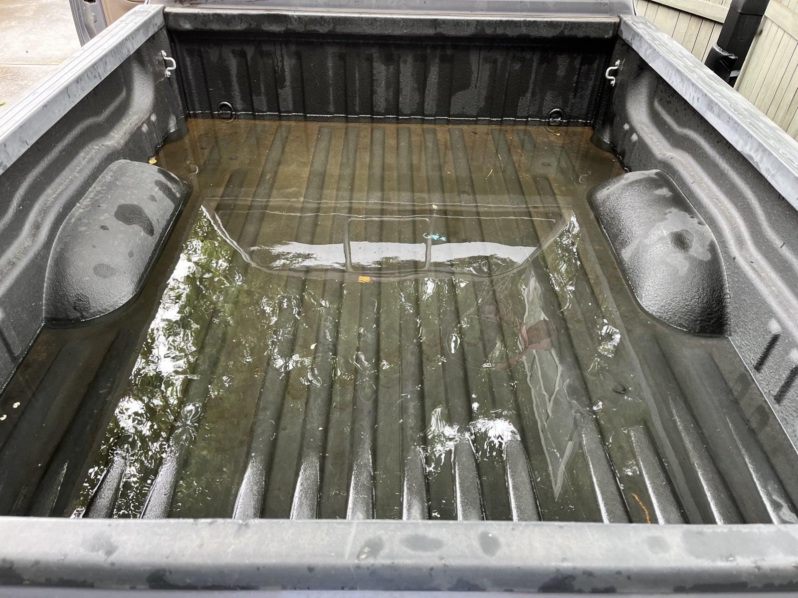

    Niether the titan or tundras plastic bedliners have drain holes. I keep a bit of hose to siphon it out. Or, reverse then brake.

    Just drill some holes through through the spray. Probably wouldn't hurt anything. Right?

    @FishNinja has the spray-on liner though so the plugs should be under the spray, right?

    That’s the plan. Then maybe just hit it with some black spray paint if I have to go through any metal.

    There should be two slits in the front bed floor, left and right of center. They often get clogged with debris, especially when bedlined. Grab you something to poke around in there and see if they'll free up the clogs

    mine have the holes for plugs. So I'm assuming yes.

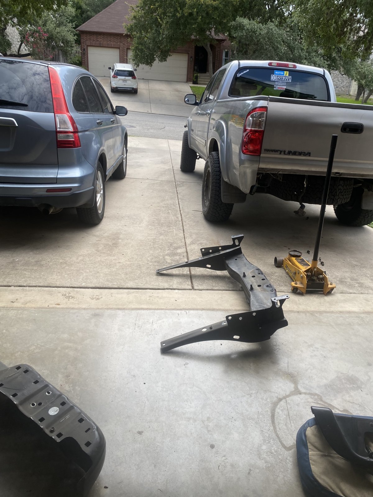

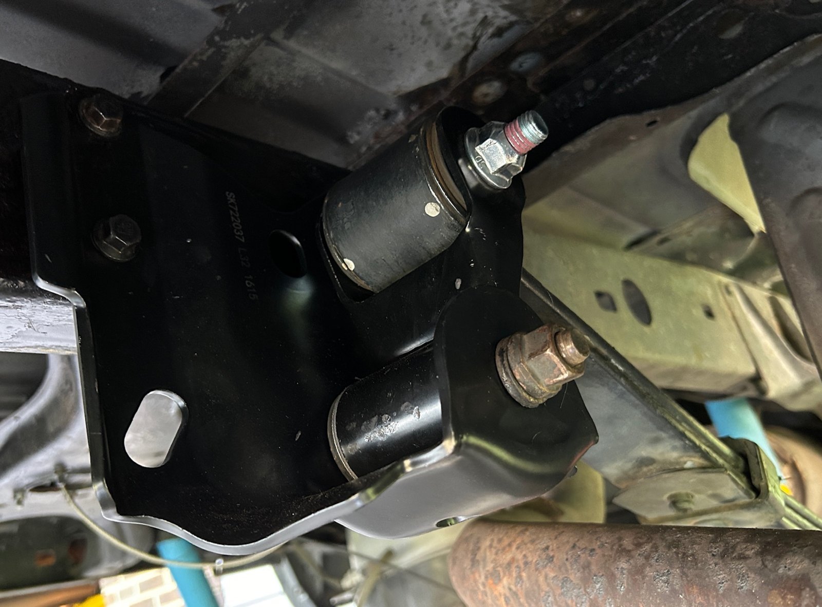

    Day 2 (short day today...appointments in the afternoon). No pics today :(
    I didn't quite finish on the starboard side last night. I had a difficult time fitting the front spring bushing into the front hanger. With a clear head this morning I figured it out...the space in between the two sides of the hanger should be nominally 3.000". Mine measured up at ~ 2.856". The bushing on the spring measures ~ 2.887, so I had to find ~ 0.030" somewhere.
    First hour:
    - Tried to pry the hanger open. This might have worked if I had the jaws of life, but alas...
    - Ground away some material from the inside spaces between the hanger
    - Ground away some material from both sides of the bushing.
    - Applied bushing grease generously
    This worked well. I was able to persuade the bushing into the hanger with a floor jack and a BFH. But I just could not get it to slide forward enough to see all the way through the bolt hole <sigh>
    Hour two:
    - Rummage through the basement to find the come-along (it's been ~ 30 years since I last used it).
    - Rummage through the garage looking for a length of chain to wrap around the axle
    - Drive to the hardware store (Ace is the place!) to buy 2 feet of chain ($12!!!!)
    I used the come-along to drag the axle ~ 1/4" forward, and drove the last bolt home (yay!)
    Hour three.
    - Removed the front bolt on the driver side
    - Cut through the u-bolt on the driver side
    - Removed the rear bolt on the driver side
    - Removed the driver side spring
    This was the one that caused me to want to change them in the first place. I had an annoying "clunk" on the left side, that has only gotten worse over time. I was expecting the find a cracked leaf, or maybe a bad bushing, or perhaps the center bolt rusted out or broken...but so far I have not. I'll have to sleuth more tomorrow.
    Off to my appointments. Tomorrow is another day. All I have left to do is install the new spring. Should be a piece of cake, right? Should only take an hour, right?!

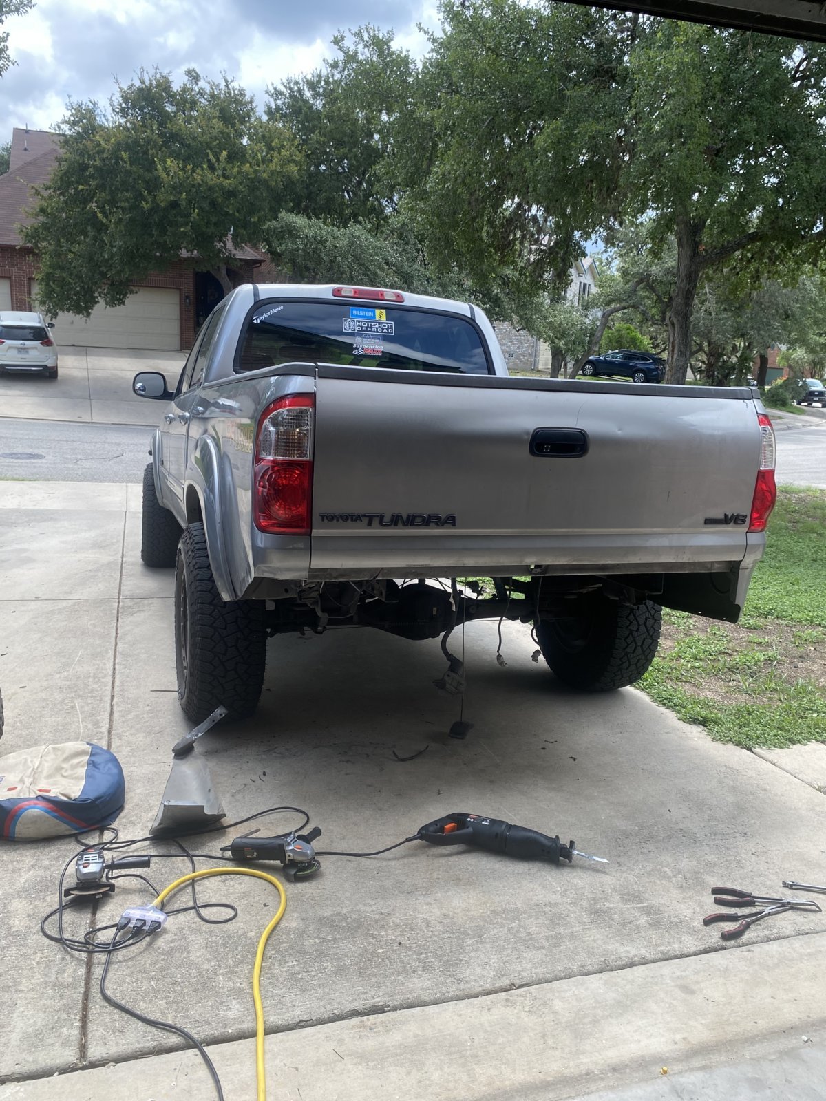

    Not bad progress for a Monday. I went out at 4:00 for "one more quick hour" blinked, and now its 7:15.
    Got a lot of the boring supporting work done today, its looking like a good week!

    So this is what it looks like when metal fab guys get bored.
    I take it you'll eventually pop holes in the side walls for access to the shackle/hanger hardware?
