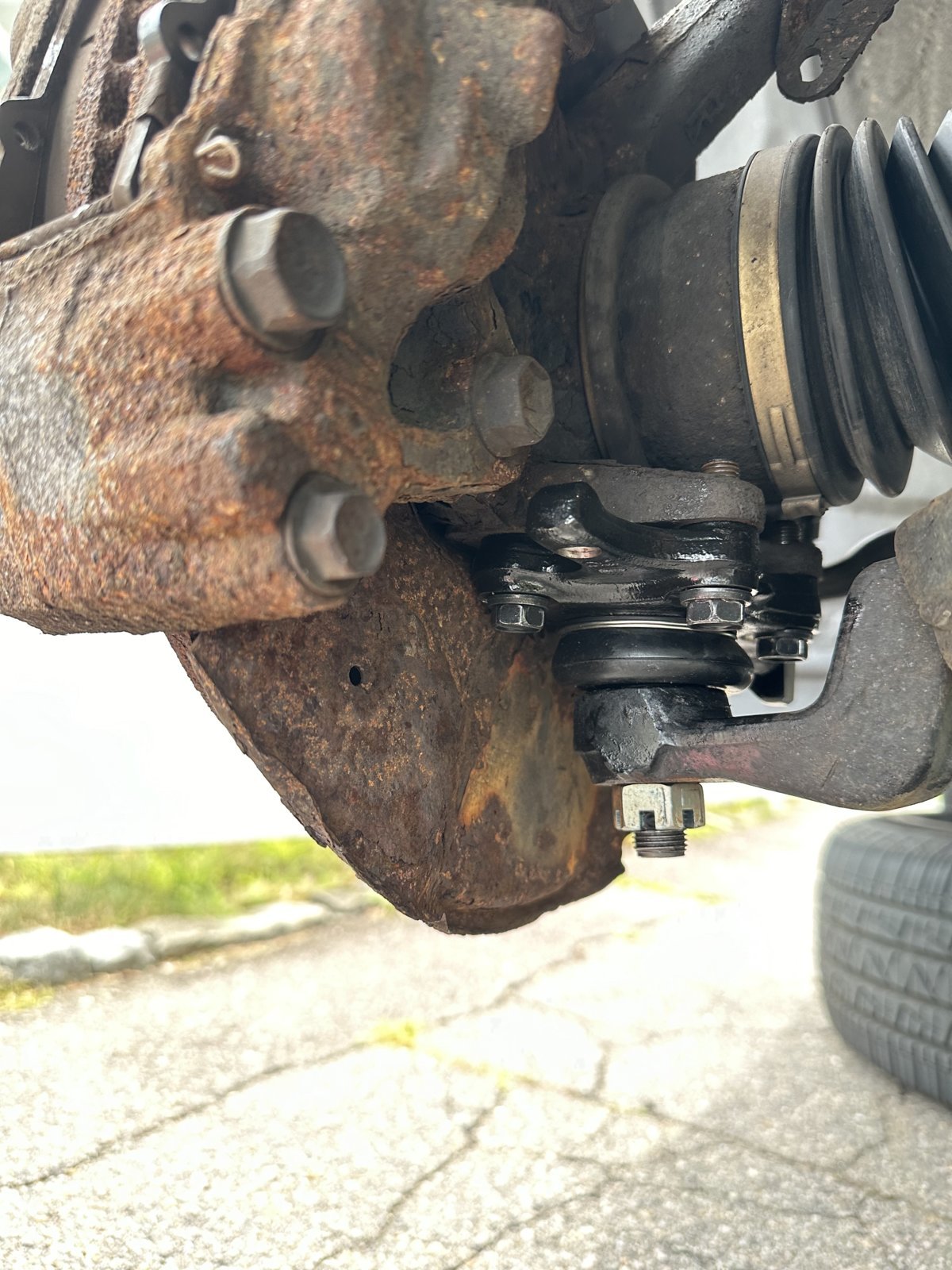

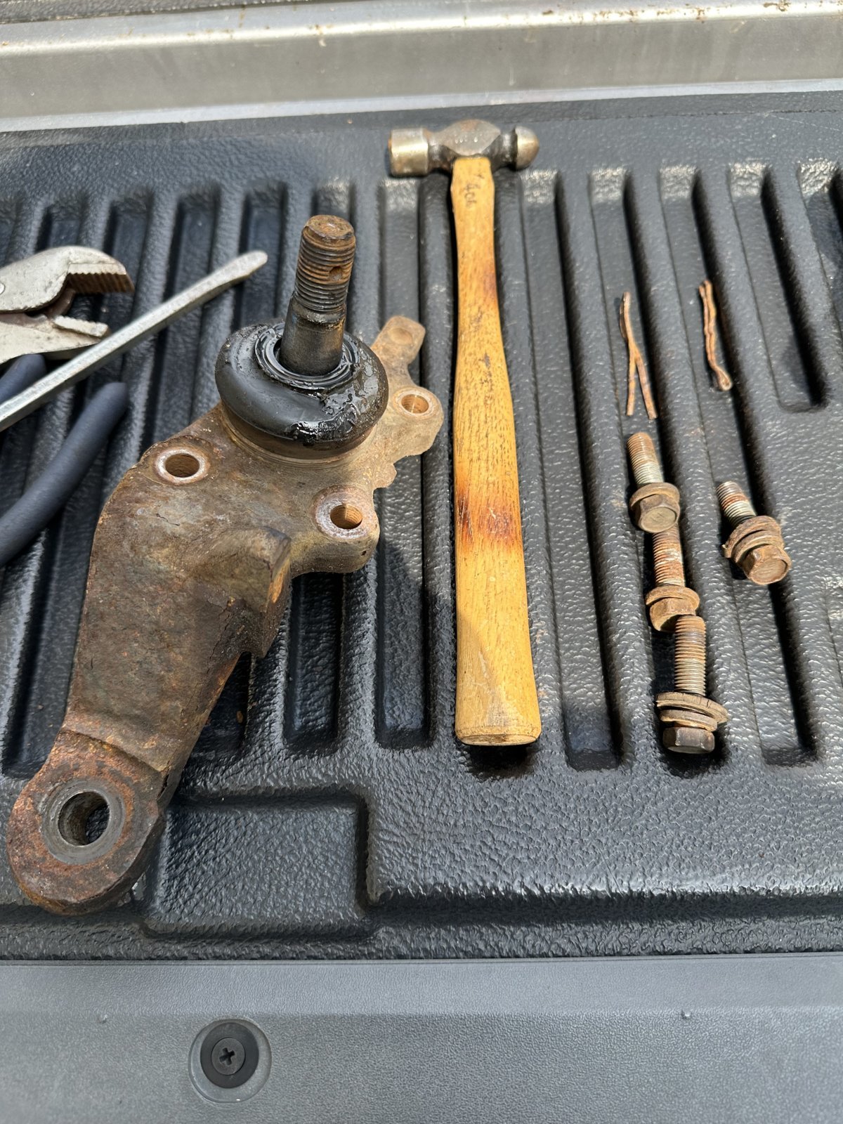

    Damn. This one I had to hammer the LBJ off the knuckle to defeat nature’s loctite.

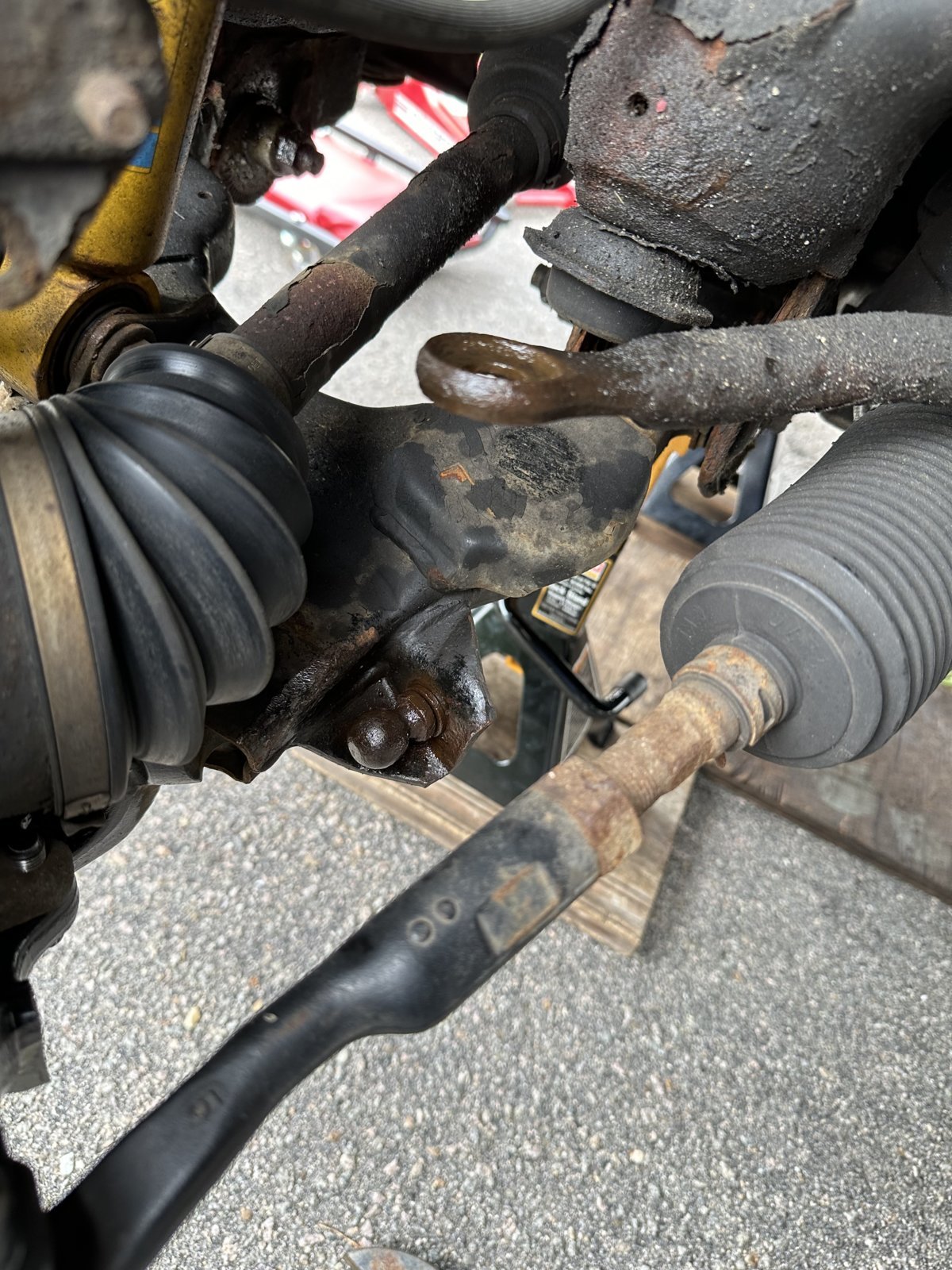

    Fin. Just need to find the right size cotter pins. The ones included are more for tie rod ends. :poking:

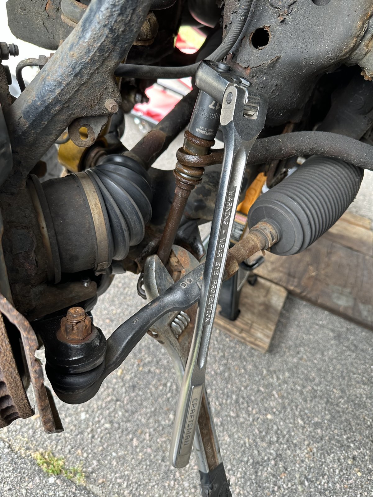

    Got the offending link off. However, I’m still unable to get my knob off.
    I hate to ask, but suggestions? May try some heat later in the week.

    Clamp some vise grips on it, hit it with some heat, and it should come off.

    Well, for one, get a fucking cotter pin in that TRE for crying out loud!
    If it's spinning, I'd grind a flatspot into the ball, then wedge something between the LCA and flatspot to hold it in place.
    But before that, I'd probably take I'd probably take a cold chisel to that split at the base of the ball and give a few targeted whacks with a BFH to snap the ball end off.

    Thanks. I’m getting new tie rod end nuts this week to replace the rusted ones.

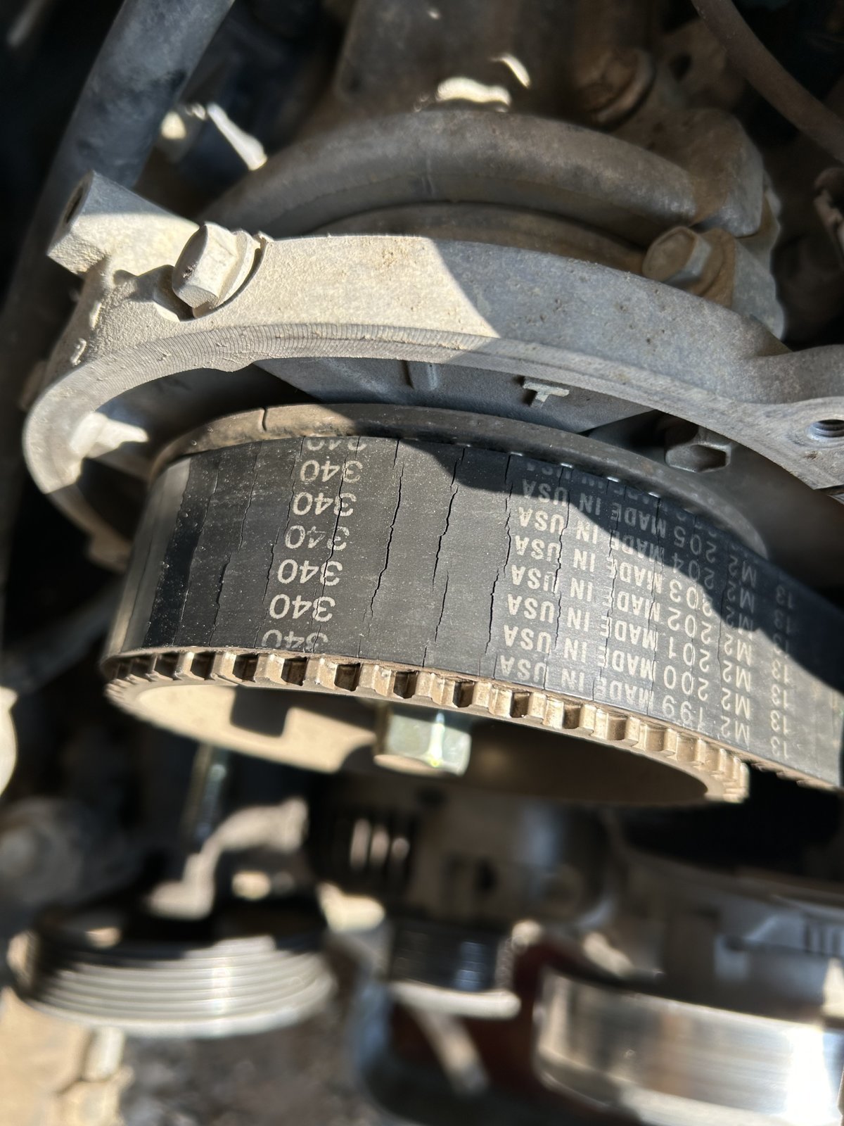

    I just bought my truck last week. This site has been fantastic. I decided to do the timing belt because I didn’t know if it had been done recently. It looks like I made the right choice. LBJs are next.

  11. Jul 28, 2024 at 3:34 PM
    VR6T
    VR6T In fealty to the God-Emperor I serve the Imperium
    Jan 29, 2022
    #73879
    1,962
    Texan.... Big suprise
    00 Tundra Limited 2WD AC
    OEM+, 6+1 bastard pack, 4.08 swapped rear end, custom spring shackles, 3 inch flat lift. This list will grow
    Firstly welcome, secondly good job, thridly let the fuckery begin
    Are next...... Are... Not is
    Yes I know

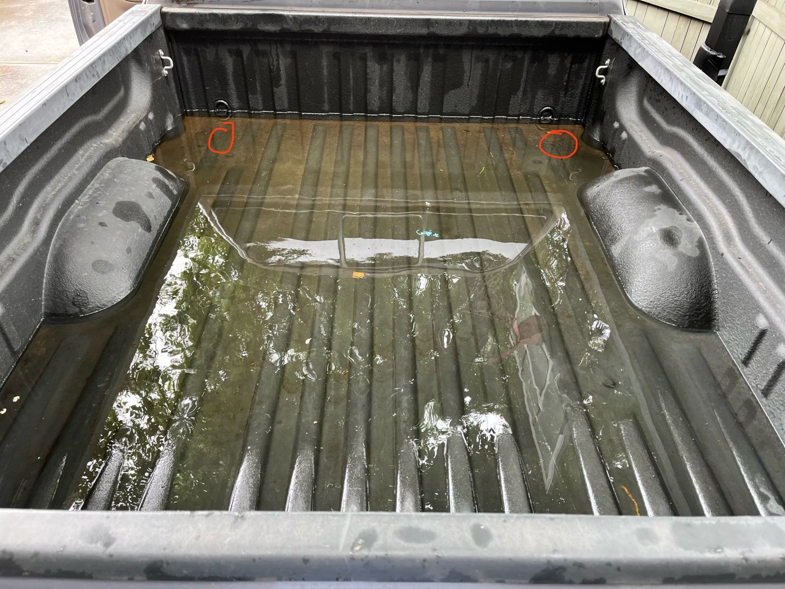

    What I NEED to do to my truck today: drill some holes in the bed so it can drain. I’m guessing PO got it Rhinolined when he put the cap on:

    Yeah, Mapp gas, and make it glow red hot. If it's almost liquid, it can't be tight.

    Yes, I can see them from below, but homie sprayed right over them.

    Can you look underneath the bed to see where the drain plugs are located? May be an easy fix to just cut through that since the plugs are plastic.

    Where can you buy proper mapp gas? That stuff was phased out years ago. What they call mapp gas today is only 10-15% hotter than propane.

    They have the portable oxy-acetylene kits at home depot for $400. I don’t have a big enough job to warrant buying it though.
