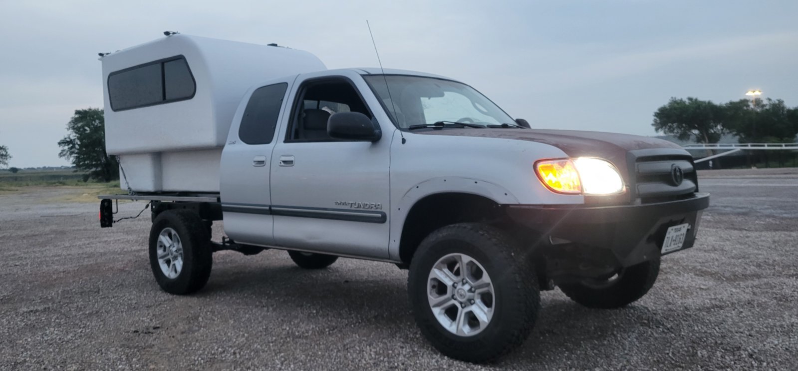

    Coming along nicely :101010:

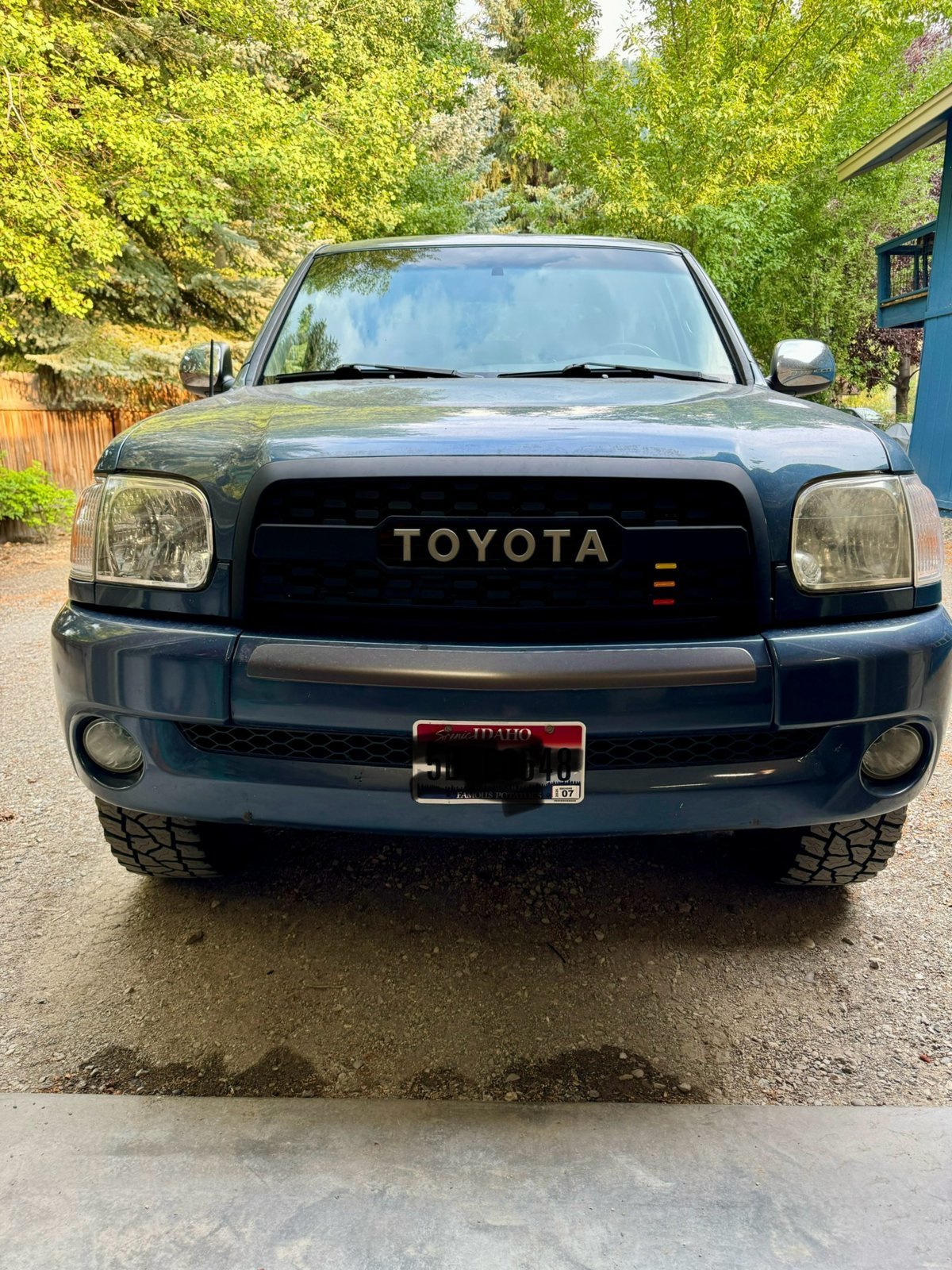

    I did a little something over the weekend. Not sure @shifty` will approve since the outside trim isn’t color matched ;) but I’m trying it out for now. I will have to figure out the bottom chrome piece along with the trim of the grill.

    @Kimosabe I like that. Where is best place to get this grill?

    I love a black grill on a blue truck.

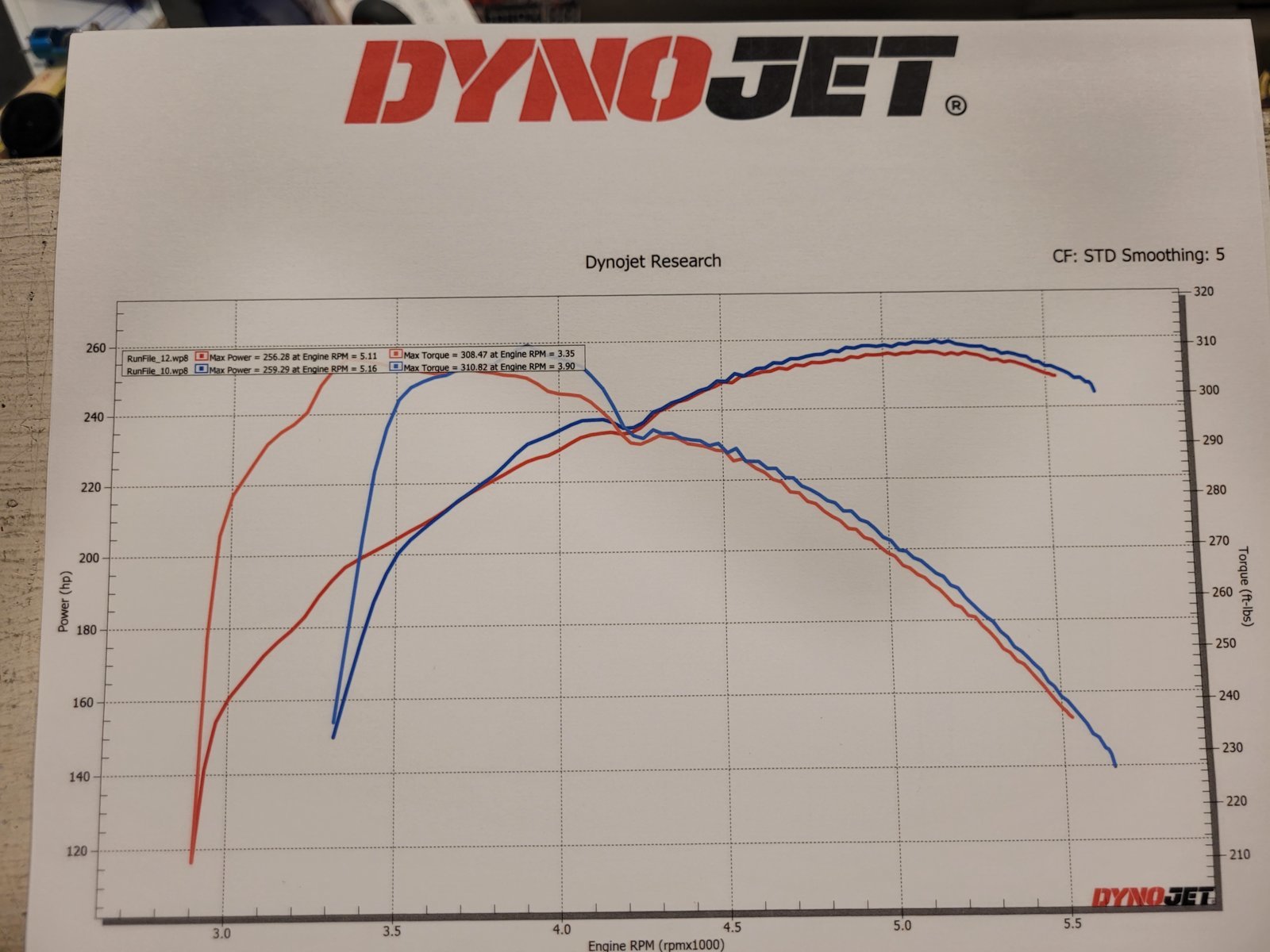

    OV Tune base high octane map w/shift points, Stan's Tri-Y headers (1-5/8" primaries), custom Borla 2.5" header back exhaust single exit, Dirty Deeds 12 hole injectors, AEM dry-flow drop in air filter (only using it because I got it for free).

    So to be clear, the tune made these gains over your last dyno with all power mods minus tune? Stock vs tuned numbers would be dope too. :cheers:

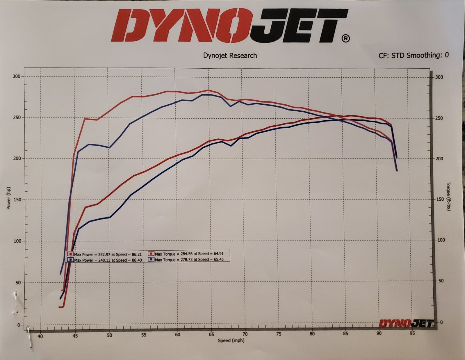

    Yup. Numbers posted were above already modded truck. Here's the breakdown:
    Stock: 248hp/278tq
    Headers, exhaust, injectors: 252hp/284tq
    All previous mods + OV Tune: 259hp/310tq
    Those peak numbers may not seem impressive but all mods combined I gained nearly 70tq over stock at around 3,000 RPM.
    I didn't realize until I left they didn't print an overlay of today vs previous run.

    I got this one from Taco Vinyl. They had the best price and are only 2 hours from here so I went through them.

    I think having the bumper unibrow blacked out actually pulls it all together. Only reason I like the outer paint-matched is b/c it gives it that "OEM+" look, like it came from the factory that way.

    Never trust a dynojet always try and find a land and sea hub dyno. Good numbers tho

    I held off on getting it because I knew it would be a while before I could color-match it, but the old one looked so bad I couldn't stand it. The guy put metal snaps on it for some reason. I totally agree and would prefer the OEM look. I can't decide what to do about the bumper trim piece though. Might look for color matched wrap.

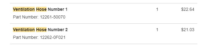

    Maybe? I just bought 'em from Toyota. They came custom-formed, and insulated with the appropriate foam, pre-bent to avoid kinks. ~$20 ea, and that wasn't during a sale. #1 is driver side. #2 is passenger side. Current pricing for local pickup from a nearby dealer is actually 10% cheaper than these prices I got from LaGrange ...

    @shifty` - can you post a pic of that vent hose #2. The part # is close to the discontinued one for my 2000 and I wonder if I can make it fit. Thanks friend.

    https://www.toyotapartsdeal.com/pag...ter=()&keywords=12261-50050 HOSE, VENTILATION
    I just ordered one for myself. Is it pricey? Yeah, but the original one has managed to damn near last this long why not. At 23 bucks I'll just toss it in with the rest of the order.
