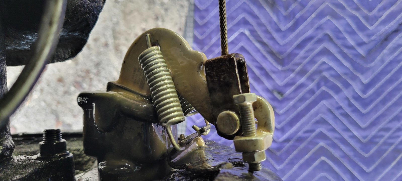

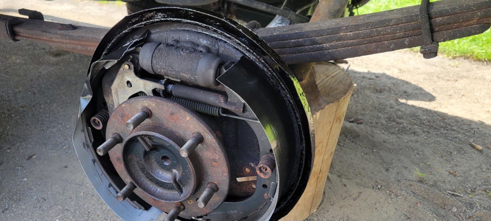

    You all probably know this, but I found it so much easier to go under the star wheel to free the lock arm (to loosen the brake shoes and get the drum off)

    I think that's how it supposed to be done. It's the only way I've been able to.

    Weird, I just use the threaded bolt hole provisions in the drum itself, run a bolt into each until it's finger tight, ratchet each one a couple turns and the drum pops right off. That's the whole purpose of those two threaded opposing holes. I've never worked on a truck wdrum brakes lacking them.
    It's a common size/thread pitch because I've acquired about 15 in my spare hardare bin over the years that thread right in.

    I did try that, don't have a huge selection of Metric on hand so they were shorties. But they started pulling the shoes off with the drum. Between how tight I adjusted them last week, and the rusty ridge on the drum... I just decided to back the gears off.
    I have seen a graphic on here that shows going over the top with a pick to release it. That's the only reason I posted that.

    I typically tap the drum with a BFH around the perimeter of the drum a few times to help break up the death grip the shoes can have on the drum. But yeah, if they're tight, no other option than hooking. I just don't typically run into that. I have, it's normally a corner case.

    When you can spin the drum by hand (light drag, shoes not stuck) and she don't want to come off... it's gotta be the ridge in there. I almost replaced the old drums, but heard here that like many things, new ones are shite/warp.
    Maybe I can invert them on the axle, let her idle, and do some magic with the angle grinder. Wife would be super fkn impressed. :rofl:3rd trip taking me to ER might be a charm.

    Yes if overighten it seems best as you describe to back them off first before removing drum. Have found as @shifty` notes that even adjusting outward with drum off is easier and can help to not overtighthen (as then can't get drum on). I also find it easier to adjust with drum off because can feel for the tightness of the drum by shifting it against the shoes.If really follow the FSM, can use a caliper to measure brake drum ID and OD of the brake shoes for difference between the diameters is the correct shoe clearance (IIRC 0.5mm).

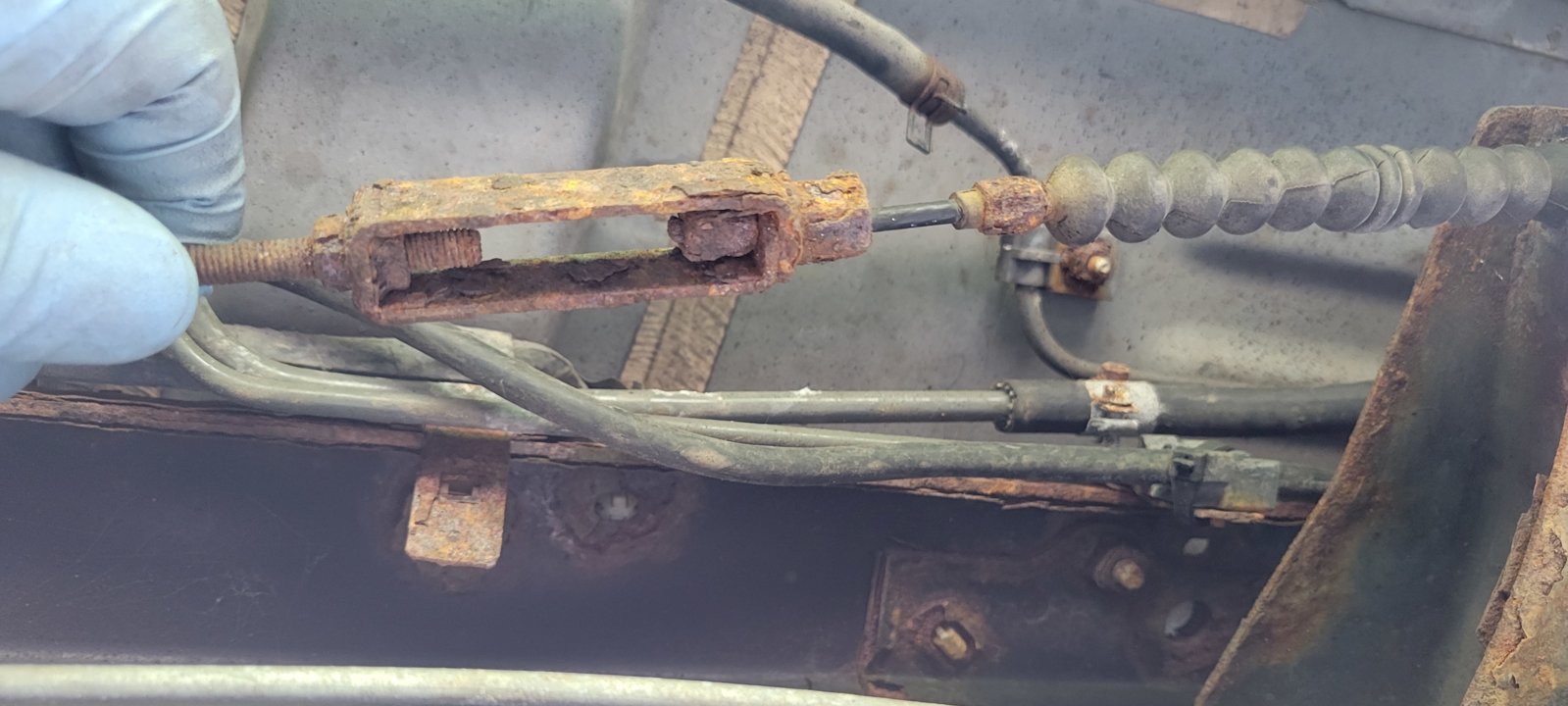

    BroHon
    Sep 19, 2023
    #104169
    2,594
    Bro
    Location: Bitch Mitten
    2000 SR5 AC 4x4 4.7

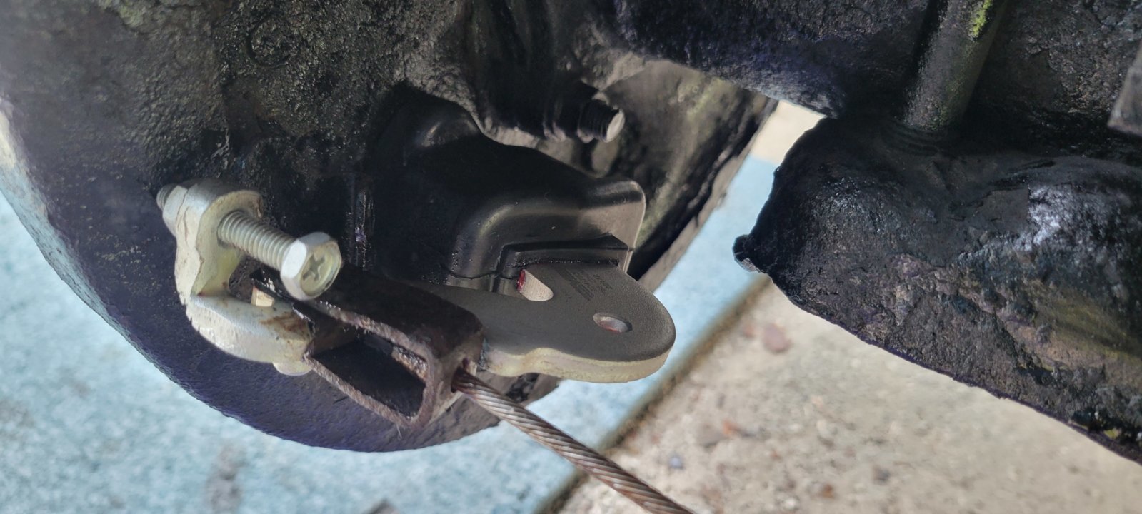

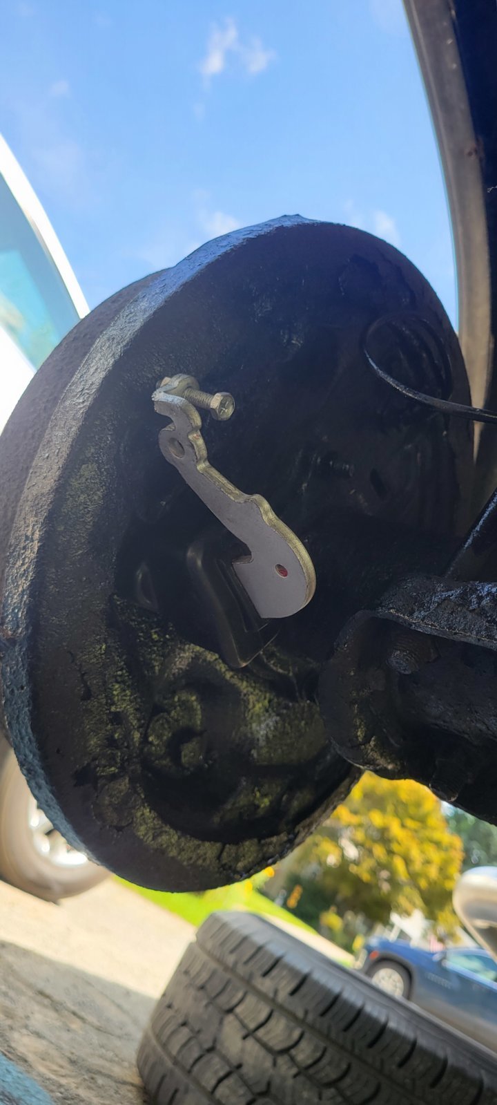

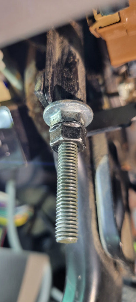

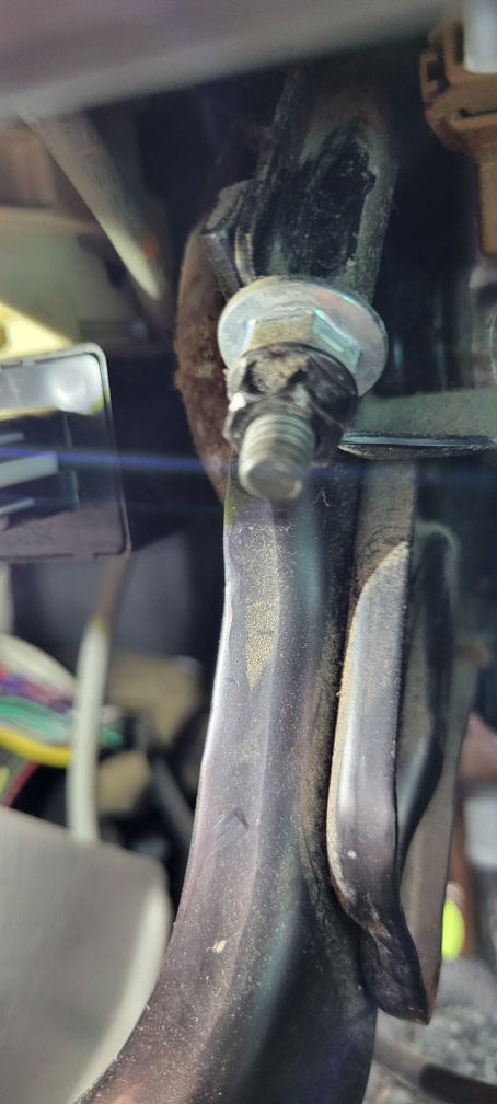

    Parking brake (With new bellcranks) working as intended now, Holds to about 1200-1300rpm. Pretty happy that the rest of the cabling system was intact and willing to function (because I didn't even really inspect it other than the middle connection).
    Addressing the middle adjustment will be a battle for another day... Have a few angles of attack coming to mind. But for now the adjustment at the pedal (all of it) was enough to get a good grip.
    Don't get the clicks like you would expect on the pedal, and she's kind of temperamental about locking down every time, but I will rarely ever use it for anything but keeping my brakes adjusted.
    Scraped and painted a bit, for what it's worth. Drenched in FluidFilm.

  25. Jul 20, 2024 at 1:29 PM
    GeminiProject
    GeminiProject New Member
    Jul 13, 2024
    #119845
    31
    Commifornia
    1st Gen Tundra AC

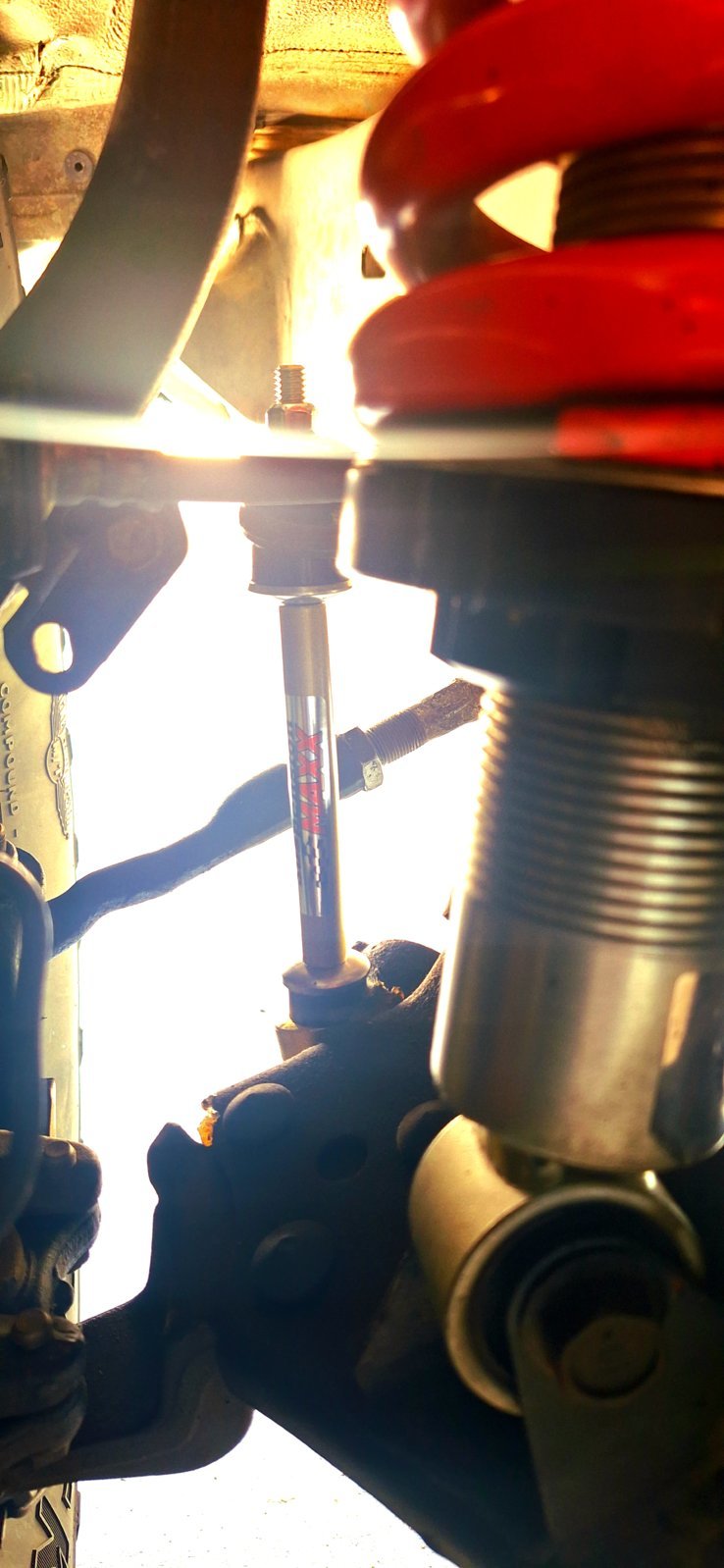

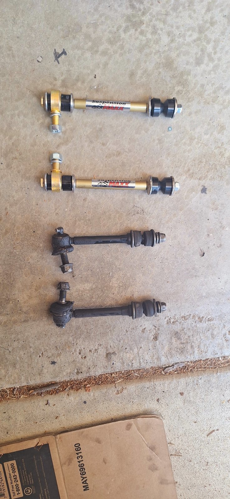

    Got some new links in
    oscardog86, Tlar25, KNABORES and 7 others like this.
  26. Jul 20, 2024 at 3:13 PM
    shifty`
    Jun 20, 2020
    #48239
    29,461
    ATL
    '06 AC Limited V8/4WD
    One of SM's install sheets shows the bottom cam should sit parallel to the ground. Is it accurate? I dunno. Is it a pain in the ass to keep it parallel while wrenching it down? Hell yes.
    Big question is: How's it FEEL?!
  27. Jul 20, 2024 at 3:25 PM
    GeminiProject
    Jul 13, 2024
    #119845
    31
    Commifornia
    1st Gen Tundra AC
    The install was easy. I drove around for a while and checked the links after the drive. Everything seems ok, instructions also say may not be possible in all cases.
    shifty`[QUOTED] likes this.
  28. Jul 20, 2024 at 3:36 PM
    BroHon
    Sep 19, 2023
    #104169
    2,594
    Bro
    2000 SR5 AC 4x4 4.7
    Well, I had them cranked out manually pretty tight/right.
    So they FEEL like ever so slightly more when it comes to pedal travel.
    I fkn Stood on that park brake pedal to get more clicks....
    Maybe when I brake the middle adjustment free and take up more slack it will improve.
    I'm not afraid to get under there and just YANK the cables either though, we'll see how the first week of commuting goes.
    I get no fking clicks either so that measurement is just guess work.
    But braking is strong, same as before. They are all relatively new brakes.
