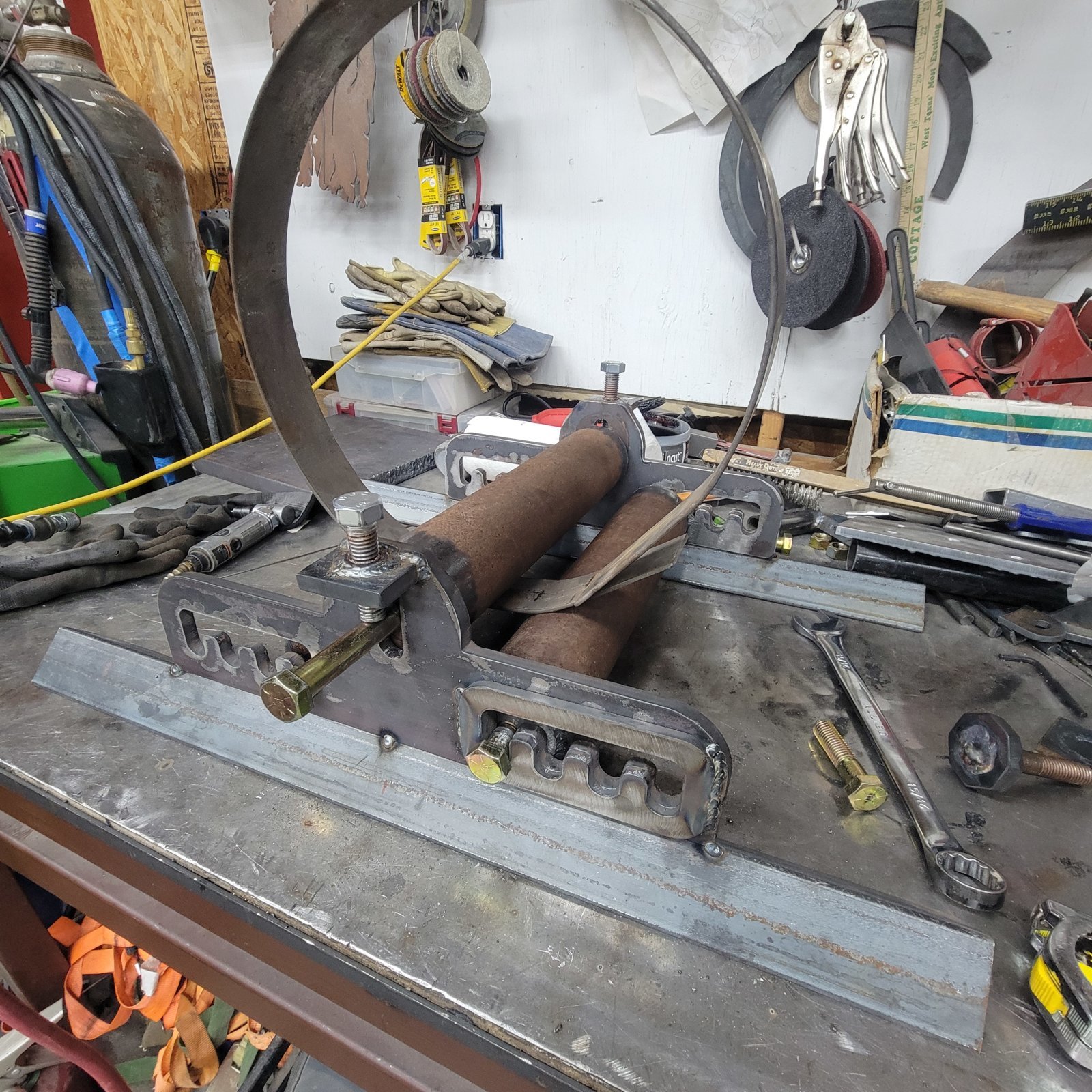

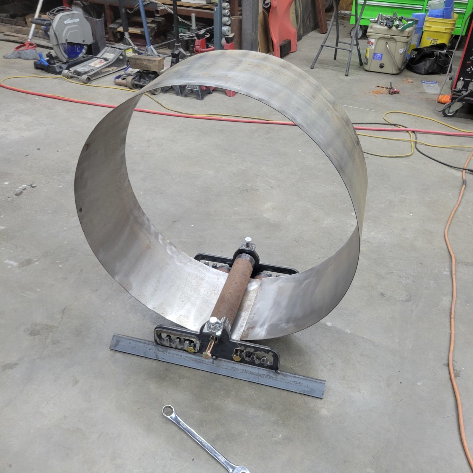

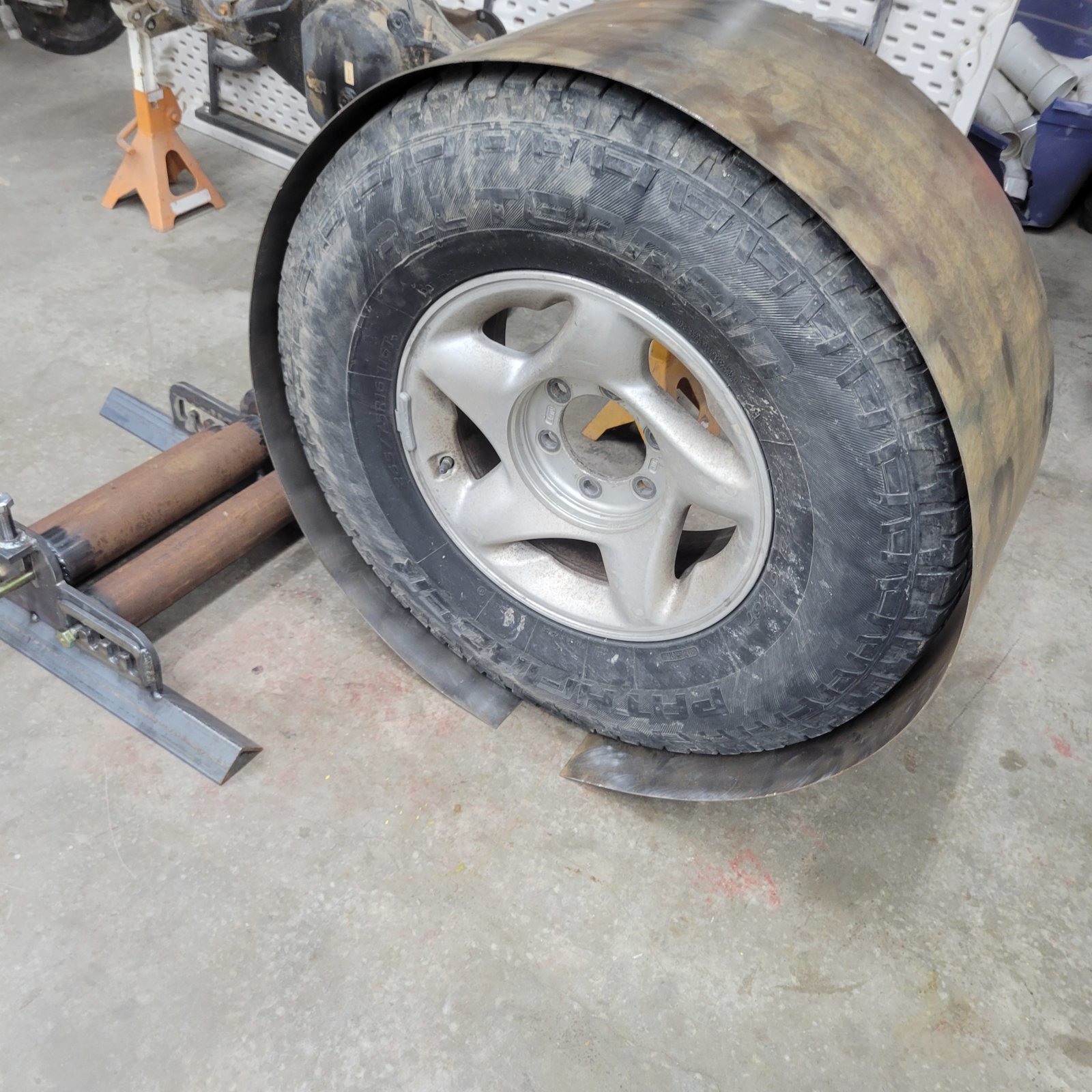

    I hate the flat fender hexagonal/octagonal wheel wells guys do on the ausie trays and flatbeds. I thought I would buy a set of trailer fenders and trim down to what I need from there, but like everything else they are 4x more expensive than the last time I bought a pair.
    Enter the Jake Jake plate roller. A sloppy execution of an idea that I've had rattle around in my head more than once. Testing here with 2"X1/8" stock.
    Fender time! Takes surprisingly little effort/time to roll a ring. Something like 2-3 minutes and 3-4 passes back and forth. Scabby piece of 12"x14ga I had on hand.
    TaDaa. Had a starfish handy for this photo, but there is quite a bit of movement in the roll. I should be able to really dial in the fender to wheel clearance.
    Total cost $30 worth of hardware. :thumbsup:

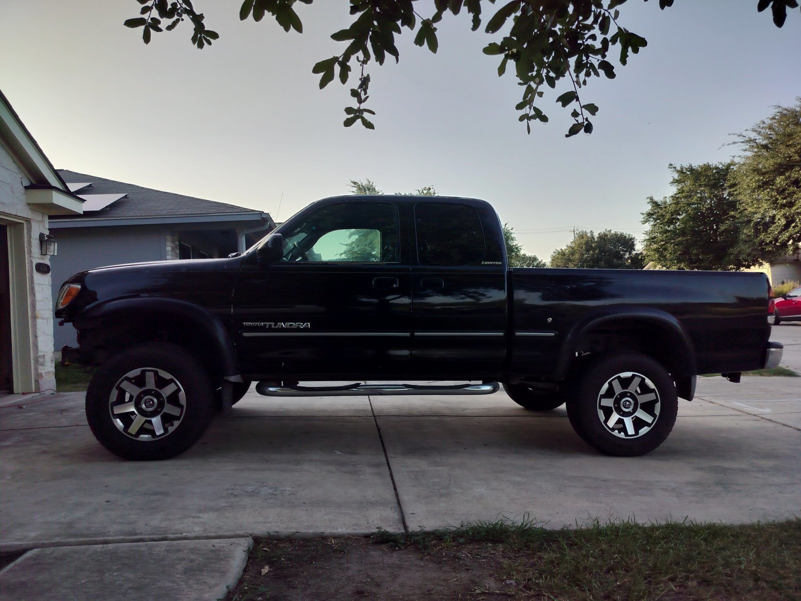

    What's the ride height look like

    Good question......
    If our maths are right it'll be about 1/2 taller than it was in the front
    Edit: Ground to front fender liners is 39 1/16ths
    Ground to rear fender liners is 38 7/8ths
    So pretty fucking level 3/16ths of an inch difference. And I'm sure the fronts will settle down in a month or so and I'll remeasure.

    Wheel wells for the flatbed.
    Looks out of place to me. Like a tractor or a piece of machinery. Gonna have hella storage.
    I've got a little trick up my sleeve for the bottom storage area.
