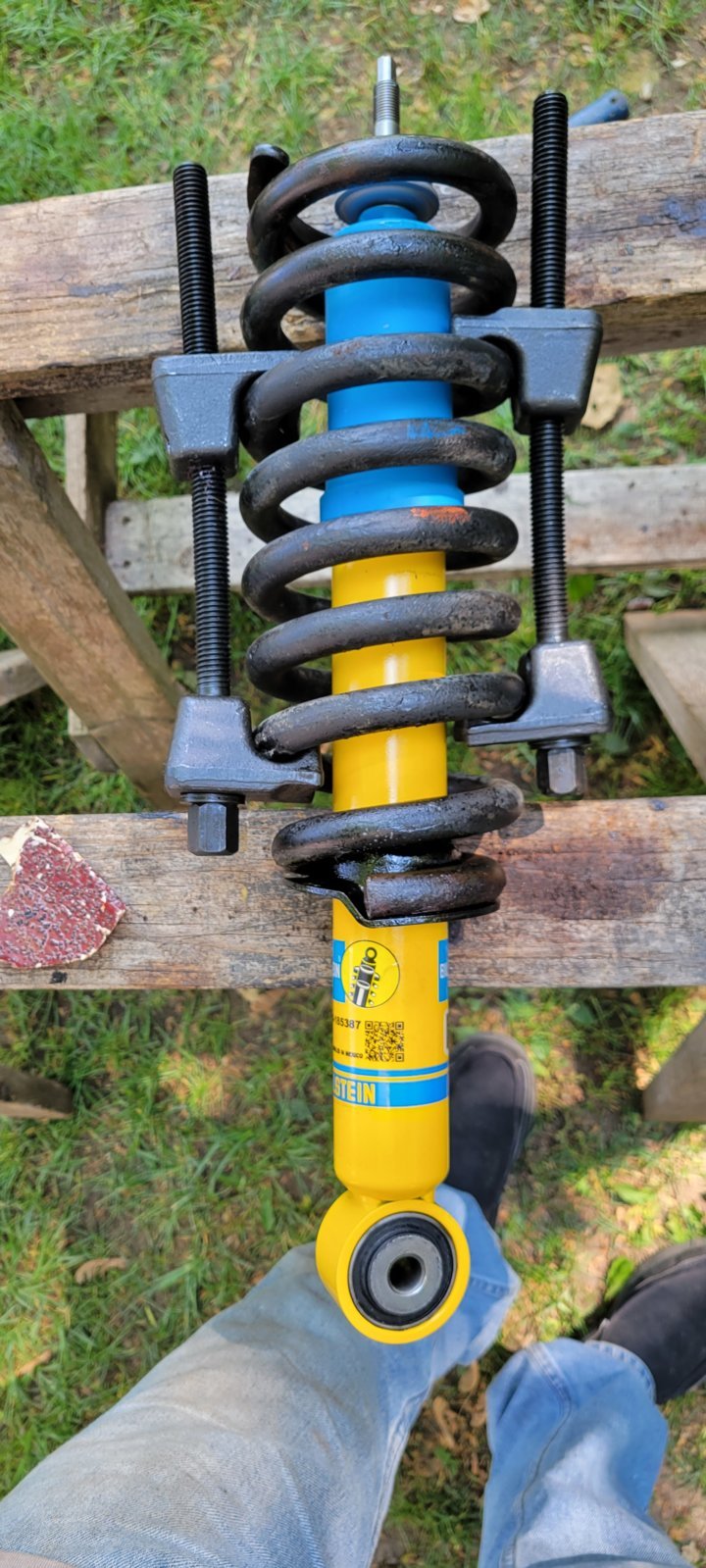

    Interested to see if those rough country coils work with the Bilsteins.

    Not sure if you were just raising the circlip or not, but next time I recommend the “no spring compressor” method. Probably takes a bit longer, but way safer.

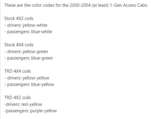

    @VR6T I think my old coils are marked to be oem TRD's. pink yellow/yellow yellow. You are welcome to them for the cost of shipping.
    I know this doesn't help today, buuuuut.

    Don't remember where I clipped this from, but I went through this identifying thing when I replaced mine.
    Obviously didn't help me..... (Red-Blue) JY supposedly said it was 2000TRD 4x4

    Well that only took all day ..... Luis came over thank God, and helped me figure it out. Pro tip of you have rough county springs and are going to put Bilstein 5100s on, just throw the springs out with the old shock body's and get factory springs

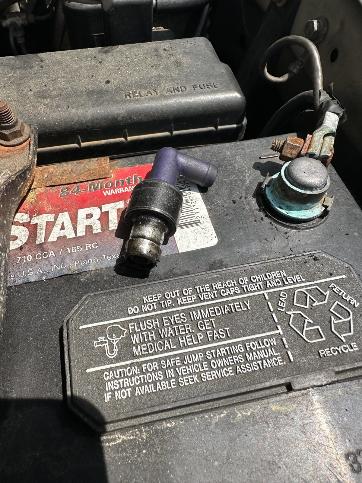

    looks like you're getting some green on the negative terminal post. Give it a scrub before you turn on the heat this fall. (house heat aka Thanksgiving day for you southern folk.)

    you put the spacer back on top????!?!!!!?!

    Yeah I never planned to delete them
