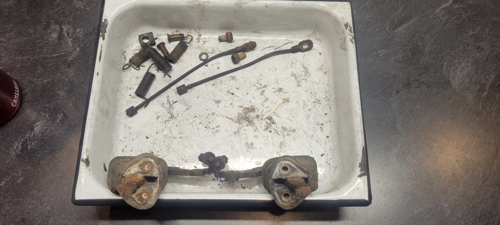

    Had not turned a wrench on the ole girl in a while... it got me out of a little slump and made me feel good.

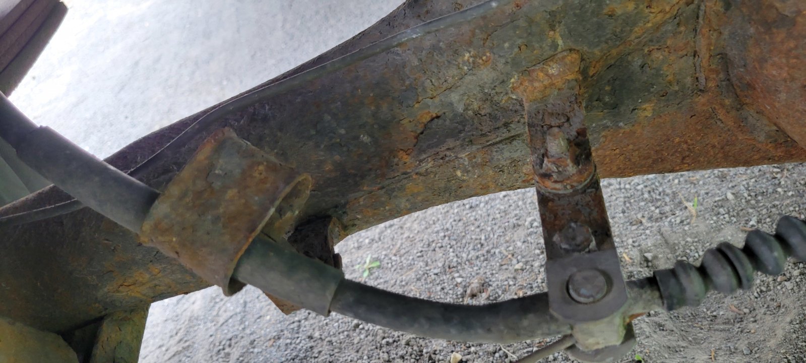

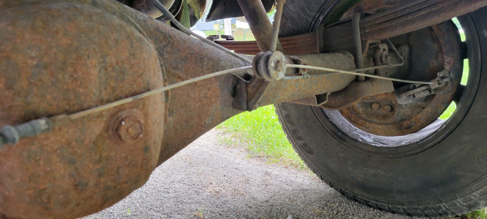

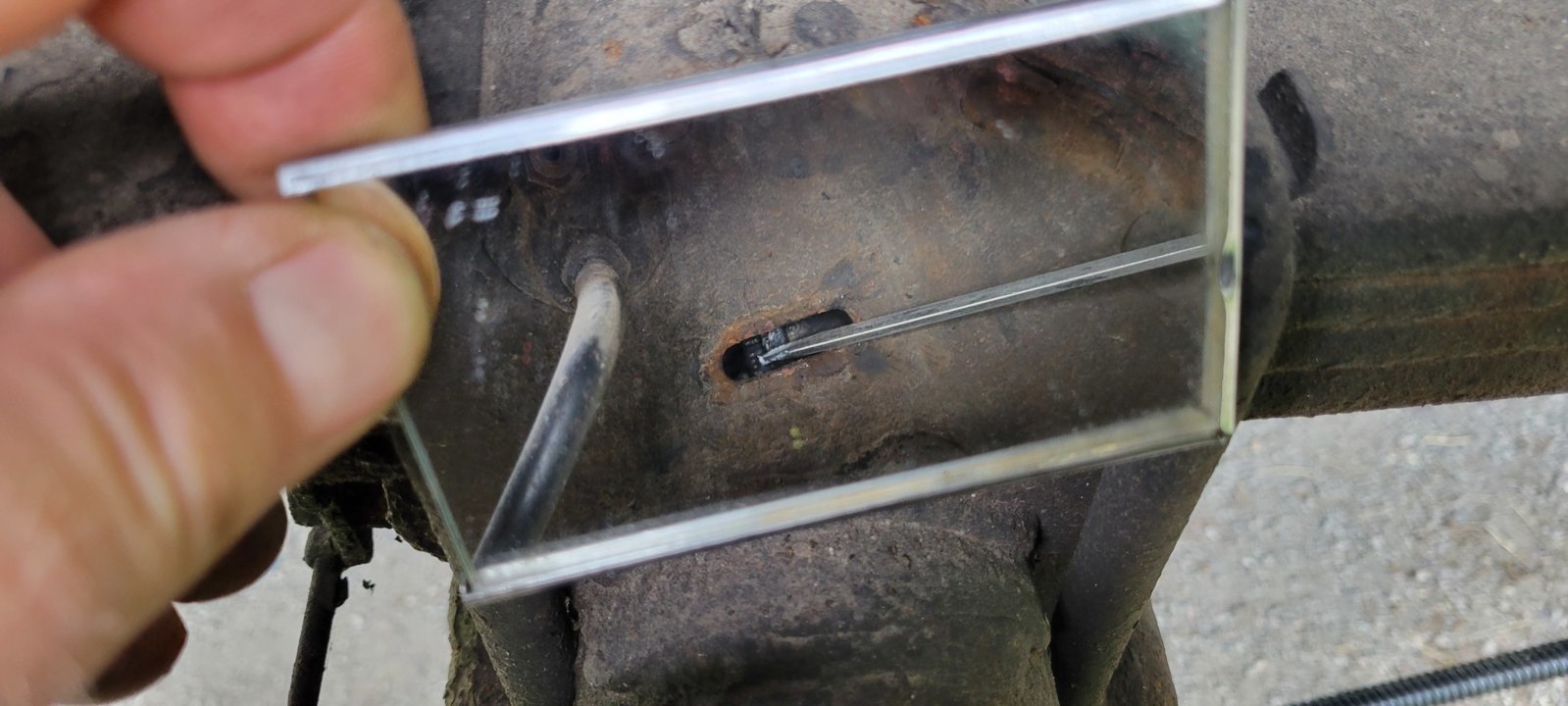

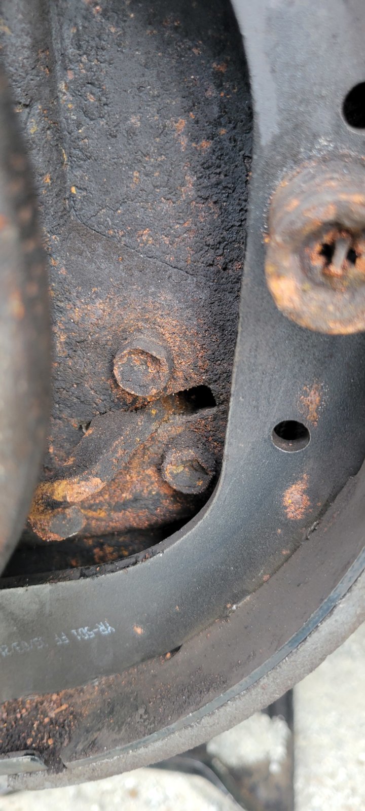

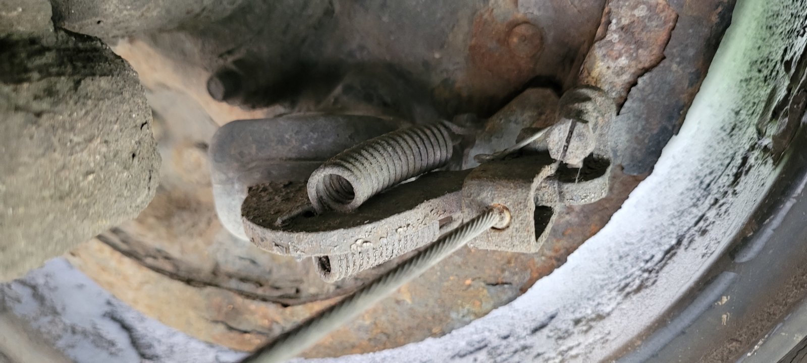

    Up for a challenge apparently. Bell Cranks/Parking brake nonfunctional for Years
    Driver side
    Pivots got working pretty easily, no problems.

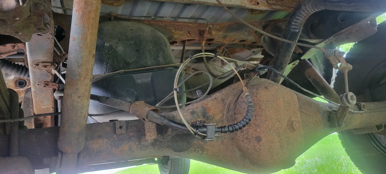

    The NO-SAG reach around cable run... interesting.

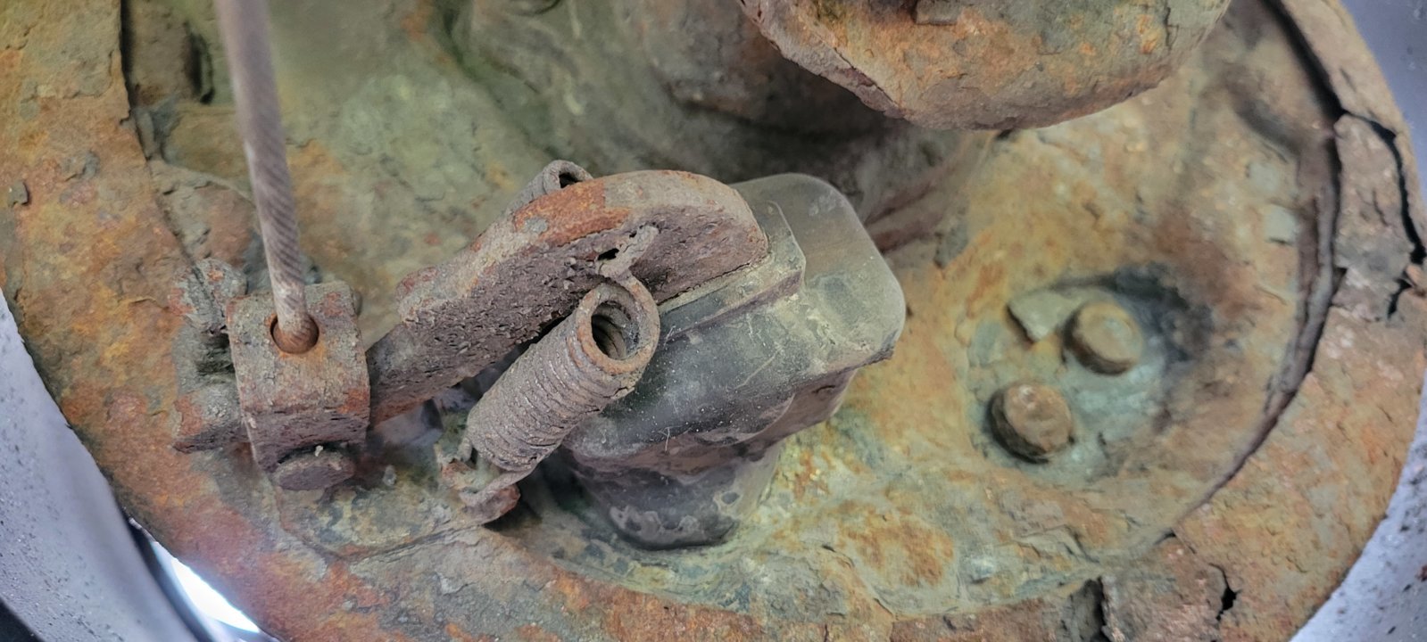

    Passenger side. Everything on these cranks is frozen up tight AF
    Bolts, pretty sure these were 13mm to start, a solid 12mm now

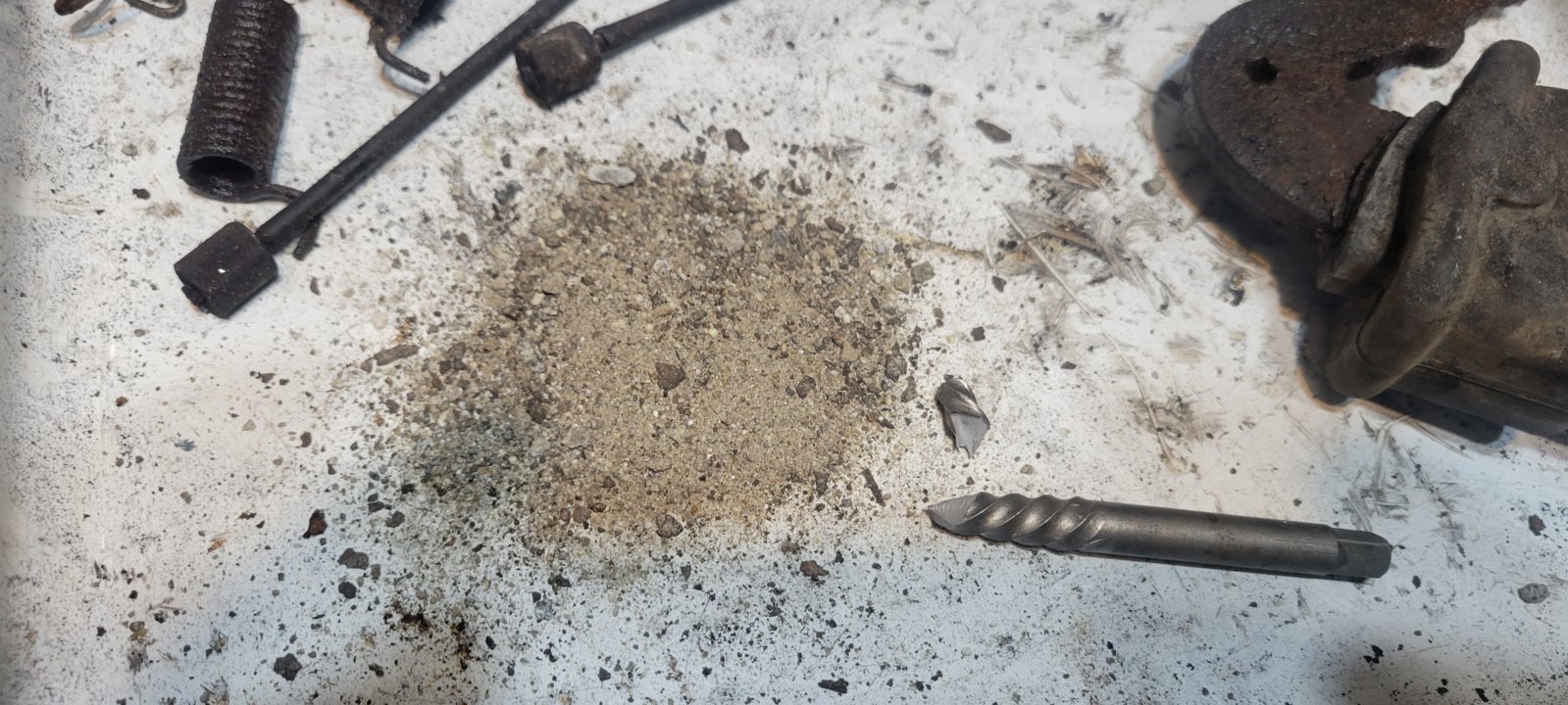

    Drivers was about as expected. Looks like aluminum in there. A ton of white powder under the boot. sniff sniff
    Got the Passengers side to come free, bonus!
    Tucked away the cables while I test my patients extracting the broken bolts, and freeing up the arms on the bell cranks.
    Did the manual adjustments while I was there. (wheels up/neutral/make them drag a bit) Learned how to reach around and install the grommets by feel with the wheels on... forgot to put them back beforehand.
    Last October when I did the brakes for the first time in the rear/and adjusted the rears like this it took at least 2in of down travel off my brake pedal!
    Thinking about stripping the boots off and soaking them in vinegar, maybe ATF... for a few days. Taking advice and recommendations :thumbsup:
    Could be a lost cause, but I have patients.
    Anyone used the set of bell cranks from Rockauto? Curious of fitment/quality.
    Ill post my progress on these crusty little barnacles though.

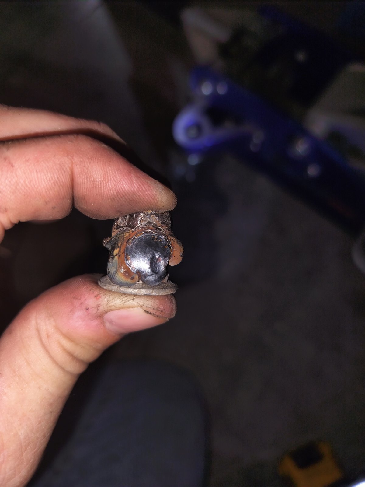

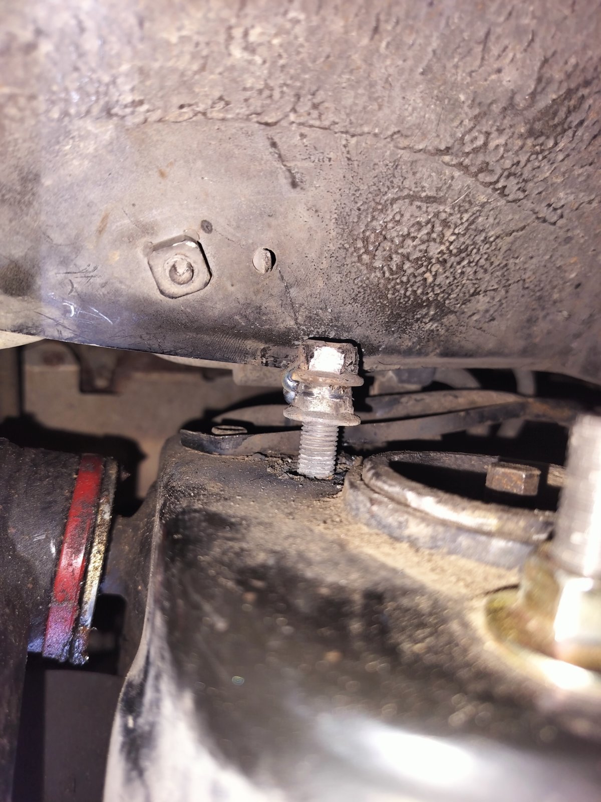

    OEM+, 6+1 bastard pack, 4.08 swapped rear end, custom spring shackles, 3 inch flat lift. This list will grow
    Fuck that nut

    Is that green mold??
    FrenchToasty likes this.
  11. Jul 9, 2024 at 5:38 PM

    Where Jack? I see some green on the closeup of the broken bolts... is that it?

    Maybe my eyes are going but everything has a green hue and the backplate looks partially green.

    Its the lighting, I promise you its Solid Effin Rust hahaha

    If you can put the parts in a tub, either oxalic acid mixture (get the granules to dissolve at hardware store) or Evaporust.
    If the parts are installed and rusted in-place, slather on Naval Jelly from Loctite, rinse after 30 mins. Repeat a few times. It'll eat the rust out.

    You say that, and you're not wrong but I torqued the weld off the first go around. Had to get the 5 pound mini Thor to break it loose. Motherfucker was on there. Aaron and his fucking impact gun.
    Added a little anti seize to all 6 so when I go to put the new ones in Saturday after work I won't have an issue.

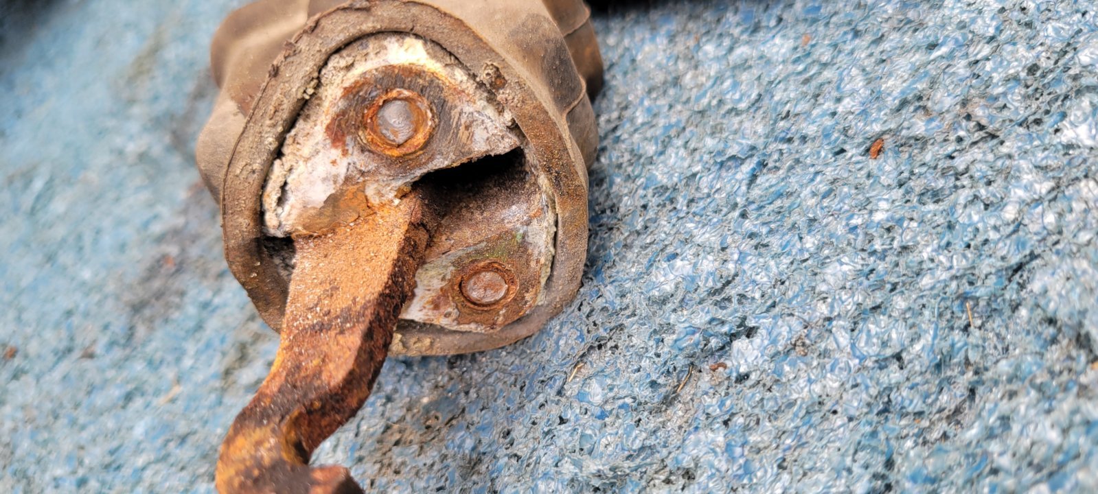

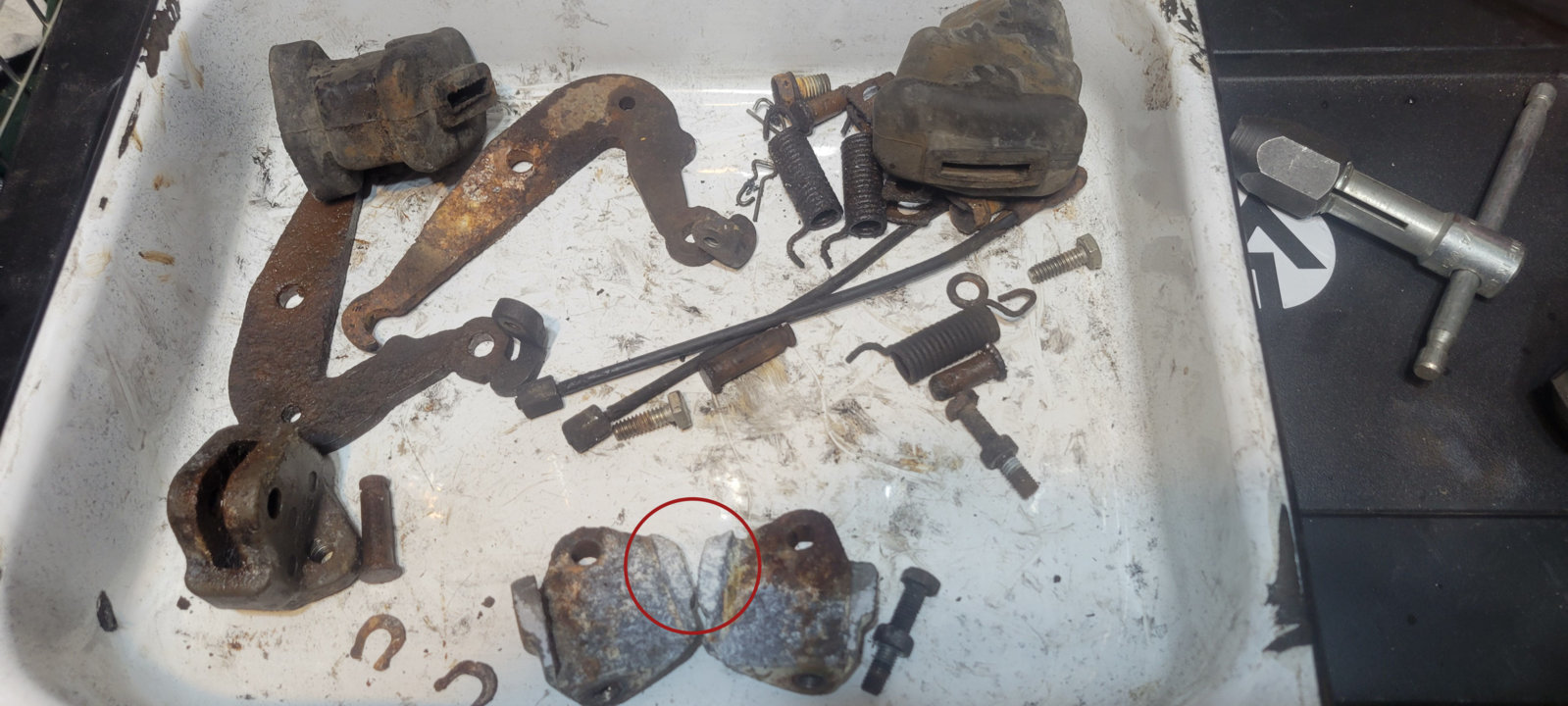

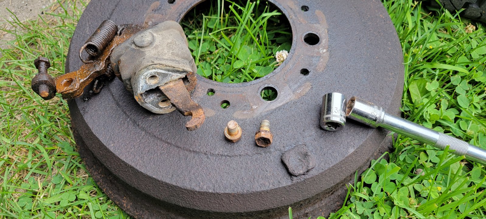

    I drilled and tapped the holes 1/4-20, pressed out the pin on the arm
    Then I noticed it was already split completely down one side. and then it fell apart...
    The other side I dismantled just for S&G I guess?
    Ordering new.
    Old break with corrosion in it.

    Were they frozen? Sounds like the PO did zero maintenance.
