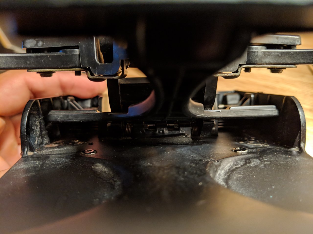

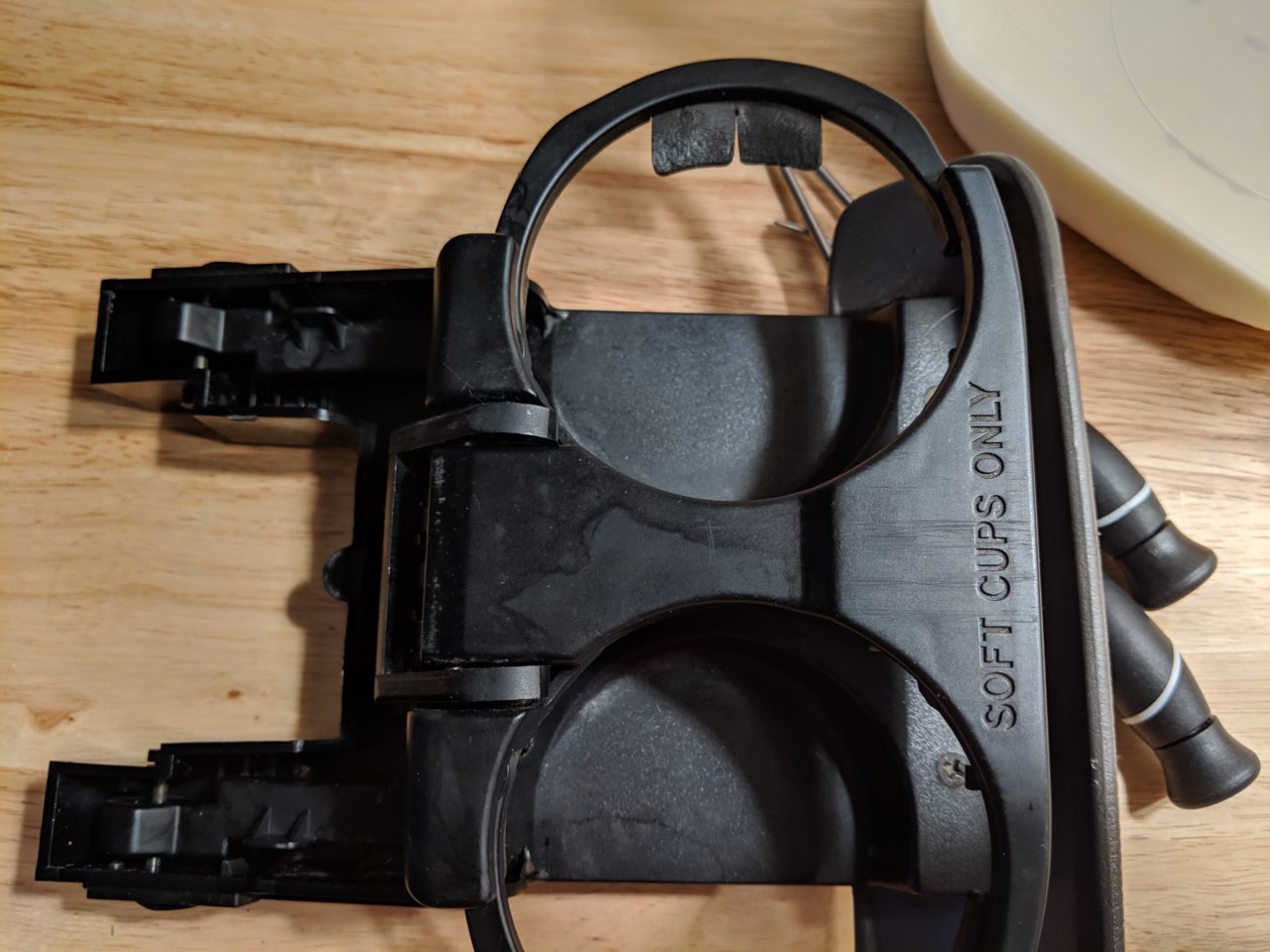

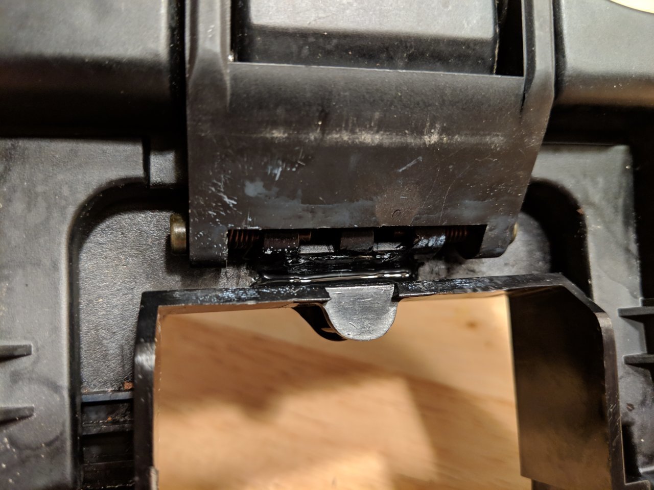

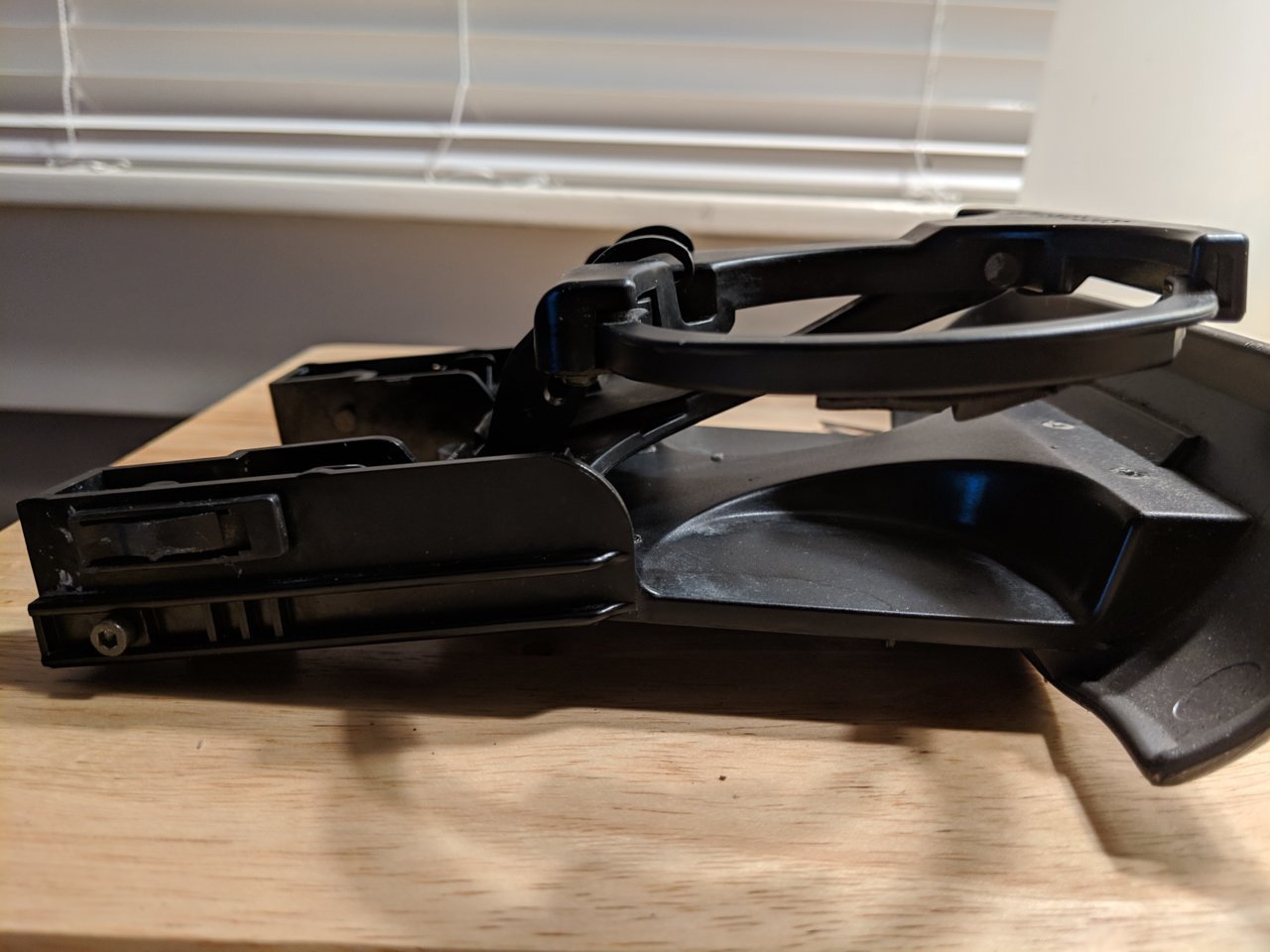

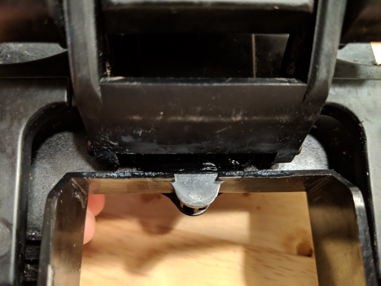

    Figured I'd try to do something productive on this rainy Saturday. It was an ideal time to see if I could save the 30 to 50 bucks on ebay, or even 300 bucks at the stealership. Pulled the cup holder out by removing the two small screws in the sides of the cupholders. I then inspected and figured out where it broke and what it was supposed to look like before it broke. Had some epoxy and super glue leftover so I didn't have to make any runs for any supplies. I then maneuvered the broken piece back into place and mixed up the epoxy and then applied liberally. I then used the super glue on the other side, I didn't know which one would work better. I let those both cure while I went exploring in our national Forest.
    When I returned I was able to finesse the two springs back into their original home. That took awhile! The following is the outcome, that I'm pretty pleased with. IMG_20190420_224759.jpg IMG_20190420_224748.jpg IMG_20190420_224735.jpg IMG_20190420_224726.jpg IMG_20190420_224650.jpg IMG_20190420_224638.jpg IMG_20190420_190655.jpg

    Try some PB Blaster ‘Silicone with Teflon’ spray on those runners. Worked wonders for me. Work best AFTER the spray dries.

    What's going on man, can you tell me which two screws you removed from the cup holder? Mine is filled with dog hair from the PO and I can't clean it without taking the whole thing out. Never figured out how to do it though.
