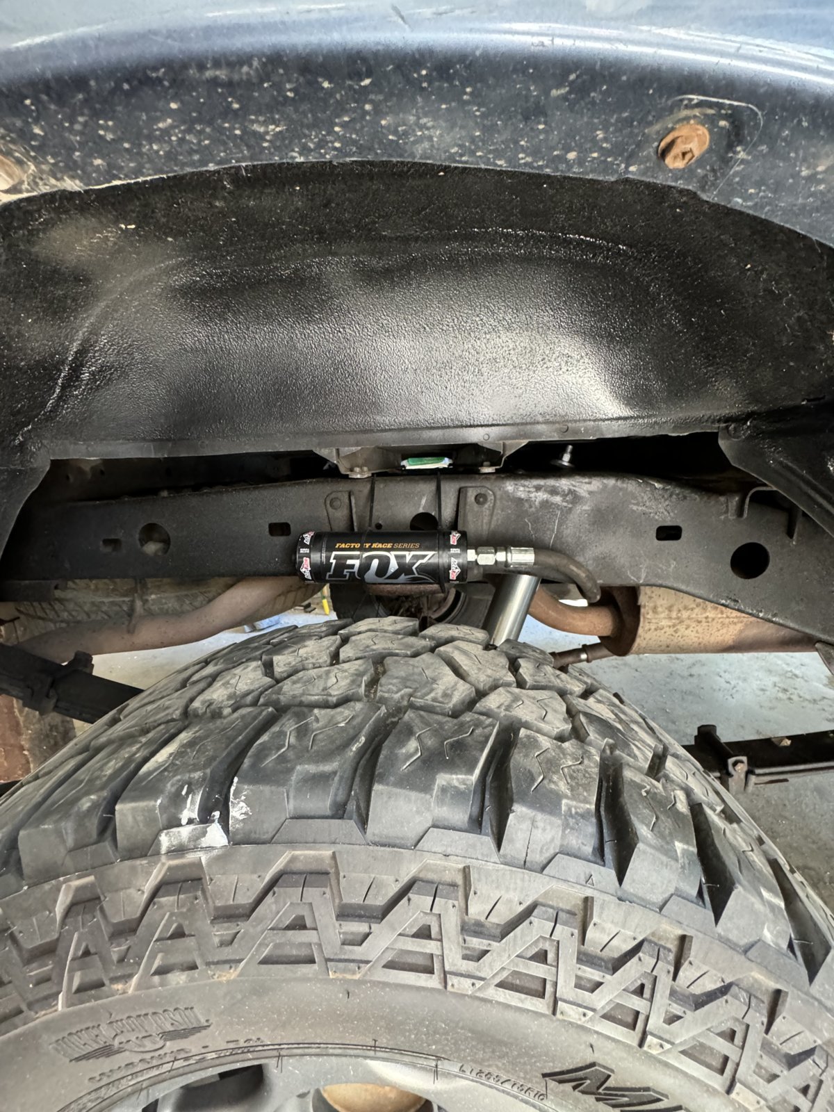

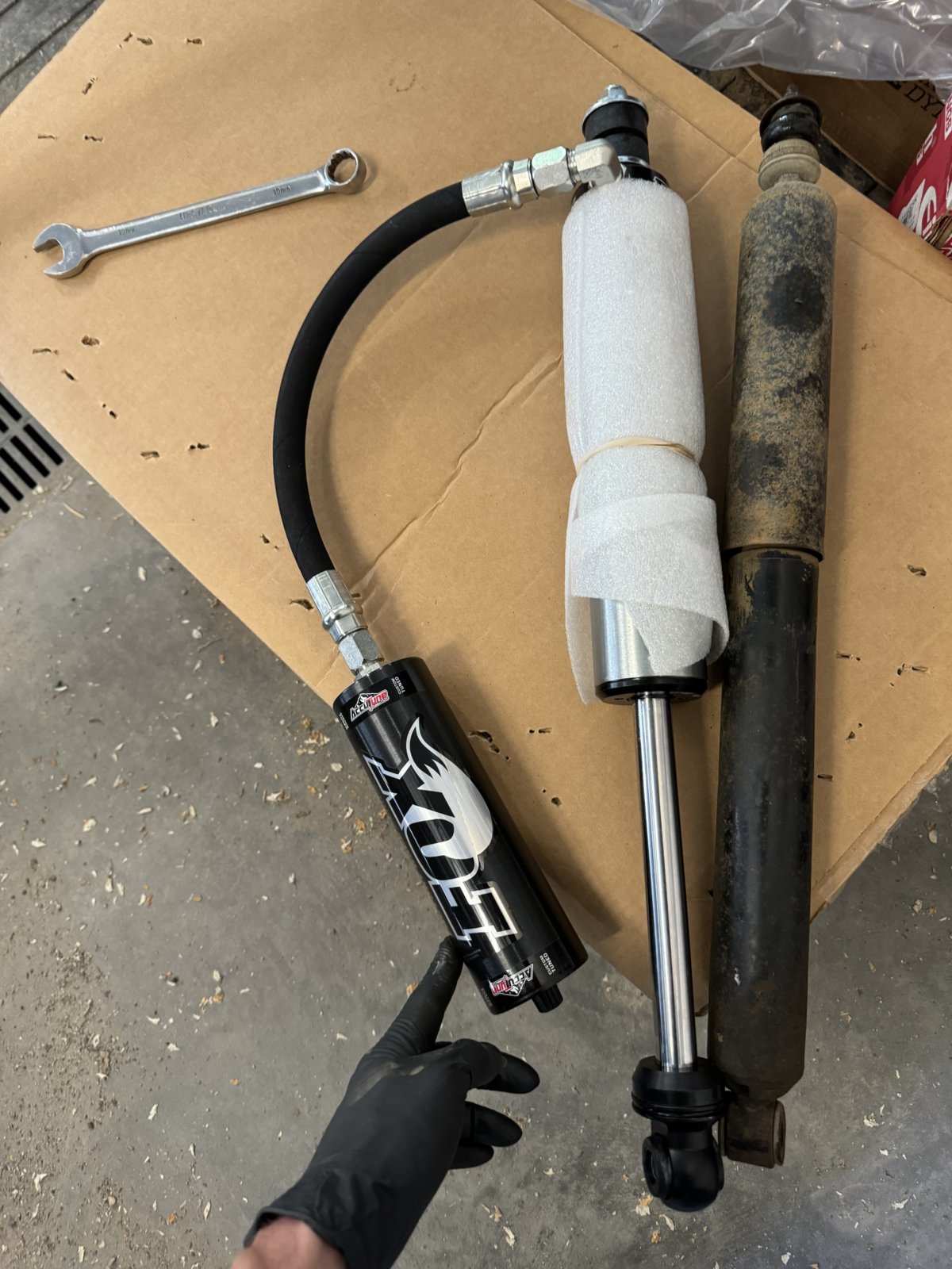

    Got the rear shocks replaced. One step closer to the rear suspension being done. I did each side during my son’s nap. So that was a big success.

    Sweet upgrade!
    How much those set ya back?

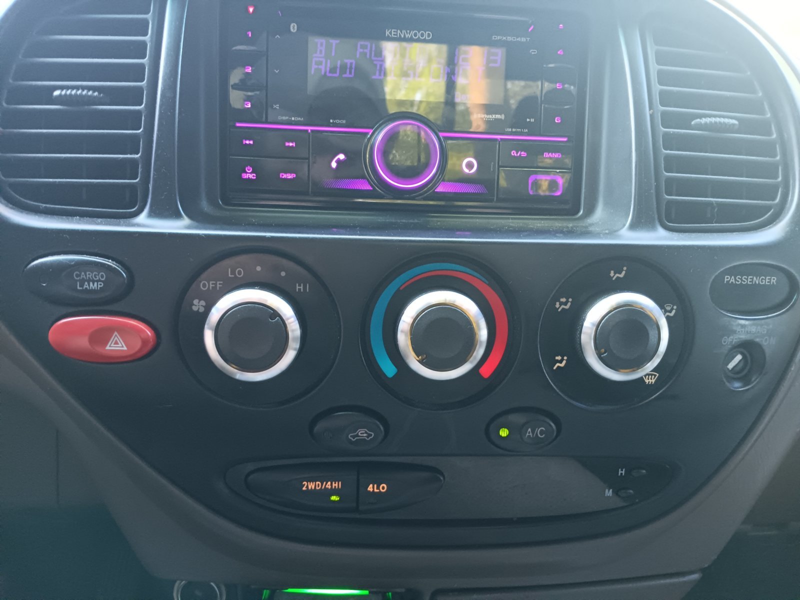

    yo where did you get that red hazard button?
  7. Jul 7, 2024 at 5:16 AM
    The Black Mamba
    Sep 6, 2023
    #103472
    4,509
    Ryan
    DFW
    Black 00 SR5 AC 5VZ PreRunner
    Imma keep it stock
    That’s the OG Tundra hazard button

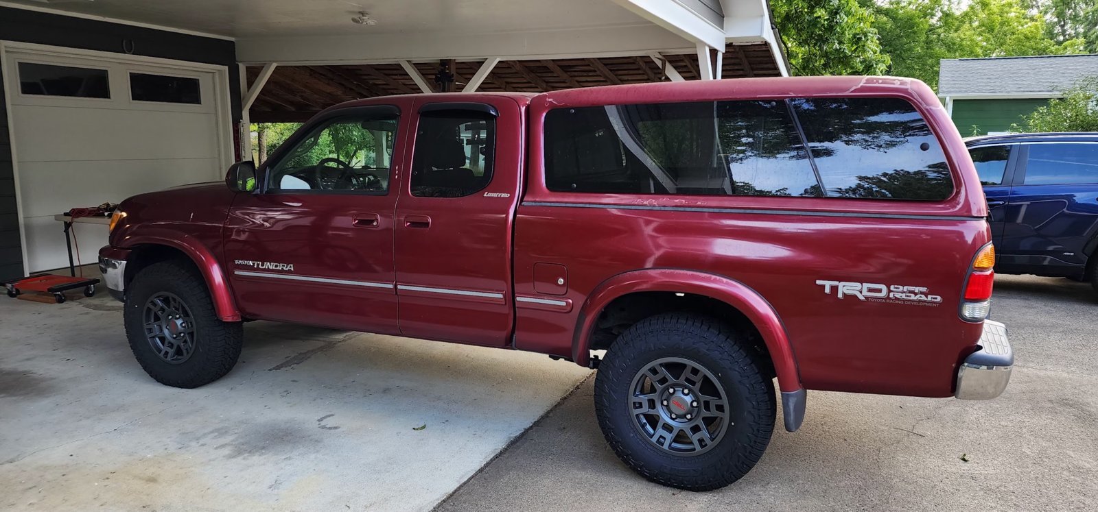

    Reporting back after 6112, UBJ, LBJ and Tie Rod end replacements and driving a bit:
    Overall - huge improvement in ride quality.
    1. Front end now feels "Factory" - was loosey/goosey before - - the UBJs were original, I believe. 140K miles on truck. Had PO new Moog's on the bottom - replaced. Nothing "appeared" loose on the BJs on physical inspection, but it drives amazing now.
    2. IMHO, do yourself a favor and just remove the steering knuckle/hub if you are doing the UBJs - you can set you press in a vice, etc. (see pic). BTW - avoid your impact wrench on this.
    3. 6112s are feeling great - happy with the swap. The 5/3 clip seems to have leveled and provides a really nice ~1-1.5" lift.
    4. Got rid of the wheel spacers (previously 285's w/ 4Runner TRD wheels) and went with the TRD Pro wheels and 255/80R17 Falken Wildpeaks.
    Next up: 1. Getting the dual batter system attached to outlets inside cab for fridge. 2. Making a platform for the back area that is level with storage for fridge / dog bed.

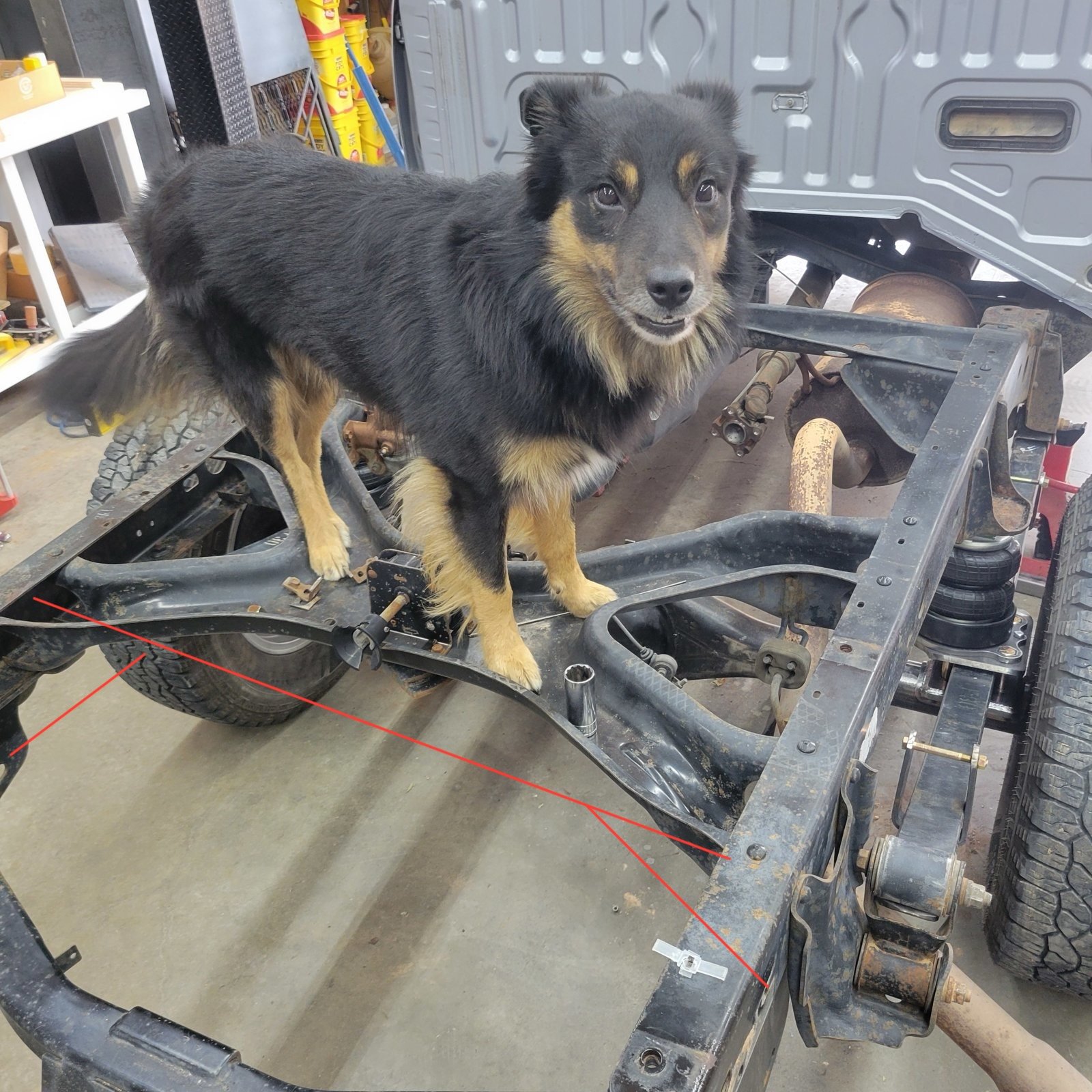

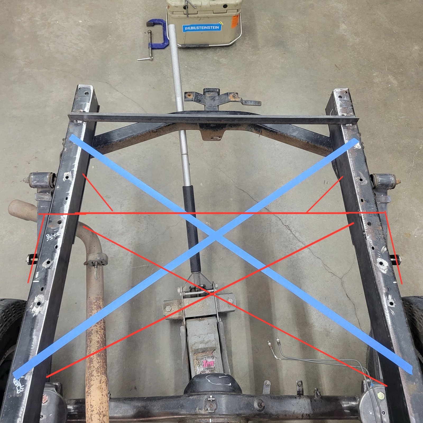

    The angle iron is just a temp brace for the topside of the frame. My old man joked that it was going to peel apart like a banana when I pulled the spare tire crossmember. The hitch is controlling any movement on the bottom side.
    Ultrawide camera and a slightly skewed perspective makes all the angles look wonky. Interestingly enough did anyone know the pinion is offset to the passenger side 1" and some change?

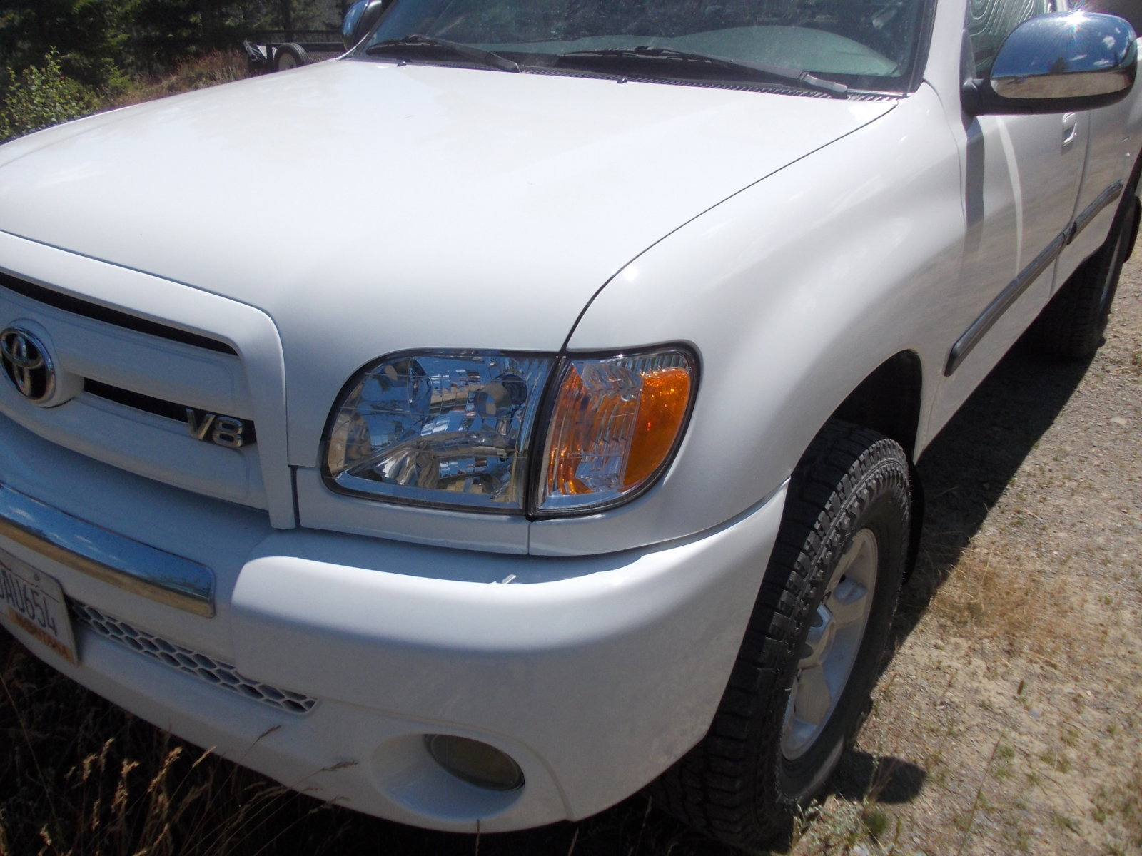

    Wait, why’d you need to paint it though? Was the original single stage paint blown thru, down to the primer? Or was it just chalked? White trucks are all from the factory with single stage and can be buffed back to clear with less than $100 in supplies. @FirstGenVol and I both had white trucks that looked like a piece of chalk, and with simple tools, got it shiny again. Here’s a shot midway thru on mine, with the cab still matte, and the bed shiny as hell: https://www.tundras.com/post/1814972

    Dremel with a cutoff disc to cut thru the nut. It’ll spin or bang right off at the split.
    Didn’t know that about the pinion favoring one side. Recognized the angle purpose, your pops is right, that and jack stands to support rails is one of those “if you don’t do this, you’re fucked” things I’ve had to do with trucks I’ve notched and bagged in the past. I failed to notice there was no spare tire xmember, holy crap! I doubt it’d have peeled like a banana, but I wouldn’t risk potential twist that’d be a pain to resolve later. Anyway, was just curious, didn’t know if you had intentions to build something up off the frame rails back there, or if it was purely to stabilize the rails.
    I assumed he drew the arrows on his for a reason. I do the same on all my leaf packs, I always draw an arrow, and if they are t universal, I’ll put an L/R or D/P designation on each.
    Definitely pull the knuckle, even for 4WD, makes it hella easier. Smart move!
    And to that point, for reference, questions:
    Are you 4WD?
    Can you share a pic from the side vs. at an angle, while you’re on flat ground?
    Did you take before/after measures so you knew how much higher you are now?
    What is your current measure up front, on flat ground, from the concrete to the bottom edge of the fender flare?

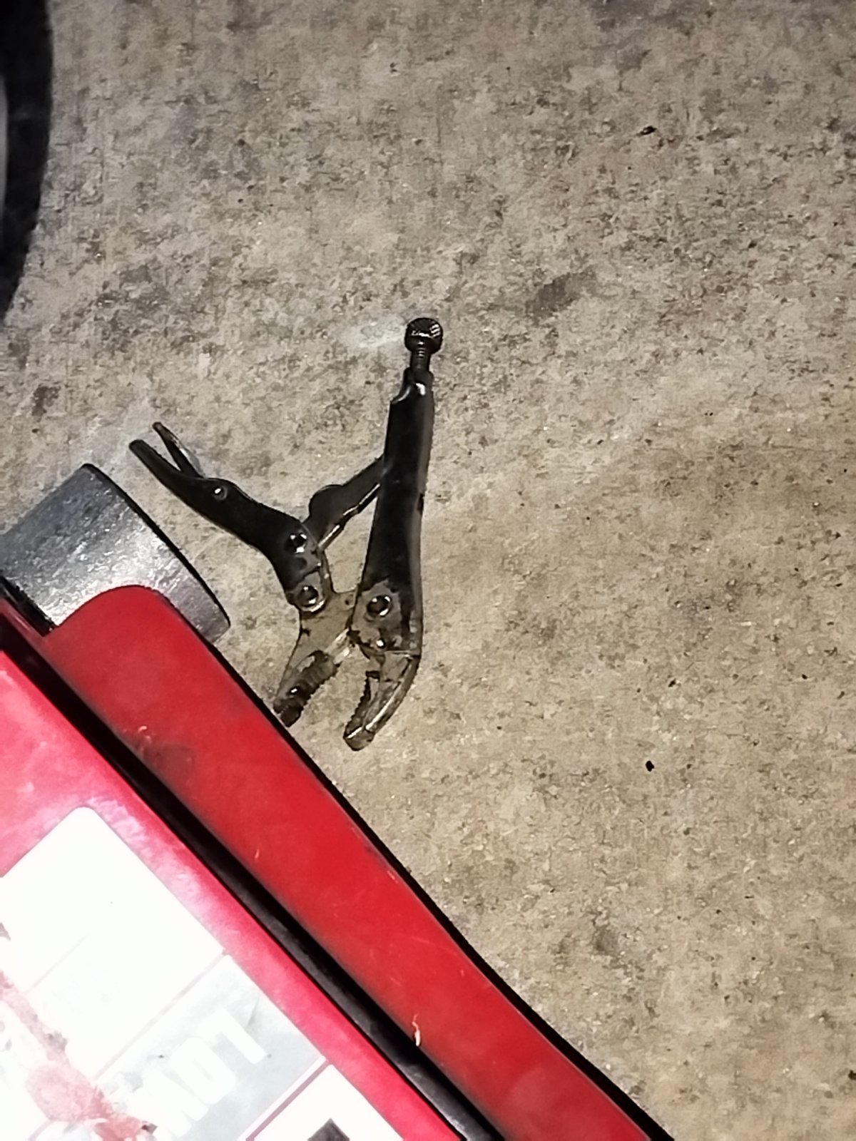

    Luckily these actually came off just fine. I used some big vice grips to hold the shock shaft and a ratcheting 14mm wrench to get the nut off. @455h0le_dachshund is right though. Bring out the sawzall or if the shocks are totally rusted I’ve bent them back and forth until the shaft snapped.

    These came out less expensive since they don’t have the DSC. I decided to give Fox a try on this truck to try something new and they’re cheaper than ADS. I got some input from @daveeasa and they’re for a 2005 Tacoma but Accutune re-valved them for my tundra.
    I still need to find a permanent spot for the reservoirs and pull the damn blocks out. Then of course find time to do the fronts.

    What's DSC?
  17. Jul 7, 2024 at 7:53 AM
    daveeasa
    Dec 2, 2020
    #55605
    4,192
    David
    Dual speed compression. One knob for slow compression stiffness, one for high.
    I should try adjusting mine more. I have all 3 trucks on full soft.
    basically one adjustment for speed bumps on pavement and one for washboard gravel roads at 40 mph.

    @shifty`
    Questions:
    Are you 4WD? Yes
    Will do, but have a thunderstorm here right now.
    I bought the truck with 5100s on them, already lifted, but also didn't measure.
    37.5" on the fronts
    The backend springs are the General Spring's "2000 - 2006 Toyota Tundra heavy duty rear leaf spring, 5(4/1) leaves."

    I agree about the factory white being single stage. Mine just had lots of dings and rock chips and small gouges and scratches etc from 20 years of nature. Now it has enough paint on it that it won't burn through when I buff it in a few years. After painting I installed new OEM headlights and turn signal lamps. I'm looking for a steel front bumper with hardware to replace the bulbous bumper cover.

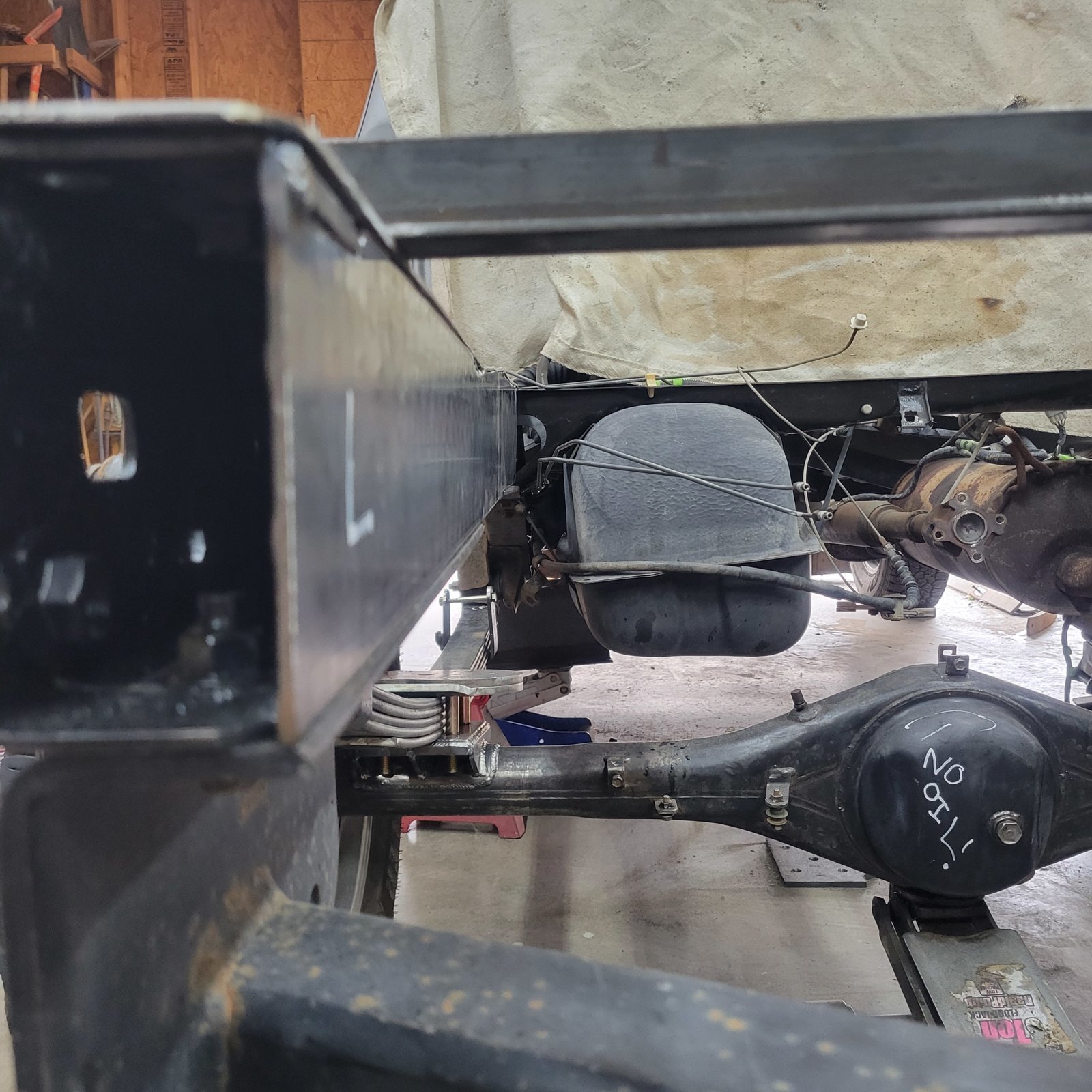

    I cut/fit these frame boxing plates to box the rear frame from the gas tank crossmember to the end of the frame.
    A little bit of a tricky fit as the top and bottom flanges of the frame are not identical. This will give me a good starting point for the tubular crossmember/shock mount.
    I wire wheeled/ospho'd/and rattle canned everything before tacking them into place. I'll treat the box section every so often to keep the rust at bay.
    Thinking something like this for the crossmember. The shock mount will intersect this x somewhere around the white marks on the frame rails. Which reminds me I still need to check the shock length and get those ordered. I already picked up a stick of 1 1/4 x .125 wall seamless for the tube work, so I'll dive into that in the morning.
    Think I'll lay on the couch the rest of the day.

    Put Zerks every 12" and fill that boxed in frame full of grease. For eva eva rustproofed. :cool:

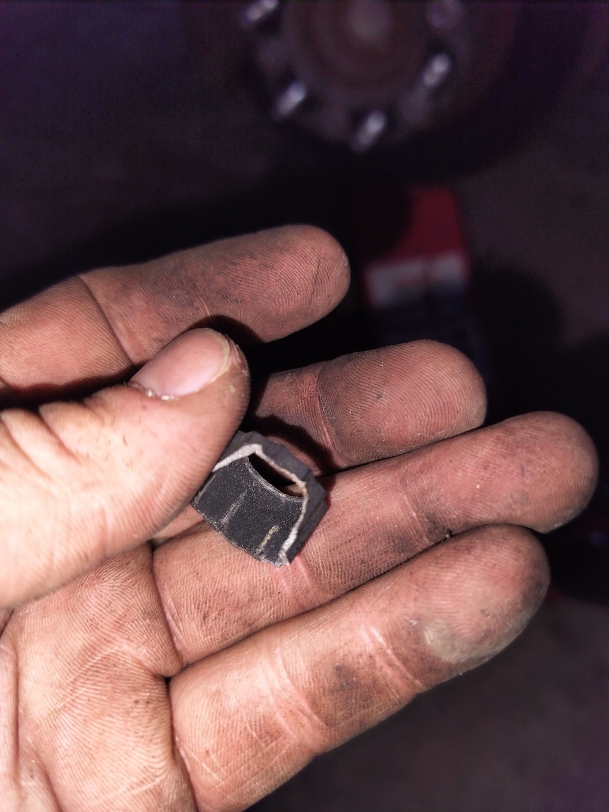

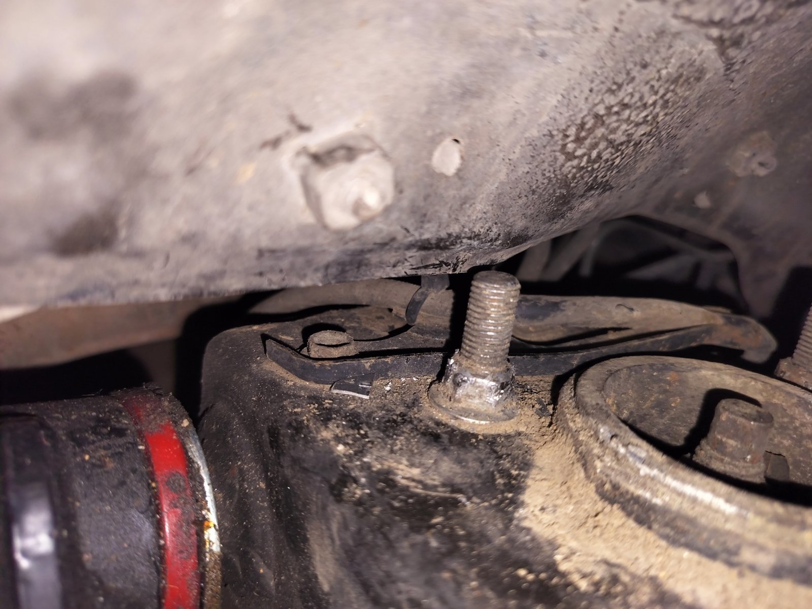

    OEM+, 6+1 bastard pack, 4.08 swapped rear end, custom spring shackles, 3 inch flat lift. This list will grow
    Anyone have any ideas..... Remnants of my coworkers handiwork. Apparently he wasn't as tactful with repairs as I thought he was.
    These were both of my ideas.
