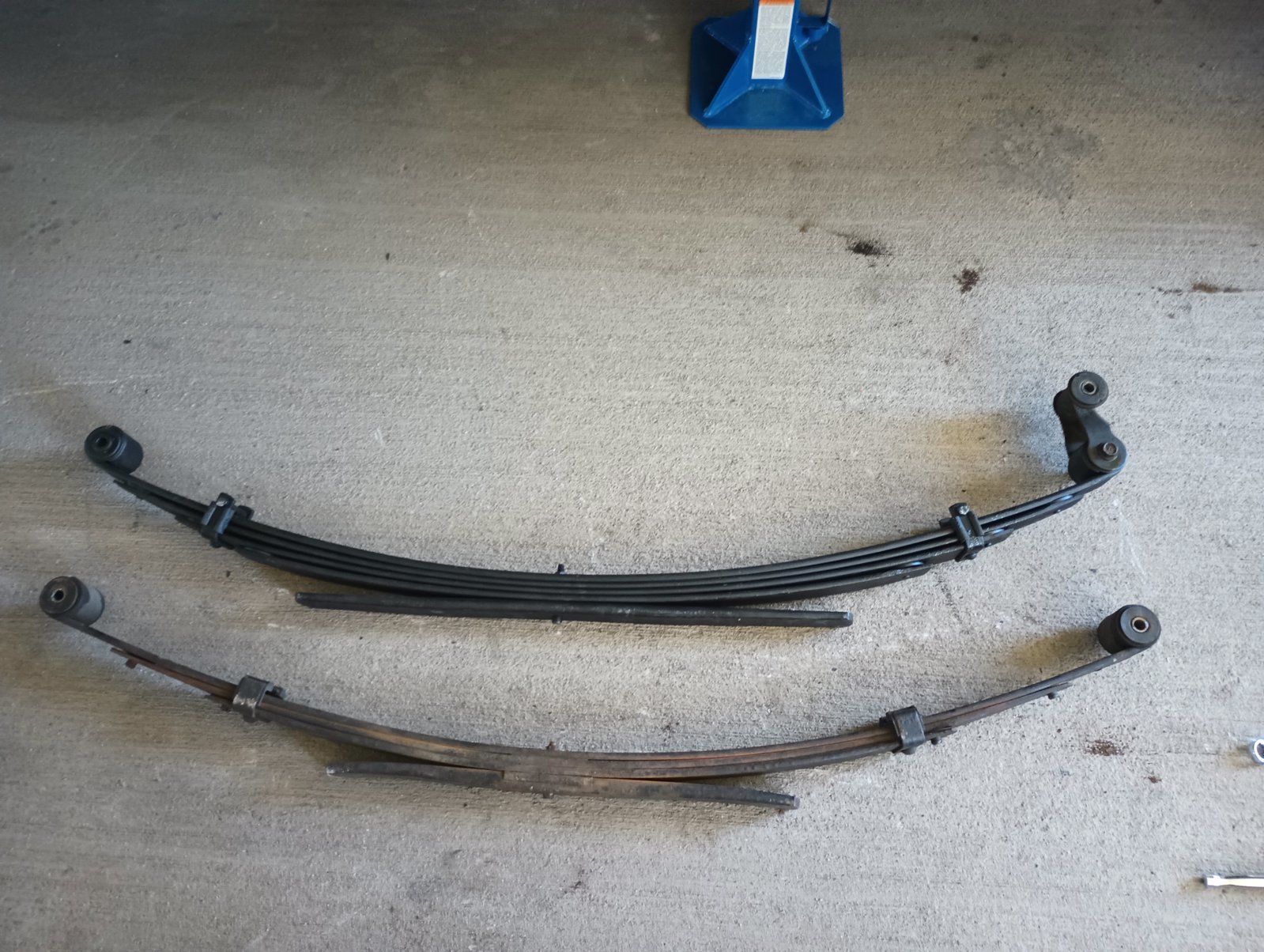

    Nothing like Jakejake but I gotta make do in my apartment parking lot. Used jack, stands, and cheapo Crescent wrenches. Cheater bar = my jack's hollow metal handle. This was a royal PITA to align into the truck and bolt up front eye and rear shackle hole while lining up that center nipple-thing, took multiple attempts removing and putting it back. Really had to muscle that bitch in there. Spud wrench and pry bar (long screw driver) required. Leafs are Husky HD from Rock Auto, and also got new Husky shackle bolts and U bolts, 7/8" size nutsnbolts. Re-used the old shackle as the bushing seemed fine. The Husky spring is much heavier than the old spring, no idea if old leaf spring was OEM but it used 19mm nutsnbolts so I assume OEM.
    I realize the shackle is flipped wrong in photo.

    I use some crescent tools, and would absolutely use the jack handle as a cheater bar.
    I have been using an 18" drift punch to get the bolts slid through, an actual spud wrench would be a good tool to have on hand. Im almost a pro at this point though. The leafs will probably come out and go back in at least one more time. It's always easier the second or third time eh'?
    A big hell yeah for getting it done with what you've got in the space available. :cheers:

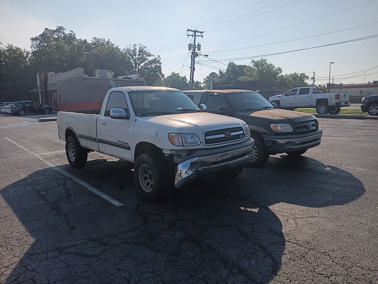

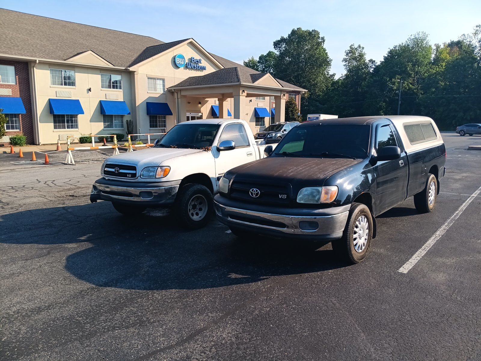

    Sold the cap, eh?
    So when's crackie turning into a DC?

    Hot damn, I didn't realize he signed up over here after I inbox'd him about your cap. Glad to see y'all were able to make it happen!
    Now go hit the JY for a new front bumper skin, Noah! :rofl:
    Love the patina on @Heathnewton36's truck. Welcome to the forum, Heath! I think you'll find this forum to be a better/more functional resource than the FB group.

    Eventually :rofl:
    I told him that I wished my hood would patina like that, jelly

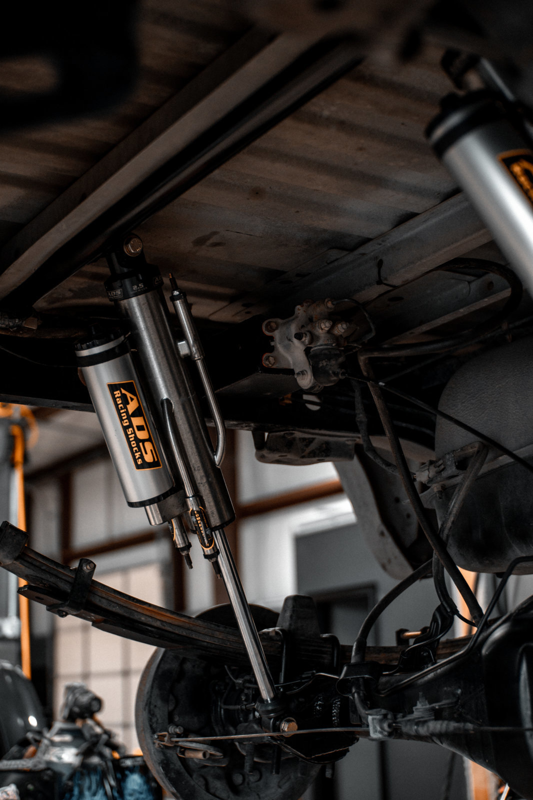

    Did another shock adjustment. Started playing with rebound on the bypasses and this truck is really getting dialed. I just cooked these speed bumps doing 60mph. Extremely stable and doesn’t buck the rear whatsoever. It pops just a hair in the front since it’s still mid travel. Rears have about 4” of shock shaft still before bottoming out… which I still haven’t successfully done and trust me I’m trying.
    Also someone sent me a pic of the archive garage rear shock relocation and I see why mine is letting me do some really rowdy stuff. I’ve got more uptravel due to my upper shock mount being further back. The red line is where my upper mount is.

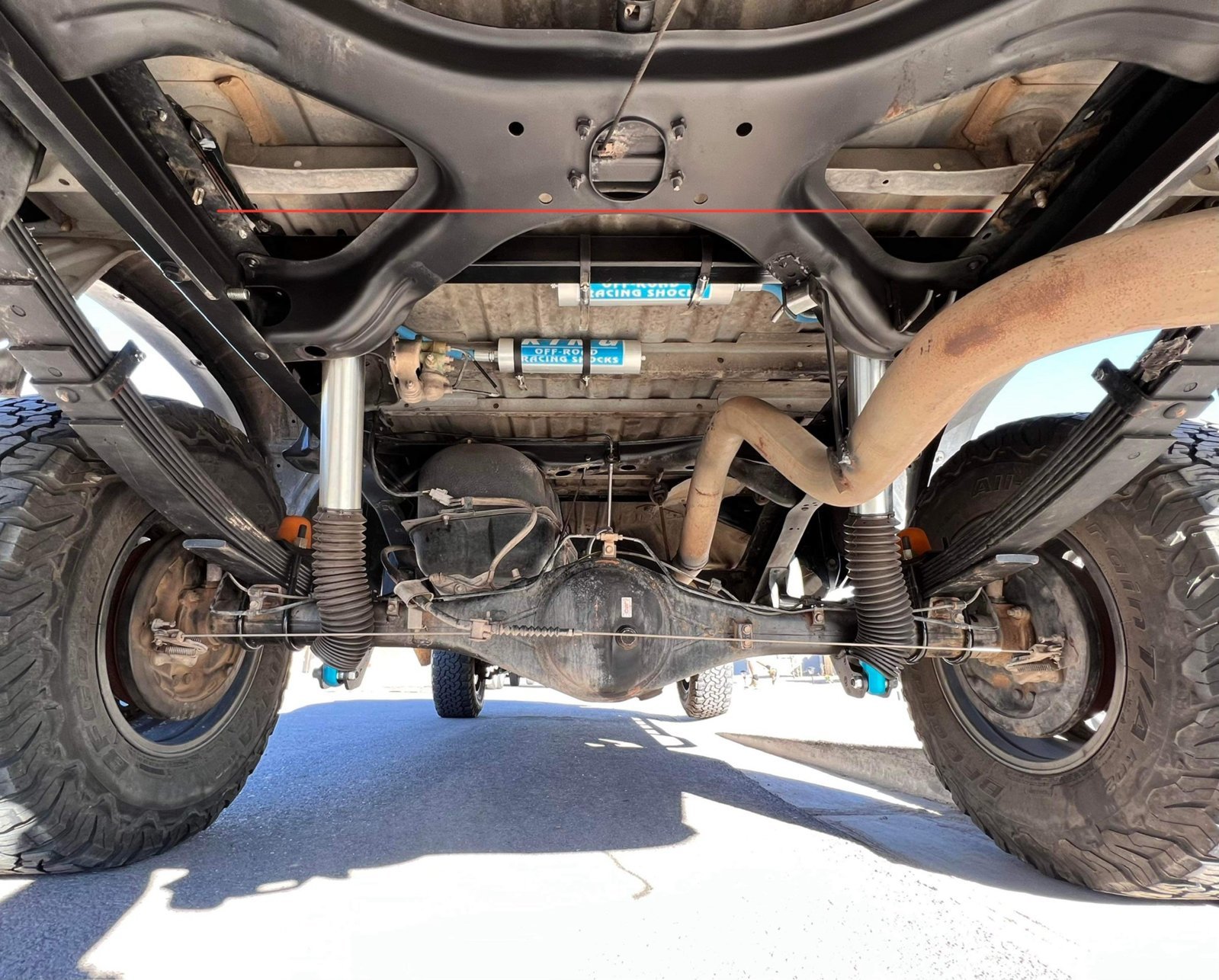

    Back on all four! Here's some beauty shots. Calling this a win for the day. Going to design the upper bag mount a chill out this evening.

    I appreciate the effort that went into this. Super clean.

    The metal work is art with the bolt head cutouts and weld beads ... and Dale's pretty cute too. After seeing this probably need to figure out how to get a CNC plasma cutter some day at home. Did you bend the 90s in the leaf pack holders hot and quench; what is the best process to do it right? And what size pipe did you canoe to fit the axle OD?

    Mmmmmm that's all purrty and cleeeean
    Outstanding job man

    This may be a stupid question, but I thought the “canoes” would be welded to the axle tube?

    Wagon style for quick detach.

    Your pinion angle will hold tight?

    Sorry toasty, I thought that was a joke. I will load it with some weight and set the pinion angle before welding the doubler to the axle tube. Probably tomorrowish.
