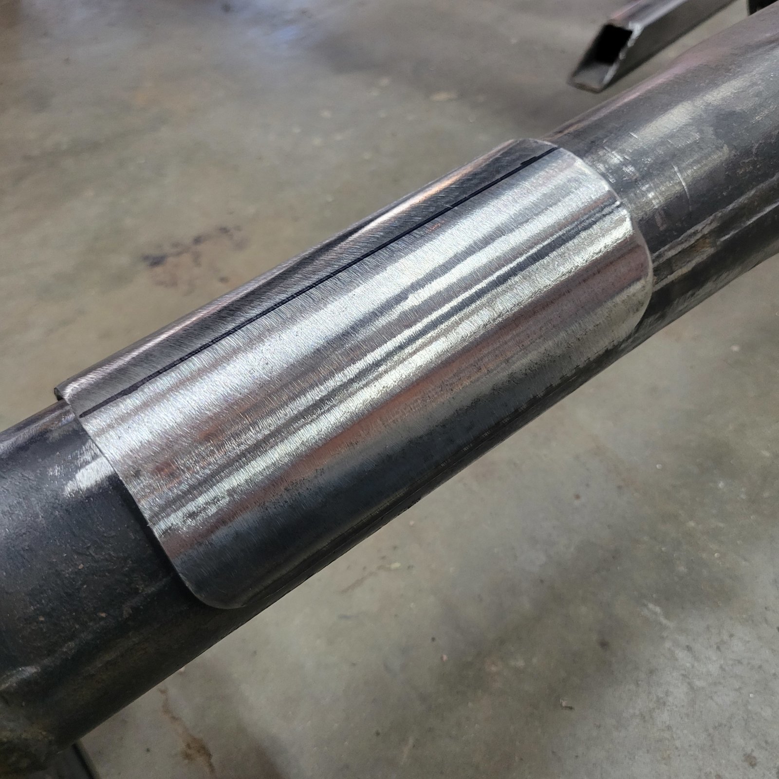

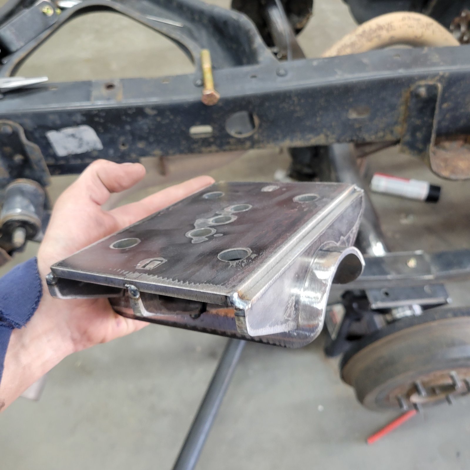

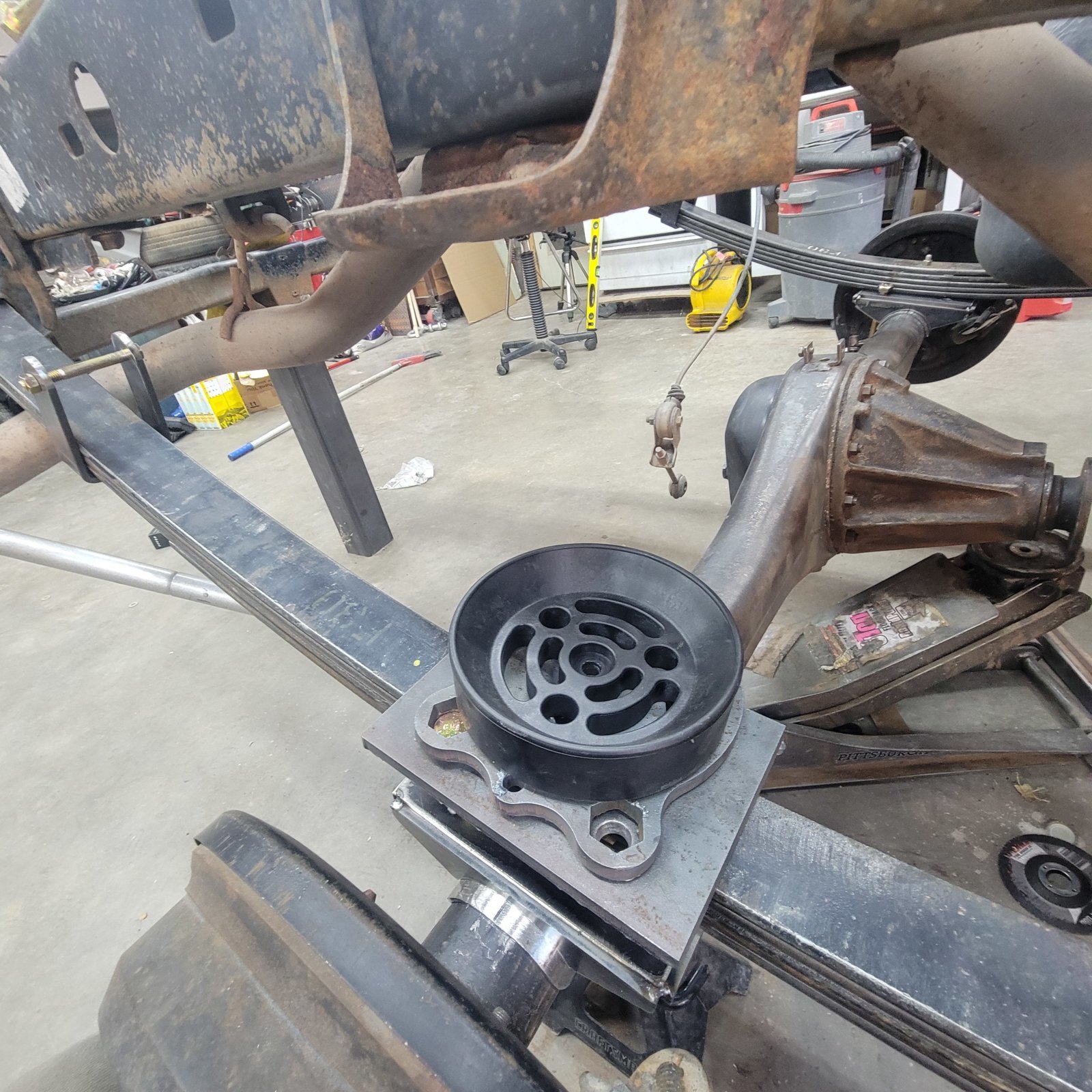

    Woke up an hour before my alarm, and was in the shop by 6. A good thing if I want the truck back on the ground today.
    Made up these doublers to replace the factory units that I peeled off.
    At my desk finalizing the spring perch design for the u bolt eliminator. Wish me luck!

    ya, it’s a WIY kit from coastal offroad

    How did you bend that?
  12. Jul 4, 2024 at 11:48 AM
    shifty`
    Jun 20, 2020
    #48239
    29,461
    ATL
    '06 AC Limited V8/4WD
    I'm going to guess it's steel pipe cut in half and dressed, if not rolled.
    ToyotaDude and JakeJake like this.
  13. Jul 4, 2024 at 12:01 PM
    JakeJake
    JakeJake Slippery Snake
    Jul 19, 2023
    #100515
    1,446
    2000 Tundra AC 4X4
    @shifty` nailed it. It's "canoe'd" pipe.

    Pretty. So why'd you ditch the stock ones?
    At first I thought maybe you'd have gotta Sequoia axle, but then I saw the drums.

    Curiosity more than anything here, but how will you set the angle it'll get welded on, or is there some rule of thumb, like always weld the tops parallel to the pinion shaft? I mean, I realize you can shim if the pinion angle is off, it's what I've typically done on major drops, but I've never built an axle with its provisions from the ground up.
    Are you also planning to weld up provisions for a rear sway?

    Damn, dude. I get jelly every time I see this stuff. Did you cut that with some type of programmable plasma cutter? Very nice symmetrical edges.

    I was thinking the same thing, I’m sure he’s got a base measurement to go off of

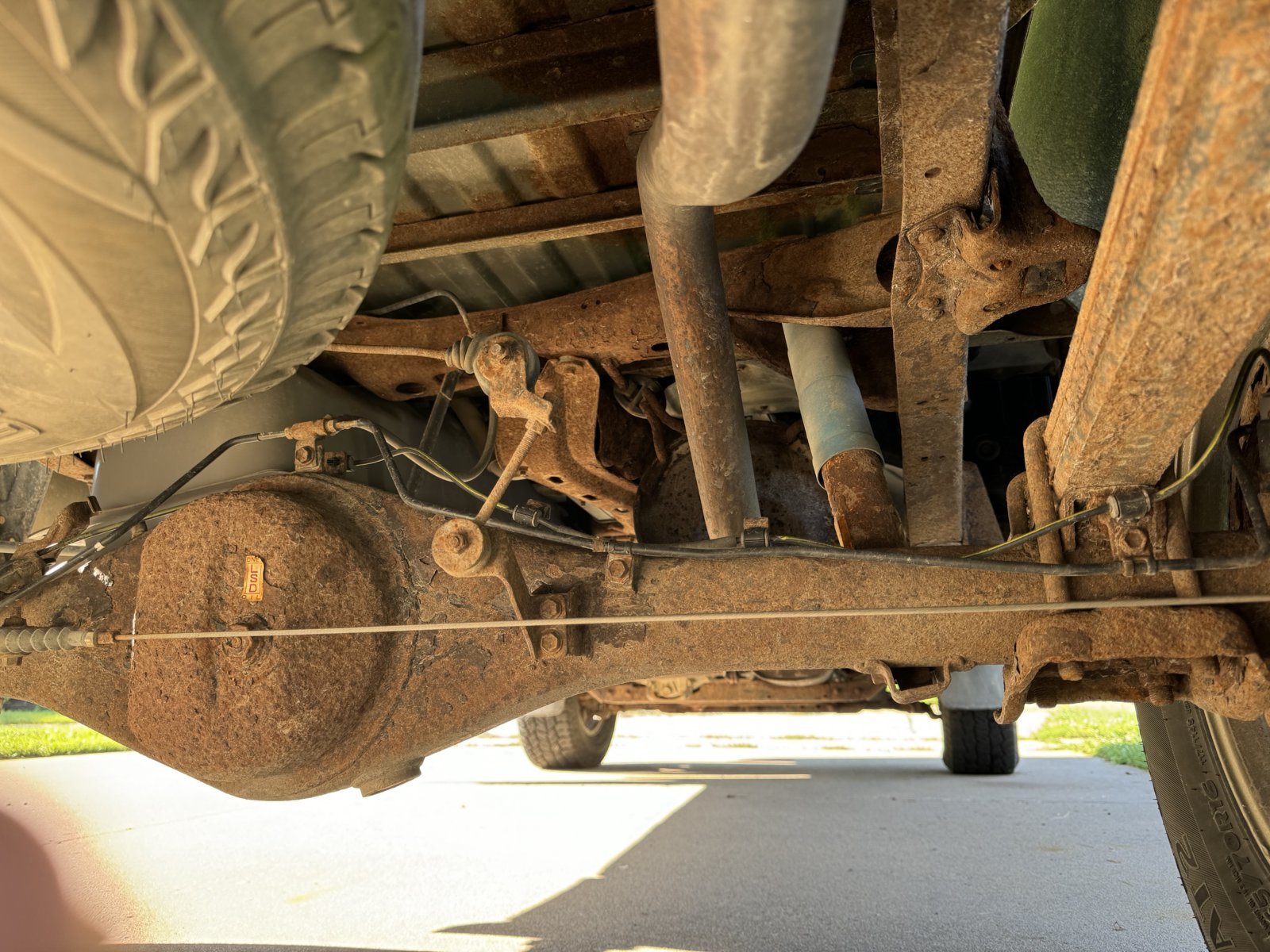

    Anyone know of replacement LSD stickers? The writing on these (and others like on the front diff and CVs) don't seem to react well to solvents.

    I center punched through the original spring hangers before removing them just a a reference. The two punch marks could be connected with a line to get a centerline layout mark to the original locations.
    Some guys just pick a pinion angle between 3-5 degrees, and some guys measure the t-case output angle and do the opposite on axle side.
    You are supposed to set the pinion angle at ride height. The way I have fabricated the u bolt eliminators I have plenty of rotational adjustment :D I Think I have 13 bags of 80lb quickcrete around here (1040 lbs) that I could load the chassis with to simulate the weight of the flatbed/camper combo. Or I guess that's the working plan? Fast and Loose.
    I hadn't thought about a rear sway bar, I'll have to look into that!
    I got interested in the u bolt eliminator because I'll likely have to do some fine tuning on the leaf pack.
    I can get the 8 grade8 nuts and bolts locally and pay by the pound. Costs about $20 for the whole set. vs ordering u bolts and waiting etc.
    It will make putting the airbag cups where I want them much easier.
    It's been said that it controls axle wrap much better than a standard spring perch.
    Just because I can :p
    Springs are assembled and ready to go in, just gotta reference the shackle and bolt orientations. Top plates/ lower bag cup mount coming right up!

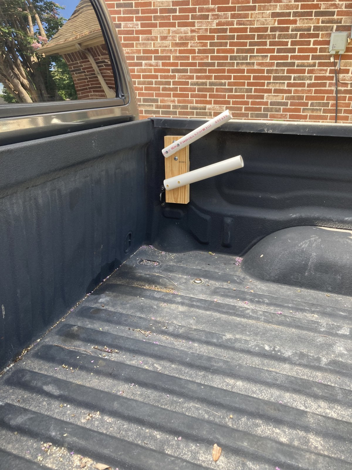

    I used to have a rod holder that was made of aluminum, it was a 90 with a little lip on the back. Kinda looked like this IMG_4720.jpg
    worked great

    So no u bolts... Ok this is all new to me.
    So you going to sandwich the leaf springs between two plates with four bolts?

    If you know a good way to remove them and keep in tact, I have an elocker now and don't need my LSD sticker.
    Once my other tundra gets its TrueTrac, it won't need the sticker either. As they don't require LSD oil

    Part number is 41991-22010 with substitute p/n 41991-04030. I found repops @ https://nightrungarage.com/products/toyota-lsd-decal

    So close, I should have cut a few test holes for the hex. Im out of 3/8 material, so I'll have to finish this thought in the morning. Damn good day overall though, and should be on all four tomorrow!

    A Sequoia rear sway bar might fit? I took a close look at one at a wrecking years not to long ago, and it looked like it wouldn’t be that difficult to make it work on a tundra. The best part is that it’s high clearance design, so there’s nothing that hangs down below the axle housing.

    You going to clean up and paint that frame while you got the bed off?
