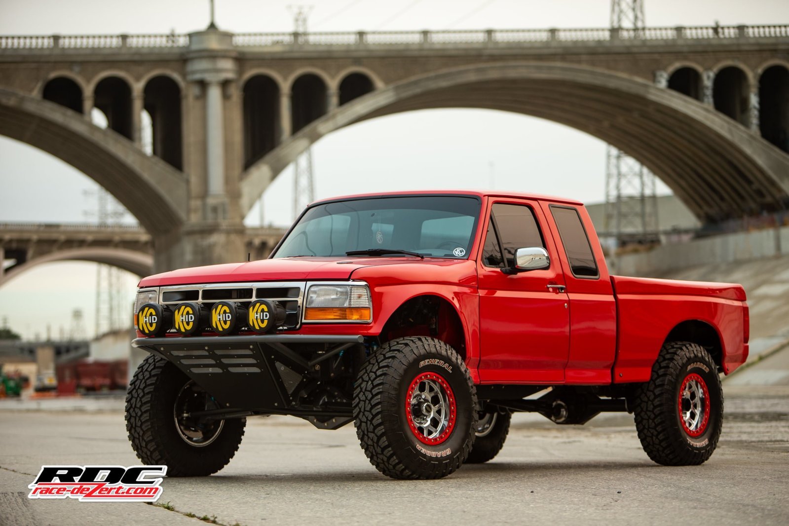

    Texan.... Big suprise
    00 Tundra Limited 2WD AC
    OEM+, 6+1 bastard pack, 4.08 swapped rear end, custom spring shackles, 3 inch flat lift. This list will grow
    I feel like both are pinnacle sized trucks. Everything else now days is to fucking big. The modern ranger is the size of a 90s F150 the current and last gen tacos are damn near the same size and height as our trucks are, factory of course.... Shits just to big and bloated, and none of it looks good IMHO. Or they come with free milling samples in the oil passages/ other obvious QC defects from the mnfg..... Cough cough turd gens

    Im with you love the size of these things. However when you bring up 94-97 f150…. Yeah I’d sell my truck for the right one. Wouldn’t even look back.

    Maybe I should tell my uncle I want the 85 f150 back

    I think the crew cabs were 250/350 only. Idk what it is, but that’s literally the dream. Old 7.3 tow rig with the 150 prerunner on the back.

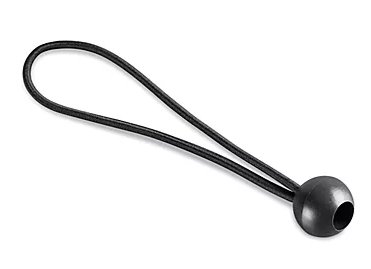

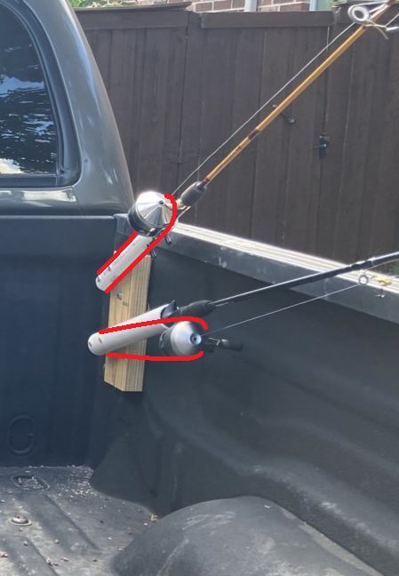

    I'd probably use something like a hairband, or those ballgag tent tiedown thingies to hold the rods in place by looping like this.
    Bungee ballgag tent tiedown thingy:

    You would suggest a ball gag.......

    I'm pretty sure the '97 model was the new gen where they rounded everything out. But yeah, those early / mid 90's F150's & F250's were sweet

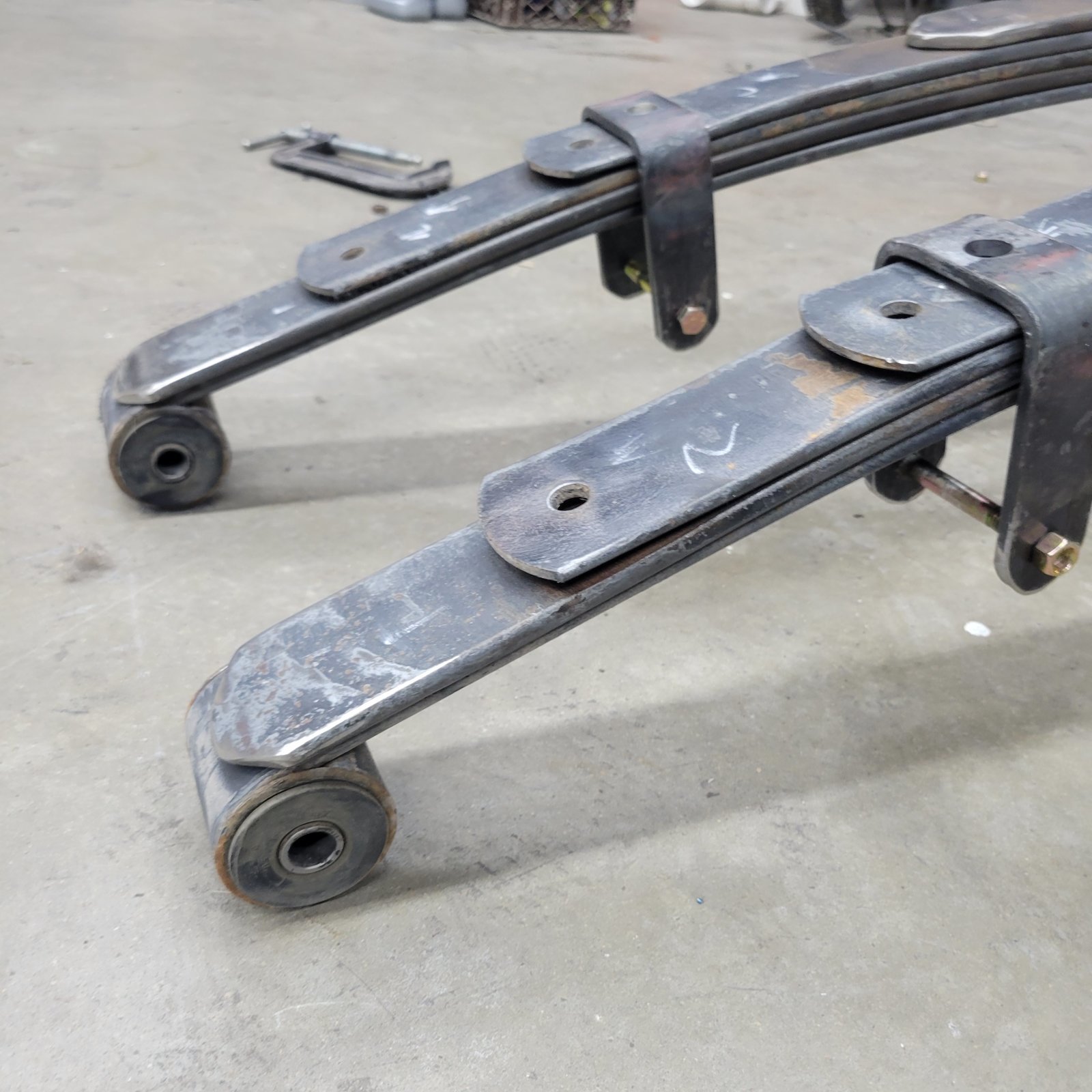

    JakeJake
    JakeJake Slippery Snake
    Jul 19, 2023
    #100515
    1,464
    2000 Tundra AC 4X4

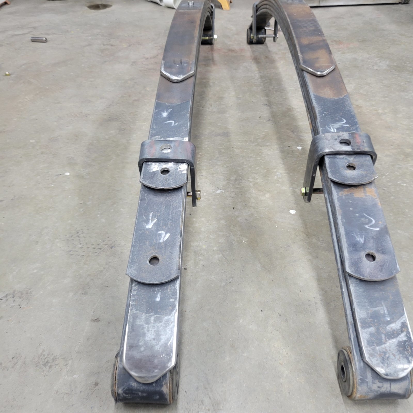

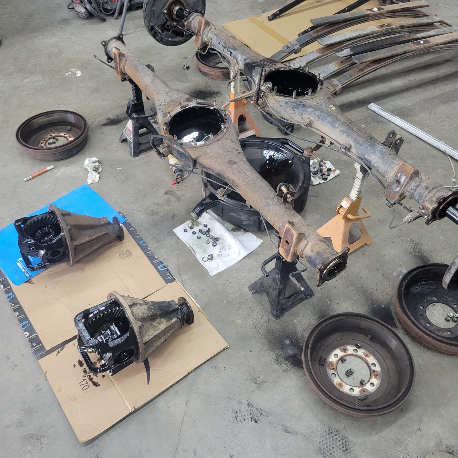

    Spent the day building a 5 leaf bastard pack out of the two pairs of springs I had. Not All day, I Had to run around and get supplies for tomorrow to keep this train rolling. Still need to finish a few details and do the final assembly.
    The goal is to be back on all four end of day tomorrow.

    Shit looks real good homie

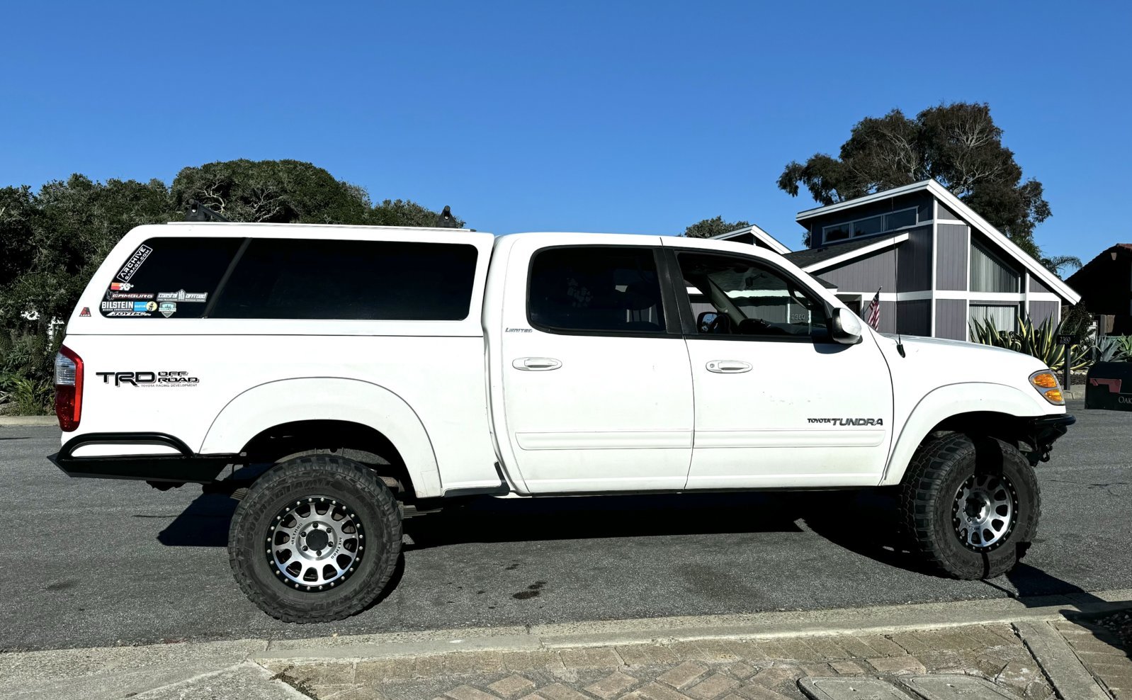

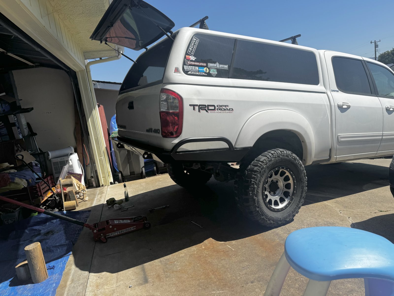

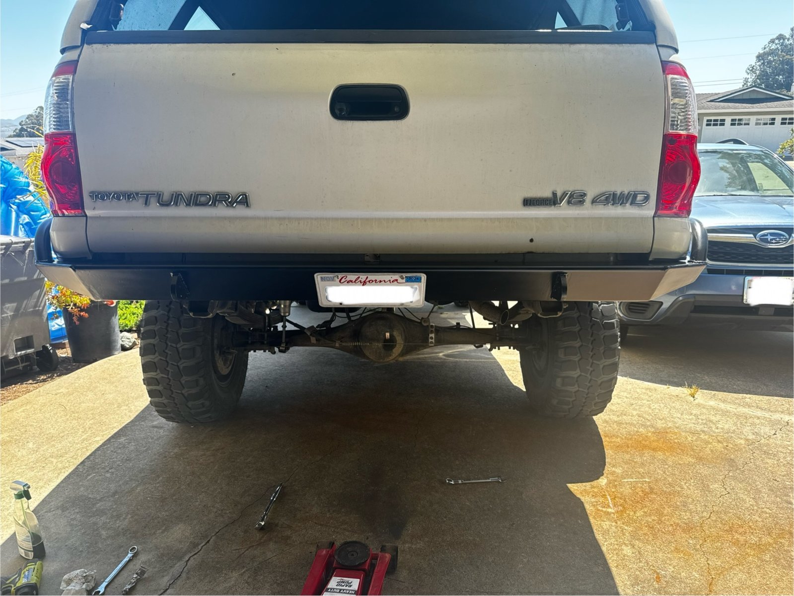

    Finally got around to getting the bumper on. Thanks to the kids being on summer break it took a little longer than expected.

    Nice. Did you make it?

    When ya'll make these 5 or 7 leaves how do you know where they'll end up height wise? Or is that part of the fun?
    455h0le_dachshund likes this.
  30. Jul 3, 2024 at 11:12 PM
    VR6T
    VR6T In fealty to the God-Emperor I serve the Imperium
    Jan 29, 2022
    #73879
    1,962
    Well rule of thumb is a 3/8th to 1/2 inch per leaf not counting your over load. I have a factory over load, 1 AAL, 2 firsts ones that sit on top the over load, 2 seconds and then the main spring to the frame and I'm damn near perfectly level with a 3" spacer lift in the front and 5100s in the rear
