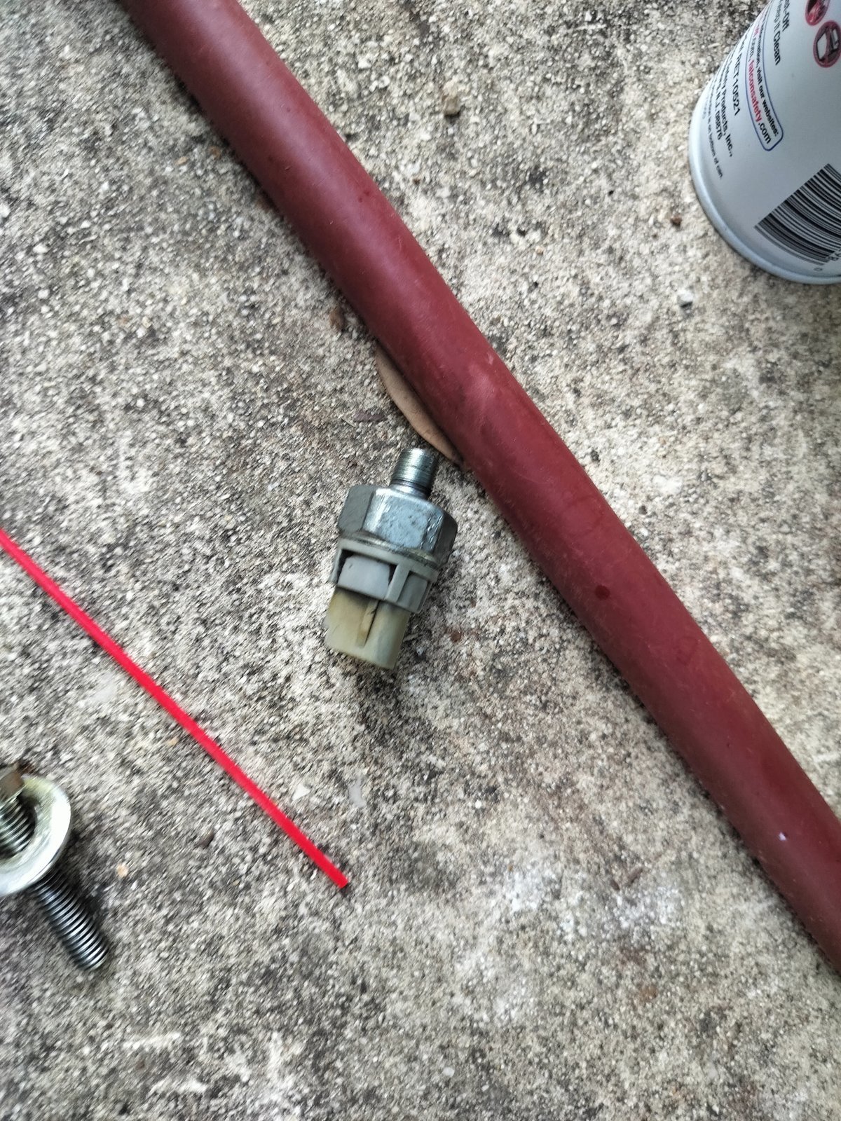

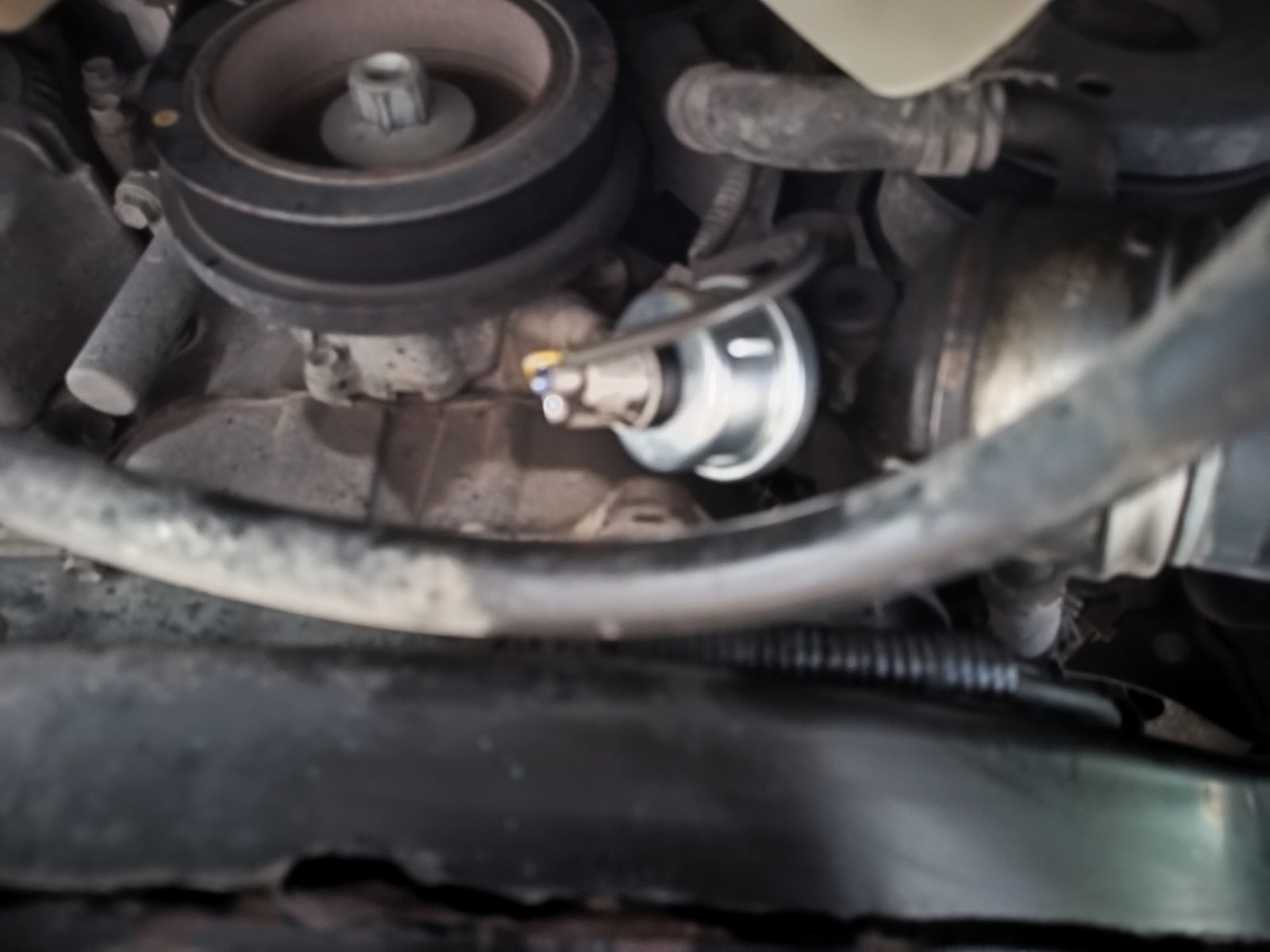

    I did this..... And no change on the gauge. Anyone got any other ideas aside from it being the wire. Whish I don't even know how to check to see if it's contacting with the dash gauges.

    Does the gauge budge at all when it revs? If not, i'd guess its disconnected.

    I mean, you have a DMM? You can always test for continuity.

    Nope

    Put a wire across the wiring harness connector for the sensor and see if it spikes the gauge in the cab.

    Nope it sure doesn't. And where would it be disconnected at? I went looking for a fuse but couldn't find one. So I just don't know.
    Also had to stop by @01GGTundraSR5 a house and have him help me with that forward bank 1 02 sensor clip. My arthritis in my thumbs wasn't happy with me trying to undo that clip connector. It codes cleared and she's running fine now. Gotta take it for a spin to see if it pops again tho. Had to fly my ass home and jump in the toilet.

    You got a video or some pictures to show me what I'm doing. I'm hell on wheels when it comes to nuts bolts engines transmissions and generally fixing mechanical stuff. But me and electronics yeah we don't get along so much

    Paper clip into the connector

    It's a single pin connector.
