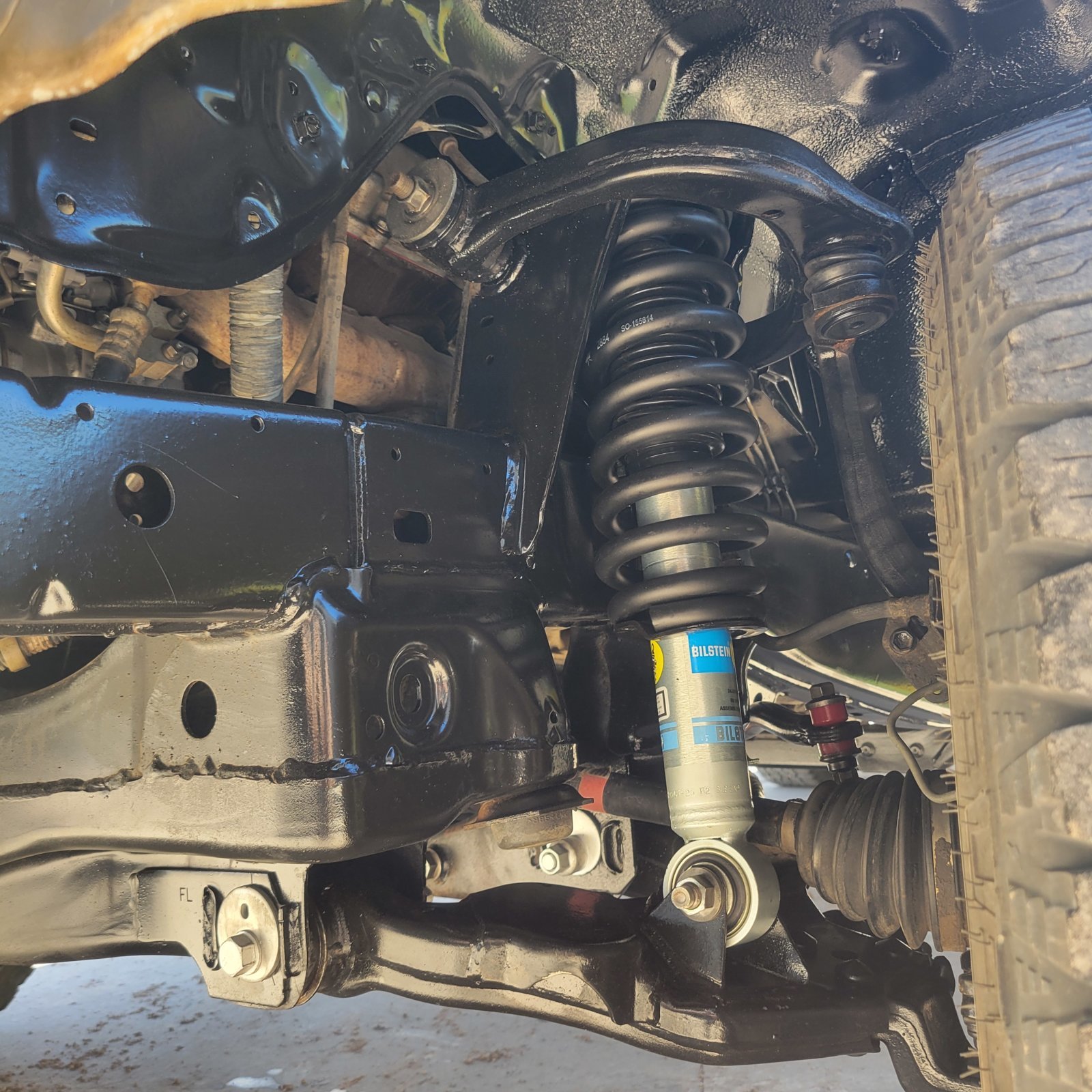

    Iron oxide weight reduction
    That looks so damn nice man. :drool::thumbsup: Great work!

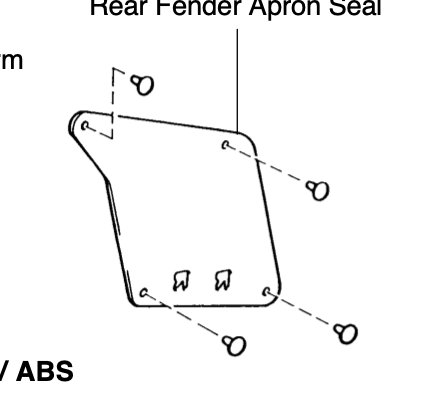

    I'm about to install them, ill shoot you a pic
    @FishNinja just kidding they are pretty beat up. Im going to think about remaking them.
    They go forward of the shock towers. Not sure why they are called "rear fender apron seals" unless im missing 2 of the four.
    Edit Edit- Son of a bitch, I have one front and one rear.

    what clip are you running those 5100s at? How’s the ride?

    Bottom or #1 with an ome 2884 spring. The test drive was mind blowing, but I only have about 5 miles on the setup so far.

    What did you use as a catalysis?

    Majic/Krylon/Vansickle/Rustoleum and im sure others make an alkyd/enamel catalyst. I use Majic as its available next to the tractor paint at the farm store.

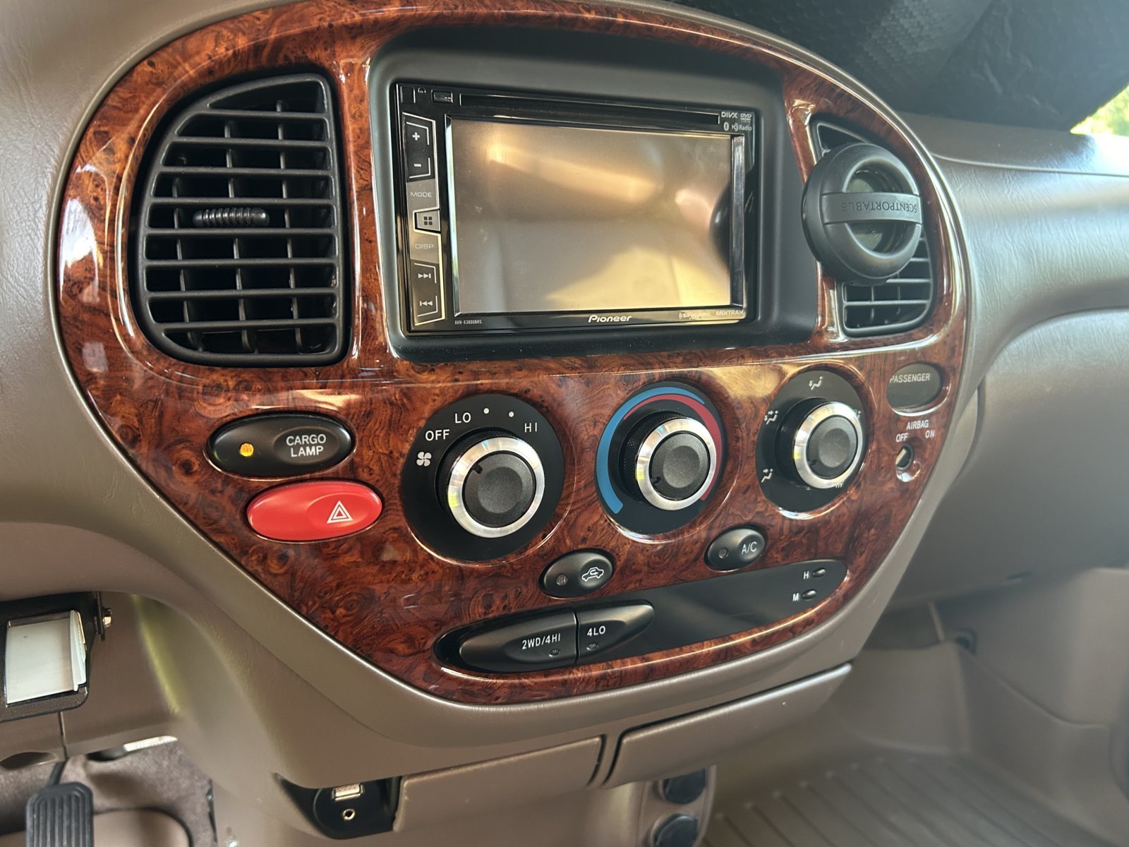

    Knobs are in. I like em. The mounting shafts for these are way more robust than the OEM. 2 of mine were cracked, I had already glued and tape wrapped one.

    Do they feel secure when you turn them? I may have to pick up a set.
    Care to share the link again?

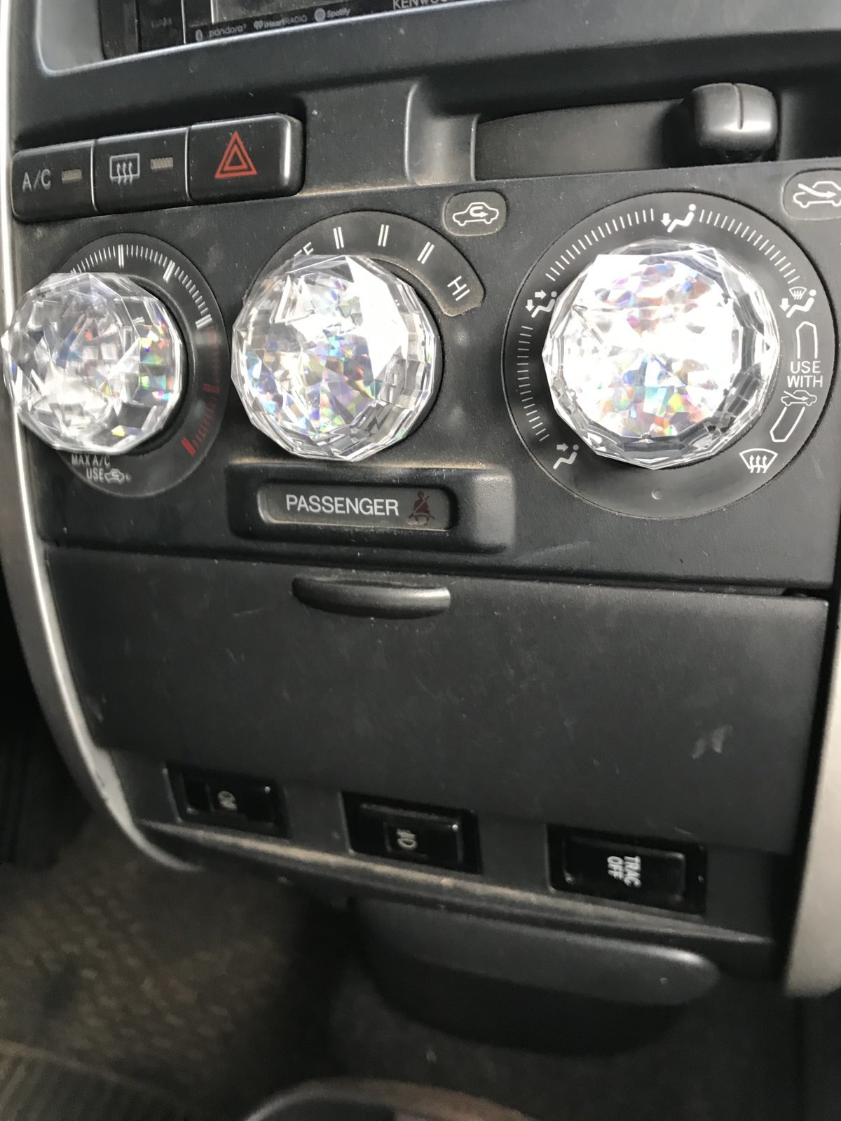

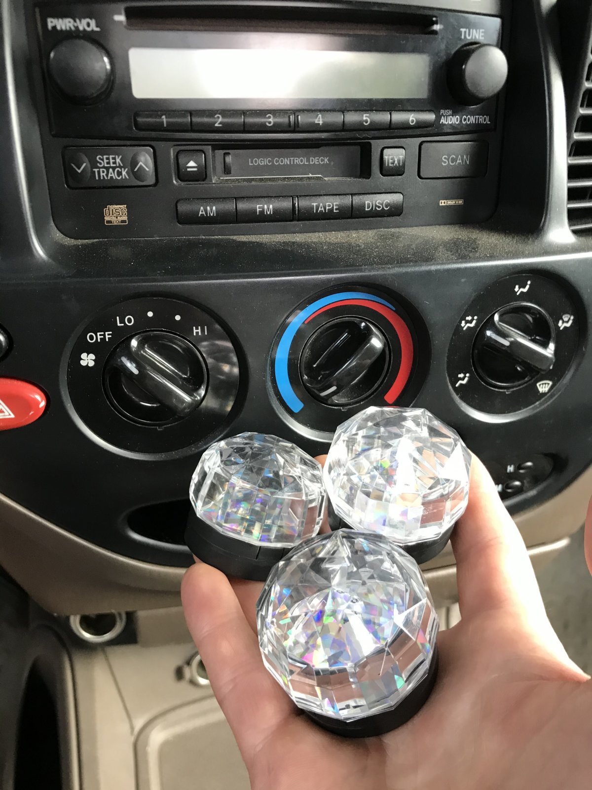

    I just went over to my shop to see if my JDM Toyota bB HVAC “crystals” would fit the tundra. No dice. The tundra has a square drive hole, while my scion xB has a round-ish drive hole.
    4F29390D-32E8-4C25-A48C-BD7AD8F0E75E.jpg BEE9DCA4-0722-4AFB-B11D-18E3729E75E9.jpg

    Super solid. Way less brittle than the OEM knobs.

    What size is the square?

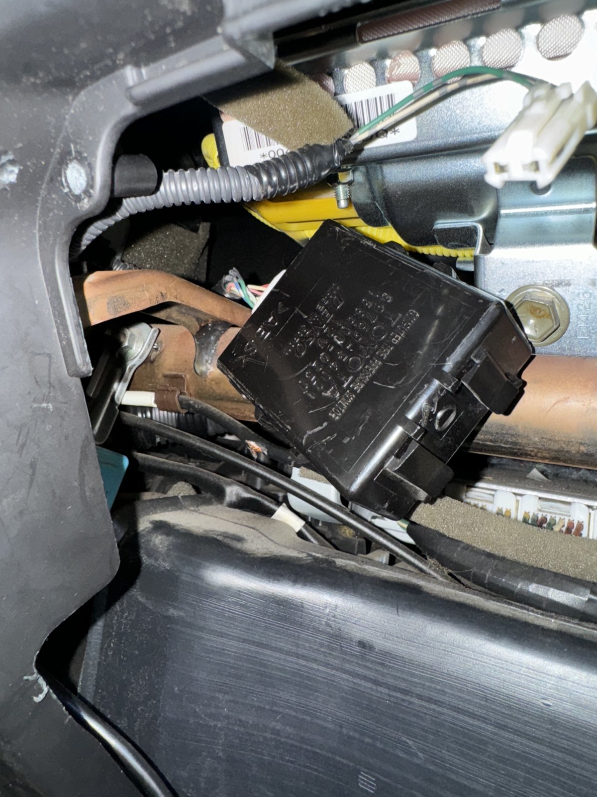

    Chasing a rattle in my dash between the radio and the airbag. I found this module just hanging out. Looks like I’m missing a mounting bracket like the one circled. Used some zip ties for now.
    wire under that box was chewed/cut or snipped by someone also. I think it answers while my radio antenna sucked

    I have a spare NOS OEM one if it’s the one you need. Which do you have?
    The drivers side are stamped out with L for front of tower and LL for behind tower. Passenger side is R and RR respectively. I think I have an extra RR.

    1/4 x 1/4 inch usually

    Good info, and thanks!
    I have an R and an LL. Really they are so bad that they will just get used as patterns for whatever I reproduce them in.
    If it's not too much trouble, a picture of it with the blade of a tape measure laid over the top would give me all the info I need. Willing to pay one hand drawn spider.

    Man I would run those in a heartbeat. If nothing else just to poke fun at the round knob crew.
    Also, how do you like the scion? I keep an eye out for the right 1st gen xb.
    Edit- Thats a $200 hand-full of knobs!
