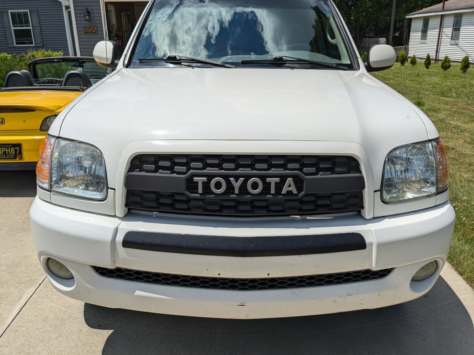

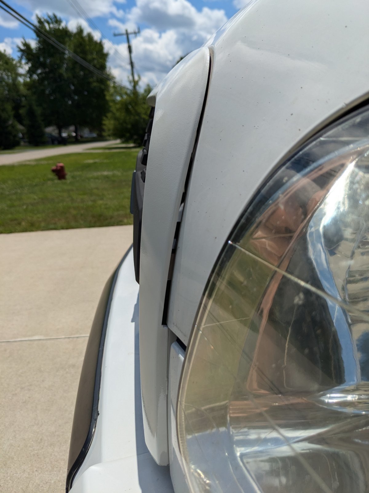

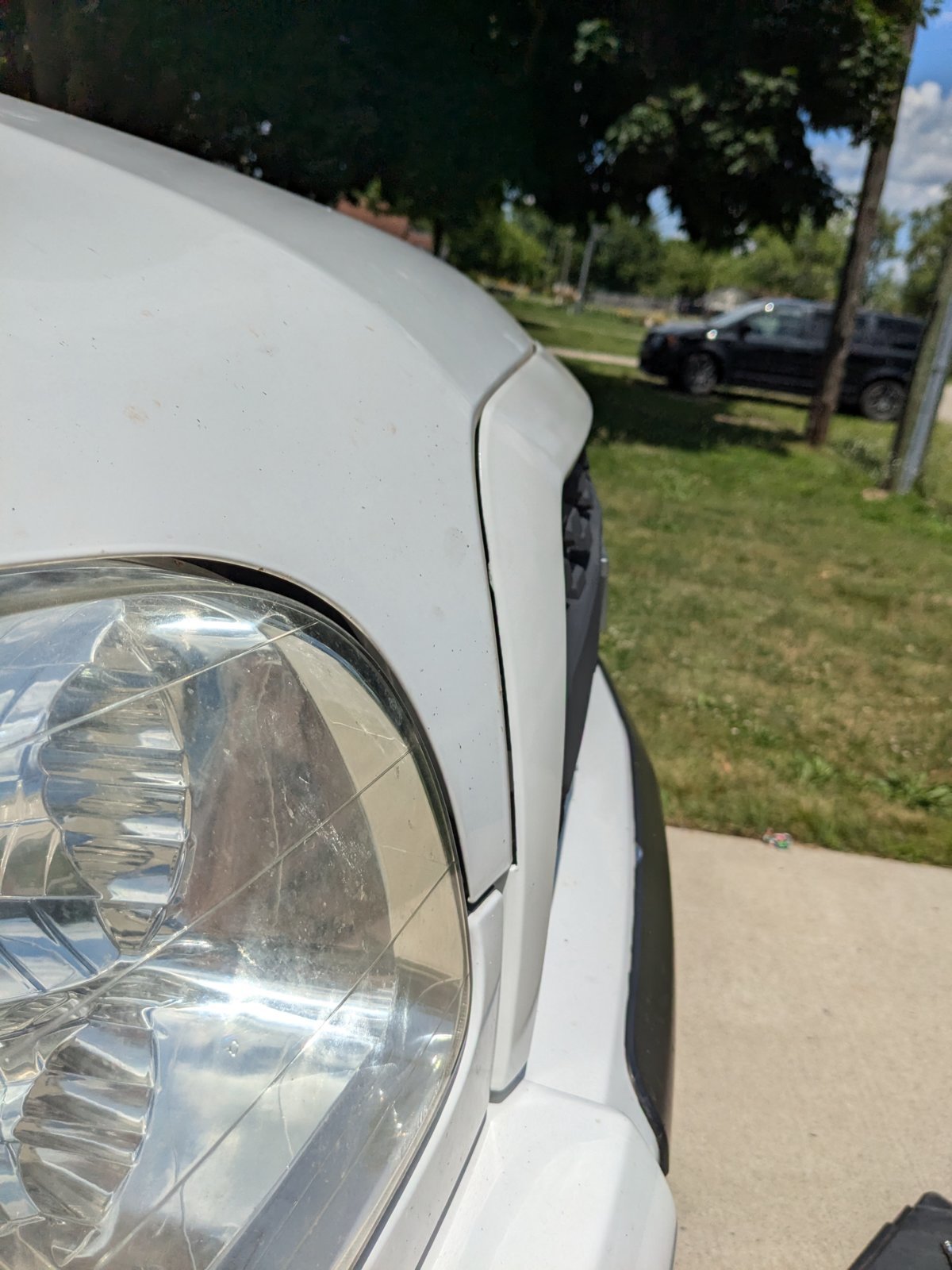

    Finally got around to painting and installing the "TRD Pro" style grille I ordered from alibaba months ago... a little disappointed with the fitment to say the least. Guess I should have test fitted it before I committed the time to paint it. :p
    Thinking about finding a gray gasket material (same or similar one that's used for the fender flares) or maybe sanding/filing the contact points down to see if that rectifies the problem. Any other suggestions to try?
    PXL_20240624_174136840.jpg PXL_20240624_174127584.jpg PXL_20240624_174117552.jpg
    EDIT: Got the fitment resolved. Reused the OEM threads vs the supplied ones and sanded about 1mm off the mounting surface. Looks far better now.
    PXL_20240624_200407739.jpg PXL_20240624_200455930.jpg PXL_20240624_200503755.jpg

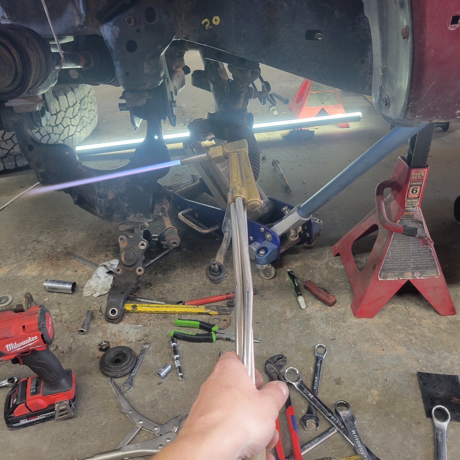

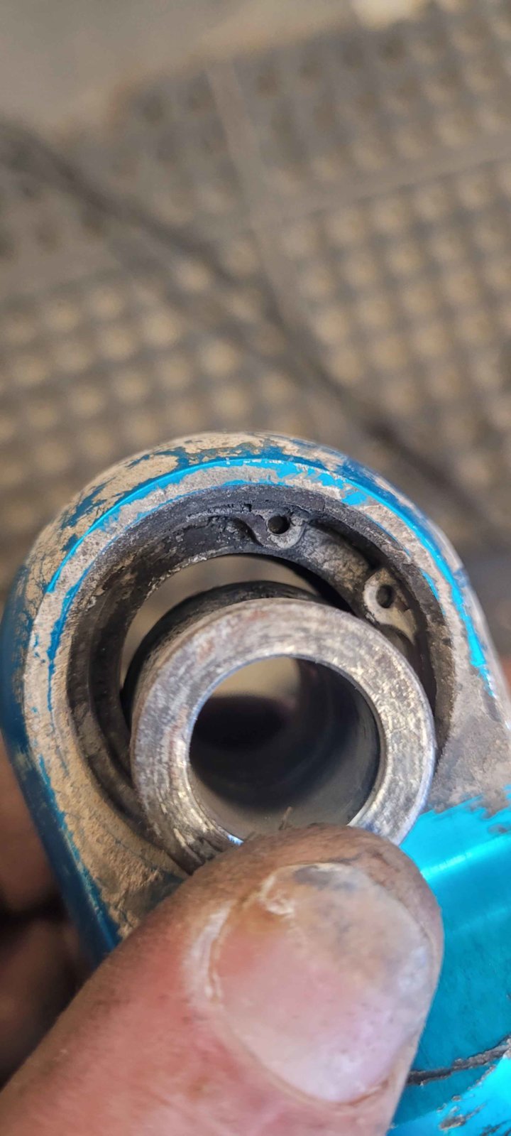

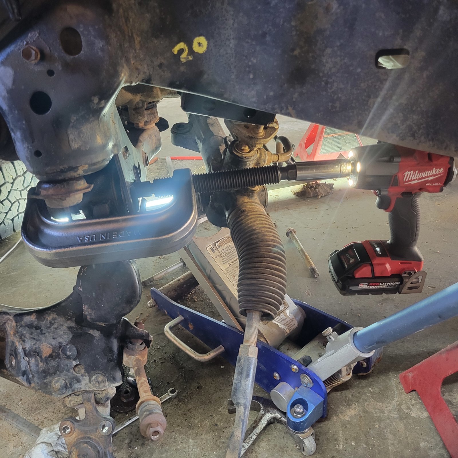

    She's got the cam bolt stuckzies.
    I asked nicely
    I quit asking
    Driver side is bare, a little break and I should be able to get the passenger side blown apart pretty quick.

    Dam man that sucks. Truck looks like it has zero to any trust too. I’ll be doing this job in a couple weeks. Hoping mine aren’t seized .

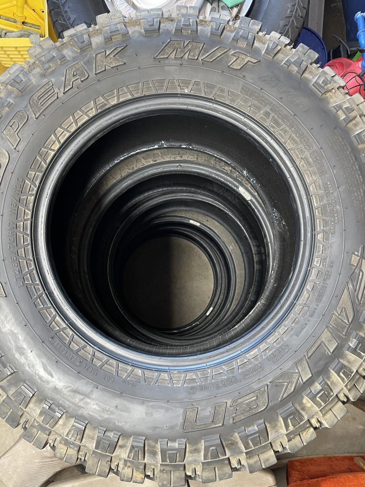

    The Jeep guys always come in clutch when they want to upgrade their tires haha. Picked up a set of 5x 285/70r17 C load Falken Wildpeak M/T. Paid $500. Build should be dialed in soon. Mounting them on SCS Brushed copper wheels.

    Looks like UBJ retention clip.
    Duh. Red. Are you colorblind? :boink::rofl:

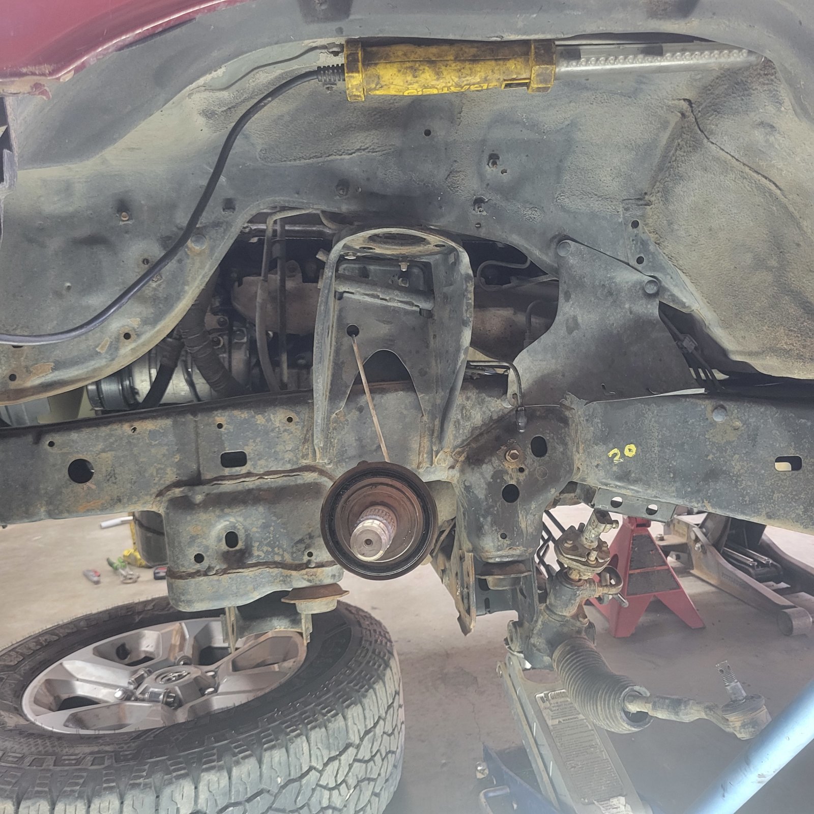

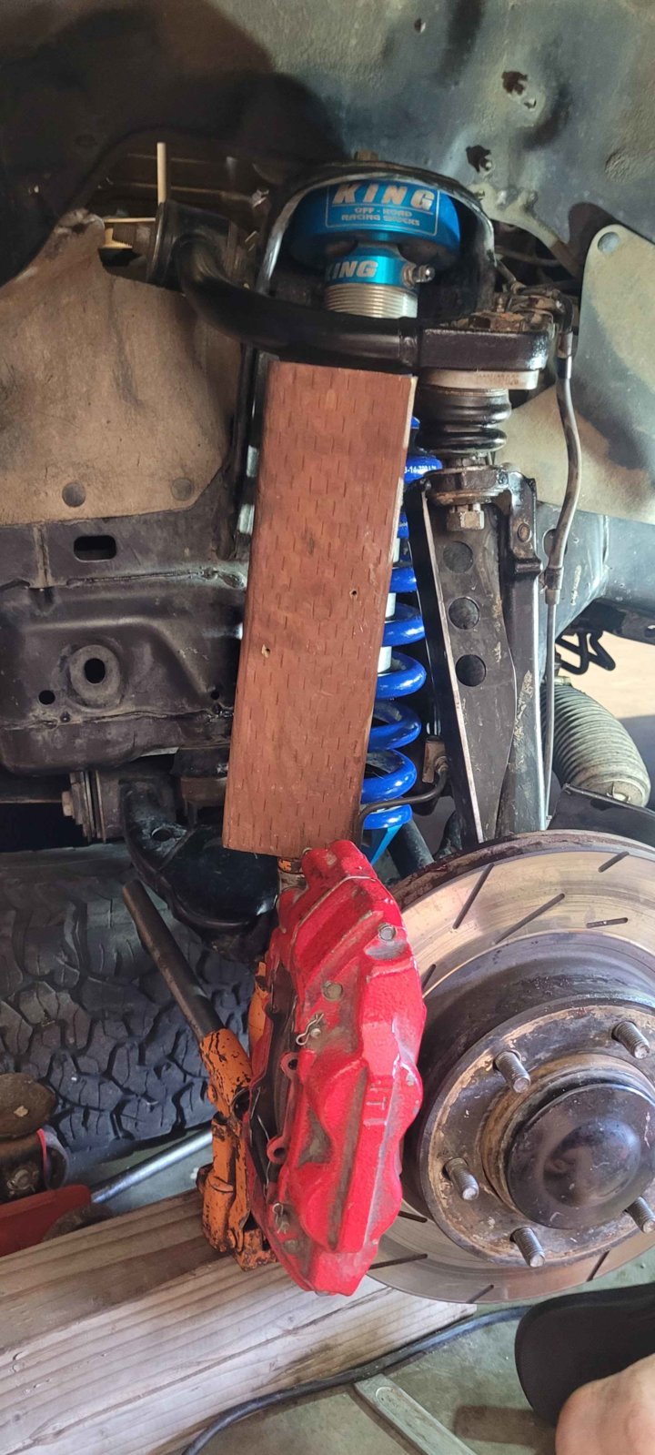

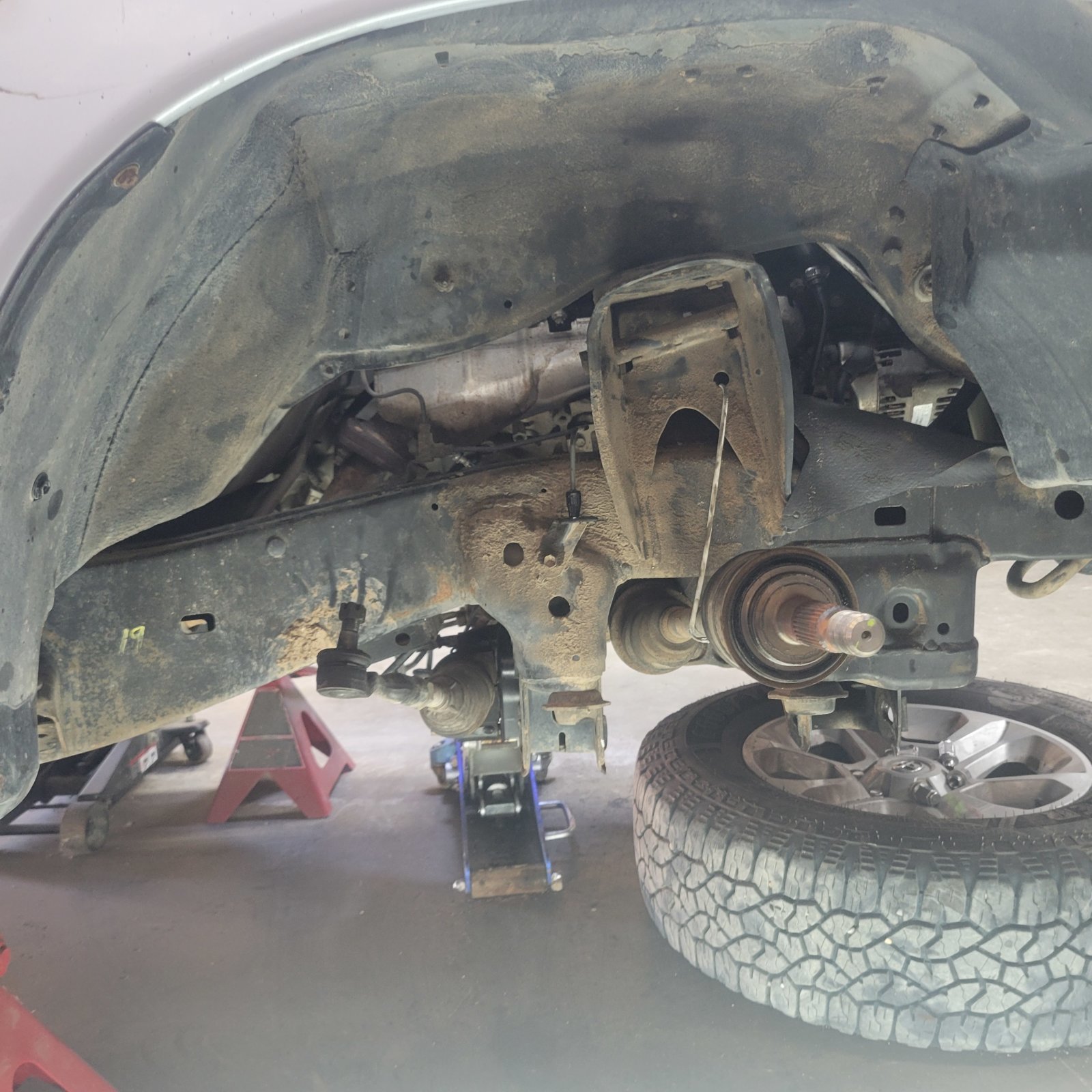

    Well, that took way longer than anticipated. @bmf4069 stopped by and got to witness the torching of the other stuck cam sleeve.
    Both sides are stripped down now.
    Tomorrow I will clean the frame/fenderwells/uca/lca. Then Wirebrush, Ospho, And shoot everything in some fresh black.
    Gotta do some cam bolt research tonight. Probably should have had some freshies on hand.

    I fully approve of that usage for caliper hangers.

    It's actually just a bent stick welding rod, I use them for everything. I couldn't have the axles dangling all over the place.

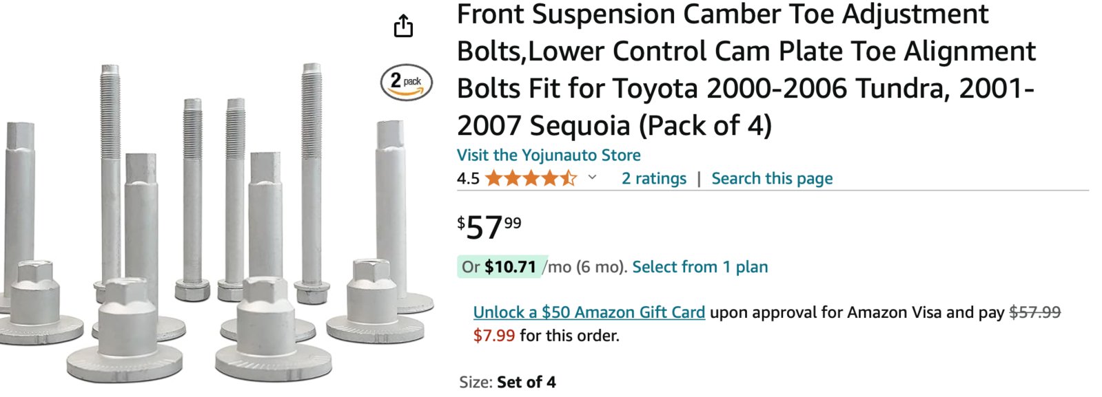

    This won't be popular, but I just ordered a set of "youlongdingdong" brand cam bolts from Amazon prime. Just a stopgap to buy me some time until a Toyota parts sale or I fab something up.

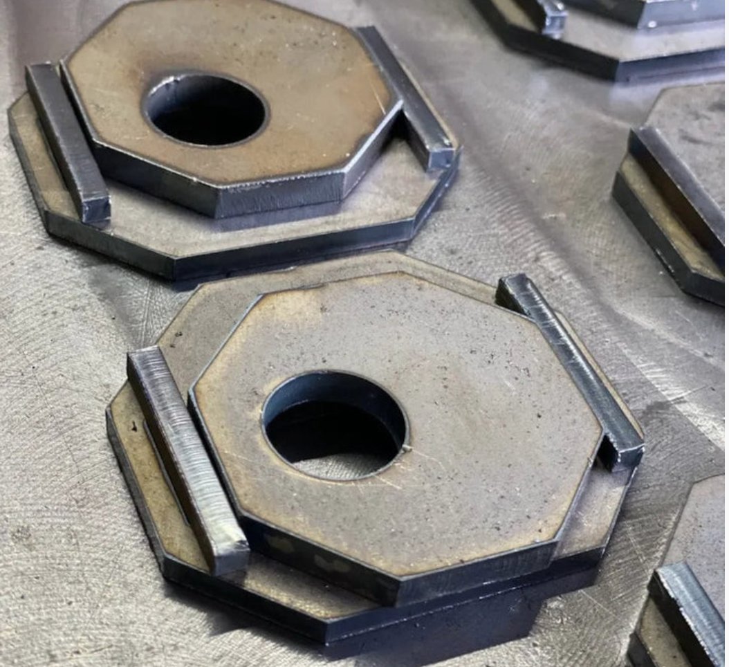

    This style makes a whole lot of sense to me, and I could produce them in house. Just need a little time to think about all the details.

    Nice fix. I like that grill. thought about it for mine with some Ambers and maybe safety greens in there hahaha.

    Looks good mang, but no "Raptor" lights?

    Thanks! Nah, I decided I like the cleaner look better.

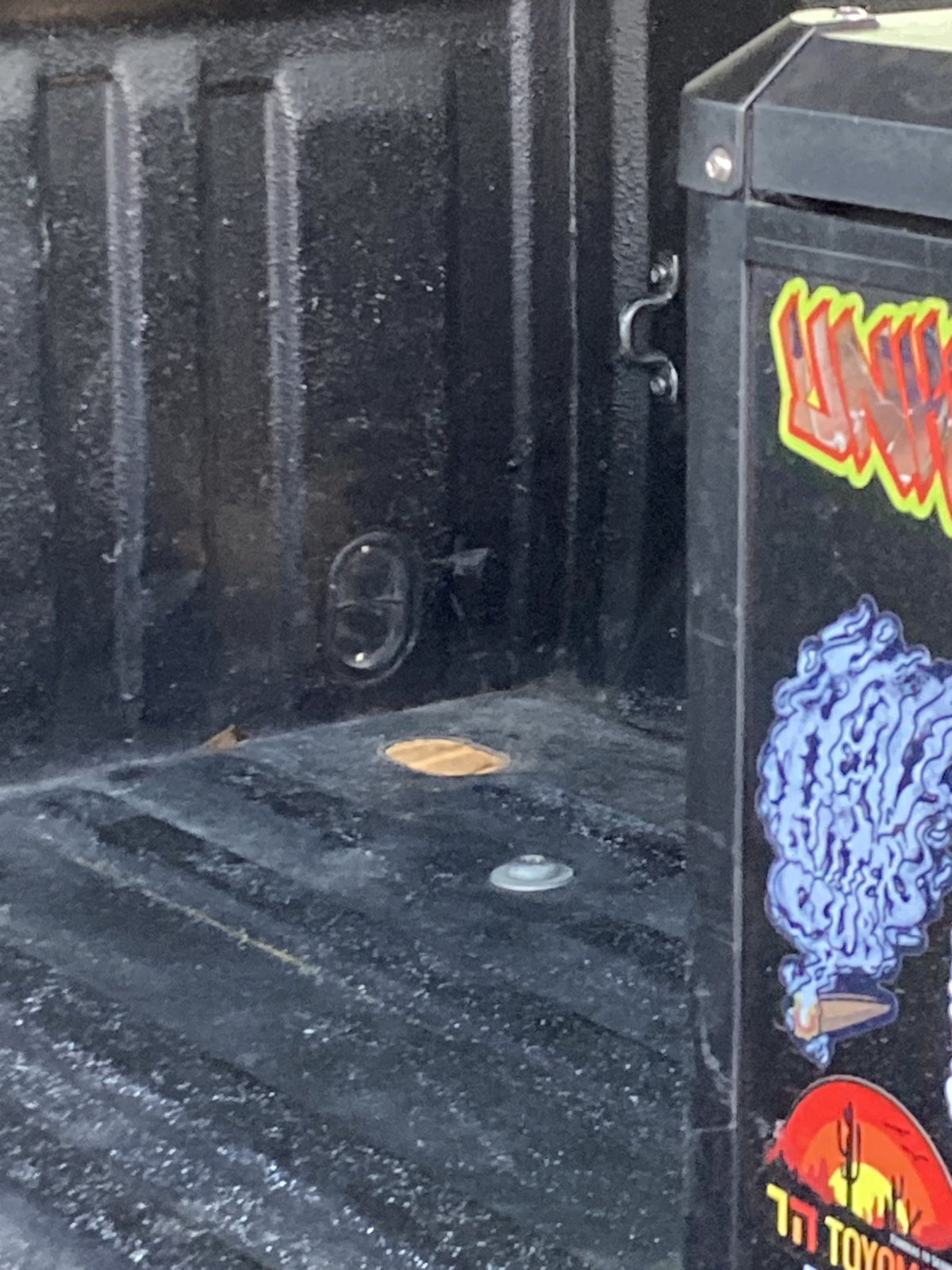

    Degreased and hosed my bed down for future tetrivities but I forgot to put the drain cap back in, pretty sure it danced around and then yeeted itself out its own hole!
    I’ll look thru the hood but I think it’s long gone. Anyone got a spare? IMG_6787.jpg

    I thought somebody posted about those cam bolt and they didn't last a month.

    I don’t think/hope your trying to mass produce, but I can PM you specs for the cam plates if you want
