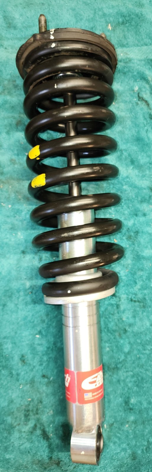

  1. Jun 21, 2024 at 12:01 PM
    VR6T
    VR6T In fealty to the God-Emperor I serve the Imperium
    Jan 29, 2022
    #73879
    1,962
    Texan.... Big suprise
    00 Tundra Limited 2WD AC
    OEM+, 6+1 bastard pack, 4.08 swapped rear end, custom spring shackles, 3 inch flat lift. This list will grow
    Pretty sure I seen height adjustable 4600s before. Not recently, but years ago. I could be misremembering tho honestly.
  2. Jun 21, 2024 at 12:03 PM
    KNABORES
    KNABORES Sarcasm incoming
    Jan 1, 2020
    #40572
    14,860
    Arkansas
    5100s are the adjustable 4600s to hear Bilstein tell it. If you want stock height, 4600. If you want lift, 5100. Adding lift springs to 4600s sounds like a no-no to me, although some members have apparently done it.
  3. Jun 21, 2024 at 12:08 PM
    VR6T
    Jan 29, 2022
    #73879
    1,962
    I just did a quick search and surf, and it seem 4600 are for OEM static ride height and are not recommend for any sort of lift.
    The ones I'm thinking of were black rubbers and yellow painted bodies and we're on a classic Chevy square body in the Norfolk naval base parking lot. So I was wrong. But they were 100% adjustable as that mother trucker was lifted like 4 or 5 inches. It was restored really nicely as well, orange on white cab paint and tan on brown interior. And it was twin manual shifters. 4 speed trans and a 4 mode transfer case 4wd. Oh and it had the classic Chevy white painted steelies.
    KNABORES[QUOTED] likes this.
  4. Jun 21, 2024 at 12:23 PM
    FishNinja
    FishNinja HIDE YOUR DAUGHTERS
    Jan 3, 2024
    #109562
    2,184
    Lee
    TEXAN....big surprise
    06DC2wd
    My truck came with 4600's from the factory??? Or some rendition of blue and yellow Bilsteins. So I'd assume you are correct.
  5. Jun 21, 2024 at 12:28 PM
    artsr2002
    artsr2002 2005 Tundra DC SR5
    #35520
    2,108
    'Yonder
    I installed 4600s in mine too. Had to leave something out so I could have enough threads on the center bolt to thread the nut on there. Don't remember what it was. Spacer level here. I is broke.
    BroHon, VR6T and Jack McCarthy like this.

  8. Jun 21, 2024 at 4:26 PM
    KNABORES
    Jan 1, 2020
    #40572
    14,860
    Arkansas
    Those factory "4600s" are an OEM version of the 4600, but are different than the off the shelf ones. Less robust.

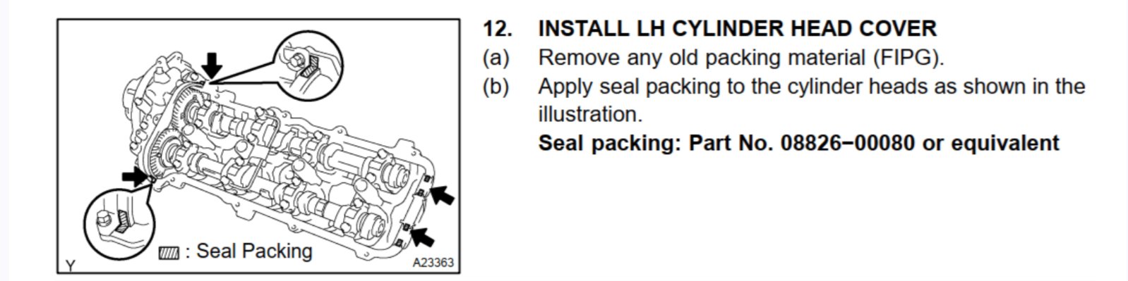

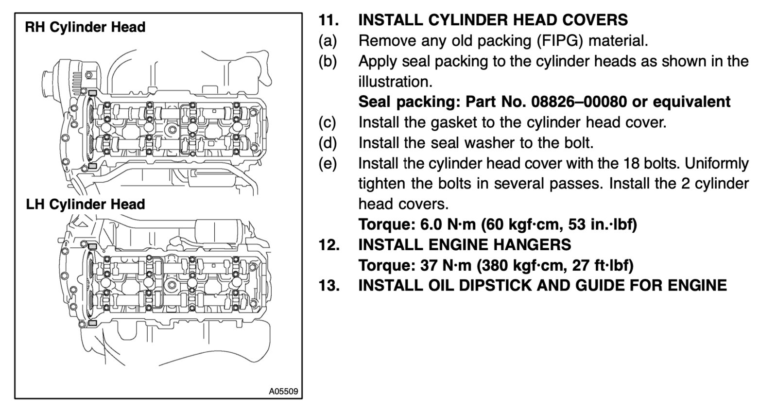

    @shifty` I saw this in another thread and didn't want to derail.
    Regarding Valve cover gasket FIPG
    the 06 FSM shows
    While the 00-03 FSM shows
    Looks like "making the turn" up the cam timing gear case would be the improved way, and probably a better seal.

  16. Jun 22, 2024 at 7:46 AM
    shifty`
    shifty` Inside his chest they found ten thousand pencils
    Jun 20, 2020
    #48239
    30,572
    ATL
    '06 AC Limited V8/4WD
    Yup, that's how I did mine. I didn't want to say anything about how you did yours. But that section of the FSM actually seems to show smoothing out at the half-moons like I was saying you need to do.
    I looked it up after seeing how fucked/incorrect most YouTube videos I checked out prior to doing the work were.

  22. Jun 22, 2024 at 9:18 AM
    JakeJake
    JakeJake Slippery Snake
    Jul 19, 2023
    #100515
    1,464
    2000 Tundra AC 4X4
    Yep. A hundred milesish on it now and I'm still dry. I'll have to start taking a look at the later manual for process updates.
    bmf4069 and shifty`[QUOTED] like this.
  23. Jun 22, 2024 at 10:29 AM
    shifty`
    Jun 20, 2020
    #48239
    30,572
    ATL
    I think as long as you spiderweb that right-angle, you could paint clown faces with the FIPG and it'd still work.
    When I got into my heads, there were remnants of both white and black FIPG in that corner, so whoever was in there last didn't even bother cleaning out what was there prior before reapplying the last time they were in there. It wouldn't surprise me one bit if the 2nd owner (he only had the truck maybe 8-10k miles) may've done it, and when he saw how much crust there was in the driver's head, he bailed and traded it in. Mine was arguably as-crusty as yours, but I'm sure your driver head wasn't quite as varnish-char'd as mine. But that dbl-FIPG stupidity led to my VCs leaking.
    JakeJake[QUOTED] likes this.

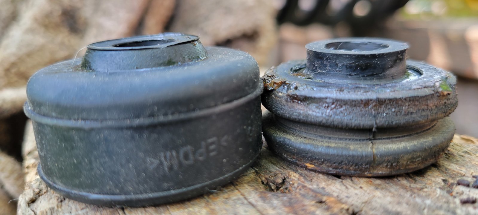

  24. Jun 22, 2024 at 3:45 PM
    assassin10000
    assassin10000 New Member
    Oct 27, 2020
    #54157
    2,272
    Andrew
    Northern CA
    '05 SR5 AC
    I put a small piece of adhesive lined heat shrink around mine to keep them together.
    One had already cracked pretty good.

  25. Jun 22, 2024 at 5:07 PM
    artsr2002
    #35520
    2,108
    'Yonder
    Every time I have to remove them for whatever reason one usually loses units small clip. One was cracked so I replaced it with some cheap Amazon replacements.
