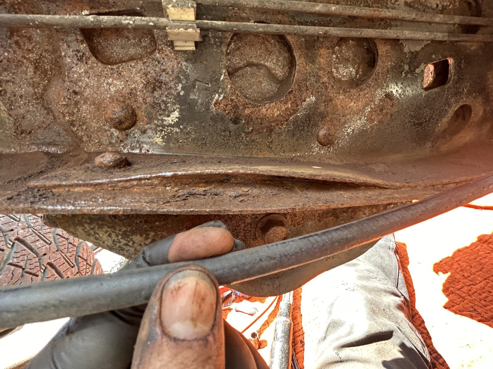

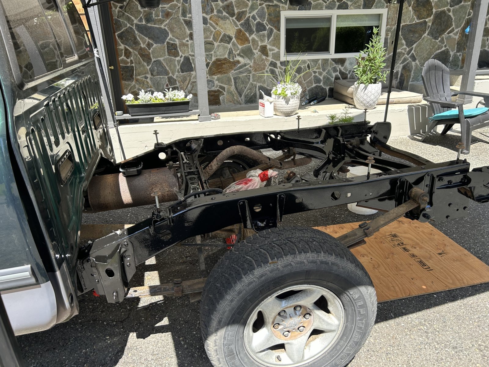

    Yeah, two coats after using the POR15 degreaser & metal prep.

    Seems like a good time to grab a 1/4 inch impact instead of a drill :boink:
    Has the frame been replaced before or did it not qualify for the frame recall?

    ATL
    '06 AC Limited V8/4WD

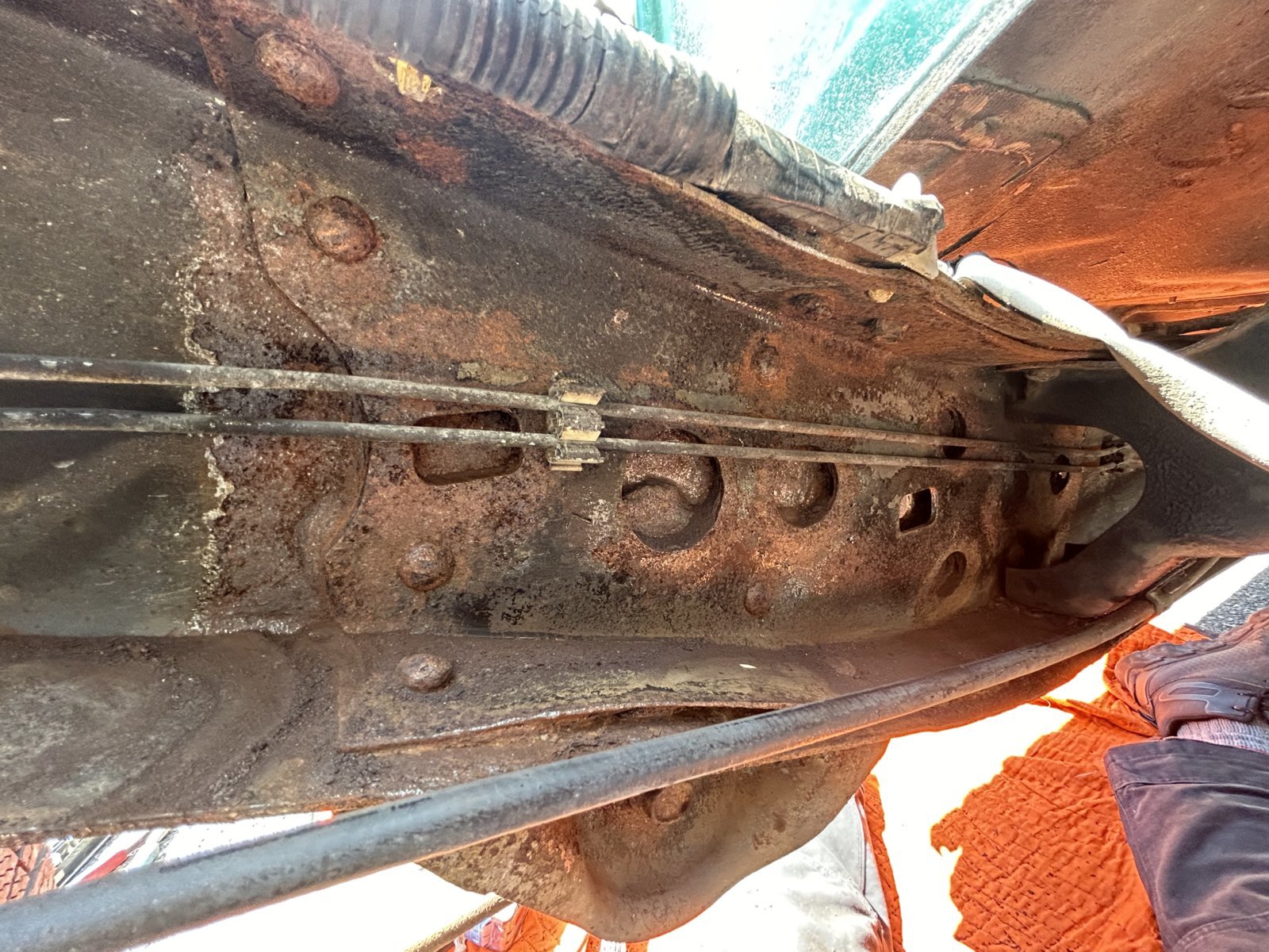

    Oh man, that's not even remotely bad. Not even slightly bad. I see no delamination at all. Sandblast, treat, seal may be overkill. I'd honestly just Naval Jelly it, maybe cold galvanize after, or self-etch prime and topcoat with satin rustoleum.

    No longer qualify unfortunately, believe it had to be done within 12 year of the truck being manufactured.

    Oh I definitely see some trucks in worse shape.. I’ve got parts on the way so I’m fully committed with it all prepped, I do intend to use the truck with a camper in the bed so any extra added reinforcement to that area makes me feel good hahaha.

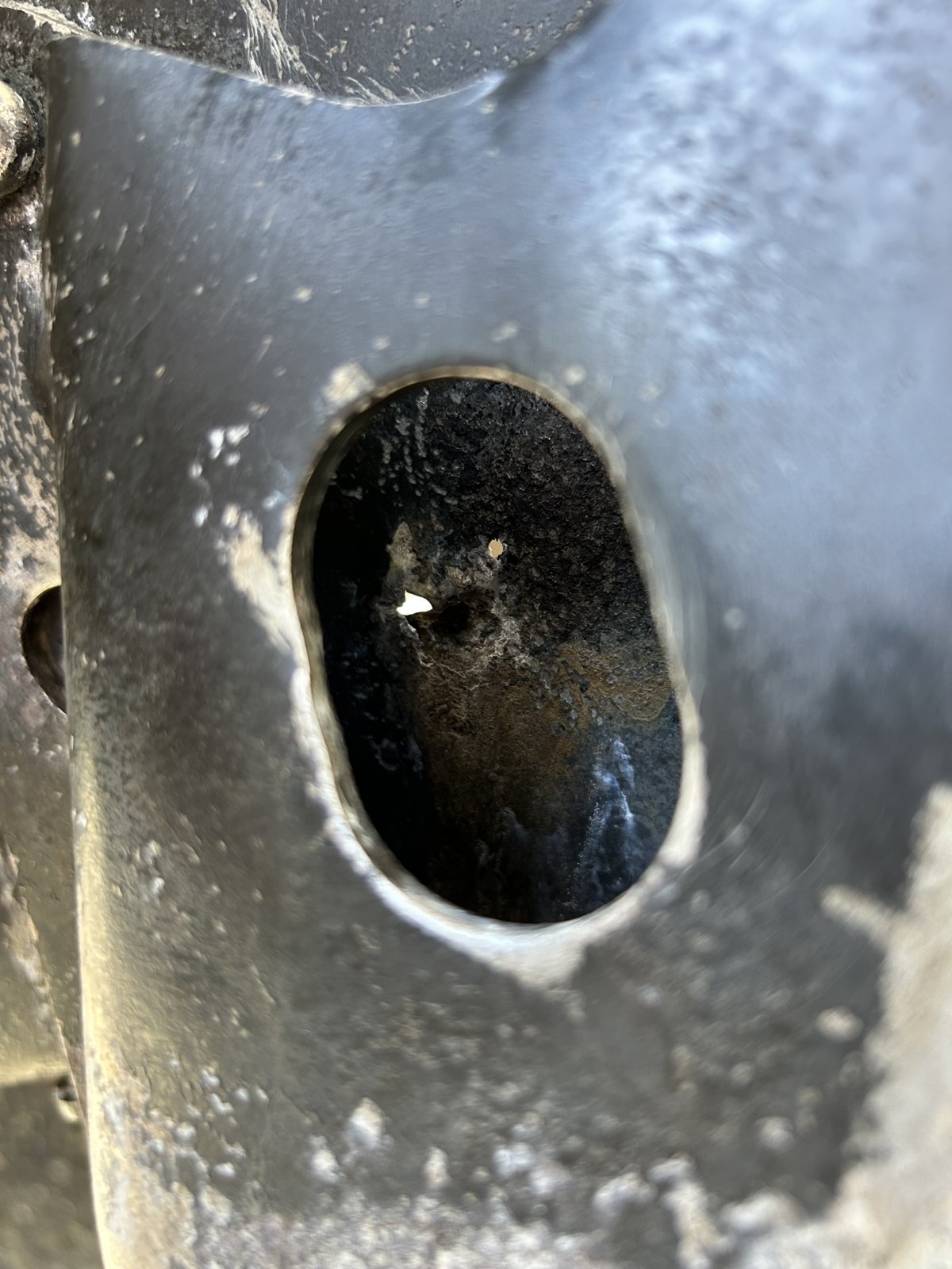

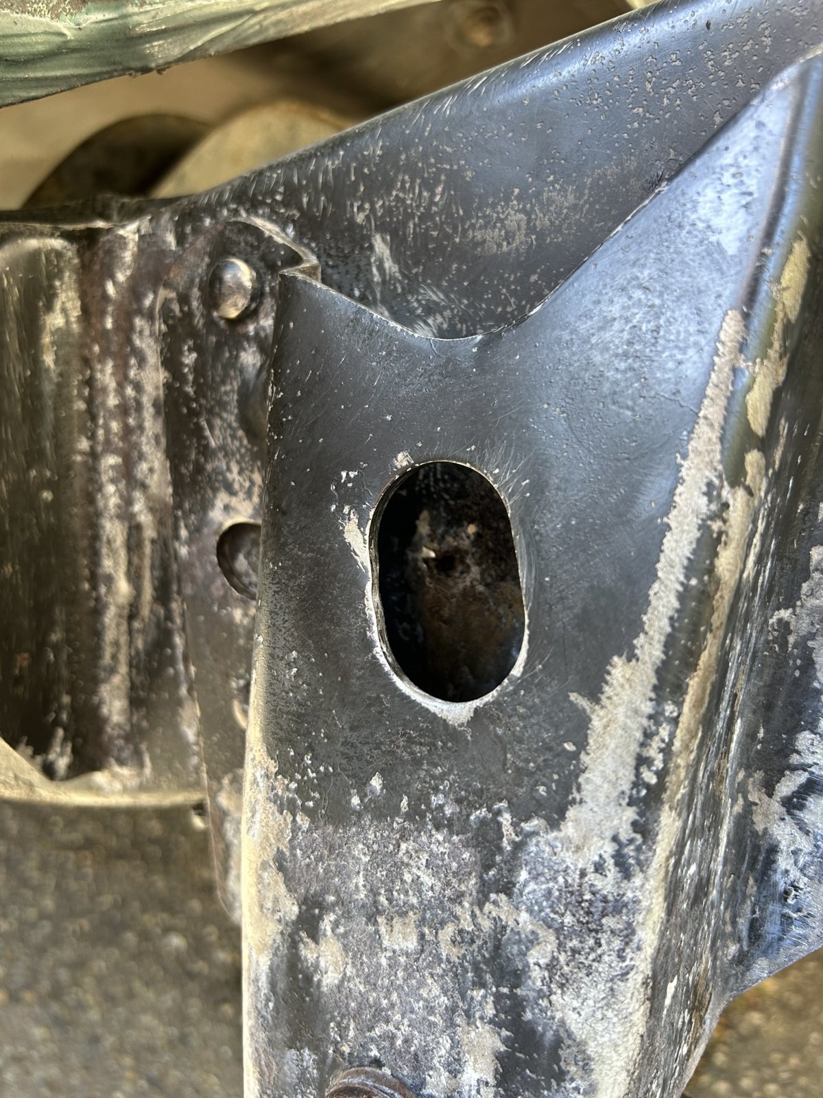

    This is after I took a needlescaler to it, bad delamination in between frame and stiffener on both sides. Punched a hole through the drivers side though. IMG_9256.jpg

    I had mine done in 21. 00-02 is still covered as long as you have rust in the right areas. If the truck wasn't registered in a certain cluster of states (I forget which) it won't qualify either. May be worth a call to your local dealer.
