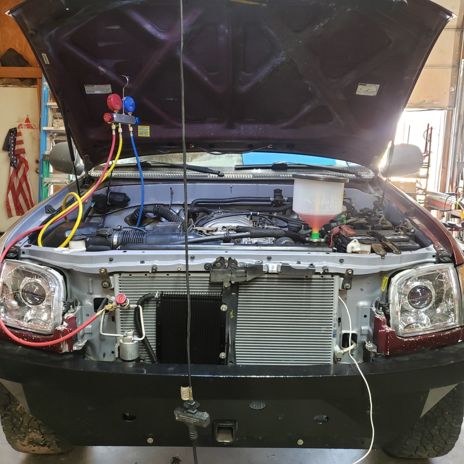

    Running smooth with zero leaks.
    Cam seals
    Crank seal
    Timing belt-tensioner-tensioner pulley-idler pulley
    Water pump
    Thermostat
    Front water crossover and gaskets
    Radiator
    A/C Compressor
    A/C Condensor
    Hayes 678 Trans cooler

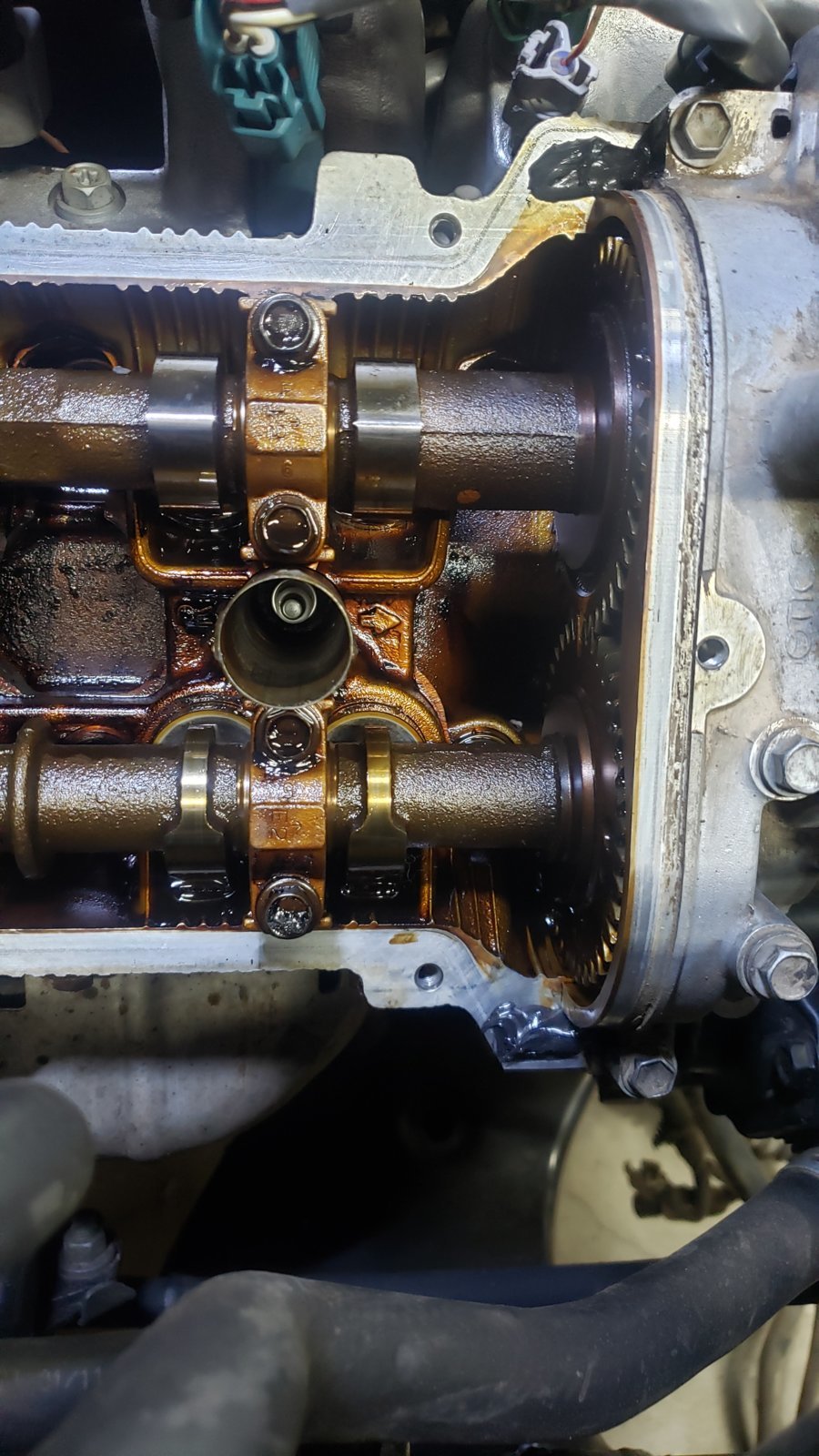

    Valve cover gaskets
    Throttle body cleaned and new gasket
    There's probably somethings I forgot.

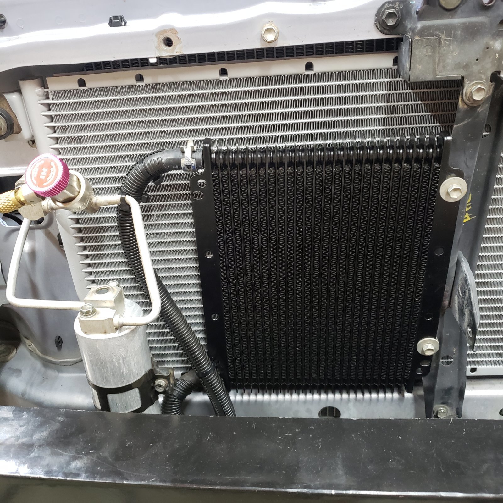

    I still need to fab a third mount for the trans cooler, extend some horn wiring for their slightly different location, and figure out my blend door problem as the defrost vents are always getting air. I'll re-torque the valve covers after a few heat cycles.
    Hayes 678
    https://www.tundras.com/threads/upgraded-trans-cooler.48516/

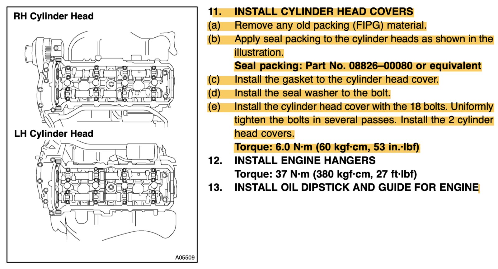

    Don't forget this when doing valve cover gaskets:
    I did the first time. It makes sense with the sharp corner of the gasket there, and the added velocity of oil slinging off the timing gears.

    Weird, it doesn't mention doing the half moons in that. FSM showed that for mine, removal, cleanup, and how to install/smooth. I swore it did at least.
