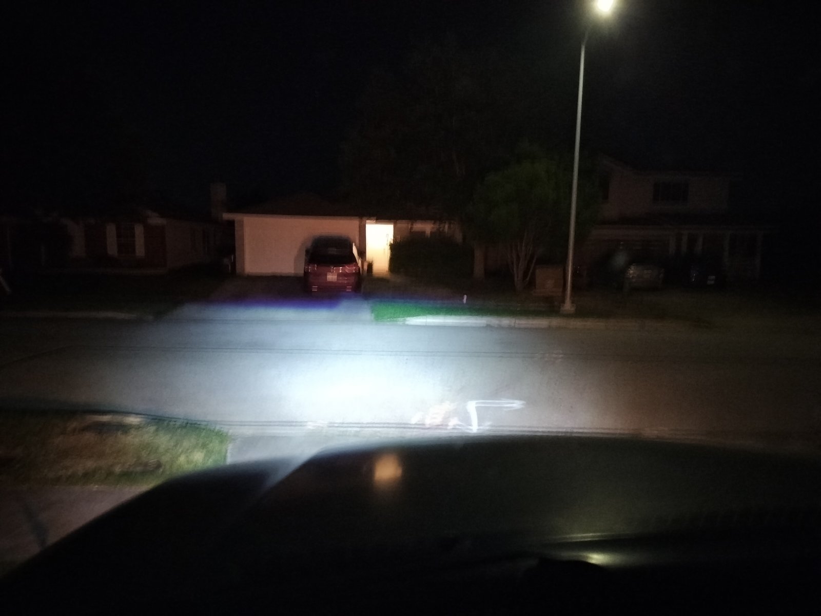

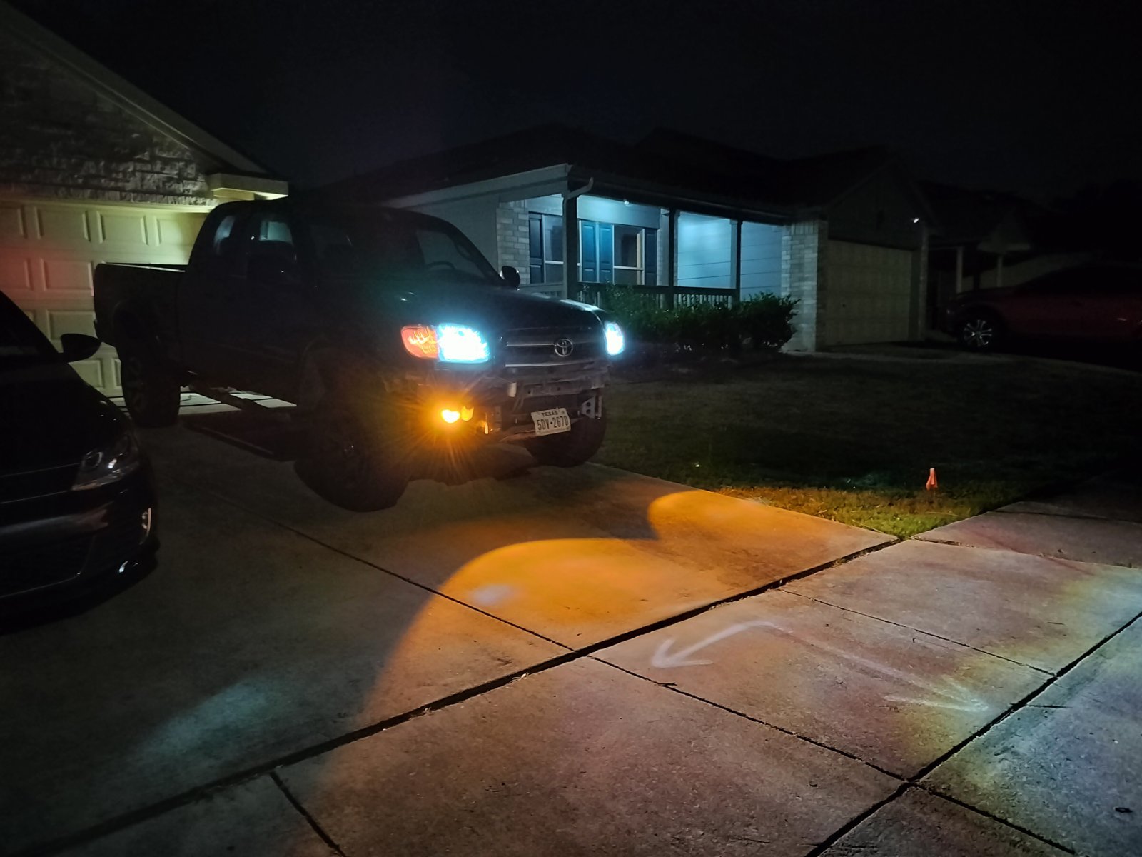

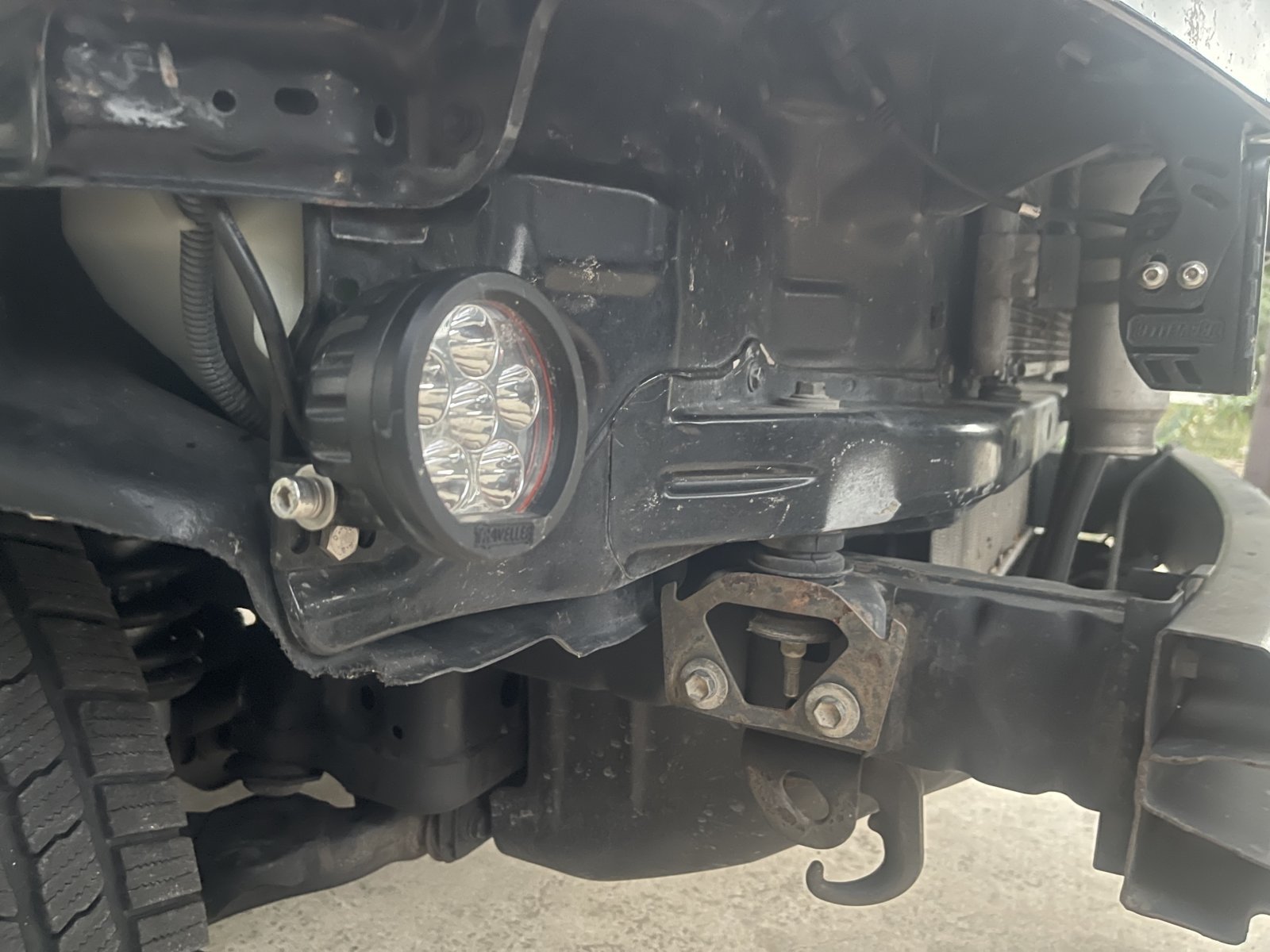

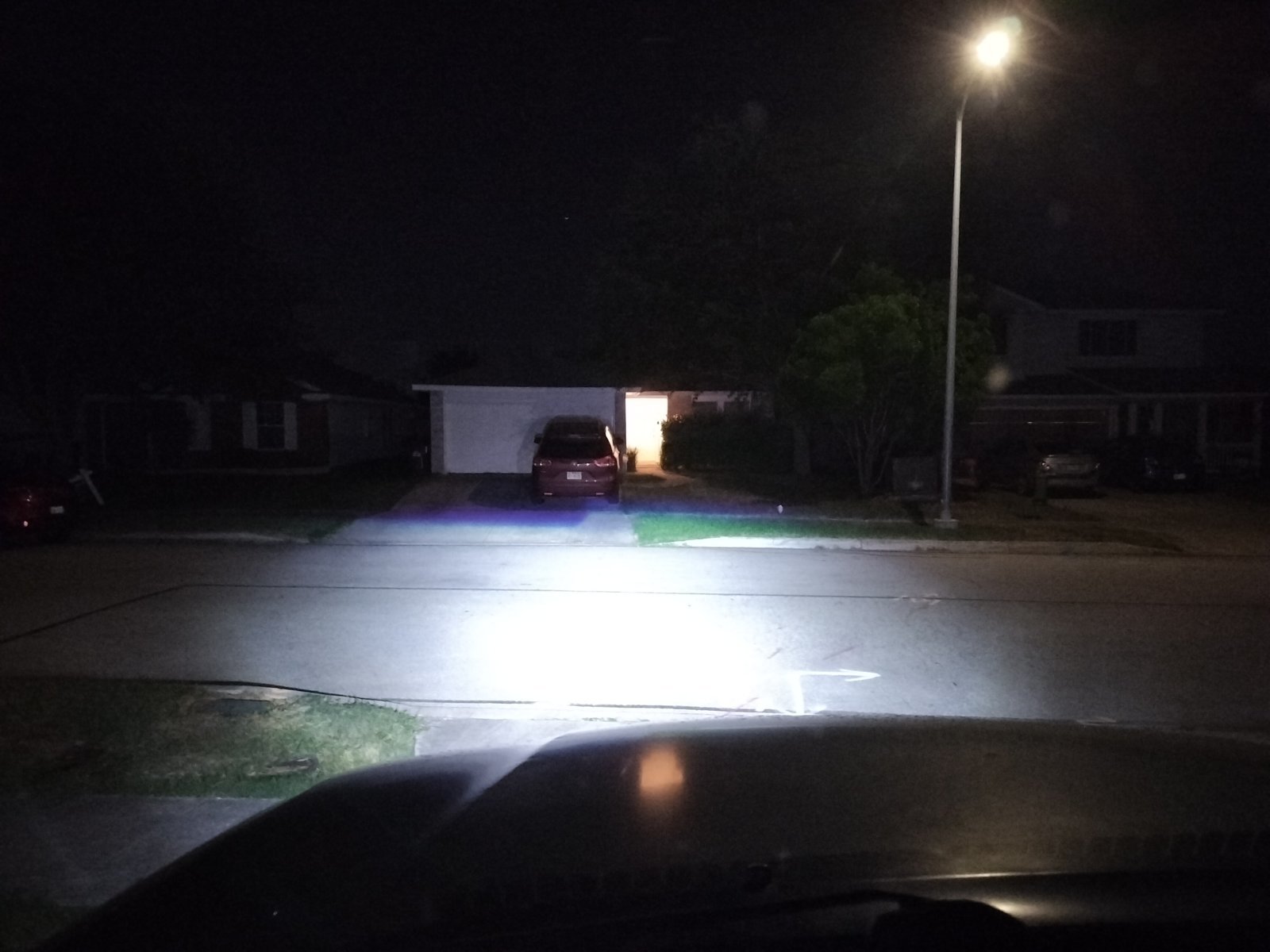

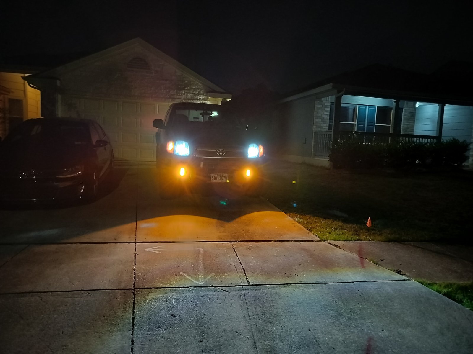

    @FishNinja got to see em in person, honestly they are a bit better than I thought they were gonna be.

    I can't tell the fogs are on in the from the seat pictures.

    Same. But as long as he's happy...
    I can say that his Colights LED headlights impressed the hell out of me when I was riding passenger a few weeks back. I still need to install mine.

    Look at the house across the street.

    I see it now.

    Wow those go way farther than the stock fogs. Hell even the LED bulb replacements you recommended me don't go that far. Definitely a spot pattern. I wasn't sure if fogs were meant to be spot or flood, so on my 4wd, I used pods that had both flood and spot patterns.

    Yea, but I think fogs shouldn't be that high. Aren't they supposed to light the area between the vehicle and low beams? Asking for a friend.

    And they're angle 8 degrees down and 3 degrees to the left and right prespectively

    How'd you take measurements of that?
    I think I need to adjust my headlights up some since I'm lowered.

    you get those wires tucked in safely?

    I zeroed the angle finder out on my drive way. Then just tilted the housing down till I got to the 8 degree marker. And fars as the put board angle, had to use a tape measure and some maths. But they are about 3 to 4 degrees angled outboard.
    I sure did. No flippy floppy wires for me good sir. Plus I know that's not their final resting spot. It'll be close but they'll be mounted on the actual bumpers somewhere. I'll have @JakeJake help us make that decision when the time comes
