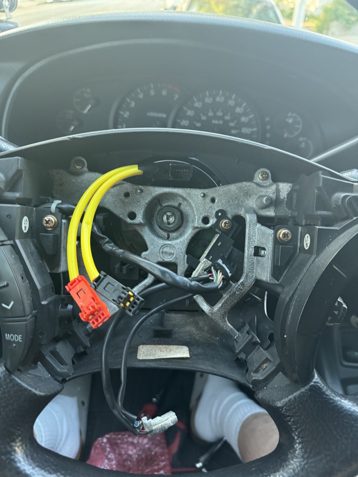

    IMG_7221.jpg Fixed my airbag light after 10+ years. Only took 2 clocksprings from rockauto. I ordered one and installed it, no change. Sent it back and got another one and just like that code was B1801 was gone. Finally no lights
    horn and cruse control always worked on oem, and defective 1st rockauto clock springs. If anything happens again I will just get an oem clock spring
