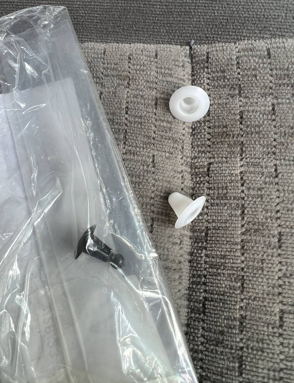

  13. May 24, 2024 at 9:58 AM
    MT-Tundra
    MT-Tundra Agnostic Gnostic
    Apr 11, 2024
    #115150
    1,337
    Montana
    2002 AC 4wd V8 Limited
    I remember seeing that. I've also seen videos/photos where people just took their existing grommets and either added butyl tape or silicone. I would have just done that, but mine are actually missing. I need something to start with first...so I ordered them even though the quality is likely crap. I'll just improve them with some type of sealant.
    But yes, I'll follow up when they arrive.

  14. May 24, 2024 at 10:22 AM
    NickB_01TRD
    Jun 16, 2021
    #64346
    2,761
    Nick
    KY
    01 Tundra V8 4X4 AC SR5 TRD
    The one you just posted pictures of isn't the problem area, it's the ones the screws go through up by the wipers.
    shifty` and abcinv like this.
  15. May 24, 2024 at 11:06 AM
    shifty`
    shifty` Goons of Hazzard
    Jun 20, 2020
    #48239
    30,799
    ATL
    '06 AC Limited V8/4WD
    Those are normally filled with a translucent "tophat" looking thing, and a black spindle-looking fitting snaps the cowl down, by snapping into the tophat pocket thingies.
    Like Nick said, when you pull the cowl, you take out some screws. What you're sealing up is the snap-in receiver those screws go into. You only need to seal up around the edge of the receivers, and only two of them, but they tend to break apart when you pop them out, so ... be forewarned. Let them cure fully before reinstalling the cowl, or replace the fasteners totally like I did (wish I'd have sealed my new ones in ... the foams they come with are cheezball)
    Part numbers you need (maybe even quantity) are in the definitive leak sticky thread.
  16. May 24, 2024 at 12:59 PM
    MT-Tundra
    Apr 11, 2024
    #115150
    1,337
    Montana
    I ordered the part number from the sticky, guess I just didn't realize they weren't what's missing in my photo. I'm still interested in putting in the new grommets I've bought, but it looks like I also want to replace the things my photo shows missing. I don't see those addressed in the sticky...did I miss it? Or should I not even worry about those?

  21. May 24, 2024 at 1:55 PM
    shifty`
    Jun 20, 2020
    #48239
    30,799
    ATL
    Cowl clips: 9008018055 (these are the leaky part)
    Cowl push pin: 904670704522 (these are the black ball-end things that "rivet" down the cowl)
    White receiver: 9046708184 (these are the white cups that snap into your steel body, and act as a receiver for the black push pins)
    Cowl clips:
    Push pin:
    White receiver:
    NickB_01TRD, BroHon, daveeasa and 3 others like this.
