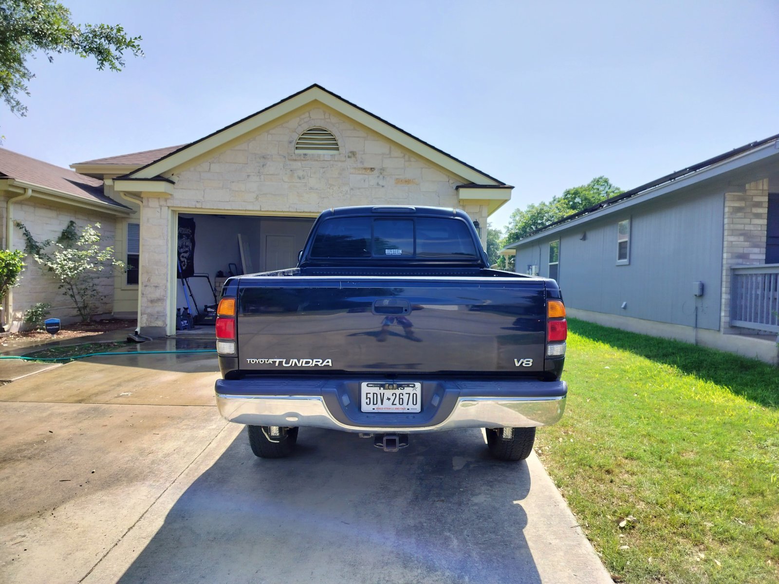

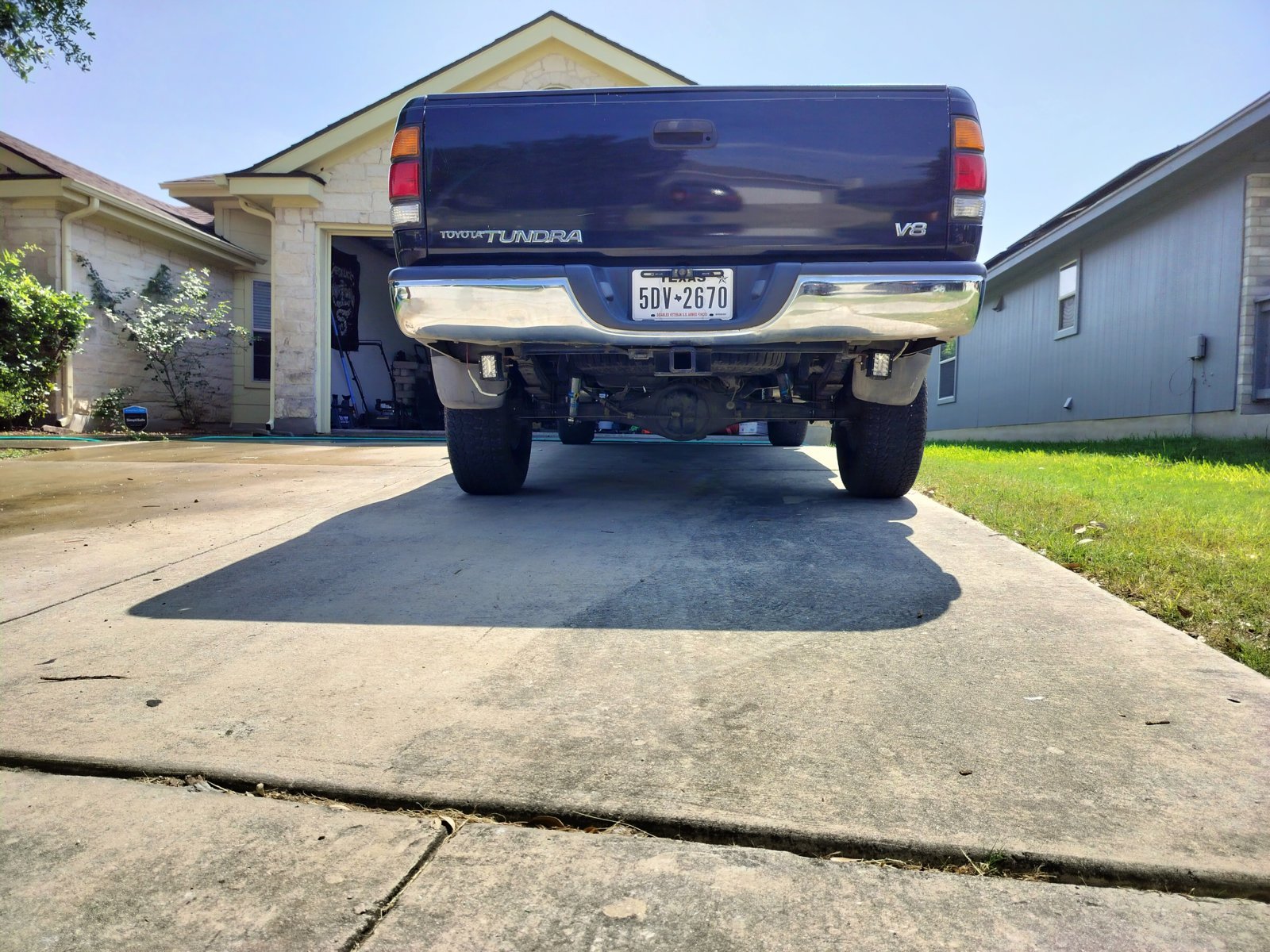

    OEM+, 6+1 bastard pack, 4.08 swapped rear end, custom spring shackles, 3 inch flat lift. This list will grow

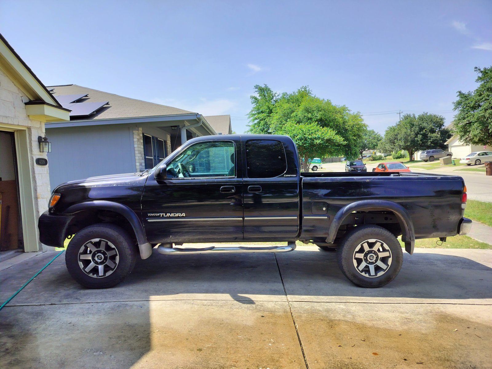

    Lmfao
    In my mind the 90s level truck is how a truck is supposed to sit on my mind.

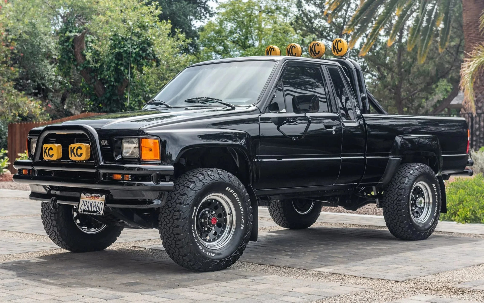

    Never say die styling (yes it's the B2TF Toyota)

    The McFly build. And that's an 80s truck lol. Still an epic truck

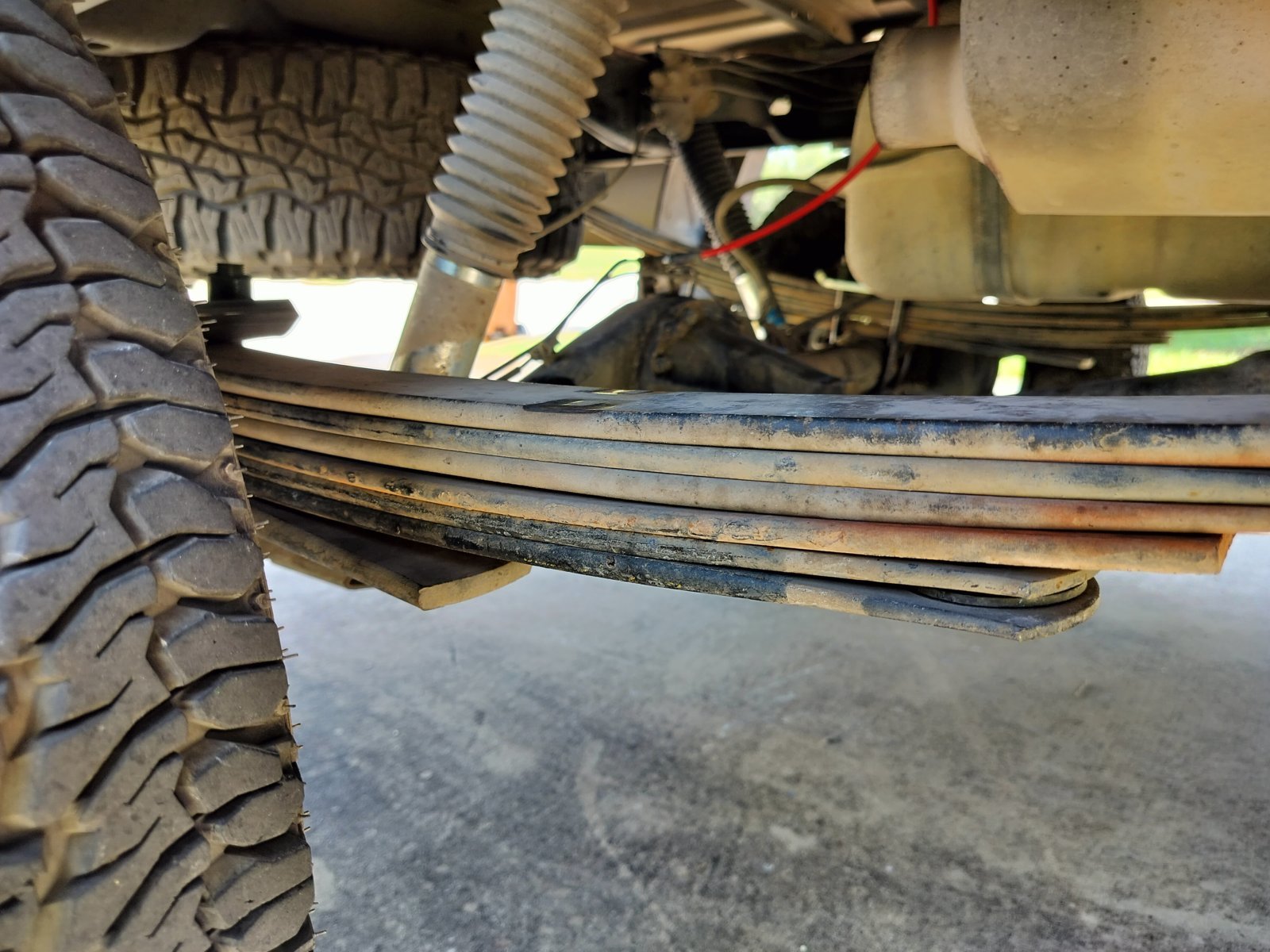

    Sadly, some won't get the reference I bet, we're all getting too damn old. I'd love to have one, I'd even be cool with it being 2WD.

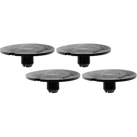

    I dunno, I'd have probably drilled the ends of the new leafs anywhere they make contact and slap some leaf shims/isolators in between them to avoid unwanted noise, creaks, squeaks, etc.

    There be shims

    There are indeed those plug shims in there bud. And we all said you'd say that. Can't do it how'd we'd want to, always do it to the "shifty approved" standard

    Nah, you do it how you do it, it's your truck. I only see a shim between the 1st and 2nd leaf, just seeing how much other dudes on here bitched about not having one between every shim and the noise they can make slapping together, I'd have taken the time. But it'd be a bitch and add an hour onto everything and cost $$ to buy several 4pk from Dorman, so I realize it's not for everyone.

    IIRC they actually had one of the shims upside down LOL

    They did, we fixed that along with the direction the AAL was installed.
