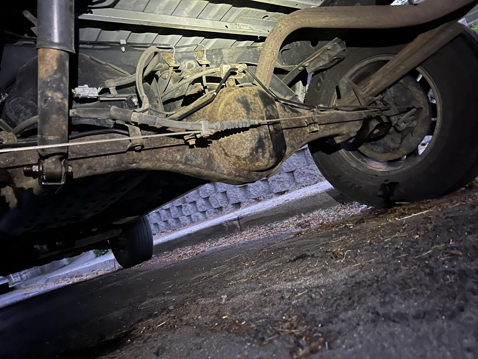

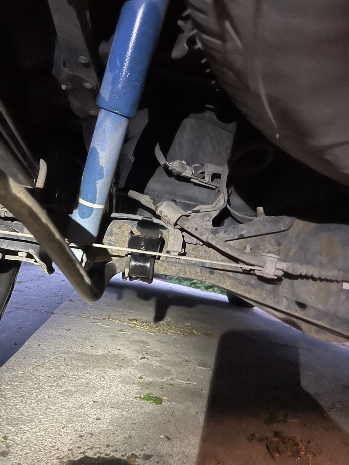

    Anyone swapped a 2wd rear sway bar and put it on a 4x4? Both my trucks are 2005 AC
  15. May 16, 2024 at 8:41 PM
    Bed Tundy
    Bed Tundy Like changing a tire, the 1st time you're careful
    Mar 6, 2024
    #113153
    203
    Neature Gary
    Moscow, ID
    (W) 2005 AC 4.7 4x4 with VSC, (G)2005 AC 4.7 TRD Sport RWD
    See Signature or my Photo Album

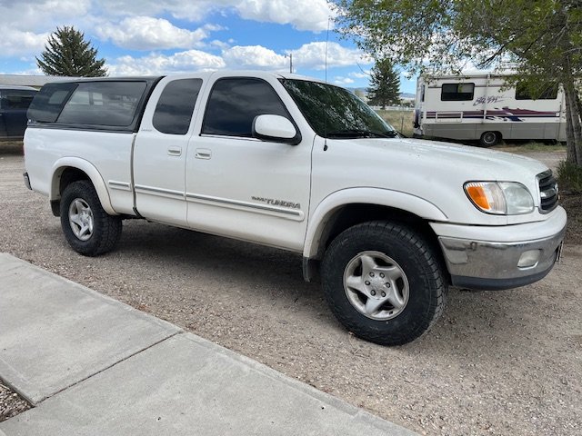

    Well I didn't personally do it, but after paying the bill I felt like I played enough of a role to post about it...New tires. Went from the inexpensive road tires the previous owner threw into the deal when I bought it to make sure I could make the 350 mile drive home (265 70), to some Falken 265 75's. Wanted a higher ply rating and the 70s didn't have it. Either needed to go 245 75, or 265 75. I once had smaller, skinner tires on my stock Tacoma alloy rims and didn't like the look, so skinnier than stock wasn't happening for the Tundra.
    These definitely fill out the wheel wells, which I like. Will see if I notice any power/mpg difference.
    Before
    After

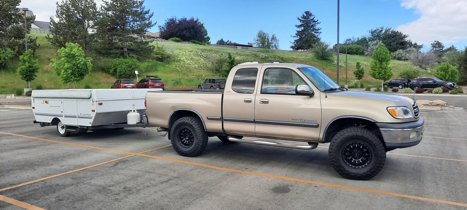

    Took the camper down to get registered today. She's mostly in working order, but I'm not getting enough voltage for the left side of the trailer. I believe the problem lies with the factory 4-way, so I'll replace that section and see if it helps.

    The plot thiccens... I have consistent voltage on both trailer lights, but the driver's side still doesn't light up. New bulb didn't help either.
    Still probably something wrong with the factory converter.

    Check the bulb socket opening possible the opening has increased is size over time and is not making contact with the bulb conductors.

    Where are you testing voltage?
    I hooked my truck up to the trailer a few weeks back just make sure the truck connection worked. Everything on my trailer worked when hooked up to the Tacoma late last fall. Driver side blinker didn't work when I tested it with the Tundra. I bought a 7-pin tester for the truck connection. Everything lit up fine. So I have a new bulb ready to install but I'll admit I haven't tested the actual socket on the trailer yet. Just figured I might as well have a spare bulb or two ready in case that's all the problem is.
    I'm guessing that testing the socket on the trailer is as easy as connecting a multimeter to it and a ground, but my electrical skills aren't great. When I'm doing a lot of it the info is fresh and I feel like I know more, but I've never done enough electrical work and testing for a long enough period for it to really stick. I'll need to do a little research before I'm confident I know how to test for power at the trailer light. Easier for now to just try a new bulb...
    The converter shouldn't be doing anything in this case though right? At least with my trailer, the converter is only used when I'm connected to AC, in order to run DC electronics. But with your truck powering the camper, it's DC to DC. No converter needed.

    Each bulb will have two connection points on the socket. If you can check across the two points without touching your leads together (will blow the fuse) that is the most accurate way. The safer way is to check the positive side with one lead to a good ground point. Then checking resistance from the negative side to that same ground point.

    They're making full contact, unfortunately. I just need to go over all the connections again and figure out what tf is going on. I still think it has to do with 4 way connections; factory pins could be toast.
    I just use a multi meter. Find the ground, check the voltage.

    Maybe wires are reversorama?

    Perhaps. I guess the lamp holder could loosen enough to pull a 180, and then the lamps base is reversed?
    I'm going to pull the 7 way apart tomorrow to see if one of those sweet children from China missed a connection.
