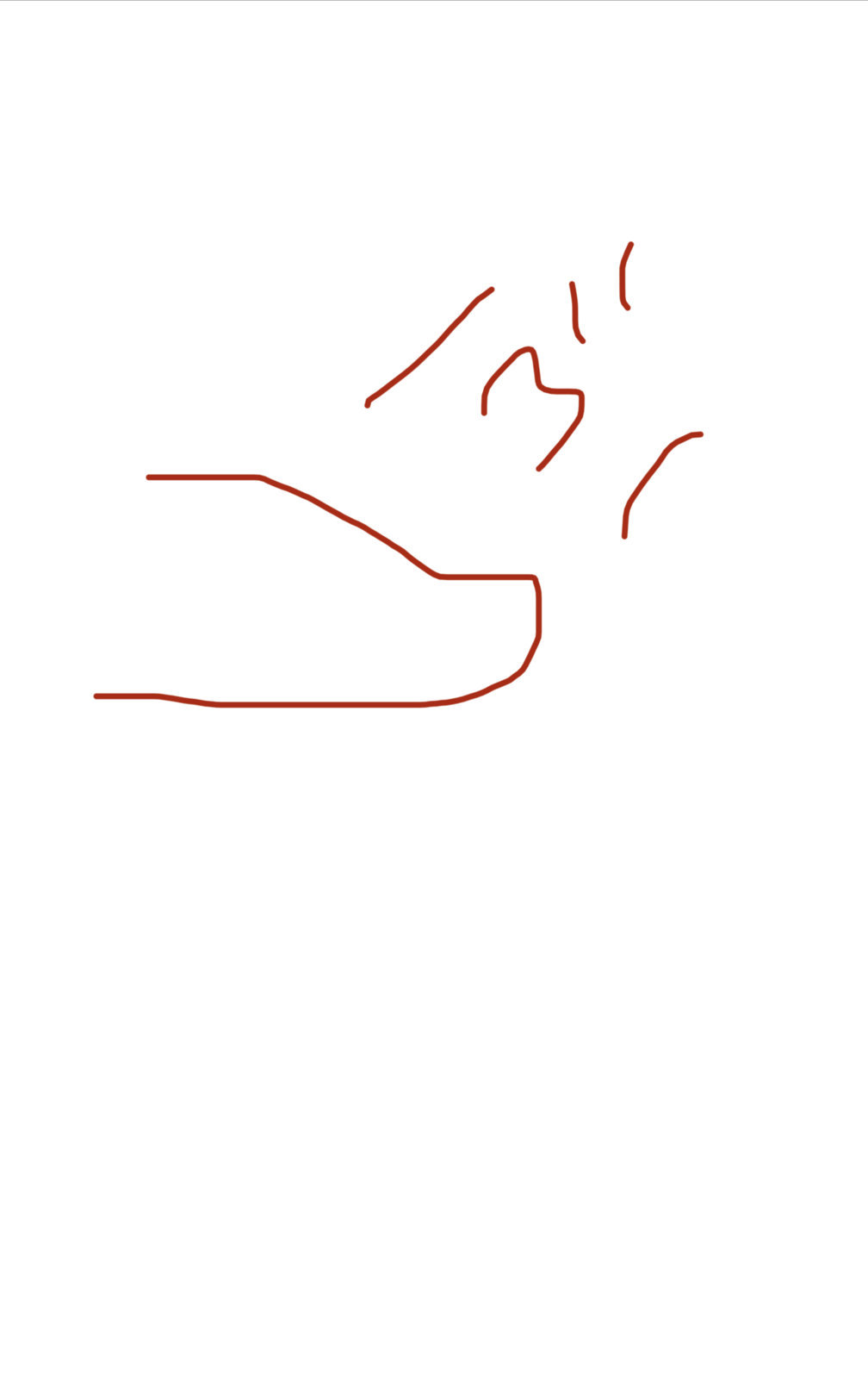

    If you do, your cab may sound like you have a SC or Turbo upgrade fyi but as long as you turn on some music, it’s fine.
    I made the Cowl end like this to give it an extra inch of protection from a gush of water. Think I posted it in this thread but not sure where so here’s a drawingB2094C23-6799-4199-9D9F-35F412C8C10B.jpgintake still 3”

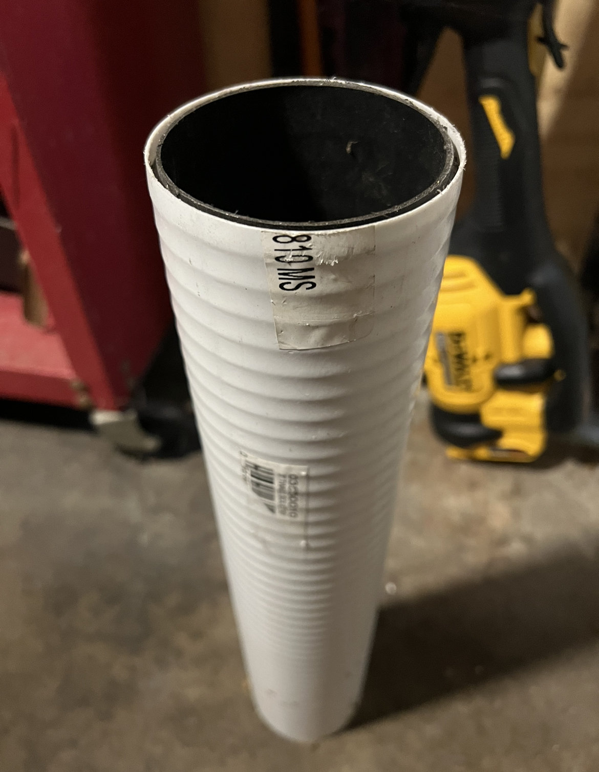

    If you do, the tubing that fits is the 3” white tubing used for garden drain systems. The black & white used for house plumbing won’t fit. And just in case you missed the edit above, this is what the Cawl space end looks like for an extra inch of protection.E2923CF5-645B-41A1-8B2F-DF02F47F8419.jpg

    Is your drawing showing that you put the intake upward in the cowl space to give a little extra height? Thanks for all the info, ill probably start this project on the weekend! Woohoo
    Great tip on finding the right PVC pipe as well, saves me from an extra trip to the hardware store although im sure ill be making a few trips anyways, haha

    Yes upward just in case there’s a lot of water that gets into the cowl space one day. @FrenchToasty reminded me how much water ends up on our windshields when we hit a puddle at speed.

    So you used 3" pvc piping as well? I'm planning on doing this soon and can't choose between 4" or 3". I did buy some 4" flexible air ducting to see if I could make that work. But it looks like 3" might of been the answer

    3” and it sits perfectly on the 3” intake
