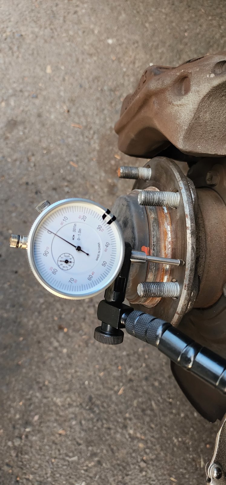

    Would hub runout cause odd shoe engagement? No brake pedal pulse? Easy to check runout..

    No brake pedal pulsing. And only 77k original miles on the entire truck. Started around 75k miles.

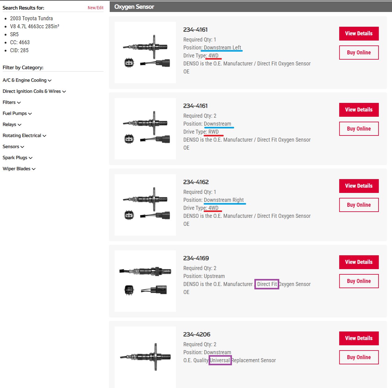

    Warning: Don't fuck around with O2 sensor part numbers. The part numbers change based on year, and often based on whether you're 4WD or RWD.
    Always look up O2 sensors at the Denso site directly: www.densoautoparts.com
    Be VERY careful when you pull your part numbers:
    • Make sure you're getting the "direct fit" part, not the "universal" (purple below)
    • Pay close attention to the POSITION i.e. "upstream" vs. "downstream" designations (blue underline below)
    • Look really carefully at the DRIVE TYPE descriptions for "RWD" or "4WD" (red underline below)
    • Look at the REQUIRED QUANTITY box can sometimes tell you if there's a RWD/4WD difference or not, or if you see "left" or "right" that's also a red flag you need to pay attention.
    • DO NOT use the following example to figure out the parts for your truck, because these sensors apparently vary by trim package! (SR5/Limited/etc.)
    Example.

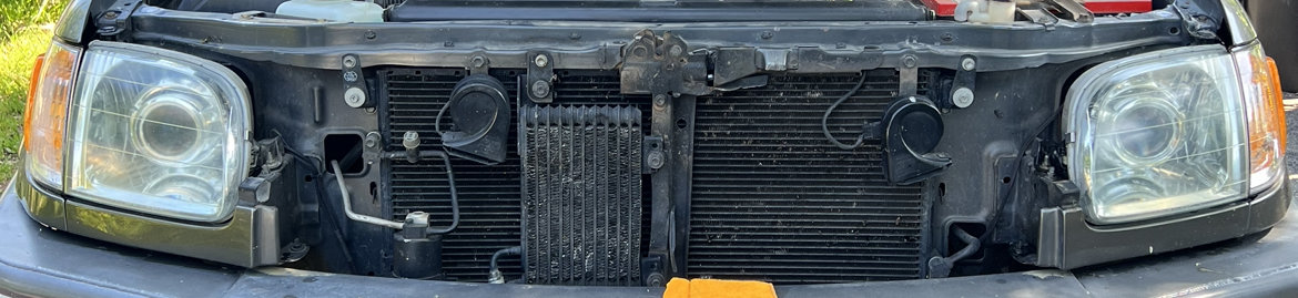

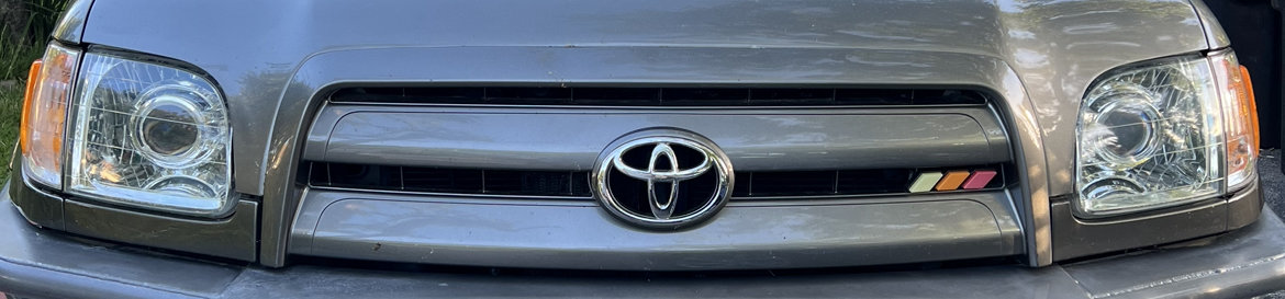

    So I removed my stock washer fluid reservoir and cut my bumper area a bit. I cut it at an angle and think it looks pretty good. But my other car was in front of the truck so couldnt get a good view of the front to see how I like it. Ill try to take a picture today to get a better view of it to share with you guys.
    My question is: Can I remove the fluid reservoir pump/sensor and just drill a hole in any other container and mount it up? Id rather find a container and reuse my pump/sensor rather than buy another one if possible. Although, new reservoirs with the pump/sensor arent very expensive either for generic ones. But figured why buy a new one when I have a perfectly good one i can reuse.
    Unless anyone here wants my stock washer fluid reservoir before I hack mine up?

    pretty our oem washer fluid res. And pumps are worth gold? Or am I wrong?

    I used my old pump on the new tank. Think they’re universal

    You bought a tacoma tank correct? That one didnt come with the pump?
