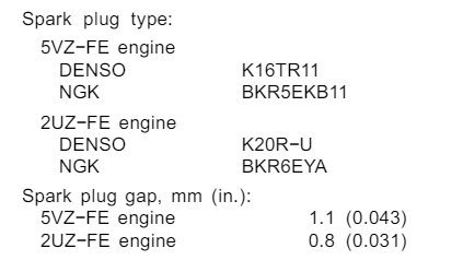

    So what’s the take on this situation- I’ve had a persistent PO420 code off and on for a few years, at first I could clear it and it wouldn’t come back for months, now it pretty much comes back immediately (after a few on off cycles).
    The other day I was a little under 1/4 tank and I dumped a whole can of Seafoam in the tank and the check light went out immediately and stayed out until I filled the tank later the same day, came back a few minutes after filling. Does that seem to indicate my cats are probably alright and I need new O2 sensors, or am I thinking about this all wrong?
    I’ve thought about just doing all new sensors since I don’t think they’ve ever been done (365,000km) but don’t want to just throw parts at it.

    Okay, my search skills are sucking right now- what’s the recommended spark plug? I don’t even recall what I used last time, I believe it was a single electrode copper per the manual.

    NGK copper single electrode is fine for an 03 v8. Dual electrode if v6.
    NGK platinum if you fancy.

    Manual is correct. NGK or Denso; can't go wrong with either one.

    In your build you use the same part number for both downstream, Rockauto is showing different ones for either side (with 4wd)..? I’m guessing it’s maybe just a difference in wire length?
