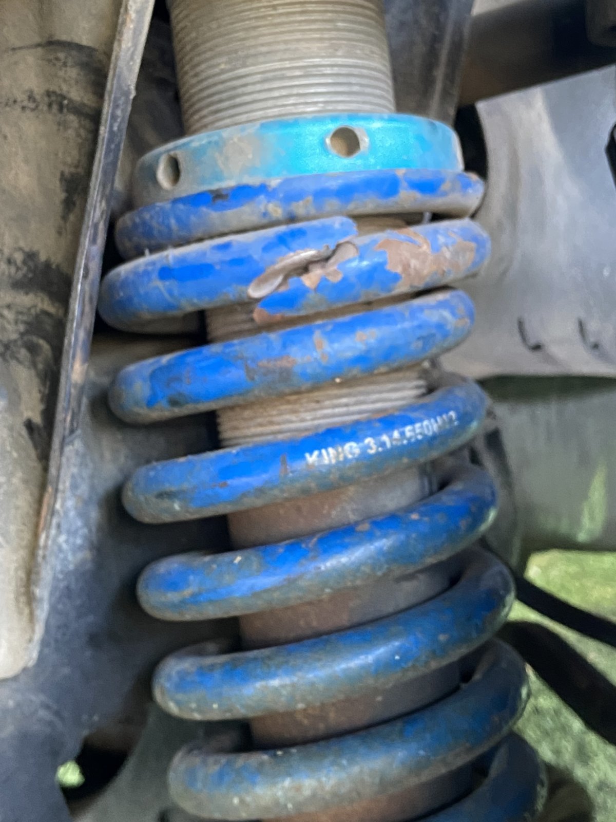

    to be continued...

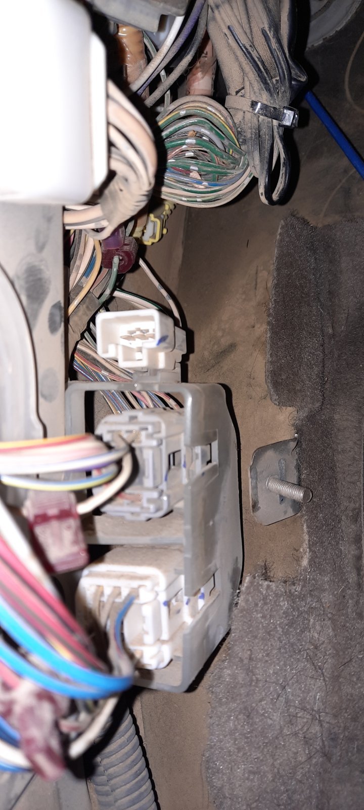

    Awesome, thanks! I got the 7 way mostly hooked up today, but still need to finish everything with the controller. Had every intention to finish it this weekend, but I got fuggin sick on Friday and tackled what I could today.
    Spent 30 minutes trying to route the blue wire through the grommet by the brake booster, figured that was the lord telling me to stop screwing around and go eat dinner.
    Side note, anyone know what this empty connector is for?

    That sucks. Those kings?

    to be continued...
    Yes sir. I have to admit I’m rather abusive to my truck on a pretty regular basis, and things break/get broken. Didn’t expect this one tho.

    Bro, if you tell me that's the factory brake controller connector...o_O
    I've searched online and could neither confirm, nor deny, so I went ahead and ordered the adapter just in case.

    Looks a lot like where my factory tow package brake controller plugged in.

    That sure would be swell! It was my first thought, but everything I heard and read online led me to believe it just wasn't a thing on pre 03 trucks...even if I had the 4 way and hitch receiver; which I do.
    Should've just pulled the GD panel off in the first place.

    No promises, but yeah, that’s what mine looked like and in that location. It’s not enough wires though, so…
    Is there anywhere you can access build info on these trucks, like through the Toyota site? Everything I can find also says no tow package wiring pre ‘03.
    Maybe pull out a multimeter and see if you can figure out what they do.

    Yeah, definitely doesn't have enough wires. I knew I was going to need to run the blue and power for the plug anyway.
    I'm gonna stick something in there, though!

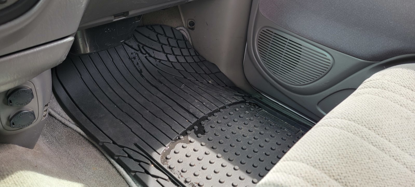

    Finally got some fancy weathertech floor mats.
    Fronts only after I recalled @shifty`'s debacle with rear fitment.

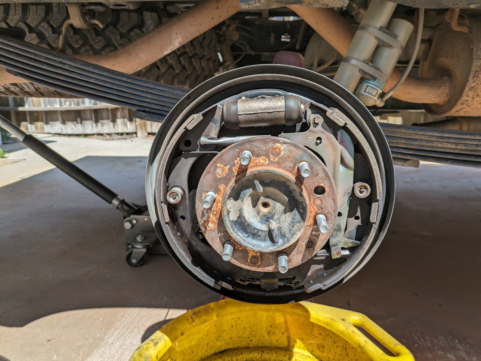

    Hey guys, popped off my drums this weekend and gave them a good cleaning per @FirstGenVol (I think). Took a bottle each side just like you said, haha.
    So I wanna adjust my star adjuster a bit more and afterwards adjust the bell cranks. Per the FSM, it states having like .04 - .08mm distance when pulling a bit on the bell crank away from the backing plate and then setting the adjustment screw. Not sure how far to pull before creating that gap and then adjusting the screw. Anyone have any info on adjusting the bell cranks?
    I saw a great Youtube video that a tundra owner posted but he didnt mention pulling on the bell crank to create the gap to then adjust to around 1 mm. Sorry for the confusing question, but im confused lol.
    Anyways heres a shot of a cleaner brake drum assembly! Also a bonus to using all that brake cleaner is I felt pretty euphoric after inhaling a bunch of it! JK

    Did you lube the contact points in the drum mechanism?

    I lubed 3 areas on each shoe that a video mentioned where the backing plate is raised. Is there anywhere else I should lube? Im gonna be opening them up again today to have a look and do some adjusting.
    The guy in a video mentioned adjusting the star adjuster until the drums are kinda difficult to slide back on and that gets you in the ball park for proper adjustment. Gonna try that today as my drums seems to slide on too easily. I guess you can also adjust after installing the drums and listening for the drag as well. Im still learning as ive never worked on drum brakes before.
    Also I used Hi temp disc brake/ wheel bearing grease for my lubing. Is that the proper lubricant to use?

    Anywhere two pieces of metal touch in the mechanism is worth a little lube. You wanna go easy in here as there will be lots of brake dust production. Pivots, starwheel threads and contacts, brake cylinder to pad contacts, PB mechanism contacts etc. And brake grease is fine. I just smear some on with a finger, I don't leave any globs in there.
