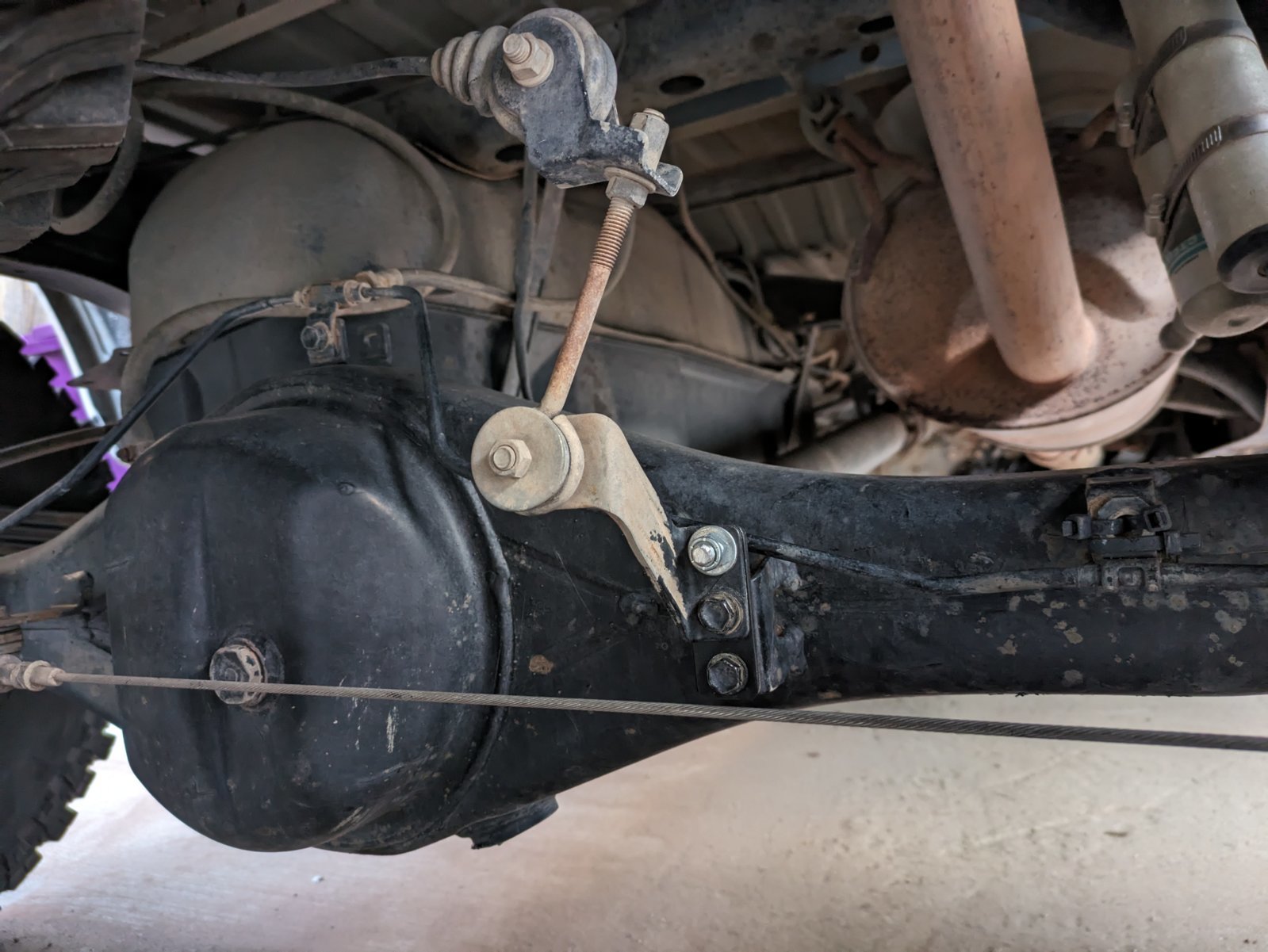

    Question for you guys.
    I saw a couple pages earlier there was talk about adjusting rear brakes and parking brake.
    I looked at my LSPV and noticed its adjusted upwards, "the nut towards the sky", almost all the way up. Is this too much rear brake? I have no experience with drums and parking brake, but when I noticed that and looked at other pictures of tundras online, I didnt see any adjusted that much towards the end of the bolt.
    Also, I see they have LSPV brackets that are used to adjust the position of the entire LSPV assembly upwards to account for having a lift. Is this something I should do for my LSPV since I have around a 1" lift in the rear? And the extra weight from my camper would make me need to adjust the bias upwards as well?
    Thanks guys!

    Mine is all the way to the tippy top and I’ve liked it so far, I also adjusted my rears pretty far out so it grabs nice
    oscardog86[QUOTED] likes this.

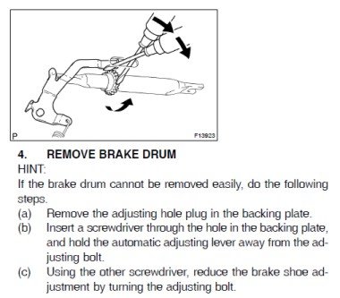

    Yep, thats the diagram I saw that showed a pick with a 90 degree at the end can be used to undo the adjustments.
    Never gone too far with it then im guessing?
    FrenchToasty likes this.
  16. May 2, 2024 at 5:31 PM
    FirstGenVol
    Dec 13, 2018
    #22934
    14,387
    East TN
    2002 AC TRD 4x4 V8

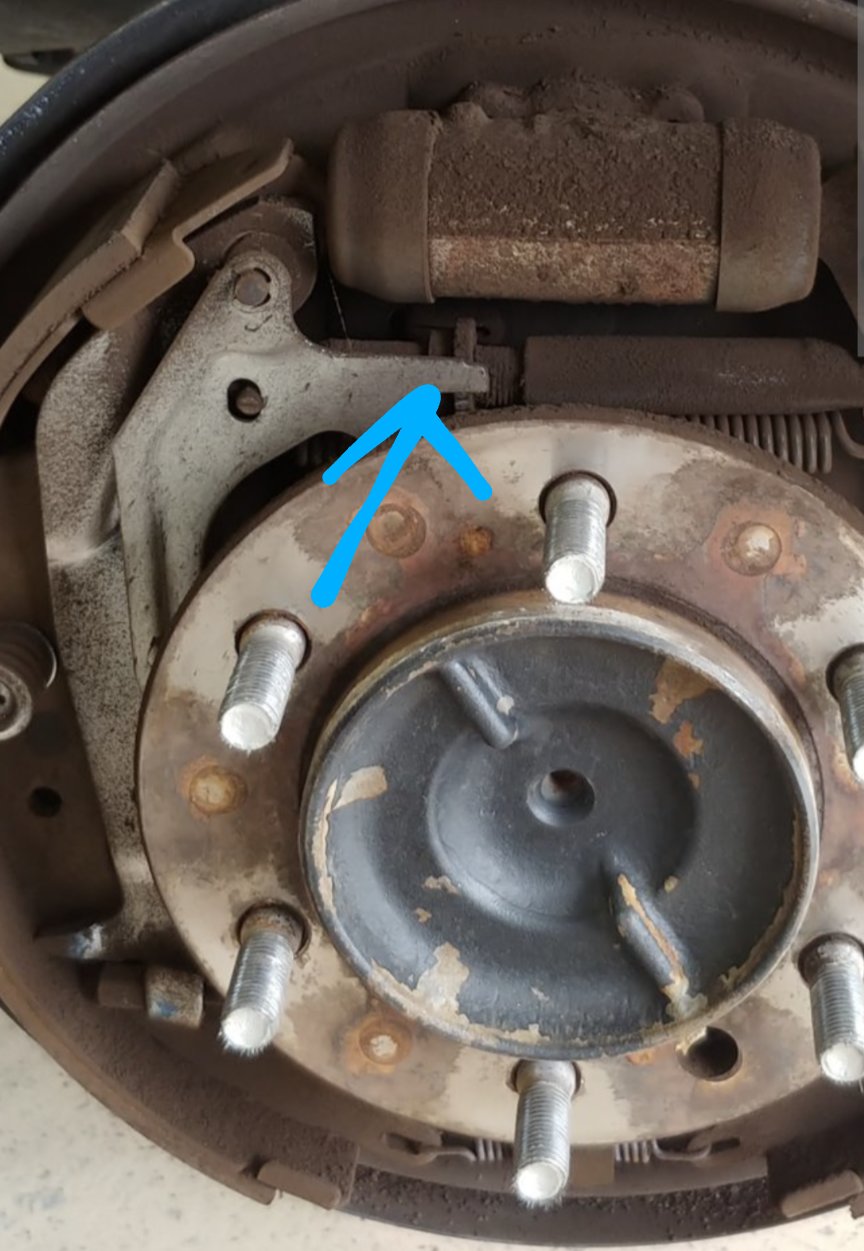

    If you over tighten them you have to back them off and start the process over. It's a pain but gets easier with a little practice. Sadly I have too much practice with all of this.
    To back them off you have to push on this lever from the peep hole and then turn the star wheel.
    This may not be for our exact truck but it's the same concept. I just found it on the Google.

    @oscardog86 how many miles on the truck? My rear shoes lasted almost 200k miles. If you haven't done any work to them it's not a bad idea to pull the drums, clean everything(1 can of brake clean per side if they are real bad) and lube the contact points.

    In theory but not in practice. When I replaced my shoes last year I kept using the parking break. I could hear the start adjuster turning. Eventually it stopped and I assumed it was good. Took it for a test drive and I had essentially no rear brakes. I had to dial them in manually.

    Just made a quick little bracket after work today for my LSPV. Raised it about an inch. Ill give it a try soon and see how it feels.
