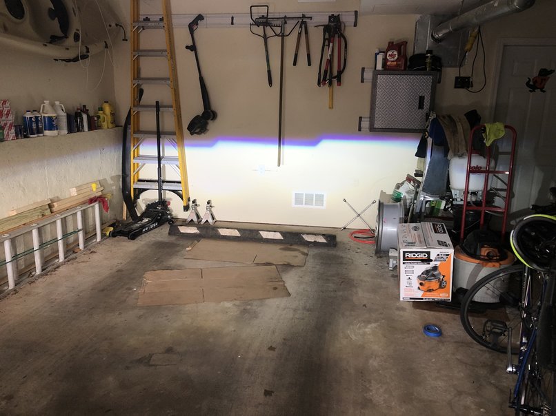

    No stair step from the driver bulb up to the passenger. The top lines on both lights should be perfectly level.
    The step-down is purely to not blind oncoming drivers from the left half of the truck.

    For visual example, this is pretty wrong.
    This is almost right.

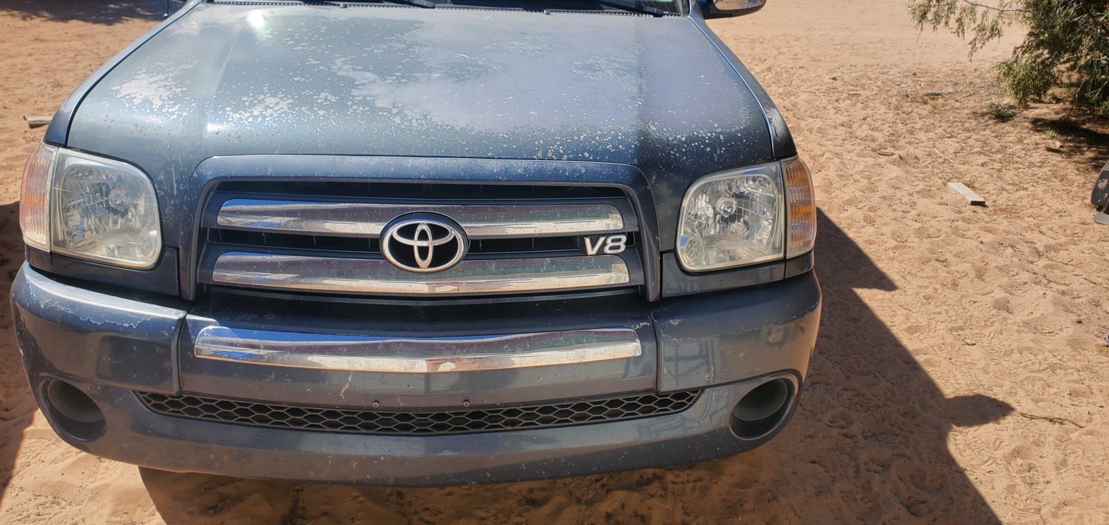

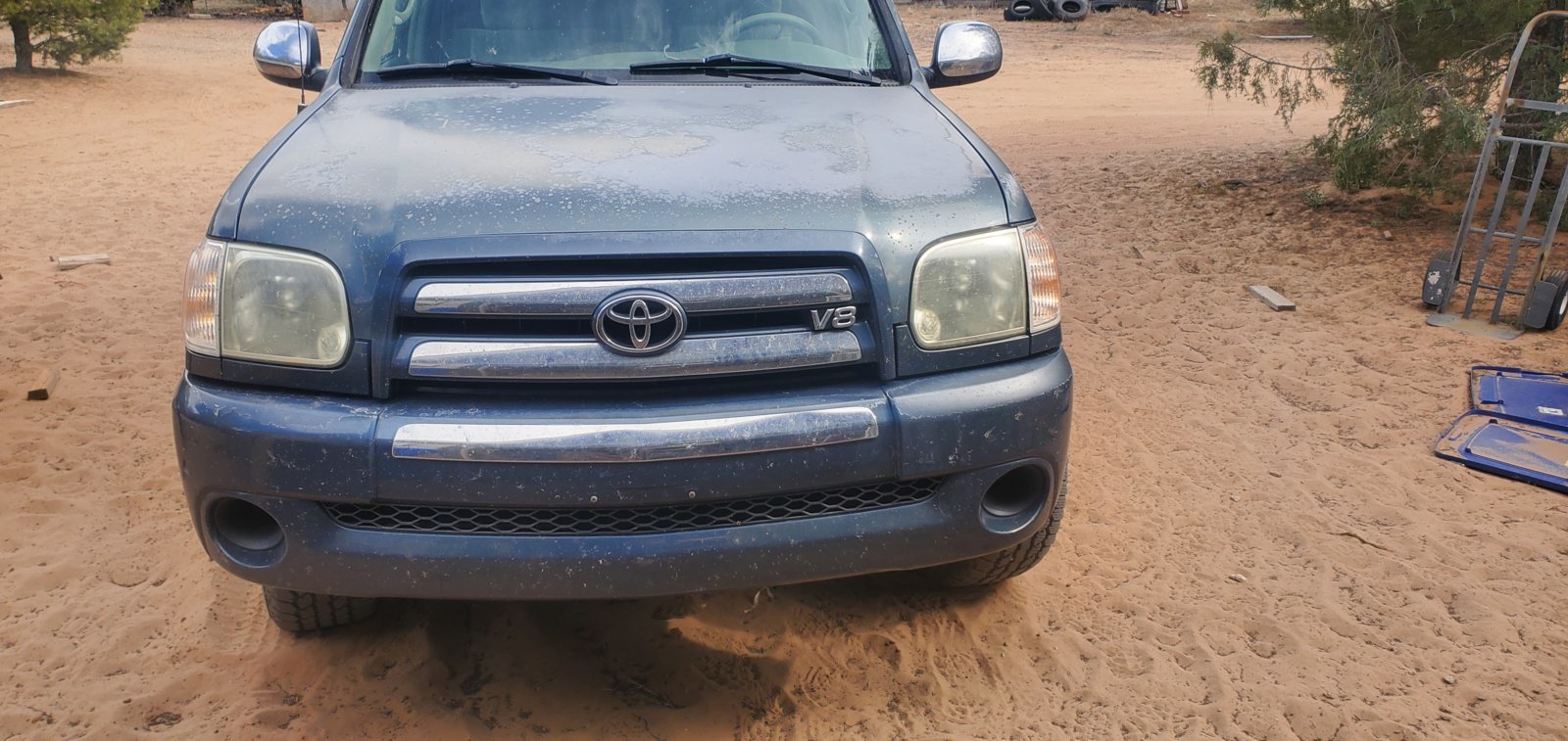

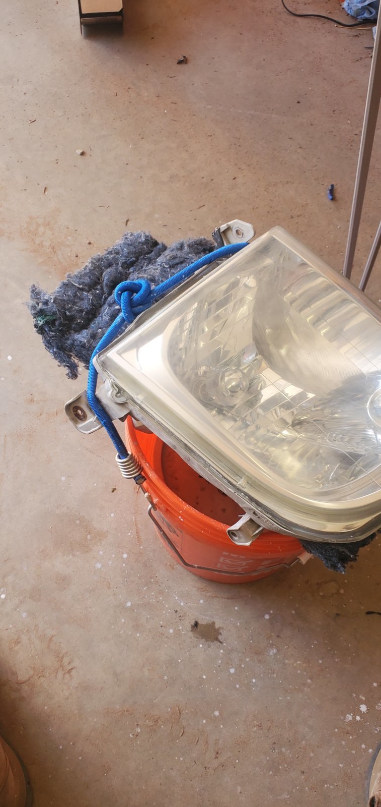

    Headlight polish. After noticing the bad reviews on aftermarket headlight assemblies, and choking the price of OEM. I settled on polish and repair. One of the mounting tabs was broken off, so I reattached with an aluminum spine and a bunch of JB weld. Used a weighted 5 gal bucket and a bungee cord to hold the assembly while i sanded and polished the lens. 20240424_162949.jpg 20240426_103305.jpg 20240425_140205.jpg 20240425_123832.jpg

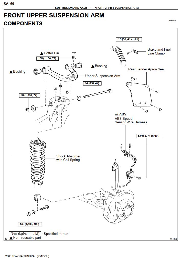

    Think I’ve found what was causing the popping sounds from the front passenger side. EEB5B7DF-BD19-450A-ADEF-E4C8707F0F6F.jpg
    Came lose just by loosening the top bolt. Fairly sure the outer tie rod end needs a hammer to pop out from DIY video I watched.

    Looks like 98Nm to me. From 2003 FSM:

    72 ft-lbs (98 is nm). According to the pic/legend.

    Yup, Nm. I better go up and edit that before someone takes it for lbft.
    I always try to keep the legend in the screencap when I post those.

    Ok so maybe Camburg does want 85. Had these on too tight then.

    Jba also calls for 85 ftlbs.
