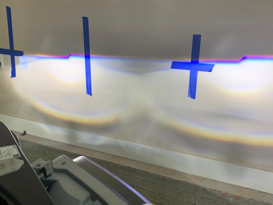

    Little help...
    I'm 5' from the wall, doesn't seem right just yet...
    (the tape was from last night, I'm not centered as I was...
    Cross tape is about 41", center of housing a little over 42"

    I don't see anything wrong, look level

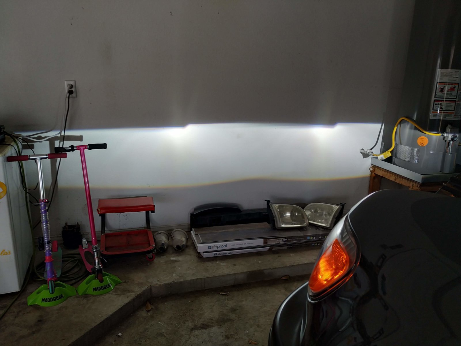

    what my projector cutoff looks like for comparison.

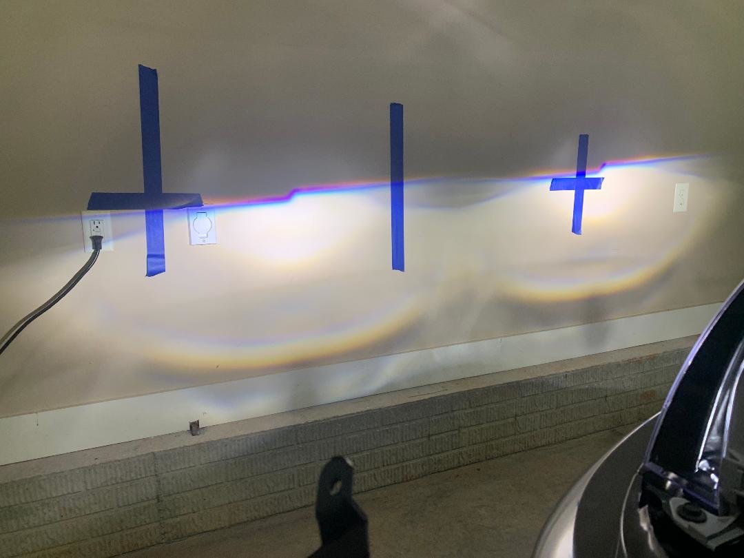

    Pulled the bulbs back out, adjusted the set screw, got the center line to match up

    Lines should look like this on the wall; you want the top line and bottom line parallel, and the tops flat. not stair-stepping:
    _____________/¯¯¯¯¯¯¯¯¯¯¯ /¯¯¯¯¯¯¯¯¯
