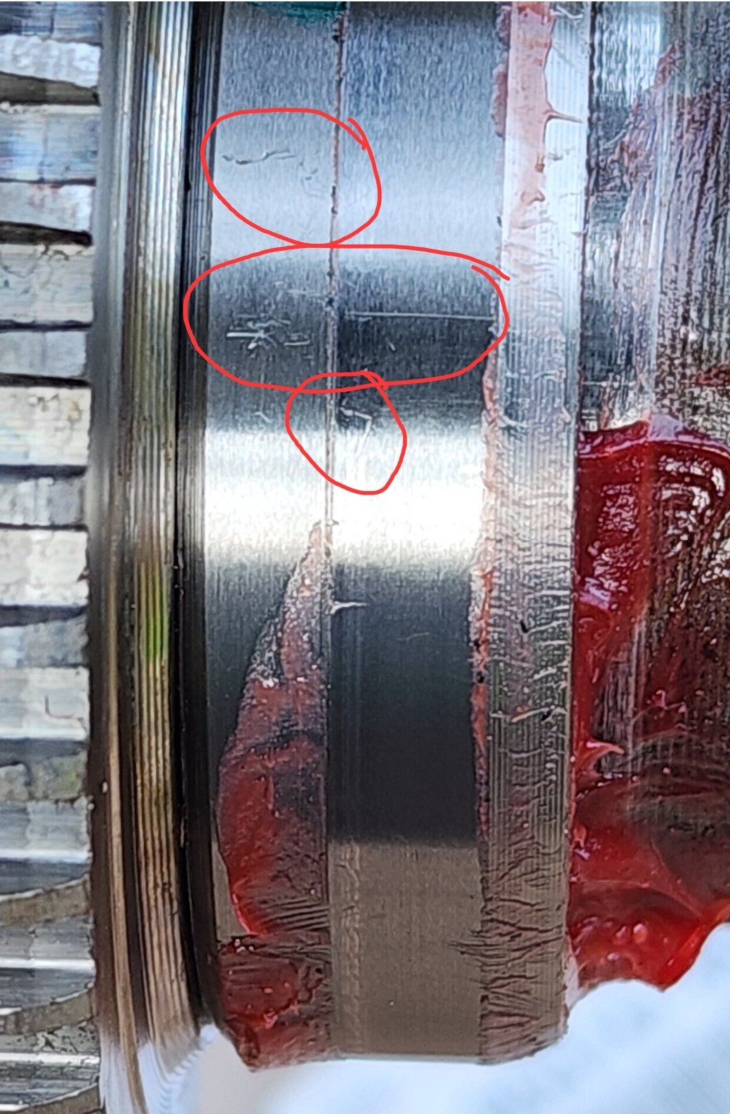

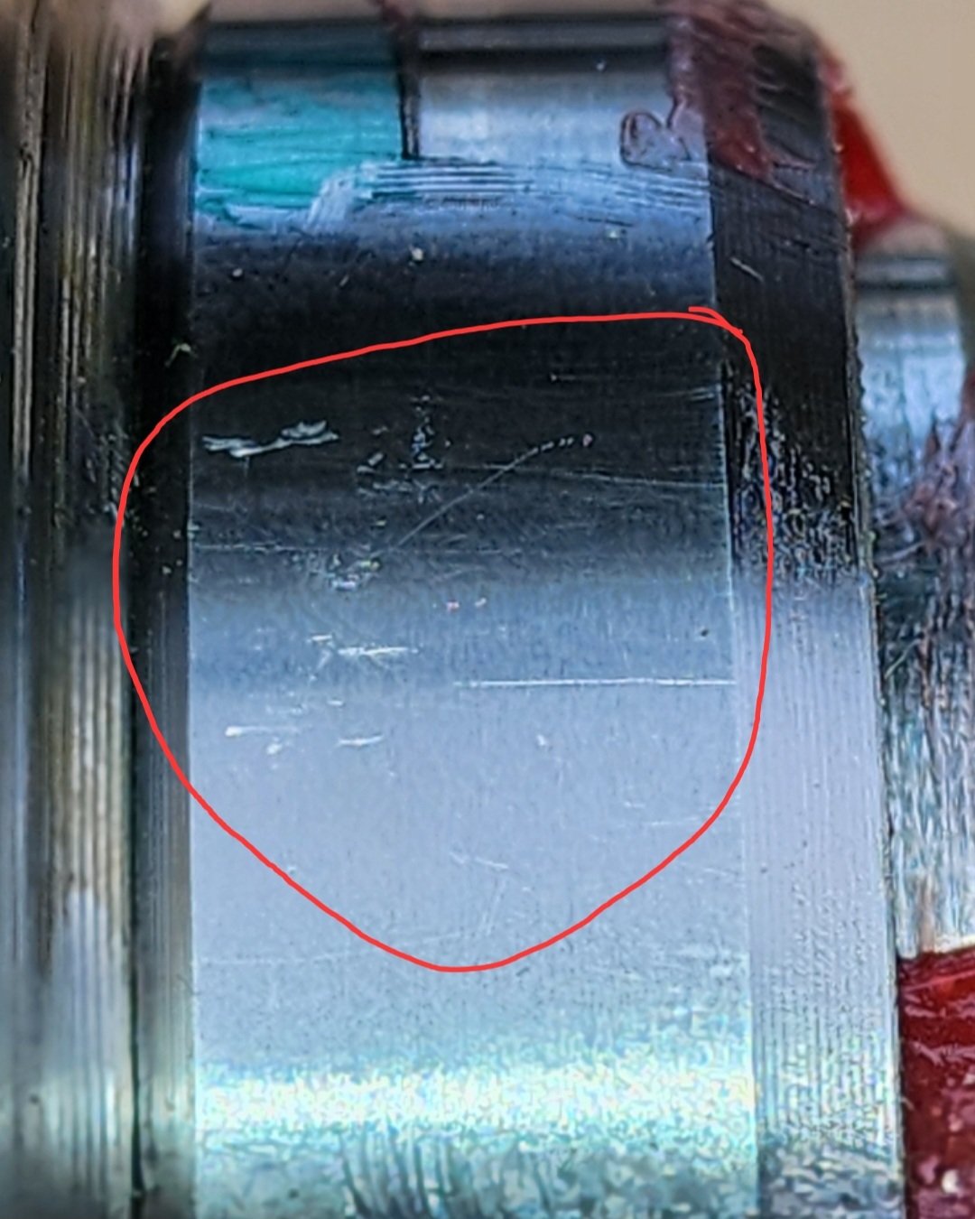

    Pulled rear axle and took to machine shop for a reasonable price to press off/on bearing that was getting loud.
    The retainers provided to the shop looking pristine came back like this. Have no idea how that could happen, like maybe it fell on the floor or something during install ....
    Scratches/pitting top left can be felt but assuming any scratching however small that would be under the seal lip is unacceptable, so planning to ask for retainer to be heated off and another installed since need the truck back up and running ASAP and don't have time to wait for the SST by mail. Too picky or this is a problem right?
    Hopefully new seal wouldn't be damaged from just the handfuls of spins to do the sharpie/grease test.
    Placement isn't bad but probably could be pressed another 1/2 mm more...
    Ordered 2nd bearing Friday proactively for other side, and plan to get the HF shop press and SST for that intall ... instead of relying on a shop again for this.

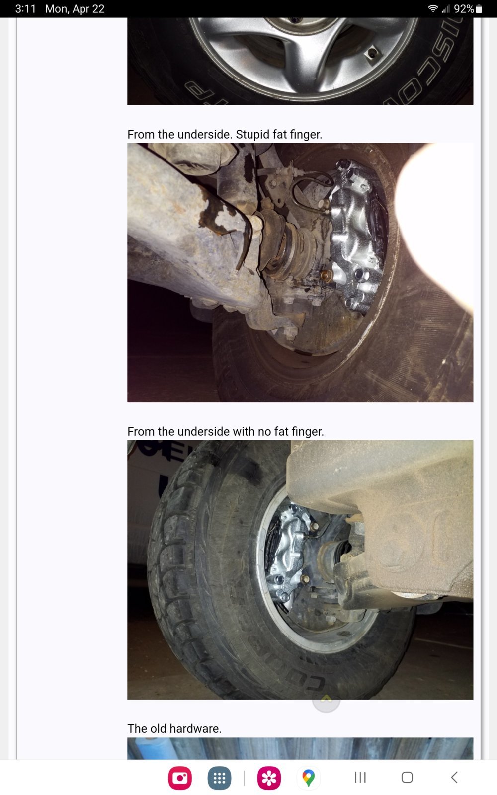

    Who was asking about 13WLs in a starfish?

    That's what I'm talking about a tight fitting starfish ;):thumbsup:

    I've heard or read somewhere that only the forged 16's will fit. That cast trash has to be bigger.
    unless you let em rub for a bit.

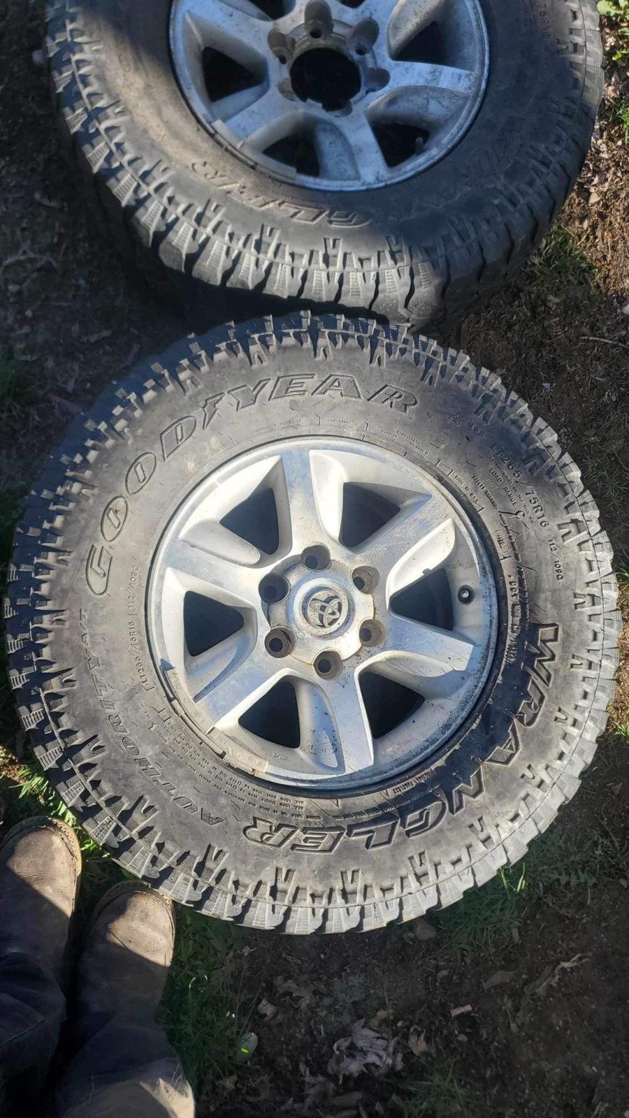

    I was asking about them in these obscure stock 16”, but they were from 05-06 so they had to fit. IMG_2097.jpg
    Anyone have two center caps for this wheel?? Hard part to find

    Those are pretty nice wheels

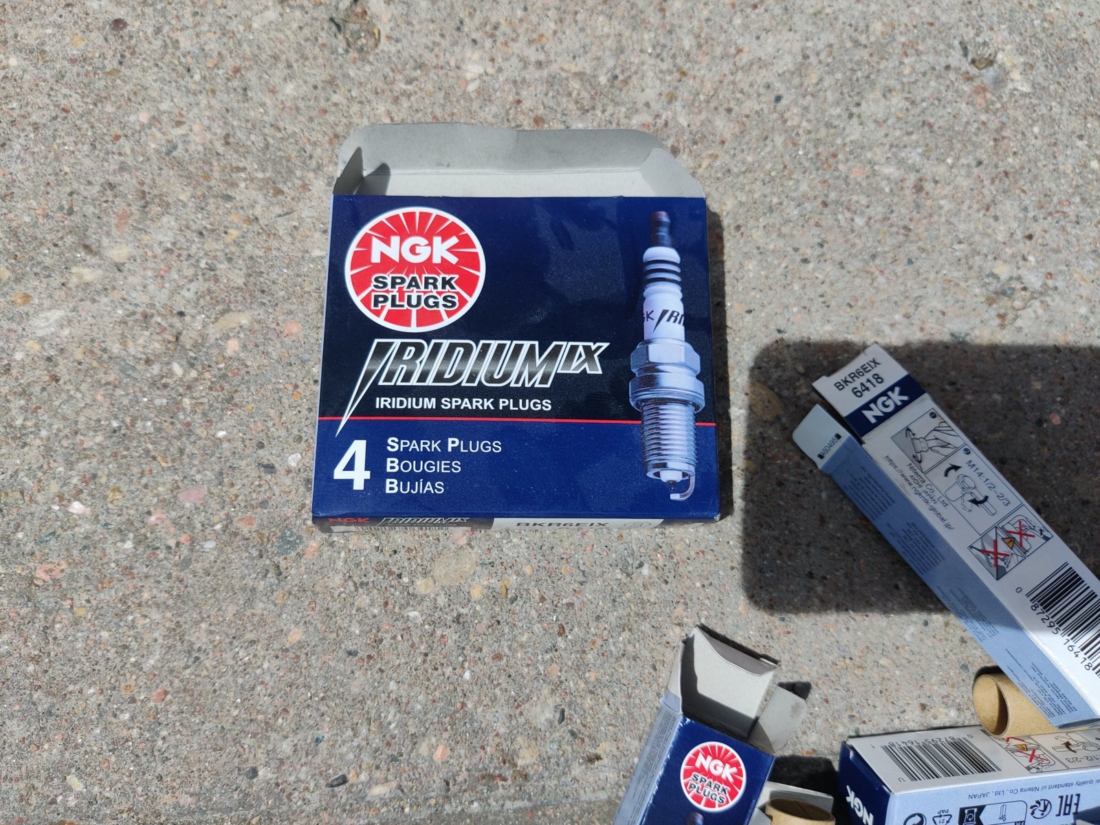

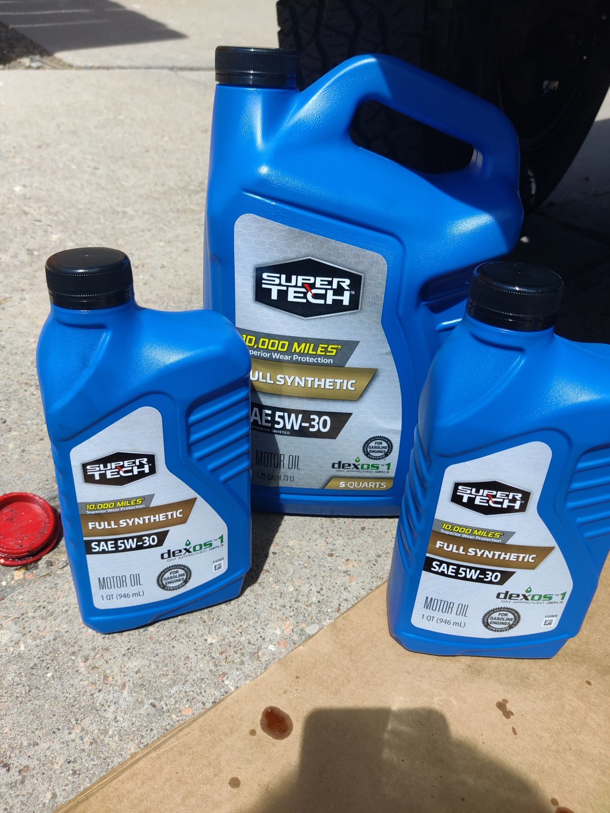

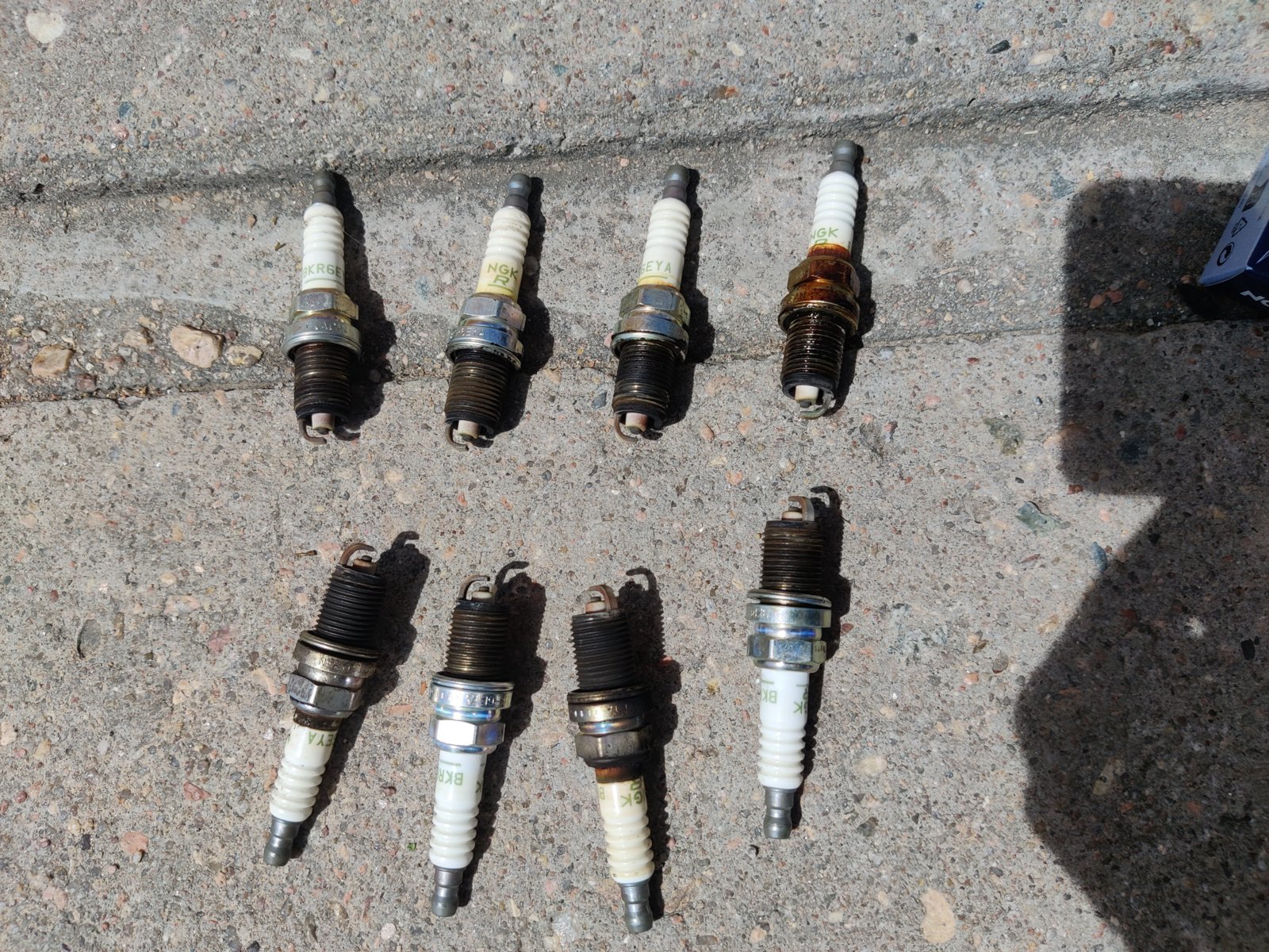

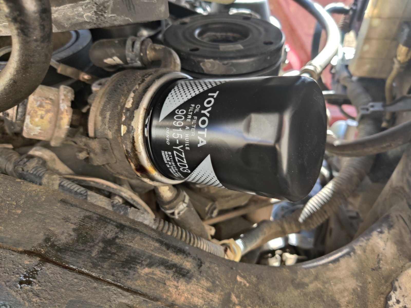

    Did my plugs and oil yesterday. After running Seafoam for 500 miles, the oil looked pretty gross. Will probably do a short interval for this next change and run Seafoam again. Also looks like I have some seepage on the very rear passenger spark plug tube. So tubes along with the valve covers will be added to the list, though it's a low priority at this point.
    Also my plugs were quite worn. Maybe originals? Idk.

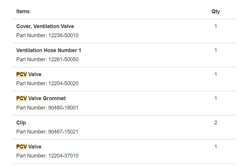

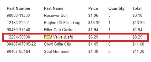

    Here's the PN's for the hose, grommet, pcv valve, clamps, and pcv valve cover for my 2001. I believe yours would be different due to the VVTI and secondary air injection.
    These are the numbers for a 2005 (V8 AC 2WD, should be the same for 4wd) based on toyota parts now, which is a good reference.

    Just a note to @Bed Tundy though - your 2005 won't use the grommet, it's thread-in. Thus, your part number is going to be different also. Your 'o5 will probably match my '06 with a thread-in unit. Part number here - there's only one digit diff'ce between thread-in and non-thread-in.

    Thanks! That hose looks about right.
    Thanks shifty, I have a new pcv and hose coming soon n the mail.
