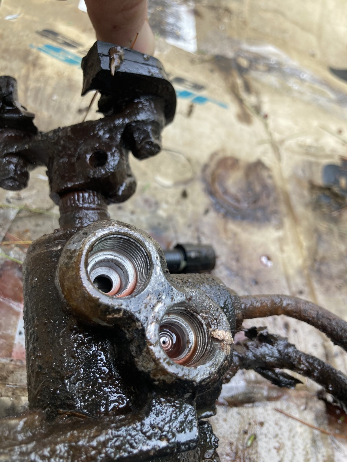

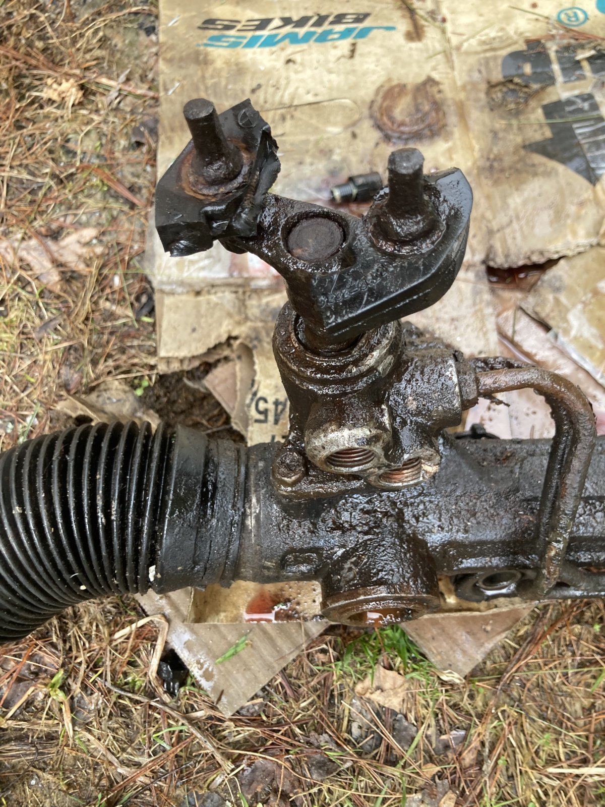

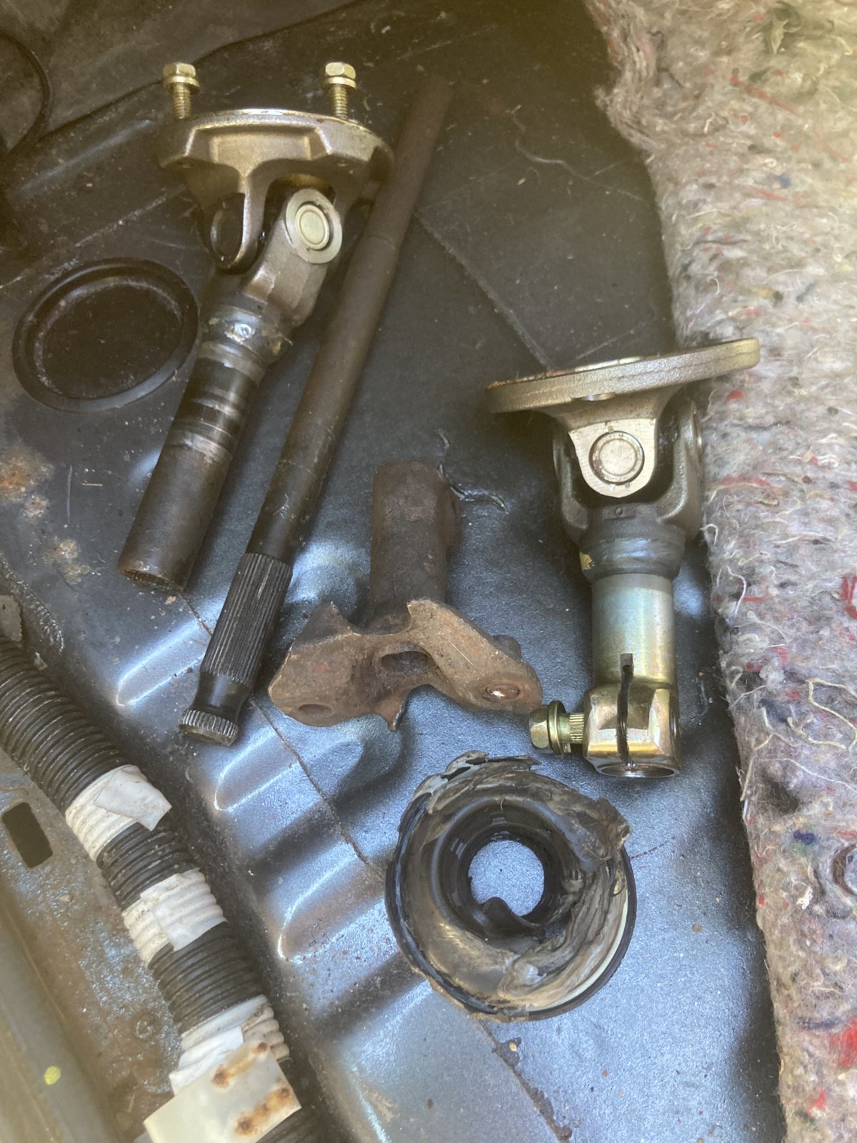

    I’ve got some first class northeast rust/ mangling for you guys
    The old rack came out, but only by cutting the rubber between the two parts of the coupler (45230). It had a tear in it after all the heat/bang/pull. That part is 75 bucks from McGeorge and on the way.
    Old rack failed leaking from the steering shaft input, but you can also see there is some metal cracked off where the lower fluid line goes in. Pretty of thread there, and it didn’t leak from that fitting. There is evidence of some other previous mangling too.

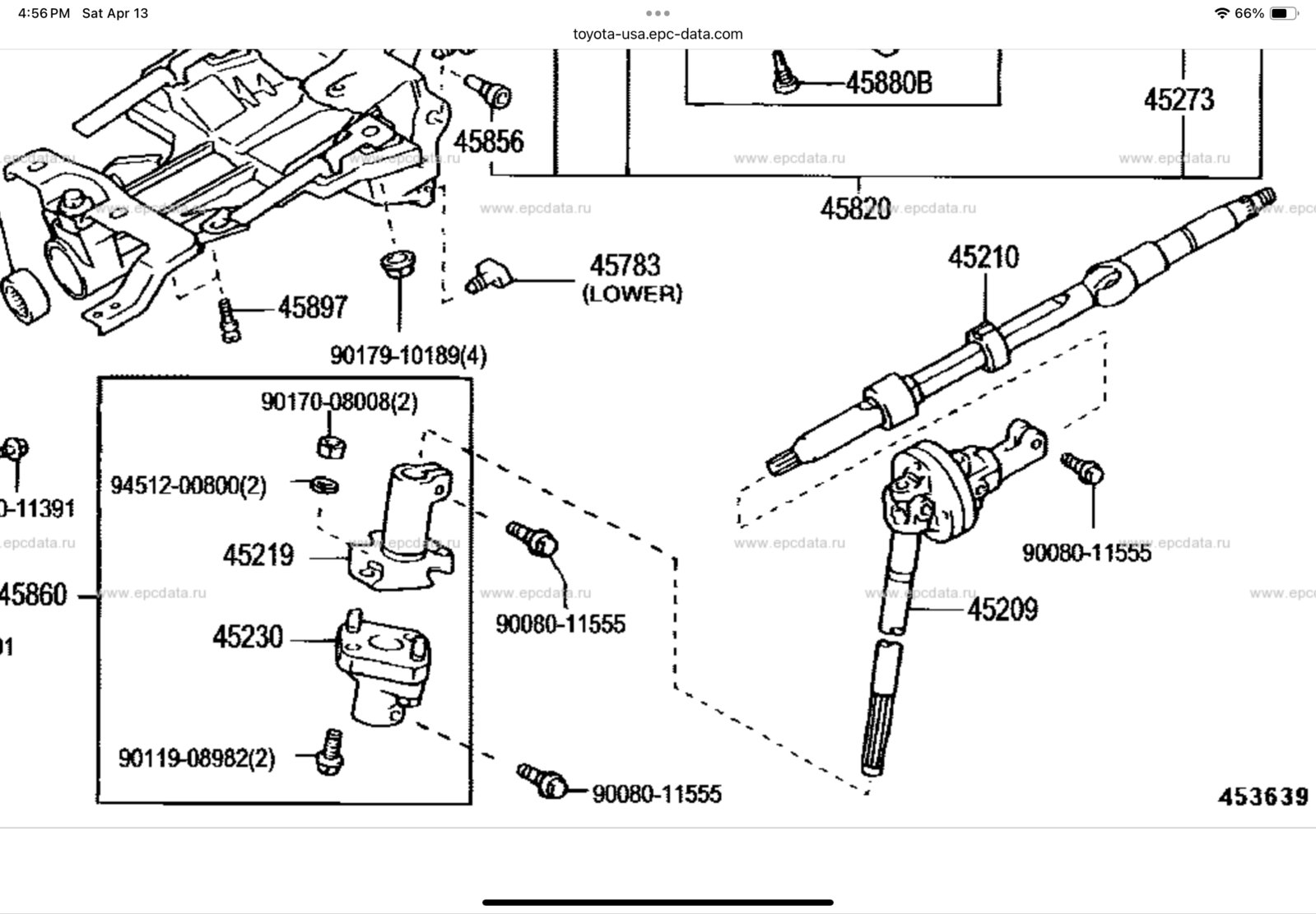

    Now my mangling and current dilemma. The upper half of the coupling (45219) had two rusted/rounded bolt heads, so I ground them off expecting to then knock the nut off the other side, the parts diagram shows a regular nut…the ones on this coupler are welded, and I can’t get the grinder around to grind then off.
    So now I’m pondering my next step. I think I’ll either;
    A. Go buy an Air hammer and see if that’s the ticket to getting this part of the coupler moving and sliding off the shaft. At which point I could replace it. I have no idea whether there is any chance that’s gonna work, I do know I can’t generate a ton of force swinging up while laying on the ground.
    B. Weld two studs on there and bolt the new lower coupling onto there.
    Parts diagram because everyone loves those.

  3. Apr 13, 2024 at 2:07 PM
    Jack McCarthy
    Nov 2, 2020
    #54409
    10,262
    Bill
    North of Boston
    02 Tundra AC SR5 V8 4x4
    How much to replace that upper coupler instead of fighting it?
  4. Apr 13, 2024 at 2:11 PM
    Arringtonpalmer
    Arringtonpalmer New Member
    Oct 3, 2020
    #53095
    120
    Sam
    New Hampshire
    2004 Limited Double Cab
    ARB Bumper, Warn Evo, UTE H66 tray, OME 2884 and Nitrochargers.
    @Jack McCarthy , $40 MSRP. If I could get it off I would replace it. That’s where I’m thinking of buying and trying an air hammer. So far I have not gotten it to budge.

  6. Apr 13, 2024 at 2:19 PM
    Jack McCarthy
    Nov 2, 2020
    #54409
    10,262
    Bill
    North of Boston
    Is there a tool that can open up that channel you removed the bolt from and get it off the shaft? That would allow it to slide out.
    Edit: I’d just use the impact hammer with a wedge tip to get that channel open enough to get the coupler off the intermediate shaft.

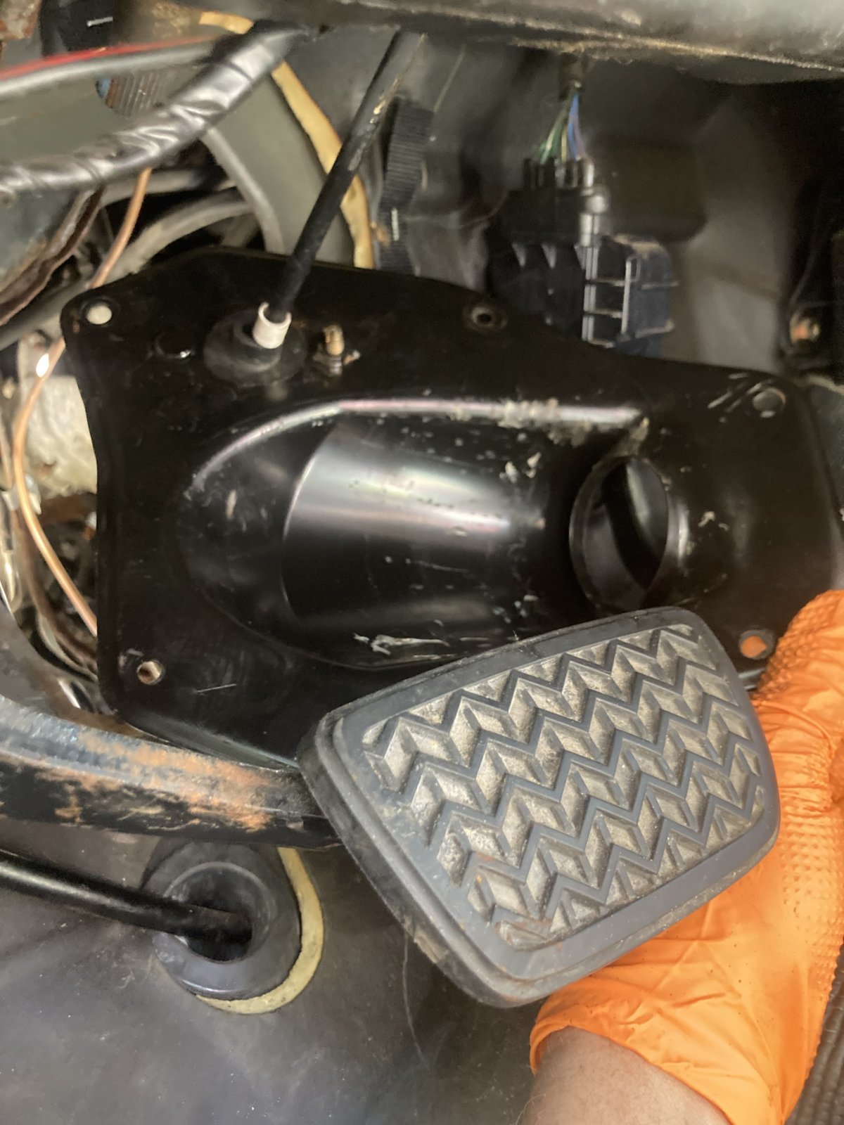

    Is this your O2 sensor harness? If so, holy hell, how'd it get that mangled, and is the sensor actually reading correctly?
  8. Apr 13, 2024 at 2:56 PM
    Arringtonpalmer
    Oct 3, 2020
    #53095
    120
    Sam
    New Hampshire
    @Jack McCarthy I have had a pry bar in there to no avail.
    @shifty` Yeah, its the O2 sensor. Either it’s a mouse chew, or I melted it out with sparks from the grinder. Either way ill take care of it when putting this all back together.

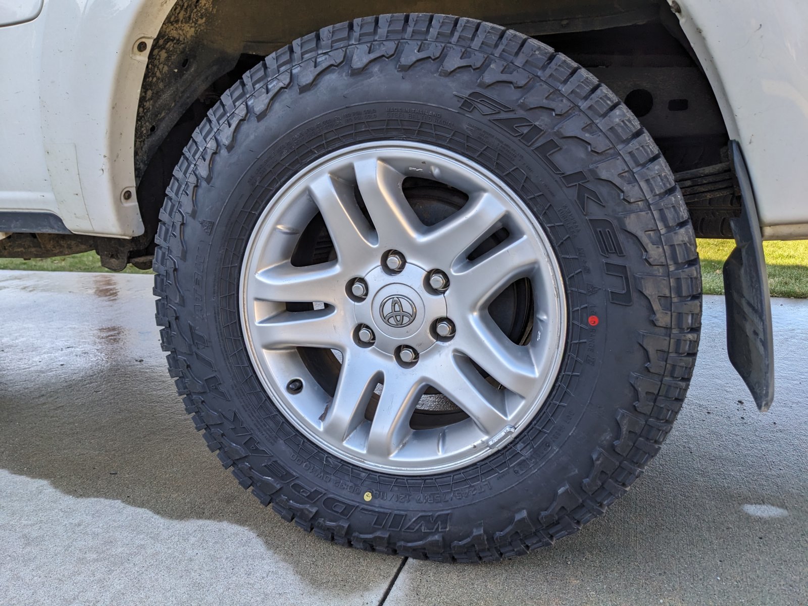

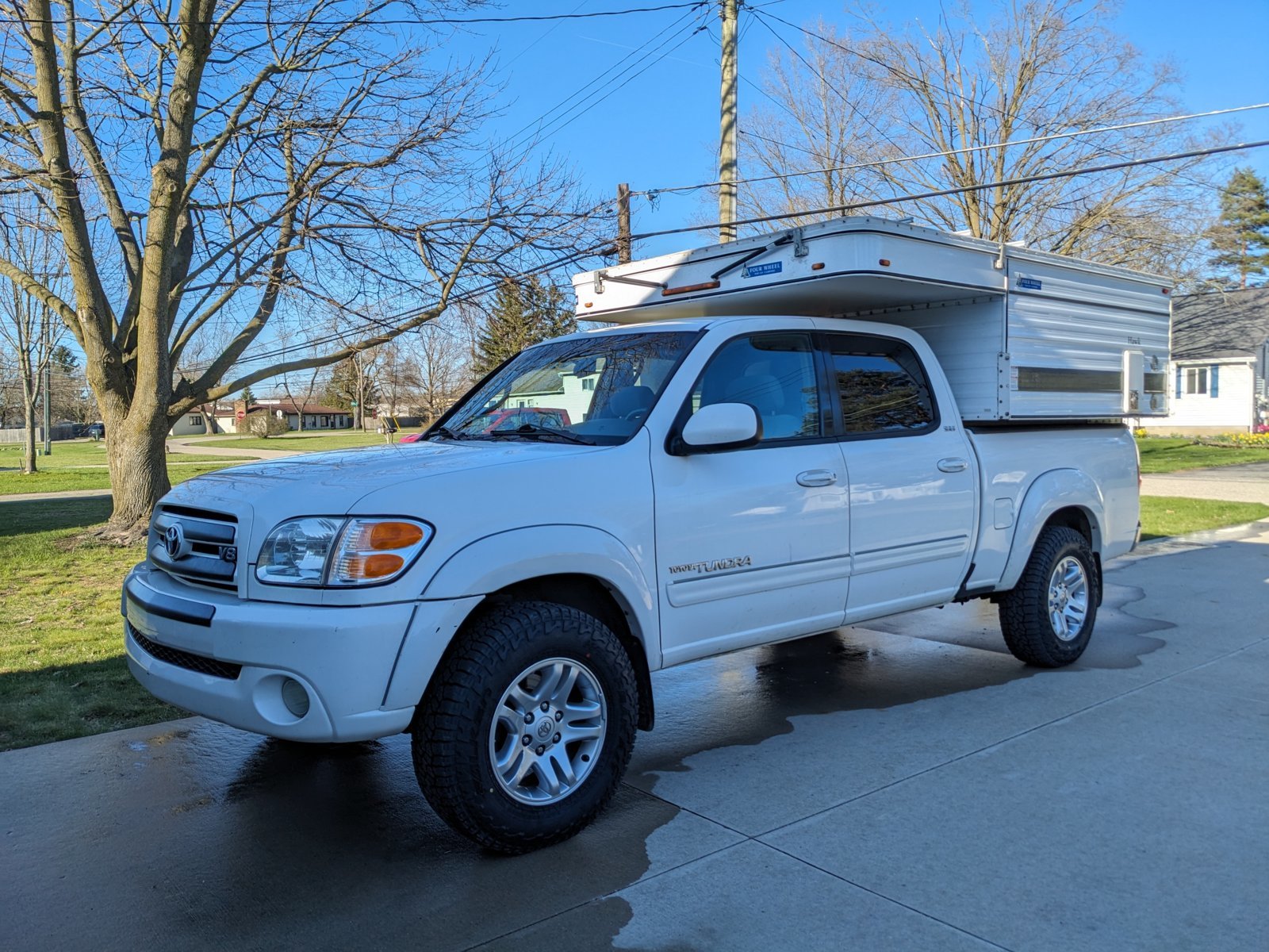

  9. Apr 13, 2024 at 3:32 PM
    phudz
    phudz
    Aug 1, 2023
    #101354
    39
    Michigan
    2004 DC V8 4WD
    Well, I think winter is finally over for us. Steelies with the Blizzaks are now in the shed, and I got a brand new set of LT245/75R17 Wildpeak AT3Ws mounted on the factory wheels today (also swapped out the original spare from 2004 for one of the take-offs). First impressions after a ~3 mile test drive up to 70mph, they're so much quieter than I expected!
    PXL_20240413_220600483.jpg PXL_20240413_220706334.jpg PXL_20240413_220714333.jpg
    fk bud, oscardog86, Voss and 5 others like this.

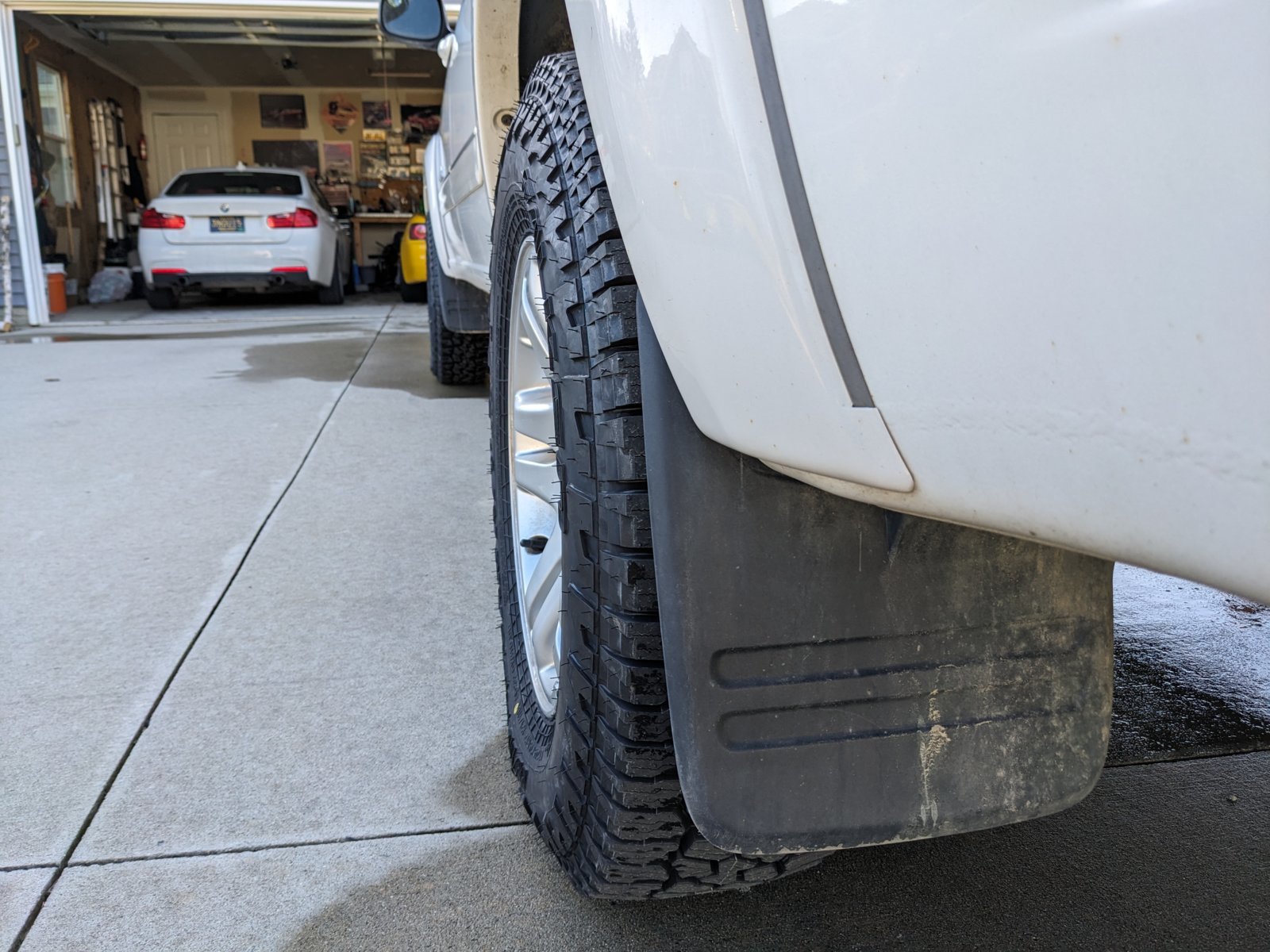

  11. Apr 13, 2024 at 3:46 PM
    phudz
    phudz
    Aug 1, 2023
    #101354
    39
    Michigan
    2004 DC V8 4WD
    Here you go.
    fk bud, oscardog86, bmf4069 and 4 others like this.
  12. Apr 13, 2024 at 3:47 PM
    dirtnsmores
    dirtnsmores New Member
    Sep 30, 2021
    #68770
    420
    Southern CA
    2006 DC 4WD TRD OFFROAD
    Bilstein 6112/5100s, JBA UCAs
    Not too bad. I've been enjoying my 255/80s. 245 might be even better for fuel saving and acceleration

  13. Apr 13, 2024 at 4:25 PM
    shifty`
    shifty` Just like witches at black masses
    Jun 20, 2020
    #48239
    28,382
    ATL
    '06 AC Limited V8/4WD
    Man, that lower balljoint looks so anemically skinny. Is that OEM?
  14. Apr 13, 2024 at 4:37 PM
    phudz
    phudz
    Aug 1, 2023
    #101354
    39
    Michigan
    2004 DC V8 4WD
    As far as I know, yes. The truck had 80k miles when I purchased it, and the history report didn't show that any suspension work had been performed during its life. It currently has 93k miles, and I have a new OEM ball joint kit (the recall p/n) and new bolts ready to go in once I get around to installing the Bilstein shocks in the next few weeks.
    I am running Spidertrax spacers, so the ball joints are more exposed than normal. Might be why they look odd?

  17. Apr 13, 2024 at 9:56 PM
    Pnwtundy
    Pnwtundy New Member
    Sep 17, 2023
    #104046
    101
    04 DC SR5 TRD, V8/4WD + LSD/Tow
    The company is called Truck Covers USA, never heard of them until i picked this up. apparently they're out of San Diego.
    Boy, I guess if it were me i'd try as hard as i could to not do option B.
    Maybe unbolt it from the other end, where it attaches to the steering wheel in the cab? This video seems to explain it well
    https://www.youtube.com/watch?v=gYbqTla_i-0
    You can also see how your steering shaft seal is looking
    https://www.tundras.com/threads/diy-steering-shaft-seal.48664/

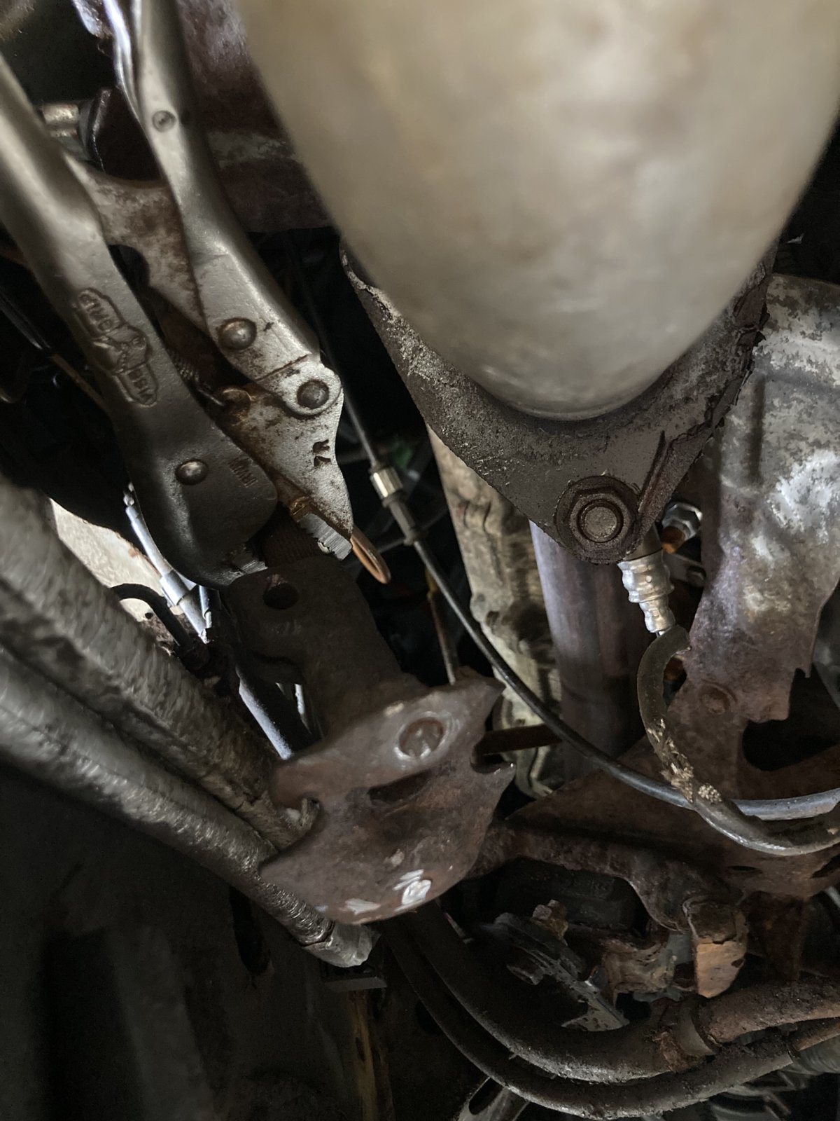

  19. Apr 14, 2024 at 9:03 AM
    FrenchToasty
    Sep 15, 2019
    #36156
    18,354
    Mo
    The SoAz….. big surprise
    Bone stock
    After last weekend in the wash, my brakes felt spongy and not grabbing in the rear. So today I got probably ten clicks on each sides star wheel, adjusted my lspv up some more. Parking brake engagement is way sooner on the pedal and a quick spin around the estates proved to be much better
  20. Apr 14, 2024 at 9:43 AM
    Arringtonpalmer
    Oct 3, 2020
    #53095
    120
    Sam
    New Hampshire
    @shifty` I have a steering shaft seal on hand, I sealed up the old on from the inside before, it was almost non-existent. I’ve read a lot more here than I’ve posted……
    @Pnwtundy I did remove that coupler and got the whole thing out from the top, had to pull the whole panel that the steering/transmission cable goes through though.
    It’s all out now and can go back together once the new coupler arrives. Also got some wire wheeling, rust reforming, painting done under there. New OEM LBJs, outer tie rod ends, rack, coupler, and steering shaft seal. Glad I didn’t have to weld studs on and this is going to come out clean!

  28. Apr 15, 2024 at 8:39 AM
    dirtnsmores
    Sep 30, 2021
    #68770
    420
    Southern CA
    So ten clicks is too much? What's ideal? I just counted 8 clicks and mine feels spongy after installing the RAS
  29. Apr 15, 2024 at 8:43 AM
    KNABORES
    KNABORES Sarcasm incoming
    Jan 1, 2020
    #40572
    13,758
    Arkansas
    rotate the starwheel until the tire turns with the slightest sound of brake shoe drag on each side.
  30. Apr 15, 2024 at 9:02 AM
    FirstGenVol
    Dec 13, 2018
    #22934
    14,151
    East TN
    2002 AC TRD 4x4 V8
    In theory, you should not have to manually adjust the star wheel. They are supposed to self-adjust when you use the parking brake. In reality, that doesn't always work.
