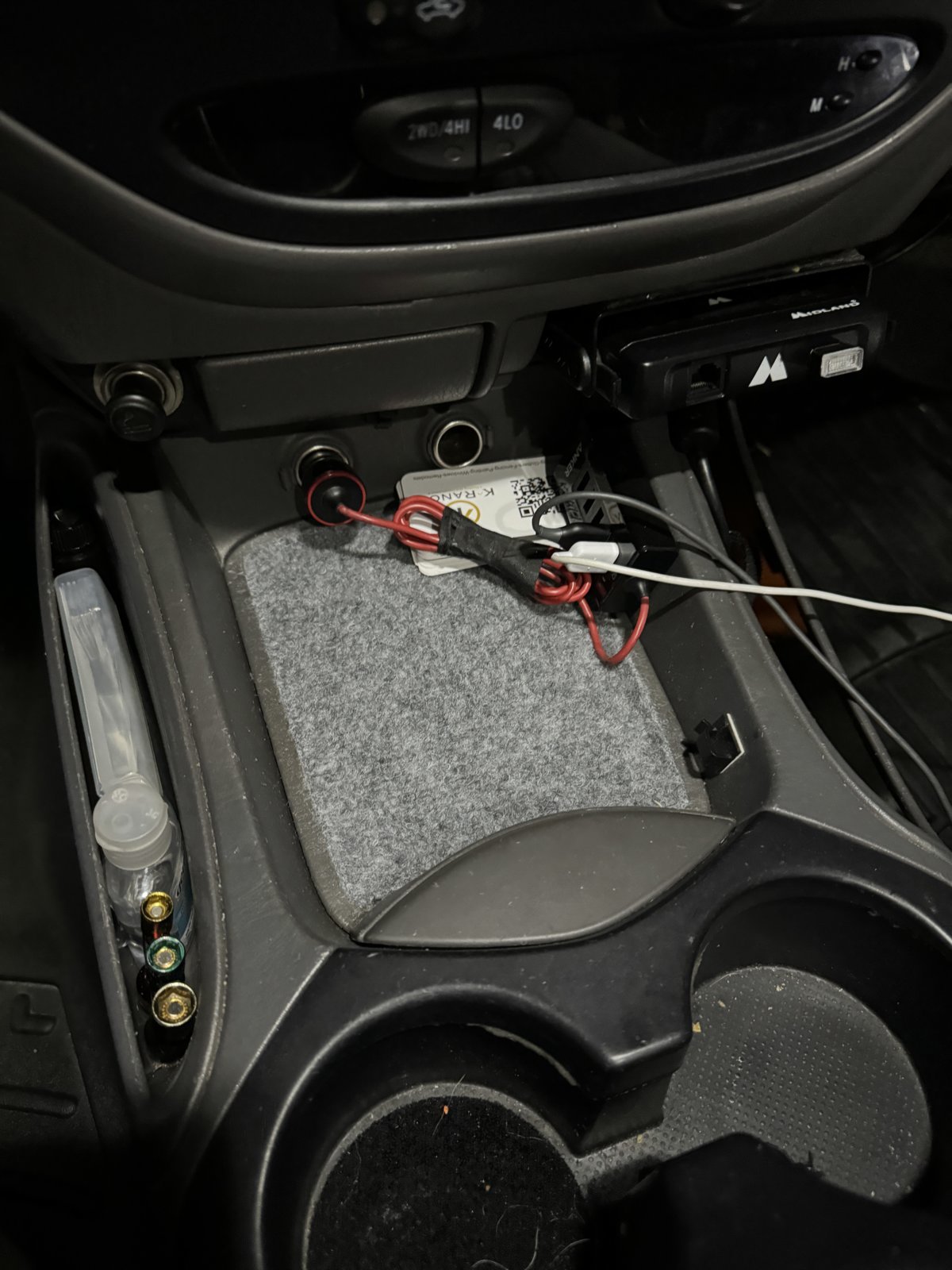

    Got tired of stuff rattling and didn’t want to scratch up my sunglasses every time I threw them here. Quick sand and glued some leftover carpet down to the console tray.

    Nice, how did you do the nice looking edging on that piece?

    I just ran an exacto knife parallel to the lip on the edges. Took my time and cut it out little by little.

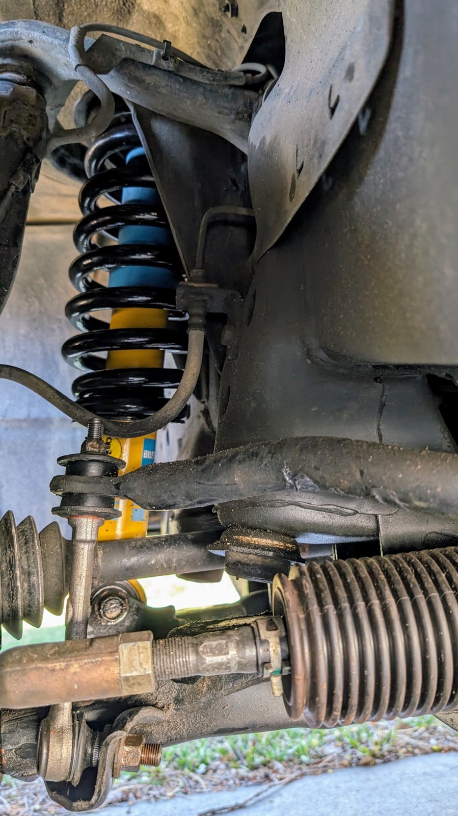

    Installed Bilstein 4600 shocks, 555 swaybar links, Daystar swaybar bushings and a 1/4" thick spacer (oh the horror!). The 4600's came preloaded from suspensionlifts.com. Before you chastise me for not using the fellow at first gen off road, I tried... I inquired with him about the setup I wanted, but I never heard back.
    *side note, 1 month in and the moog steering bellow is still okay :rofl:

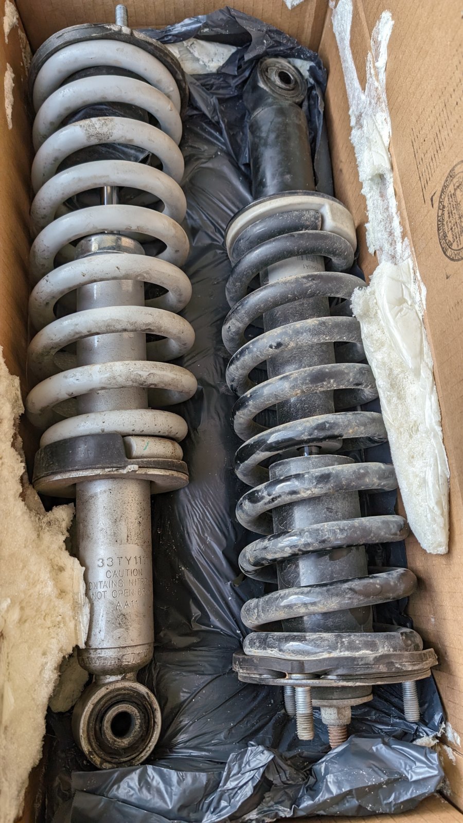

    The shock assemblies I removed from the truck were a mismatched set. The silver shock is a Duralast from Autozone and the black shock is a Master Pro from O'Reilly. I think the Duralast assembly was recently installed since the fasteners were still shiny, but the lower bushing was already sagging. The Master Pro looked to be a couple of years old and the lower bushing had torn. Luckily both of the lower shock bolts were coated in anti seize.

    The front ride height went from (hub to fender) 19.125" driver and 19.25" passenger to 19.875" and 20". And ohhhhhh buddy, it rides so much nicer now. No more bouncing over dips and bumps in the road.
