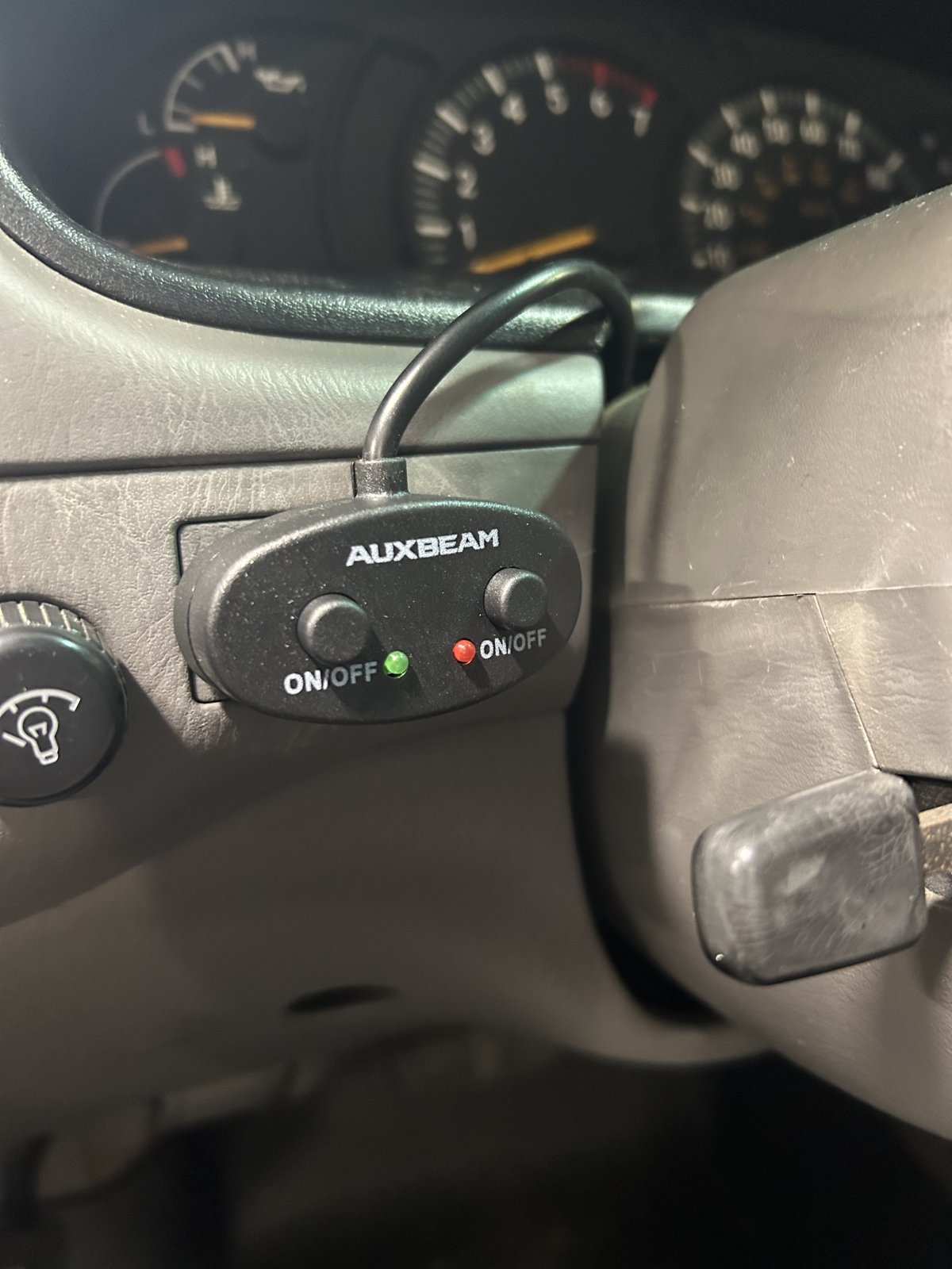

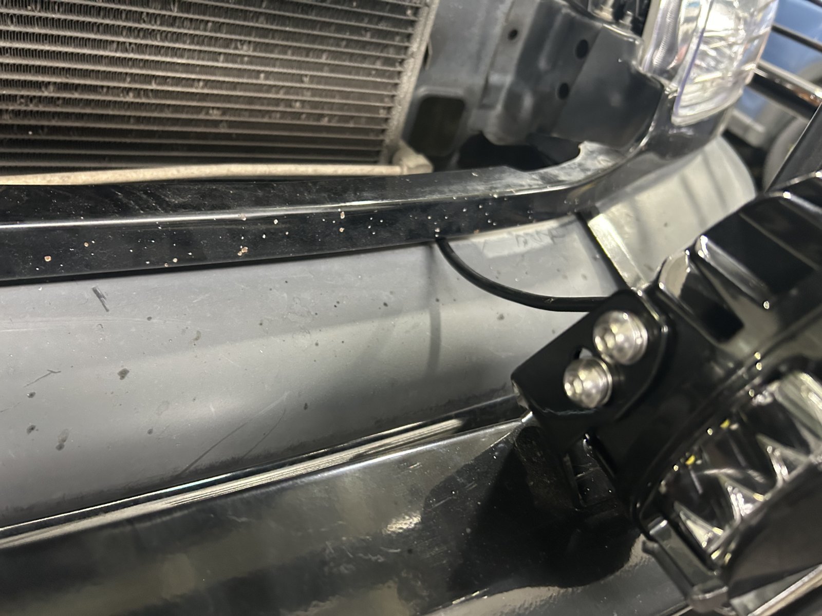

    Just to get this back on track, I wired up the Auxbeams. Took like 5 minutes.

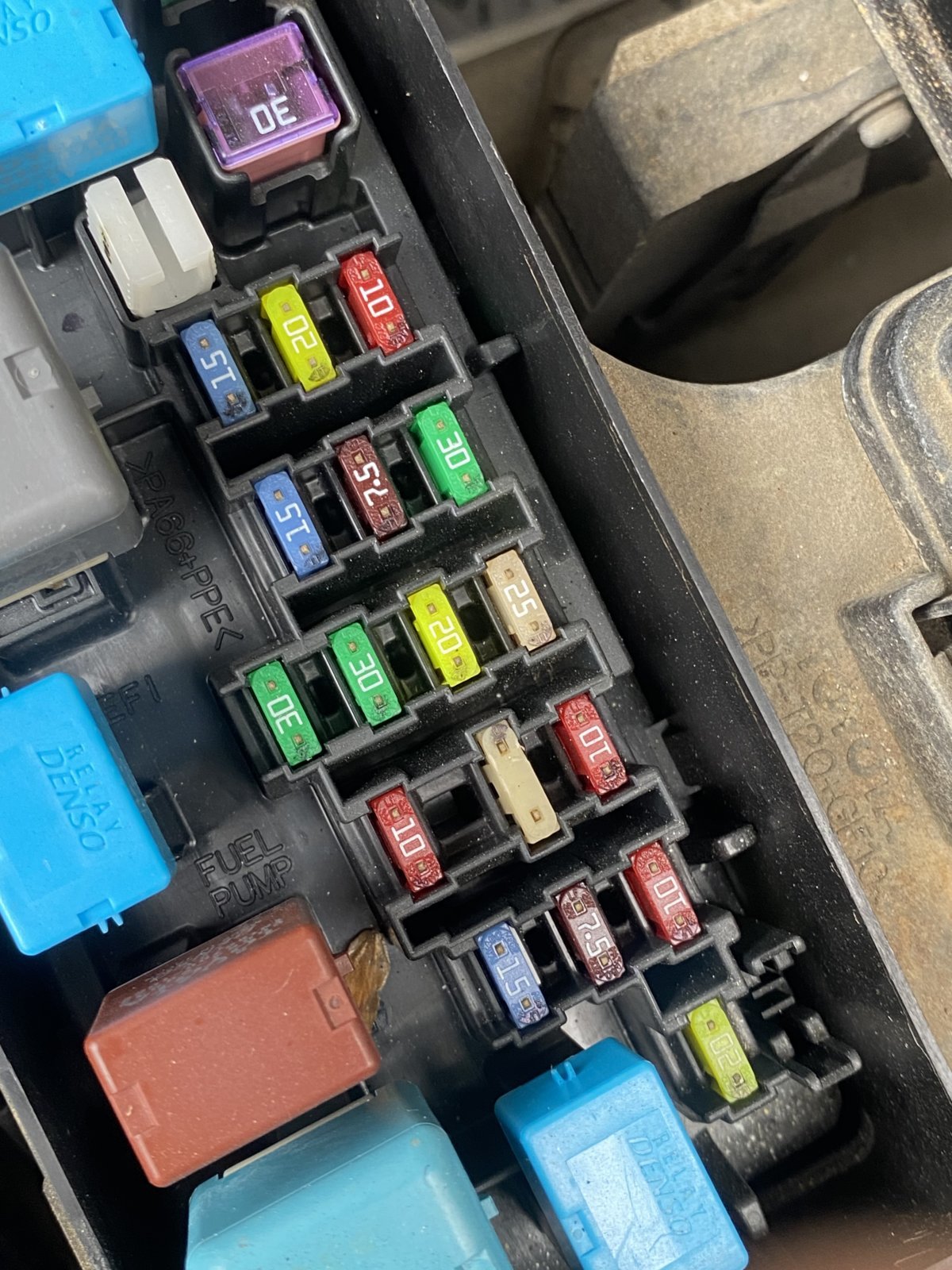

    Can someone help me figure out what fuse goes in this SHORT D.C.C spot in the fuse box under the hood.
    It looks bigger than a regular fuse, I have had a 20amp in there for a long time and just realized that is the wrong fuse after my radio and power locks stopped working.
    Iv been reading its called a Short Pin but im trying to find a part number
    Called the dealer and they said nothing goes there

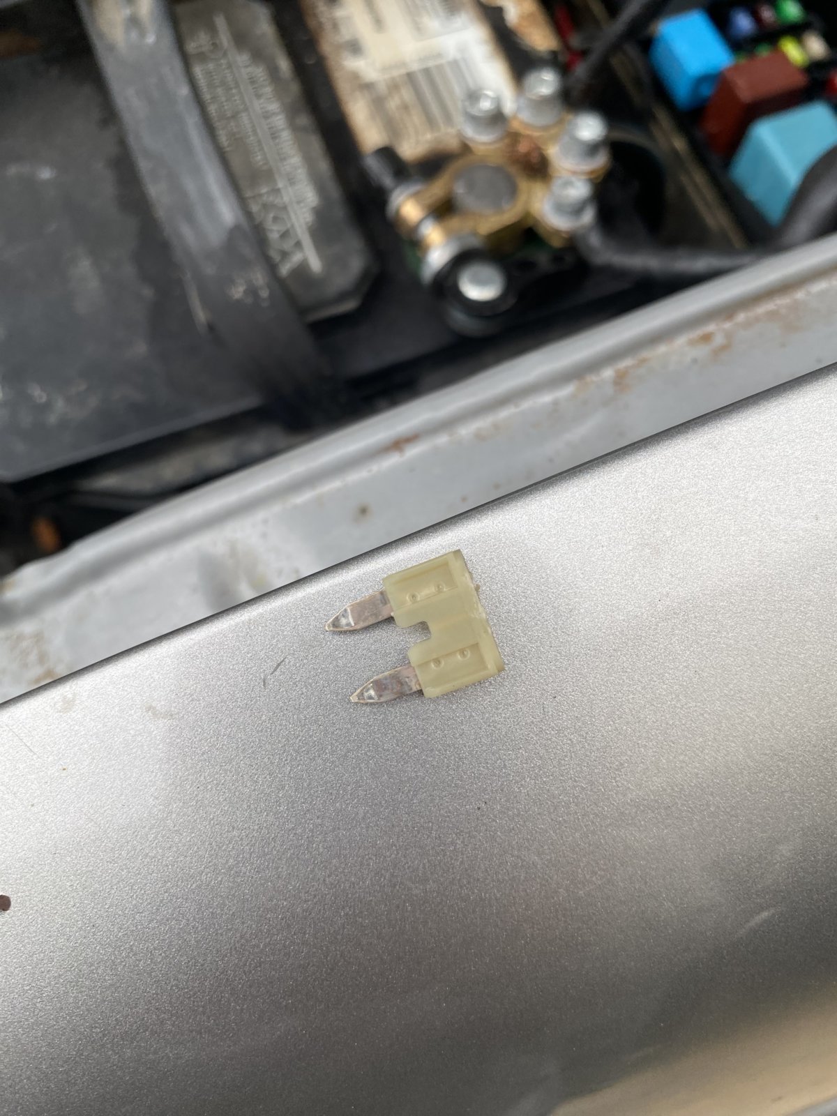

    Thank you for send this over, might have to just hit the junk yard. The dealer has been no help, even a tech said nothing goes there. Im telling them my radio and locks dont work if there is nothing in there
    I have had a 20amp half way in and out in that slot since forever and have started to get shortages

    Based on color it should be a 25?
    Just removed it (again) to see if my truck did annything and my radio turned off.

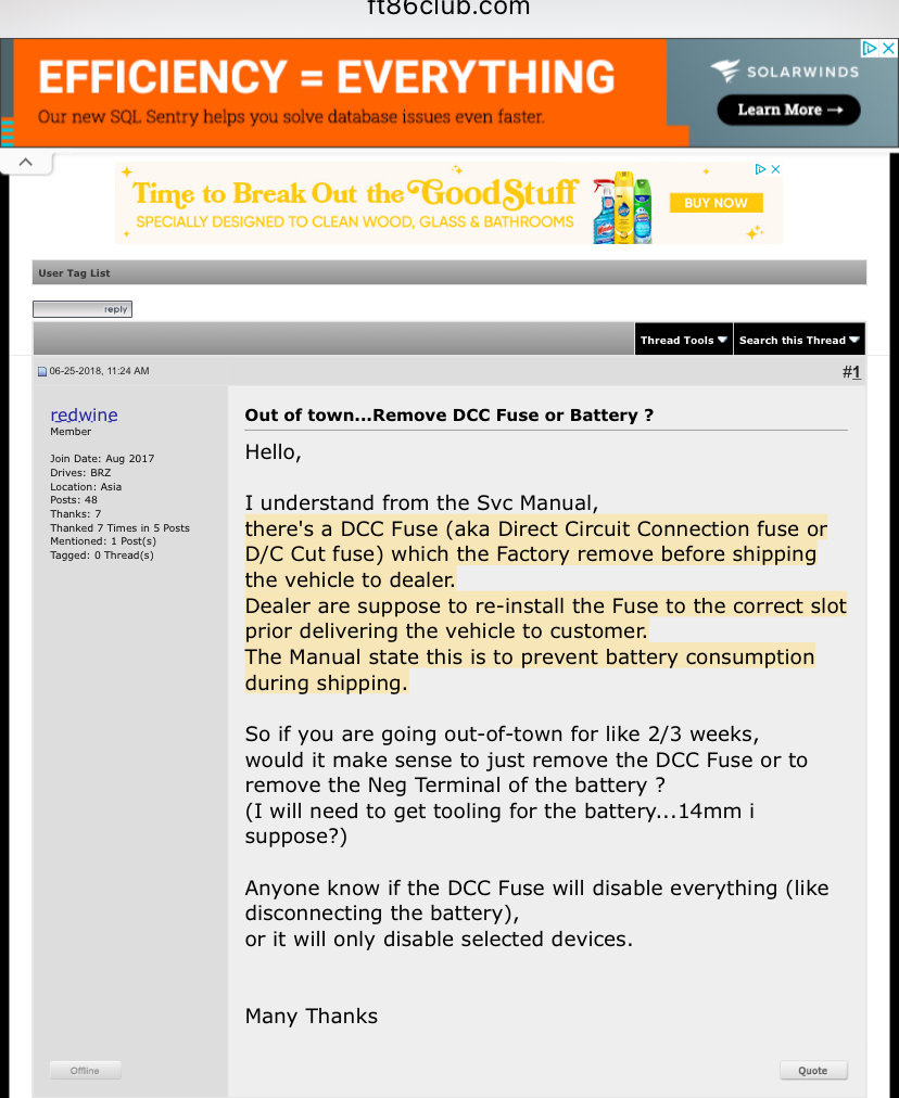

    It's for a 86 but the concept still applies I believe, Basically that fuse is to be removed in order to stop parasitic draw during shipping and is supposed to be reinstalled by the stealership. That tech you spoke to is a retard (and please tell him I said that)
    it's also called a "short pin" and is not an actual fuse

    Yeah, it controls the radio and power locks I have found. I have also found the part number after contacting Carson Toyota, I feel like me and the part guy have been talking way to much lately hahhaha
    for the 2006 tundra Short D.C.C fuse 82824-20140.
