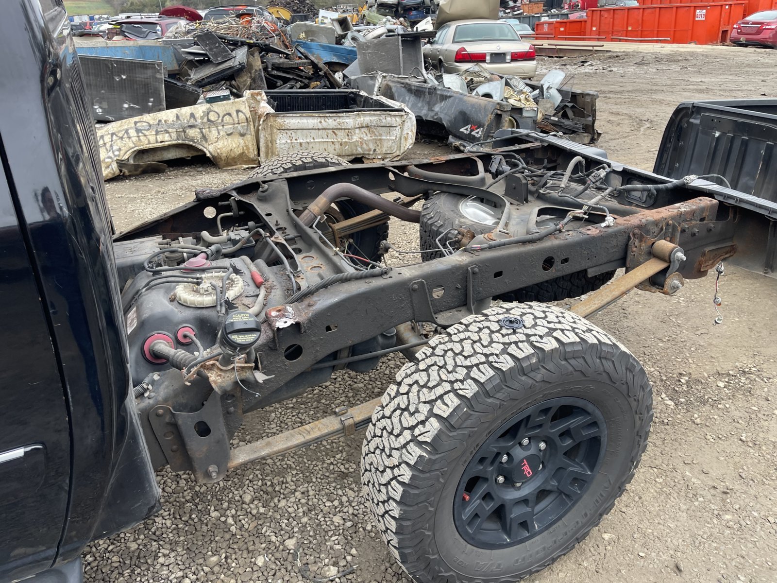

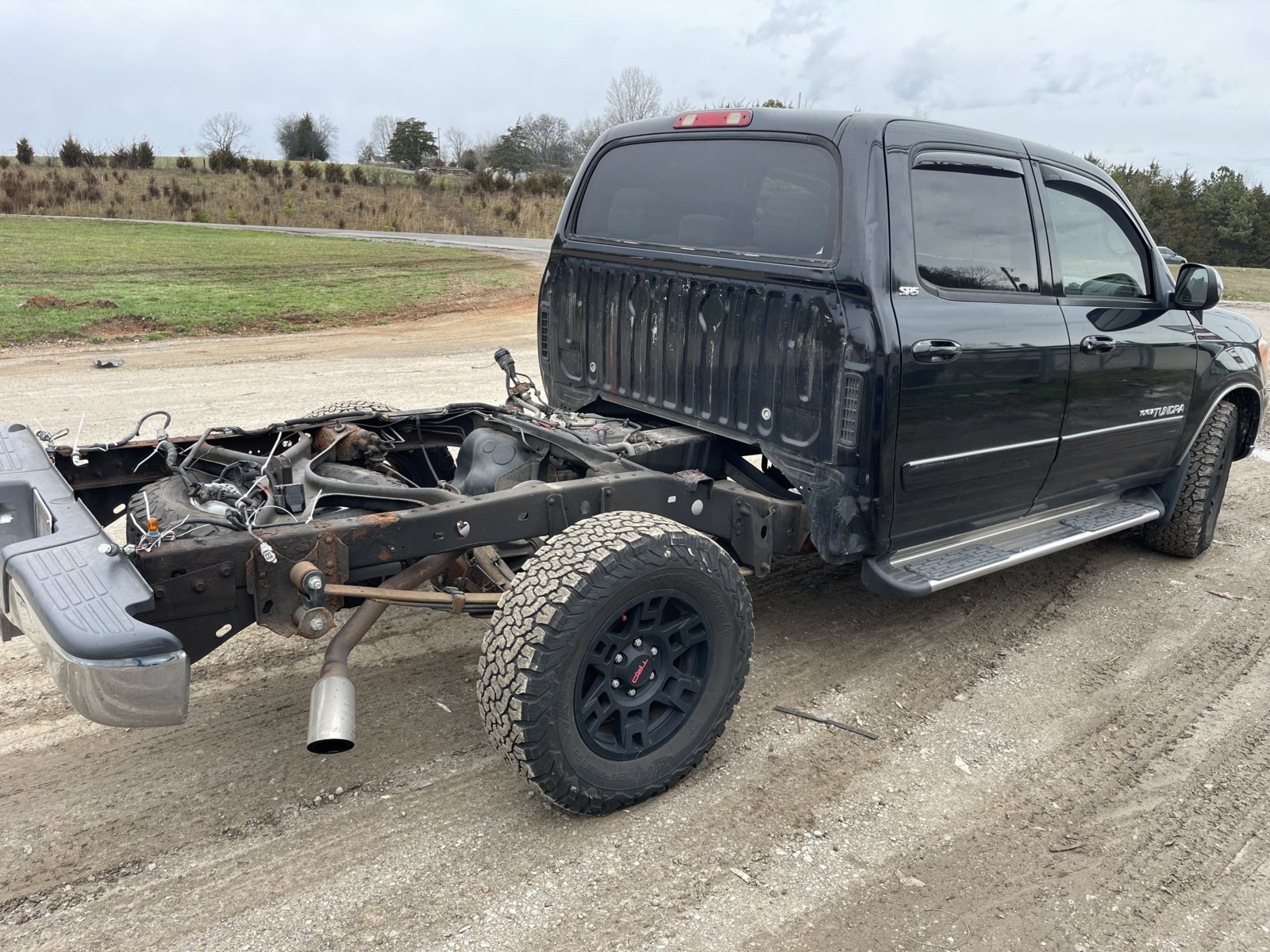

    Can we drive 33 miles without police intervention during the Friday morning commute, all highway, through downtown Knoxville?

    gonna zip tie the taillights to the bumper?

    Pick up a sheet of 3/4” 4x8 MDF for your new flatbed there @jpink.

    Most states require fenders of some kind cover the tires. Think you'll be fine for a short drive. Gonna wire wheel and treat all the barnacled areas first, right? Love the team ramrod bed in the background at the JY.

    Yeah, gonna clean it up as best I can did a quick blast with the pressure washer down the street. Had to get to work but gonna go spend some more time there tonight.
    Not sure why they felt the need to drill a 2nd hole and weld but as @FirstGenVol keeps saying, if this truck could talk.
    After the quick run at it with the pressure washer. Will go back for more attention later.

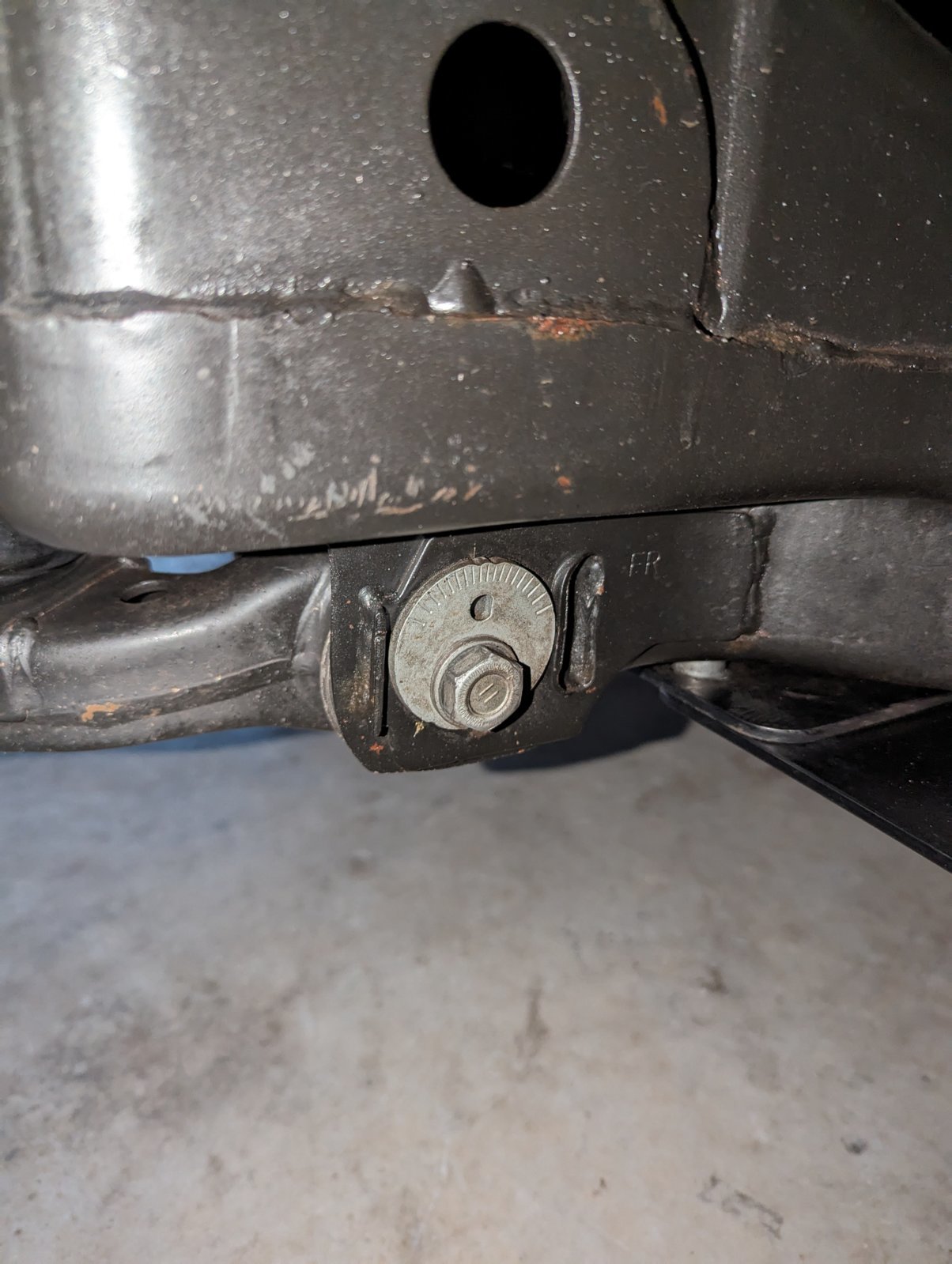

    So I tried a different alignment shop today. All they do is suspension and brake work. On the phone, the owner knew that our trucks do well with caster around 3.
    Instead of using the Hunter machine they went old school and did it manually. The truck drives straight but the wheel is slightly crooked which is frustrating. They had to completely reset the toe after I replaced the tie rods.
    This was the most expensive alignment I've ever paid for. $195. Literally double the price the 4x4 shop charges. I had high hopes but I'm not sure it was worth it. One positive thing is that I didn't rub at all. Went full lock to full lock and didn't touch the fender liners.

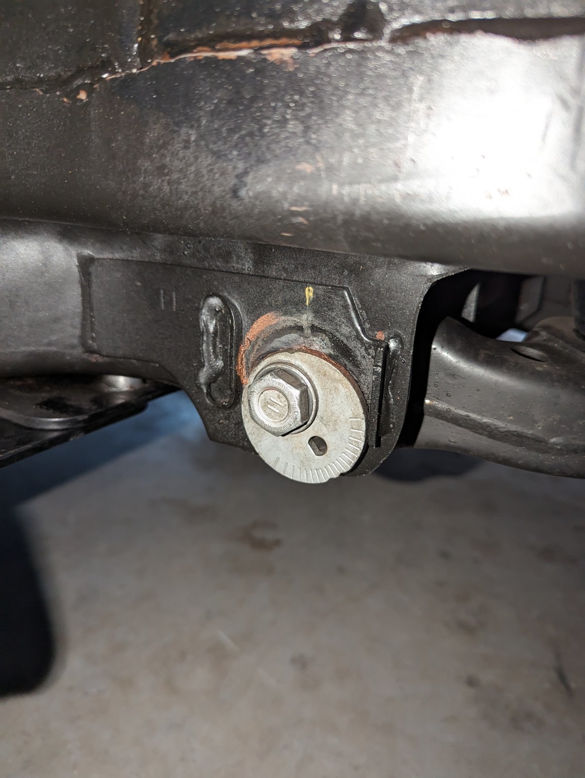

    I noticed this eccentric cam is is a completely different position than it was previously.
    Passenger side is not.
    bmf4069, Voss, BroHon and 2 others like this.

    Looks like you started with more camber on the driver's side and they had to adjust to zero it out. I would also take it back and make them fix the crooked steering wheel, not that hard.
