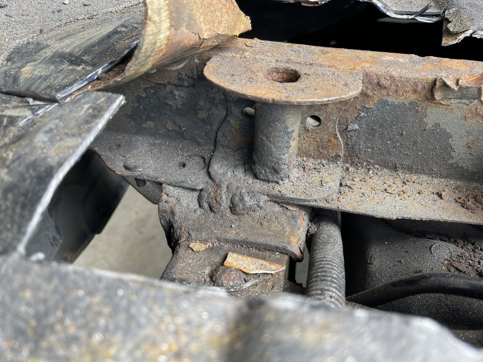

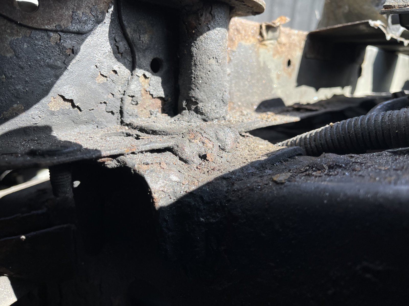

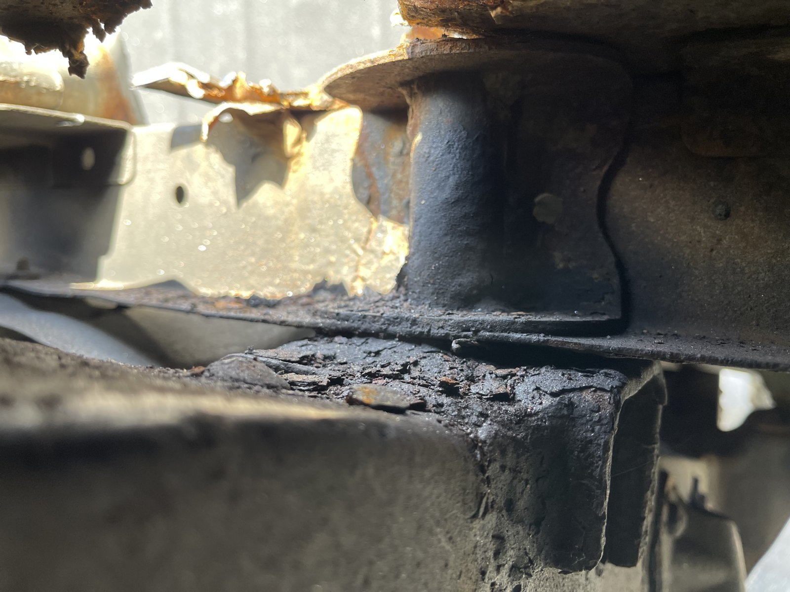

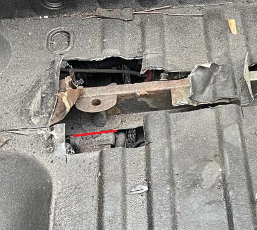

    Maybe torch the living shit out of it?
    Take a crowbar and hammer at this joint, after grinding out that blobby weld? It'll leave the framerail cap in-place, so you can work at removing that after, then clean up the frame, treat it, and re-spray.

    If I'm not mistaken though, I think this is where the bed support sits on top of the framerail, and where separation needs to happen.

    Ahh, ya'll are trying to disassemble the bed crossmember that's part of the bed. That's part of the bed, not the frame. Yeah, what @shifty` said. Stop tuna canning the bed and separate the bed crossmember from where it sits on the frame. And no torching please, that's right on top of the gas tank.....

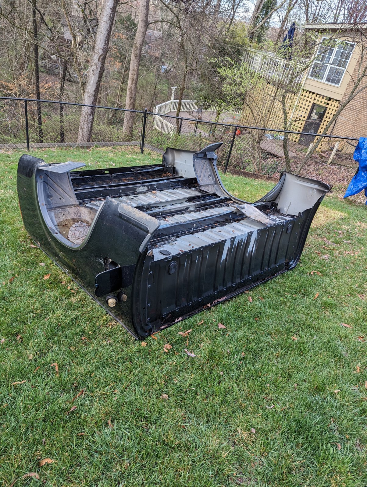

    Your bed is now one with my yard. Part of the ecosystem. There are worms living in the wheel wells.

    That's what I told him yesterday. He no listen. He's separating the bed from the bed.

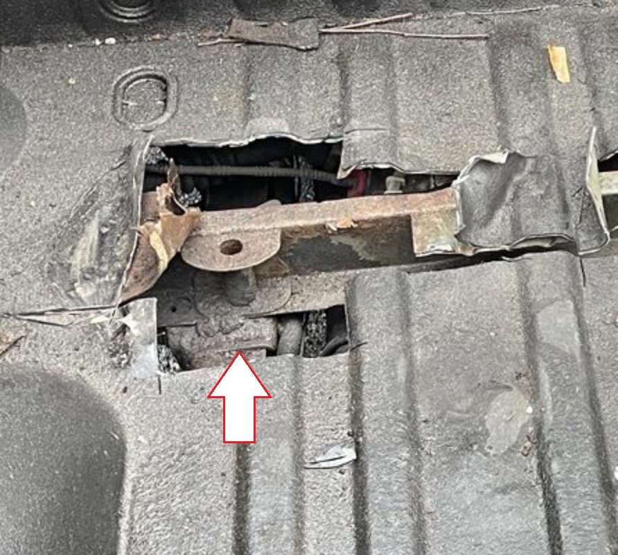

    As @shifty` pointed out, I think there's a weld weld there by the frame to bed bolt. I would check the rest of them as well. Cut the weld, then lift the bed. It's not rusted together so much that it won't come apart.

    I can't imagine they welded the frame to the bed. It's corrosion. The Toyota dealer also sprayed his frame as part of the recall and that shit is peeling off in layers. In think they got sloppy with application.

    Looks welded on driver side.
    But maybe not on passenger side?

    Was the bed bolt broken on the mount with the weld?

    Yes, on both sides it split in the middle coming out.

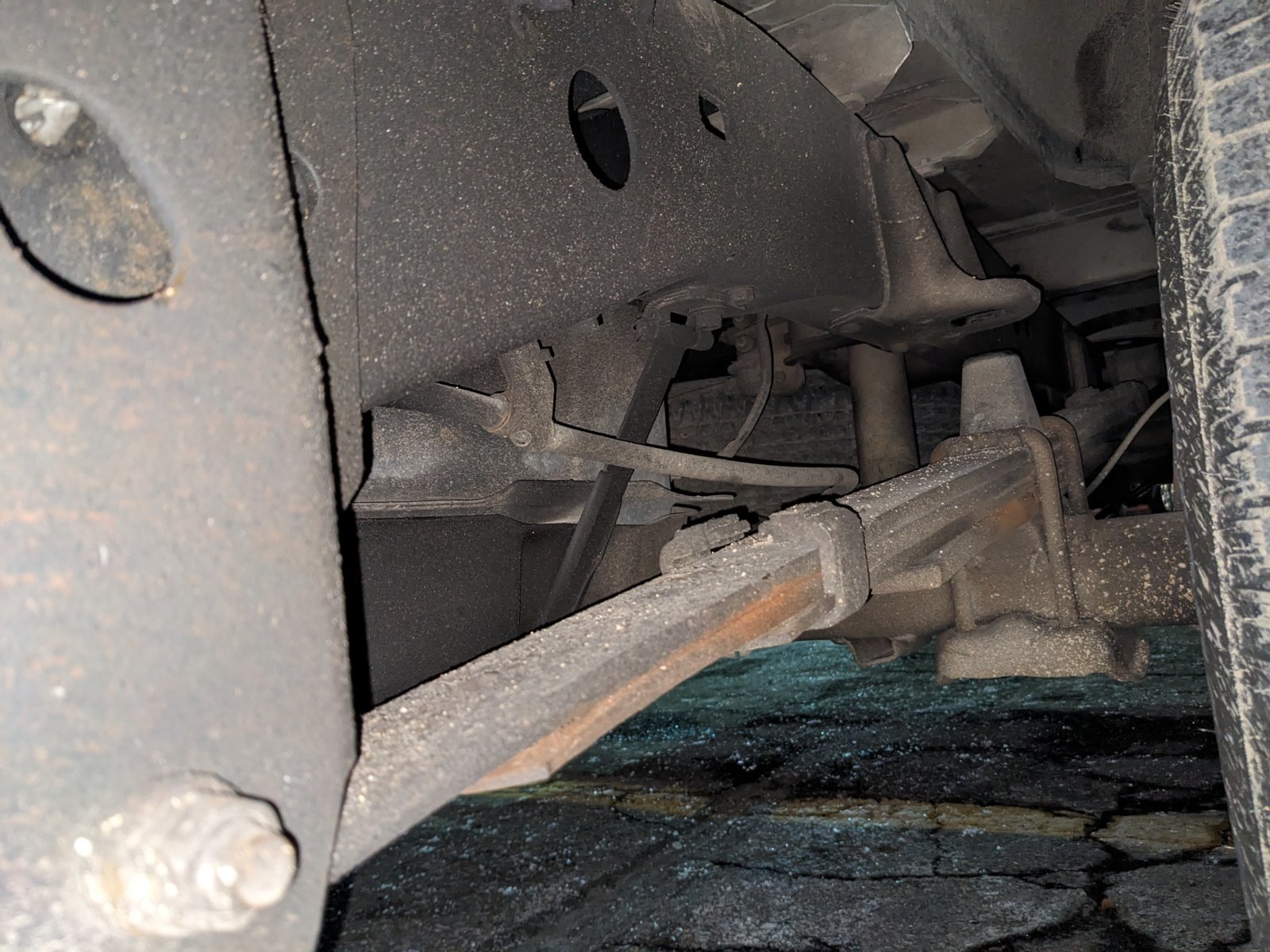

    The first picture looks like the main problem. Want to come by the house and we can attack it with a bottle jack and pry bar?

    I can throw some bolts back in the bed and head your way after work. I think we're gonna have to grind that weld first before we make any headway with the jack. When the yard tried to lift it, it pinched back towards the cab so it's on there strong.

    Yeah, that spot is clearly welded, and I think @KNABORES nailed the reason. Bed bolt snapped. The hack-around was to weld the bed support to the frame. And that's why it's such an ugly ass blob of a weld, they had to do some hand/arm gymnastics to get to that spot, and probably welded blind.

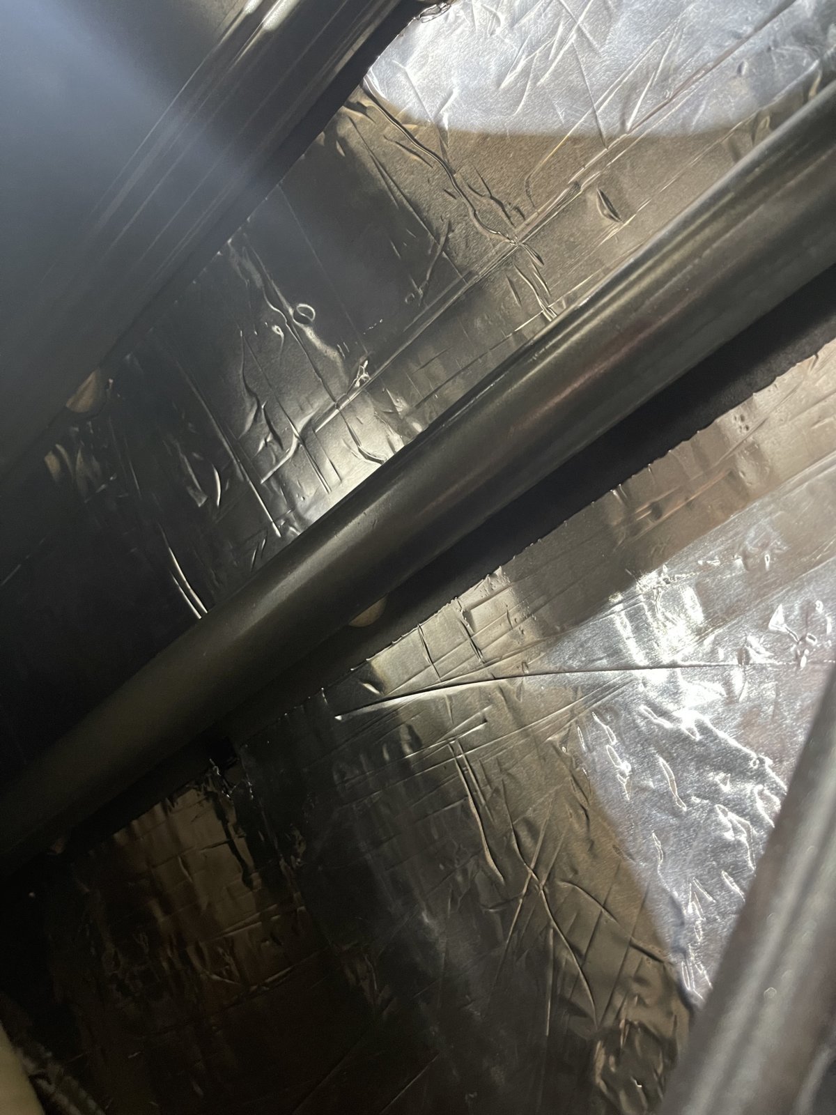

    Working on radio install/sound deadening. Nice when your daily is an 03 Camry and you can spend months on a project like this.
