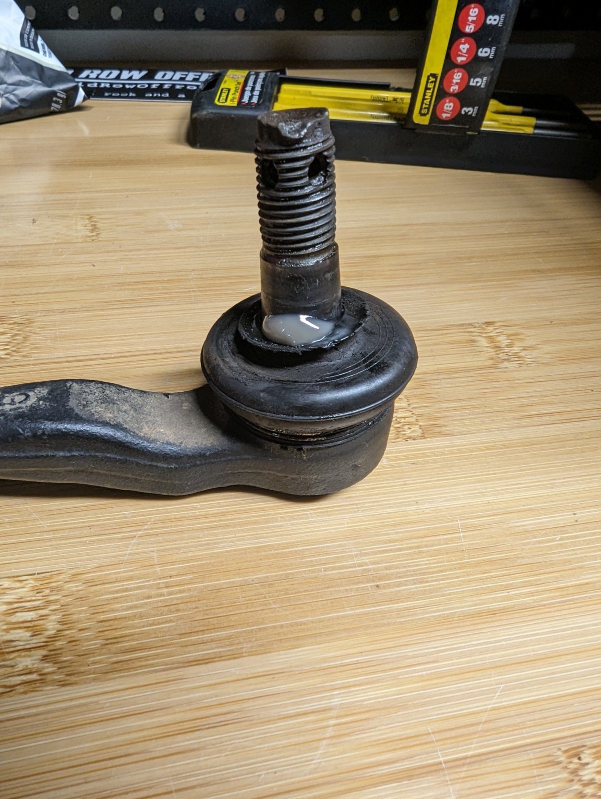

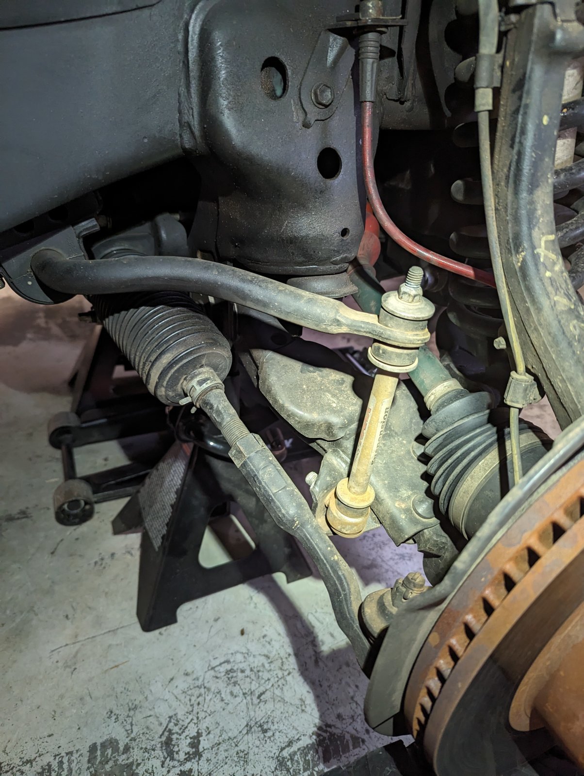

    How is this even questionable? The rubber bellow (or whatever you call it) is torn completely around it. Replace.

    You can also blue locktite the inner tie rod threads into the rack too.

    The mangler is back for his crown. I have new outers sitting in the garage waiting to replace mine which also have torn rubber.
    How hard was it to remove?

    Lol yes sir! You saved my ass with the pipe wrench suggestion. Made it very easy to remove the old ones.

    Wish I had read this 5 minutes before. Do you recall how tight the inners need to be?
    :oops:
    Too easy apparently. Really not sure that I mangled the boot. I'll take the blame for the tip but I'm not sure how the boot tore.

    Almost 200k miles. Nice job Toyota.

    Tight. I don't recall a torque spec, but if you have a big crowsfoot that fits it you can torque them.

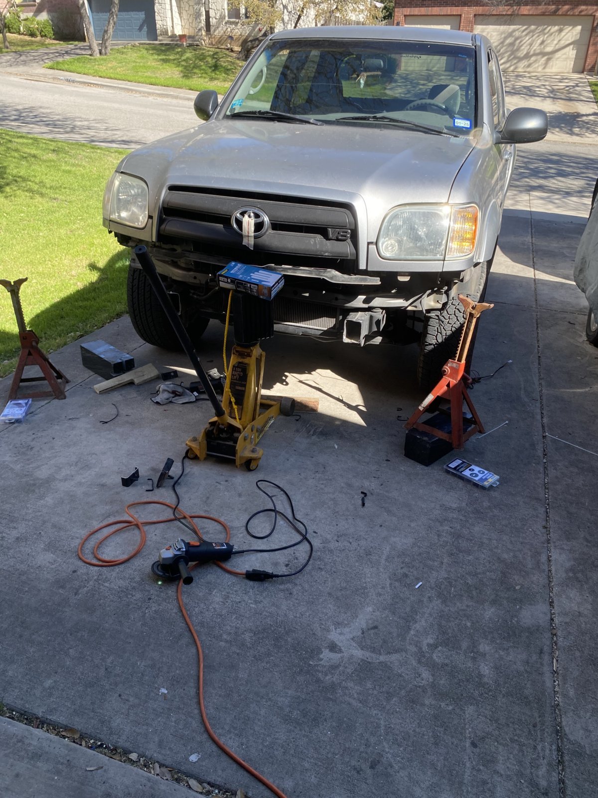

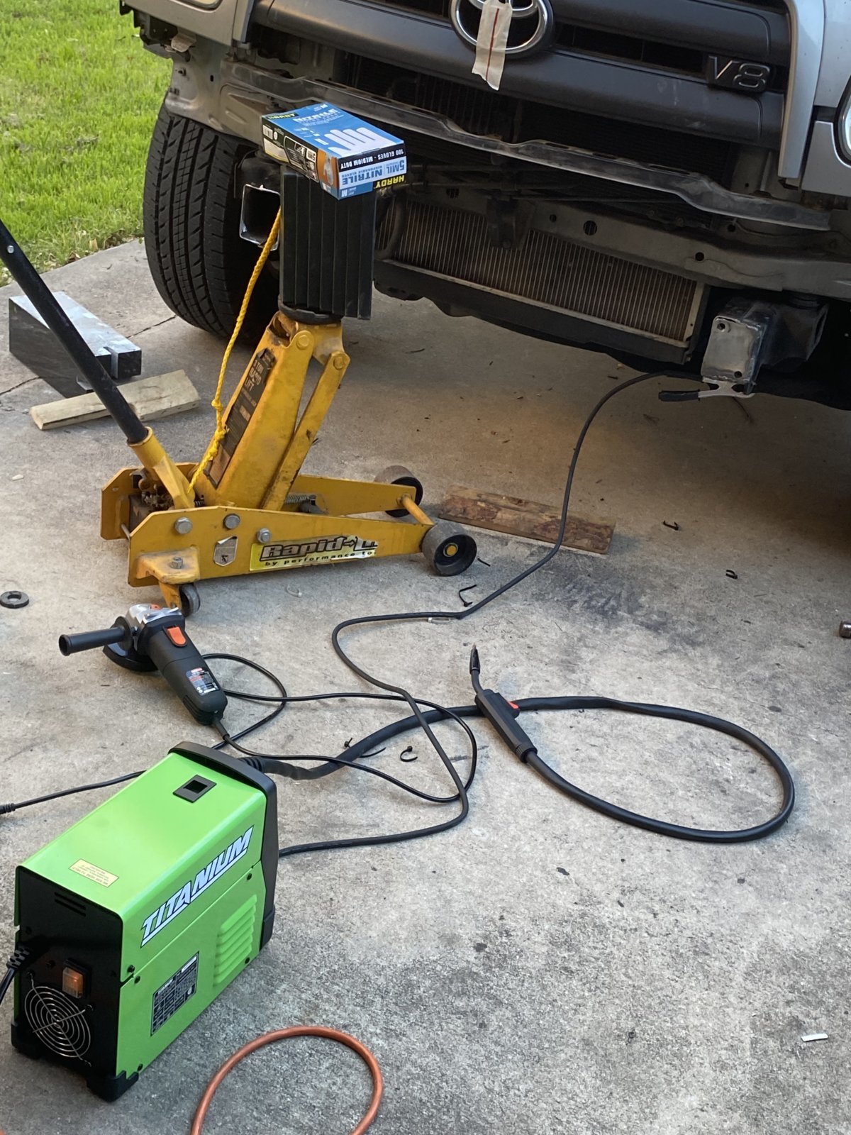

    Tan outta daylight but got the plates/nuts all finished up. Now I just gotta make some uprights to hold up the main bar. I’ll get more pics tomorrow. It’s dark. IMG_4320.jpg

    What is going on with the box of gloves on the chock on the jack?

    trying to get the main bar at the right height/ leveled out. I moved the bar while I cut and I welded.

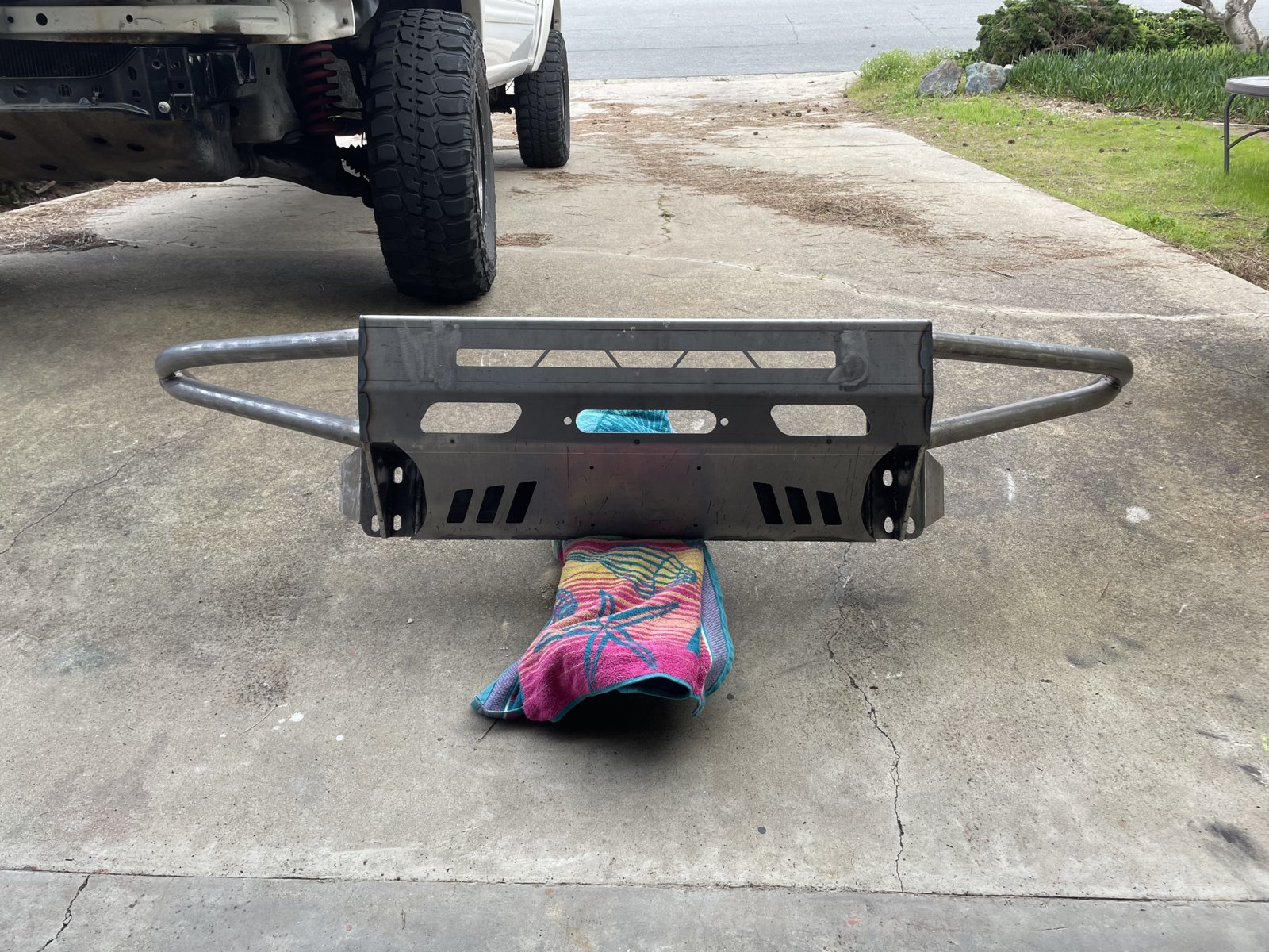

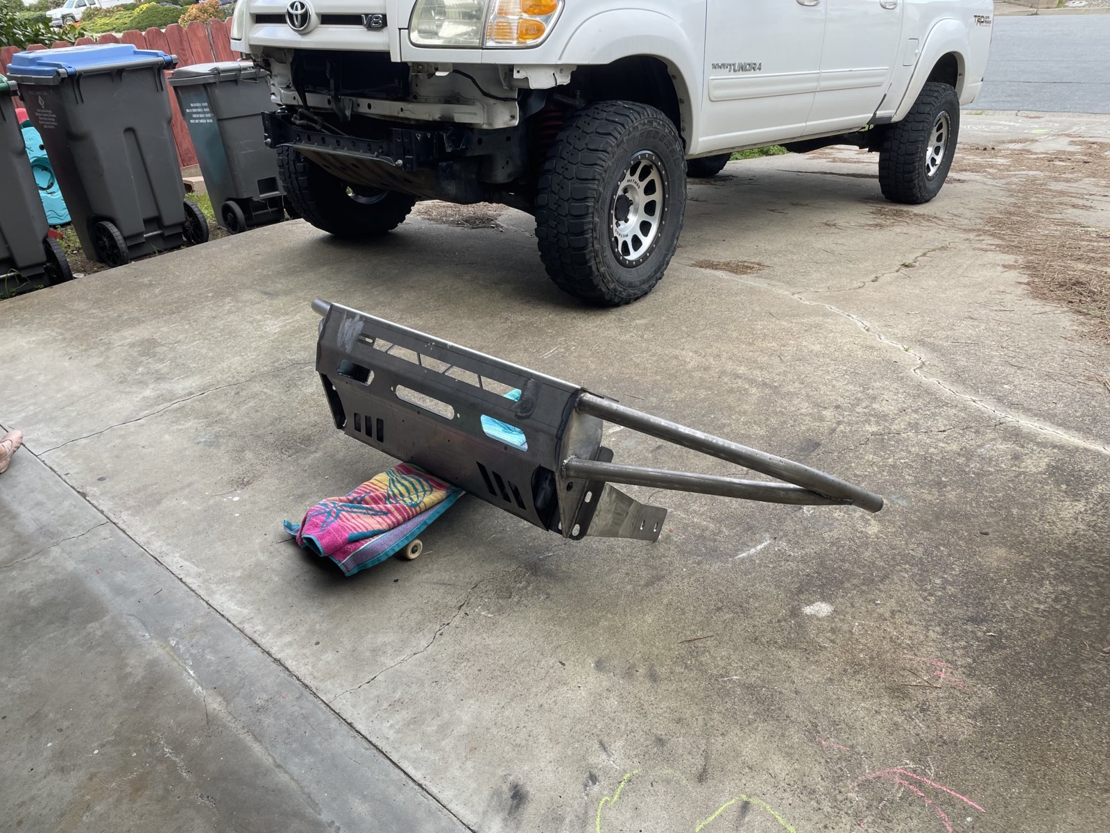

    Just a few more sections to weld, then grind and paint. Cant wait to get it on the truck

    2 bumpers on DC’s getting done this weekend??? Ayyyeeee
    yours looks way cooler than mine lol

    That is going to look amazing. What's your plan for paint?

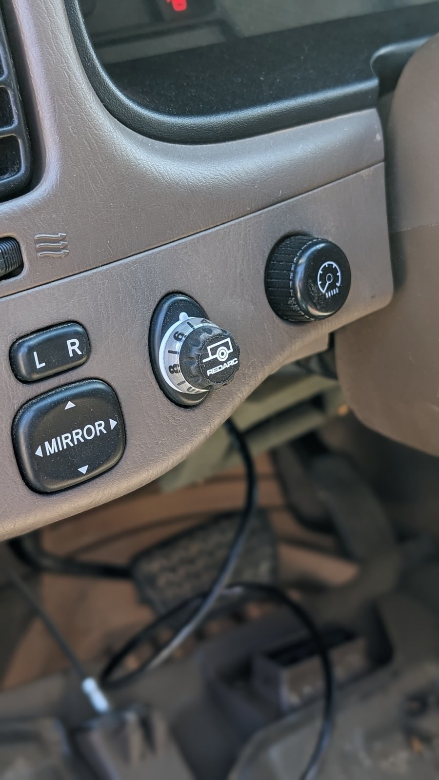

    Installed a Redarc brake controller today. The control knob required some significant grinding to fit into the narrow switch blank. Seriously, why didn't Toyota use their standard switch size in the First Gen?

    thanks! Just going to do some rustoleum spray paint- self etching primer then some matte black

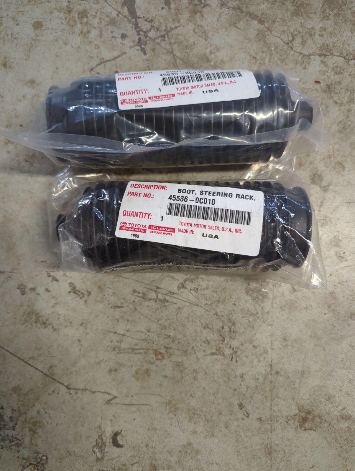

    Tip for anyone replacing your steering rack bellows. Make sure you know which part# goes with each side. They look very close and once you put the wrong one on, it takes some force to remove. I controlled my mangling tendencies this time.
    Also, a pipe wrench and jack handle make quick work of the inner tie rods.

    Ah yeah sure enough there's a crack that's hard to see at first. That settles it!
