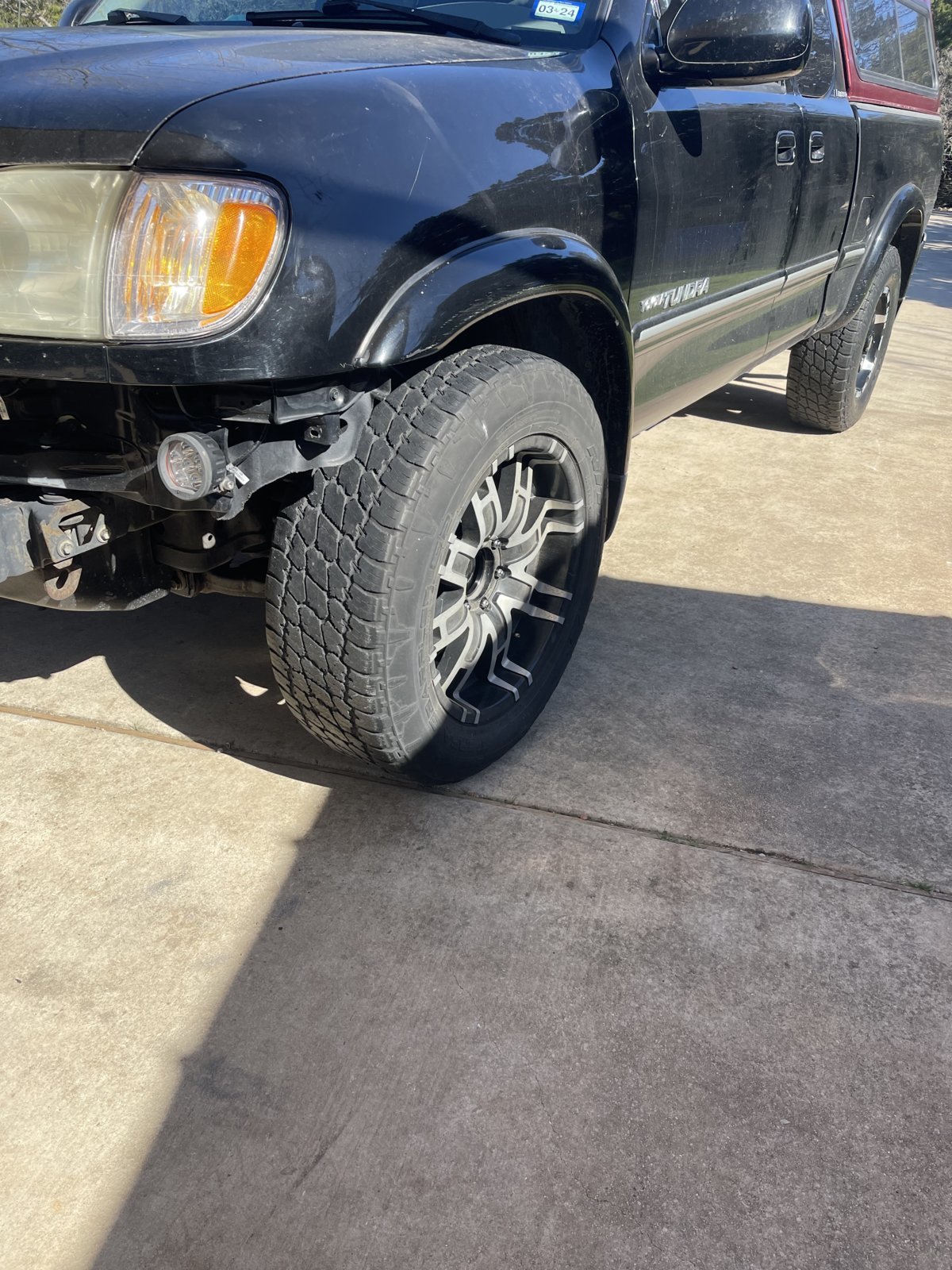

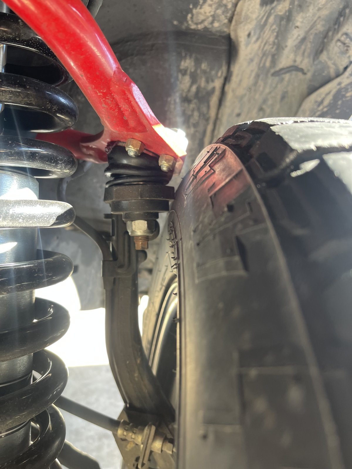

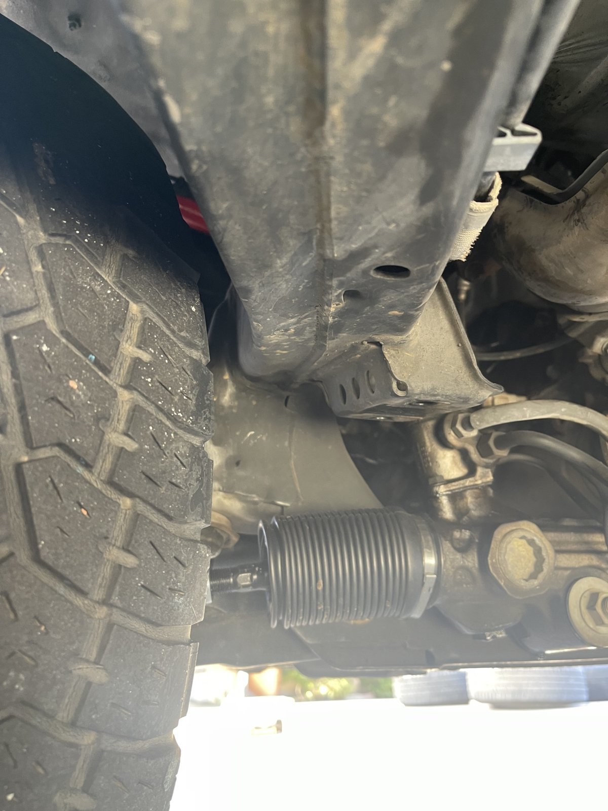

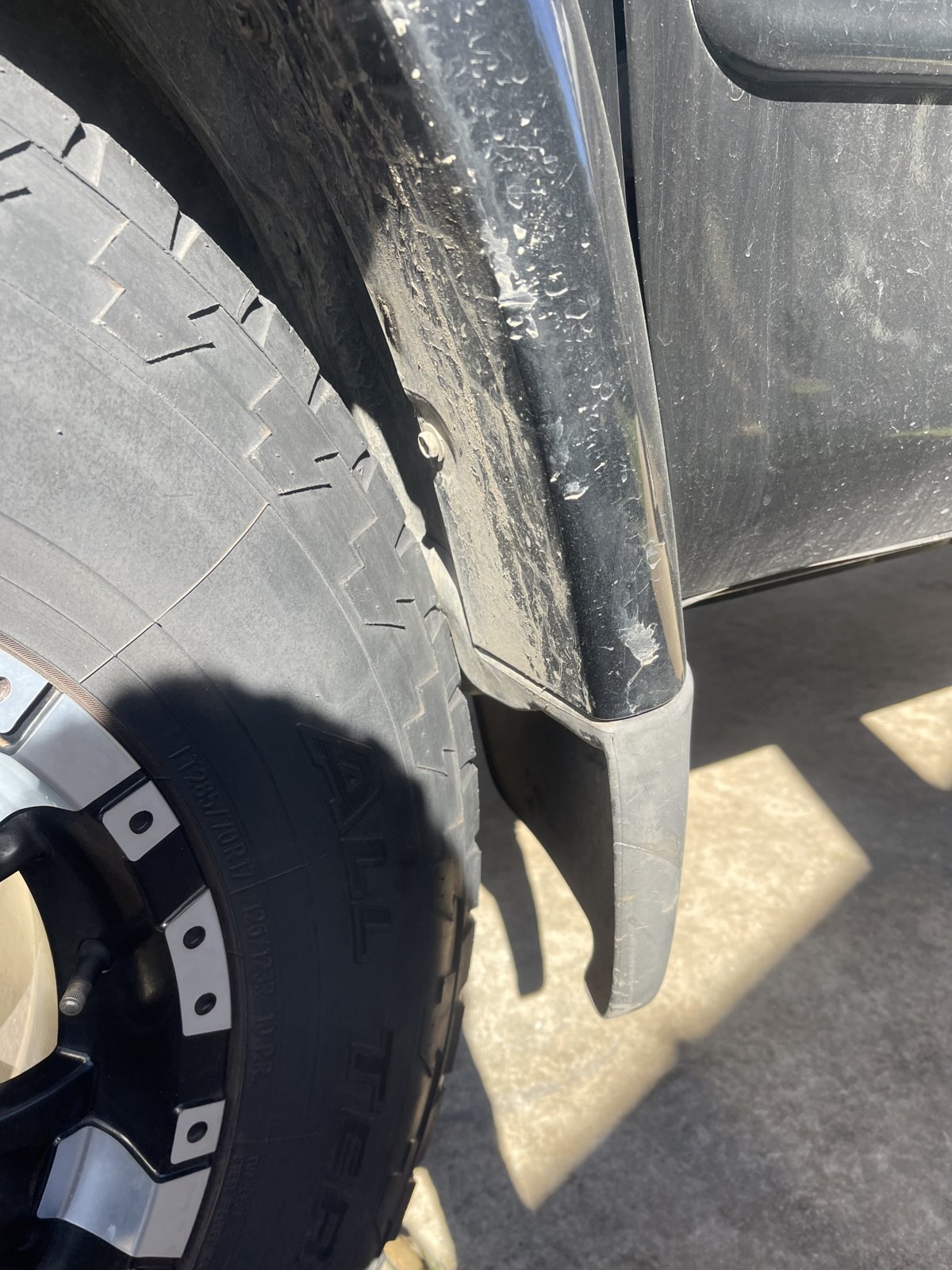

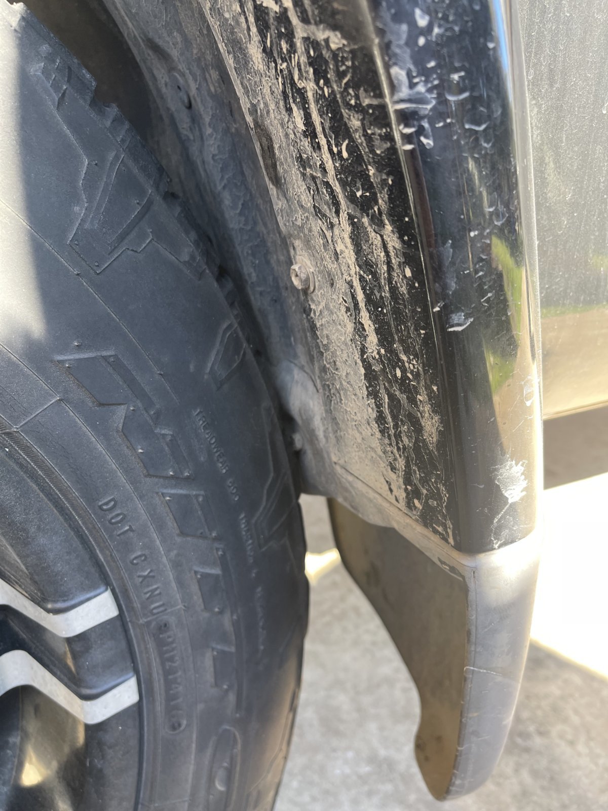

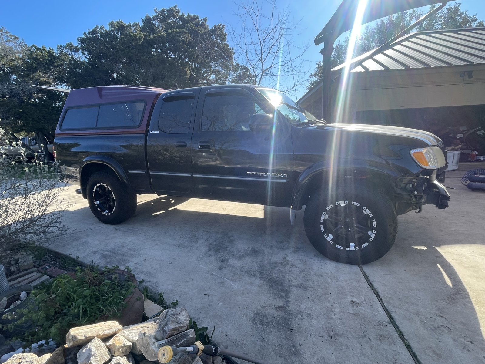

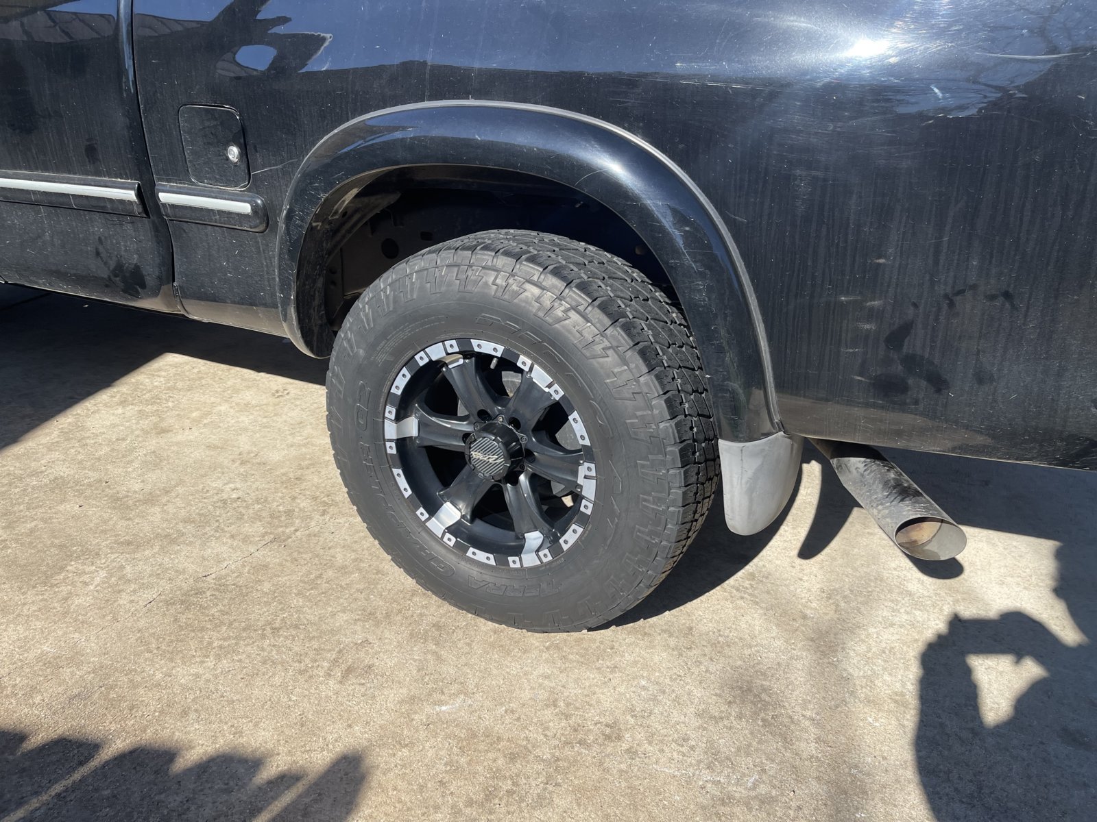

    No spacers:
    fills the wheel wells nicely.
    No frame rub, but kisses the yankee mudflaps.

    What size tire? Just curious.
  9. Feb 18, 2024 at 8:04 AM
    Mr.bee
    Mr.bee King Turdra
    Jun 4, 2022
    #79178
    6,424
    SATX
    '02 AC TRD

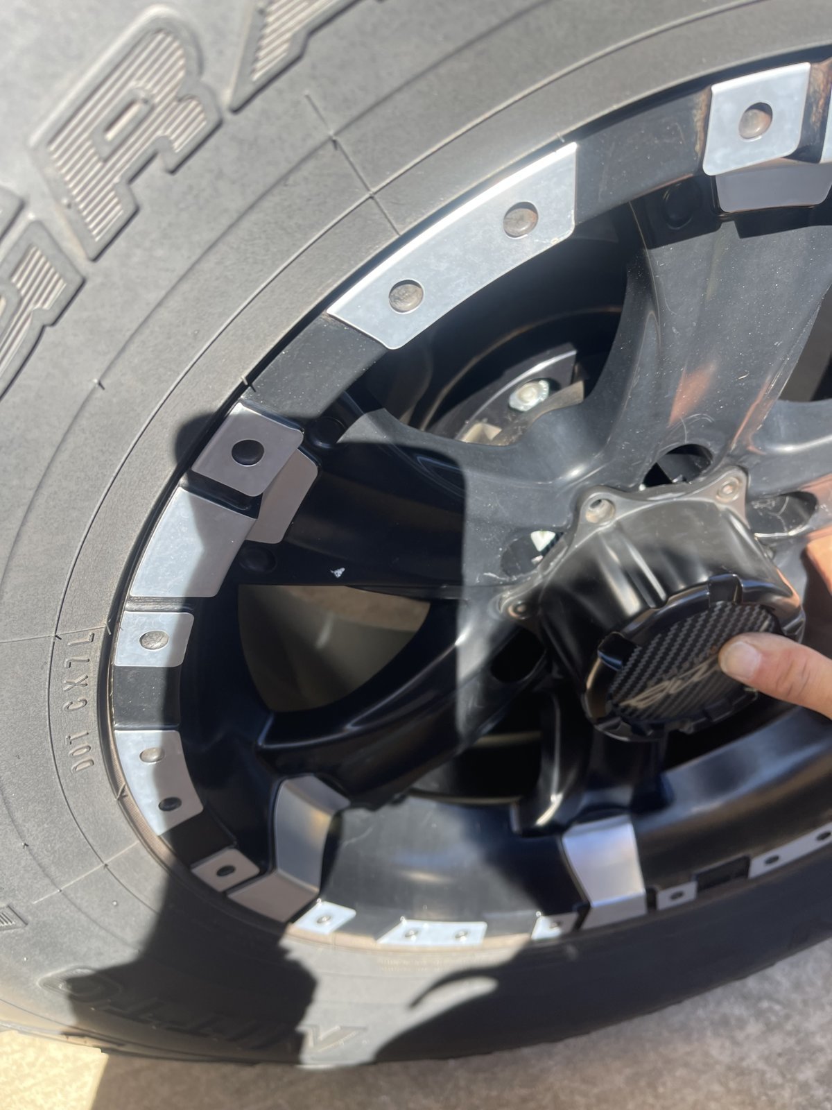

    worn out-ish 285/70-17's.
    W/ centercaps because apparently thats what seperates us from the heathens.

    Very nice. The UCAs and wheel specs are definitely working on your favor

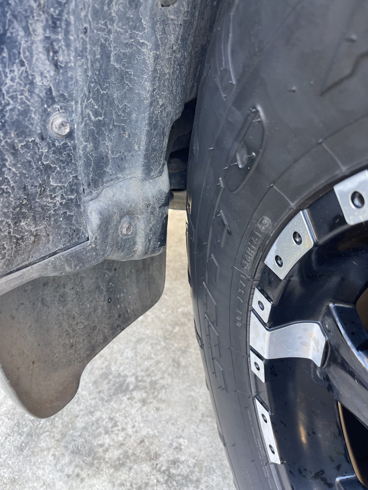

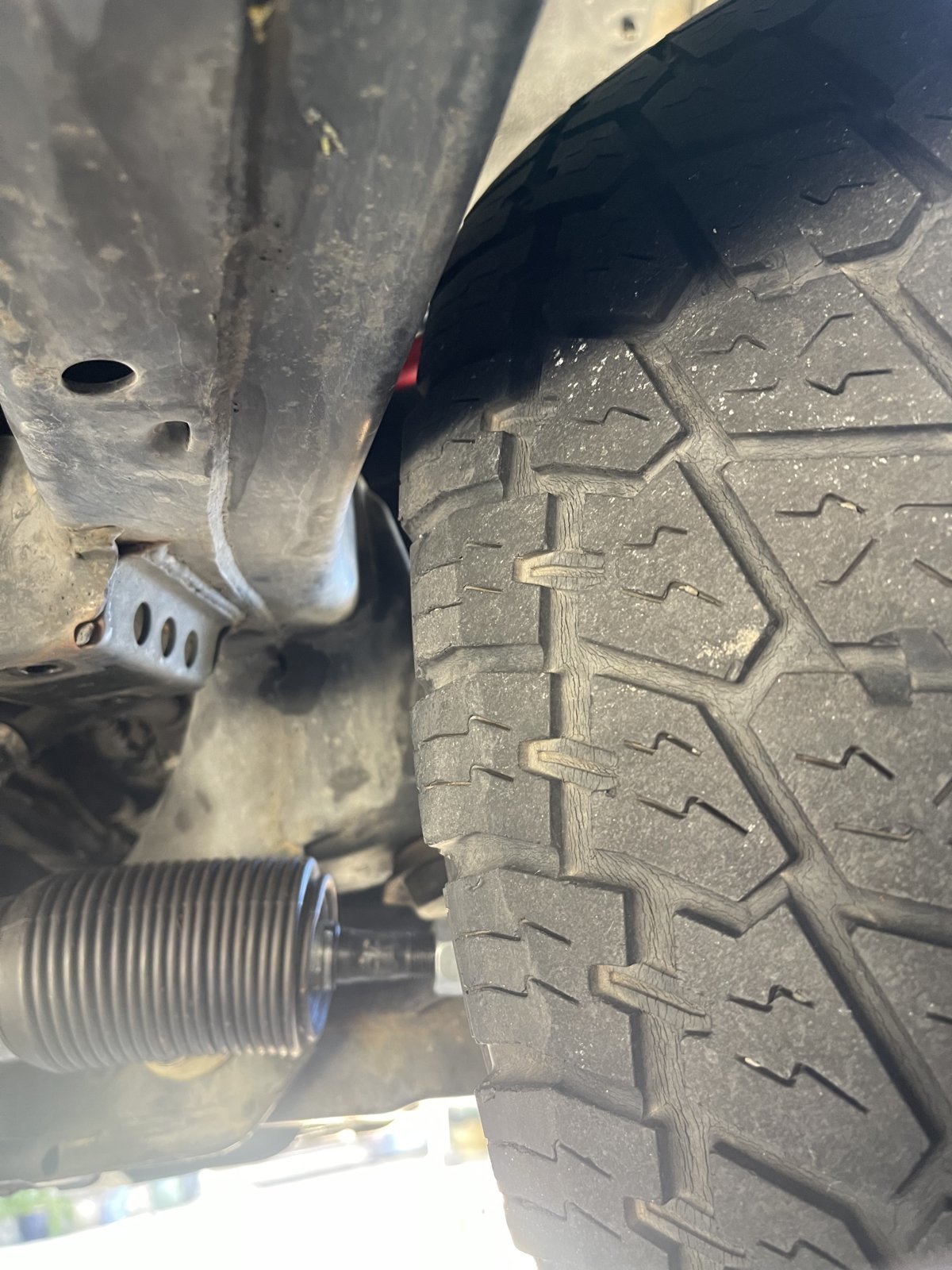

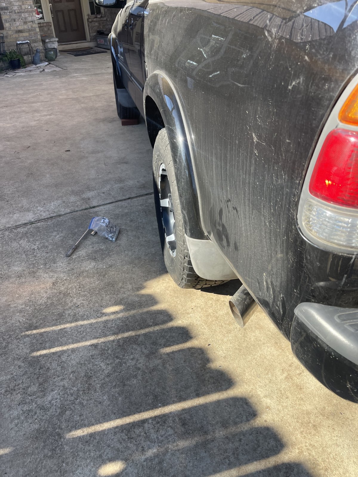

    20's w/o spacer caress the knuckle. (But dont rub the flap or the frame at stock height)
    twankies w/ spacer rub hard into the flap.
    Just like long travel.
    they'll stop rubbing eventually.
    I appreciate the spacer inspection holes. (And can fit a beer can between the hub cap & center cover)
    Like i needed more excuse to pull my front end apart & get +3.5" LT...eff.

    No cotter pin on the upper ball joint? Huh. I’ll have to take a look at mine.

    jba uses nylock, and i added loctite.

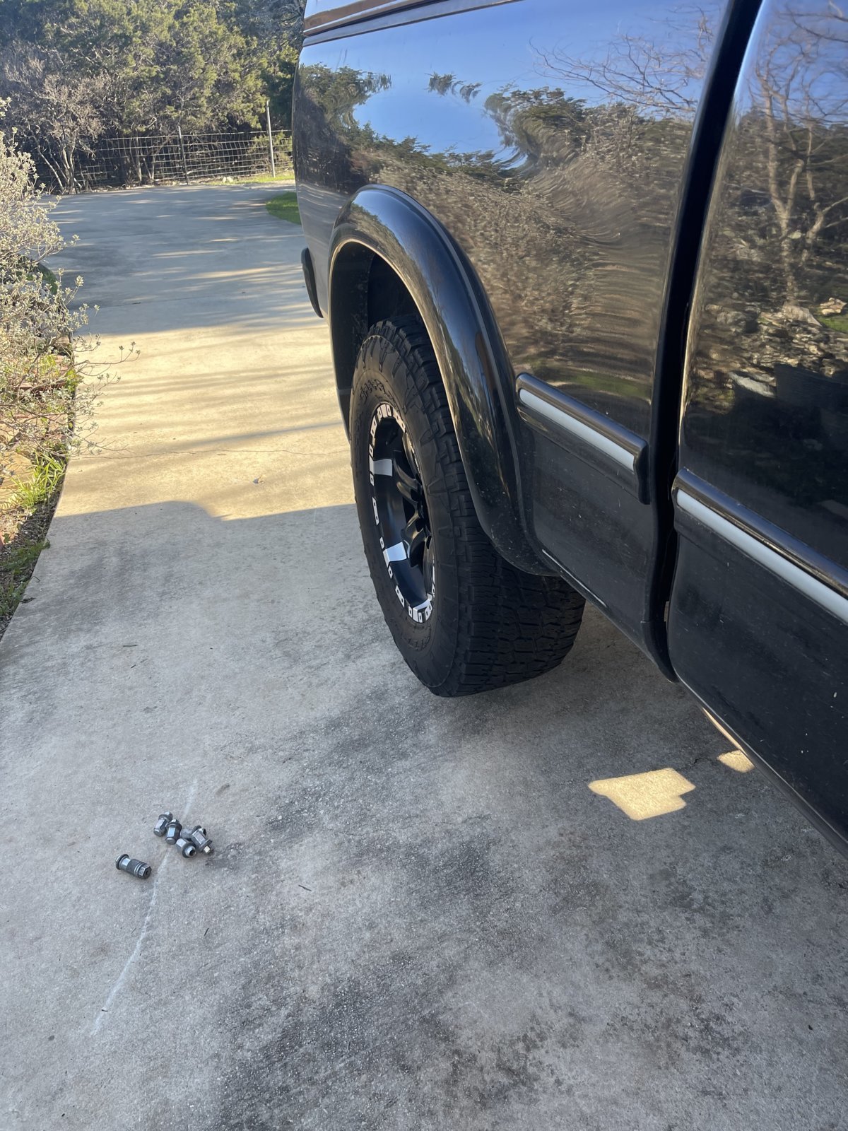

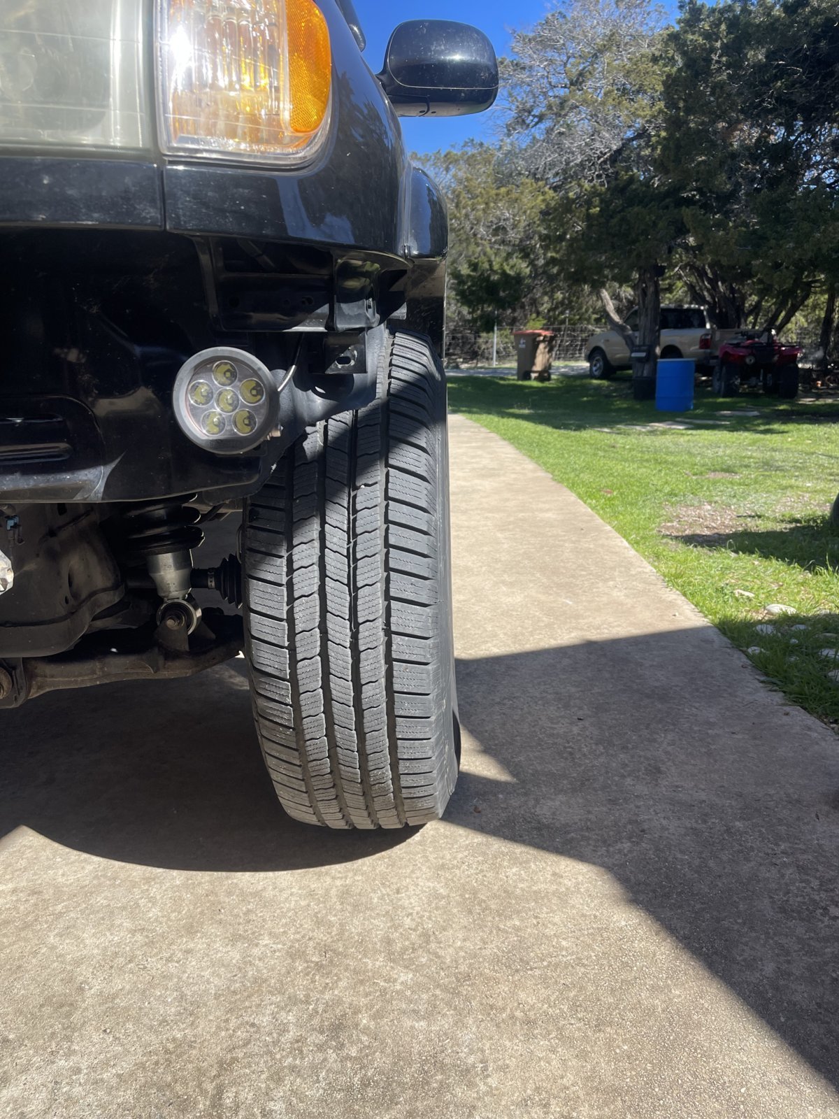

    Lady tires dont rub with spacers.

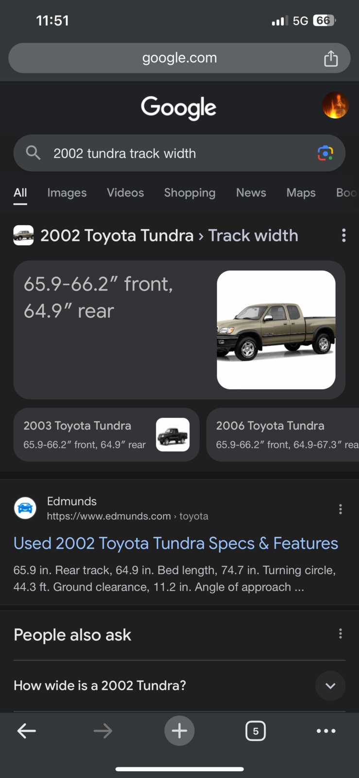

    1-1/4" seems about perfect for the front. Probably need 1-3/4" for the rear.

    The rear is more narrow than front?

    Dunno if 4x4 is wider or narrower. I hid my tape measure from myself.

    Strange. I always assumed that they were the same. I'll get my tape measure out this afternoon for 06 and 03

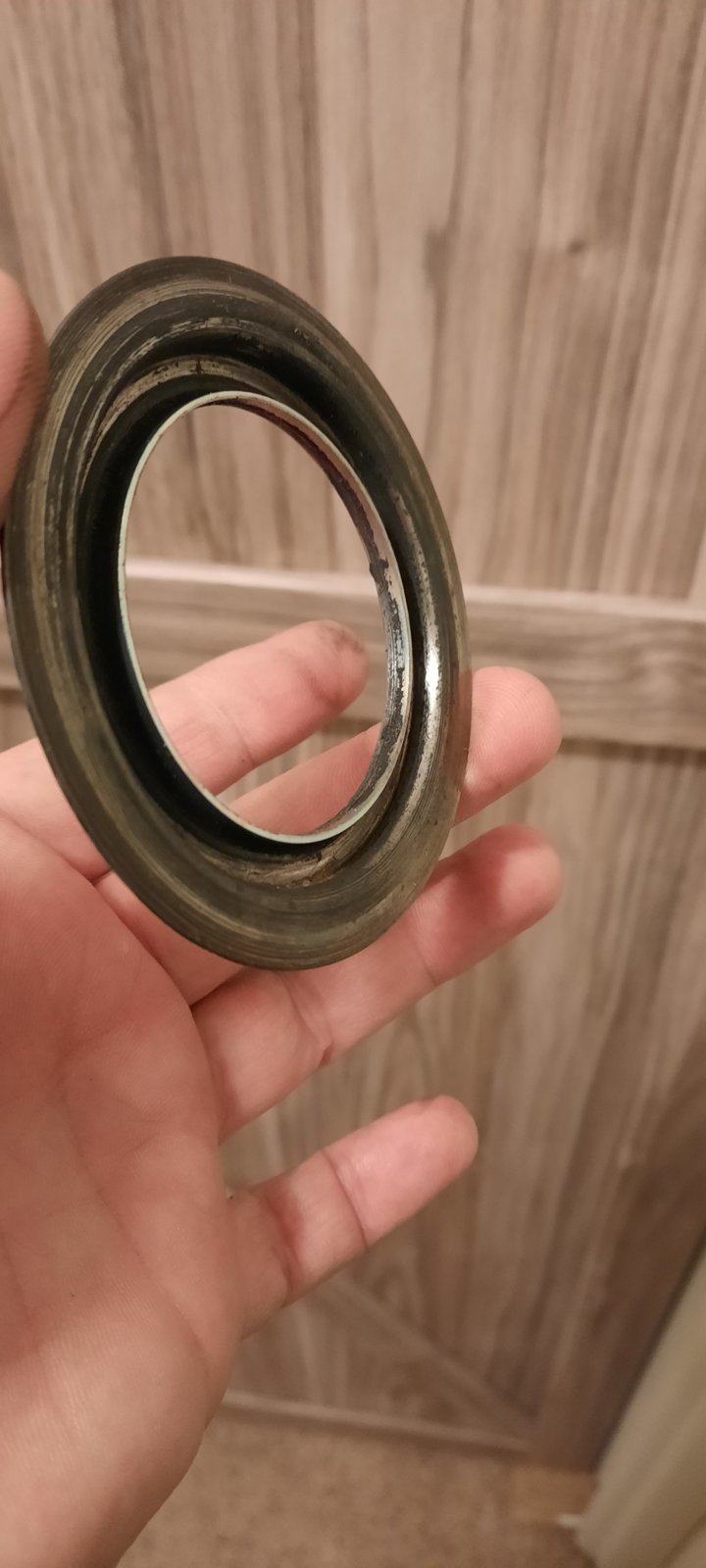

    From outside of stock tire to tire on my 03 rear I'm getting 74"
    Front is also 74"
