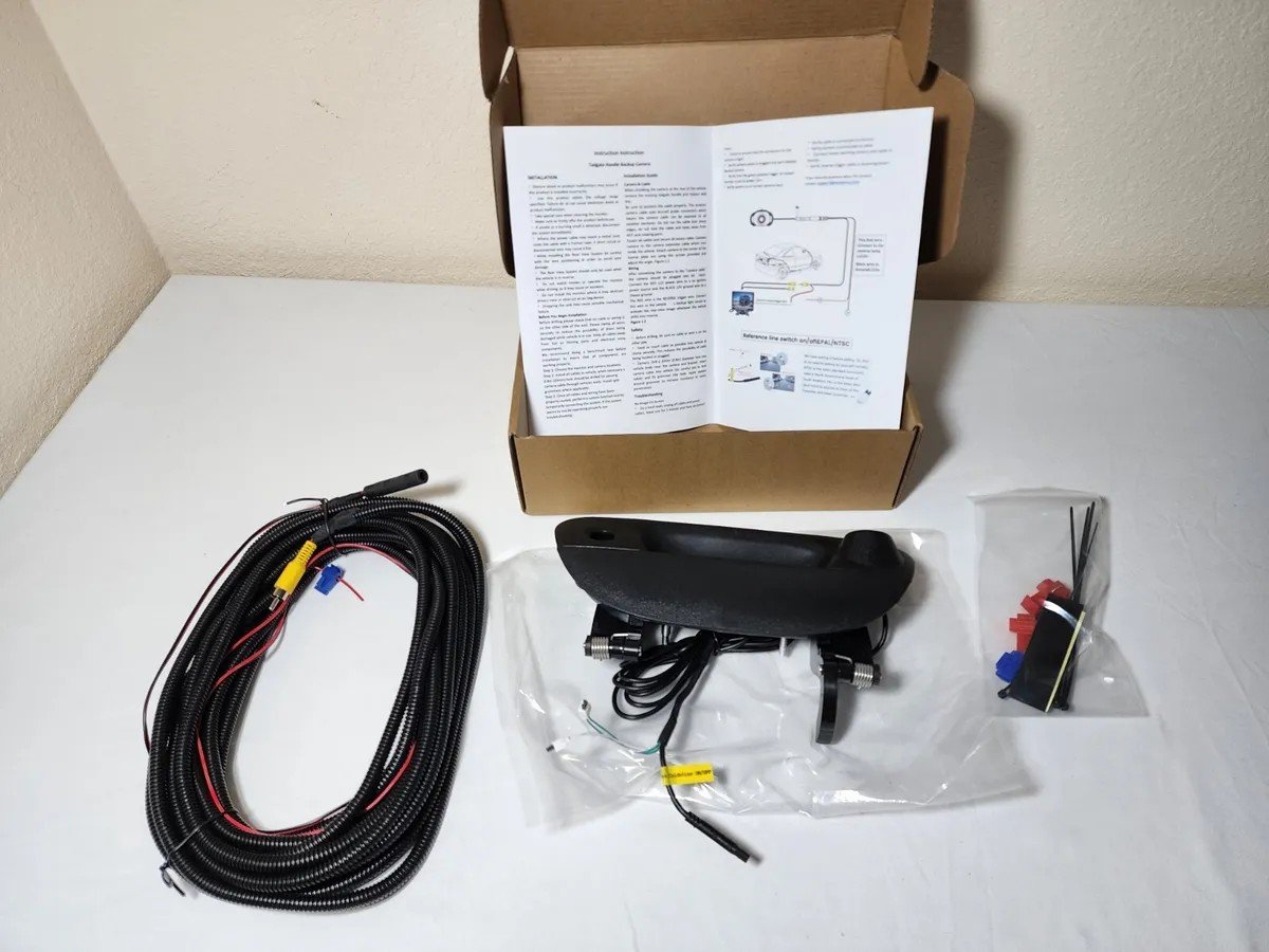

    Well shit ... Got the backup camera wired and it isn't working. It knows I'm in reverse, because the screen changes to a black screen.
    I tried changing the camera polarity from battery to ground on the head unit and that didn't work.
    This is the one I got.
    https://www.amazon.com/Anina-Tailgate-2000-2006-Tailgaters-Replacement/dp/B09TKTLLQ2
    It's got two wires I don't know what they are for. They are not the ground, or the signal power, or the video wire. All those are already connected. The wires in question are these green and white ones. They have little plugs on the ends

    wonder if they're for some sorta aux switch. I tried to find an online manual, no luck.

    Same. The paper manual is short, poorly translated crap.

    sounds like you are missing +12v or neg to camera

    Maybe. I've got the red wire tied into reverse lights power wire, ground is bolted on the chassis, the other end of red is connected to the pioneer units reverse trigger wire. The yellow plug is plugged into the yellow video IN on the pioneer. I don't know what I'm missing. It seems like the two random green and white wires are for guide lines.

    https://youtu.be/olhrPau4AIA?si=4mdx5ePjntTWLEgR
    maybe he goes over something you missed?
    edit: he talks about the little wires at the end of the video. They’re usually for mirror and camera lines? So I don’t see how they could be effecting why it’s not outputting an inage

    @455h0le_dachshund looking into this see if there is a reverse camera plug. Not video out.

    I'm an idiot. I figured it out after checking everything over again. I had it plugged into the yellow video IN, instead of RC IN. RC= rear camera. Fuckin a.
