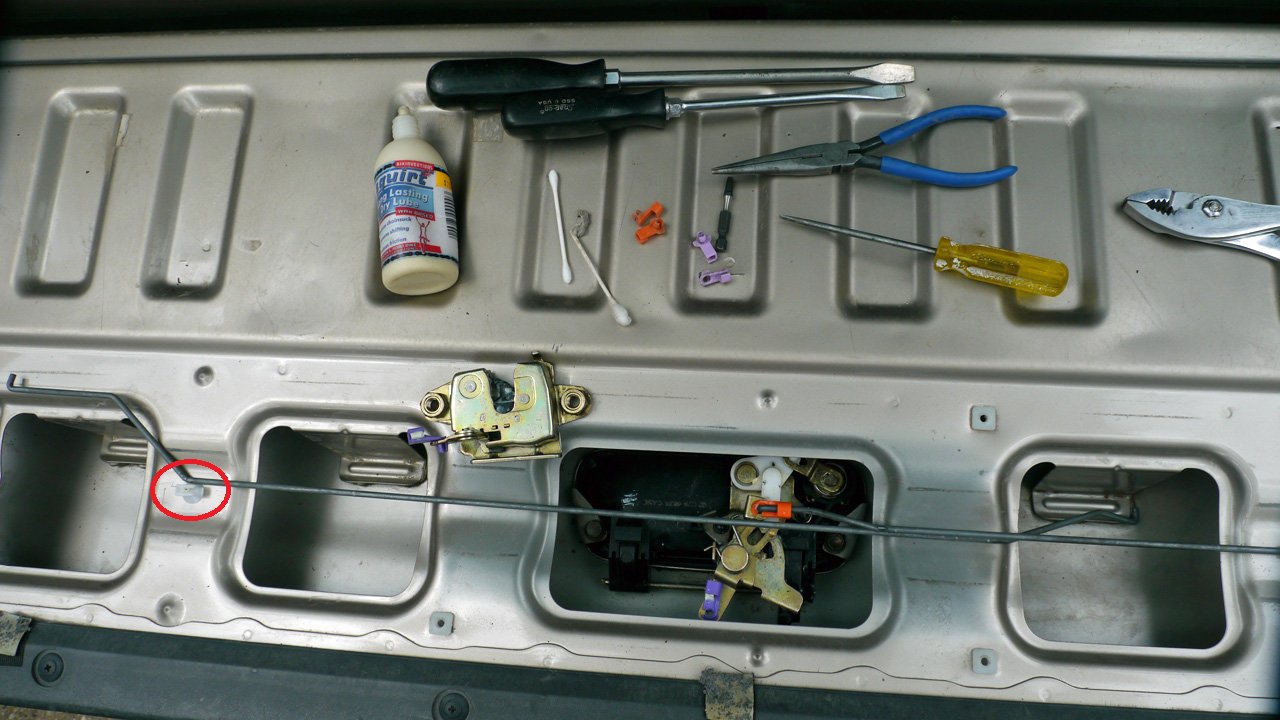

    My tailgate handle was floppy and didn't engage until it was pulled all the way. The tailgate also doesn't like to stay shut sometimes.
    So I replaced the tailgate handle with a camera handle combo. I tested the handle before install. It worked great. Swapped it in and now it's floppy. The old handle is working fine now that it's out. I lubed everything already
    What am I missing? Some part of the outter mechanism must be to blame.
    Any ideas?

    Yes, are the white retention clips intact? If not, it'll result in loose/floppy behavior. Same is true on regular doors. The opening rod needs to be contained to avoid floppy behavior.

    And @455h0le_dachshund these white clips are what I'm talking about. They need to be intact, and the rod snapped into them. There's one midway down each rail. Note the bar is popped out in this pic.

    The retention clips on the handle mechanism? Yes they are new.
    Or do you mean on the outter latching mechanisms? I ran out of daylight before I could investigate those.

    Well both, really, but see my last pic.

    If yours are cracked or missing, p/n is 69749-34010

    I found some other stuffs I need to check after the rain stops tomorrow. Looks like the panel being bowed is another culprit. Pretty sure mine is bowed from the PO transporting motorcycles. So ill hammer ot out with my mallet. Also looked like I can adjust the strikers.
